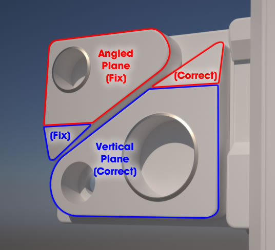

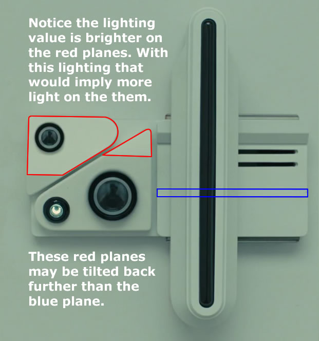

When comparing your prop against the screenshot, I would say that the upper left triangle might be tilted backwards on the movie version. The lower half of the triangle seems to be flat.
It’s the opposite on your version.
I might be seeing it wrong though...
interesting, I never considered it before but you might be right. I just assumed that since the larger top part was lighter and the bottom small part was darker, the darker small part must be tilted down into shadow. However, the upper part is actually even lighter than other flat parts of the panel, and the smaller part is the same shade as other flat parts. the upper part is a similar light shade to other parts which are tilted back into light, so let me try modeling it that way and ill show a comparison
Interesting observation.

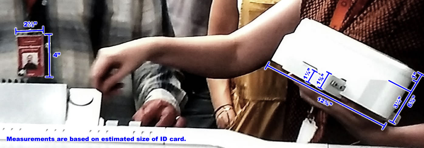

I am watching the extras on the disc. There is a scene in the extras ("Designing the World of Blade Runner 2049") where a woman is holding the unit in her hand. An interesting side view that gives us some thickness reference. Super excited to find this!
The general size is what we had extrapolated, but it is MUCH thicker than we'd thought. We can also see along the top edge a bit and there's a rail with a couple circular elements on it.
Wish there was something we knew the dimensions of, to use as a better size reference. The ID badge perhaps?

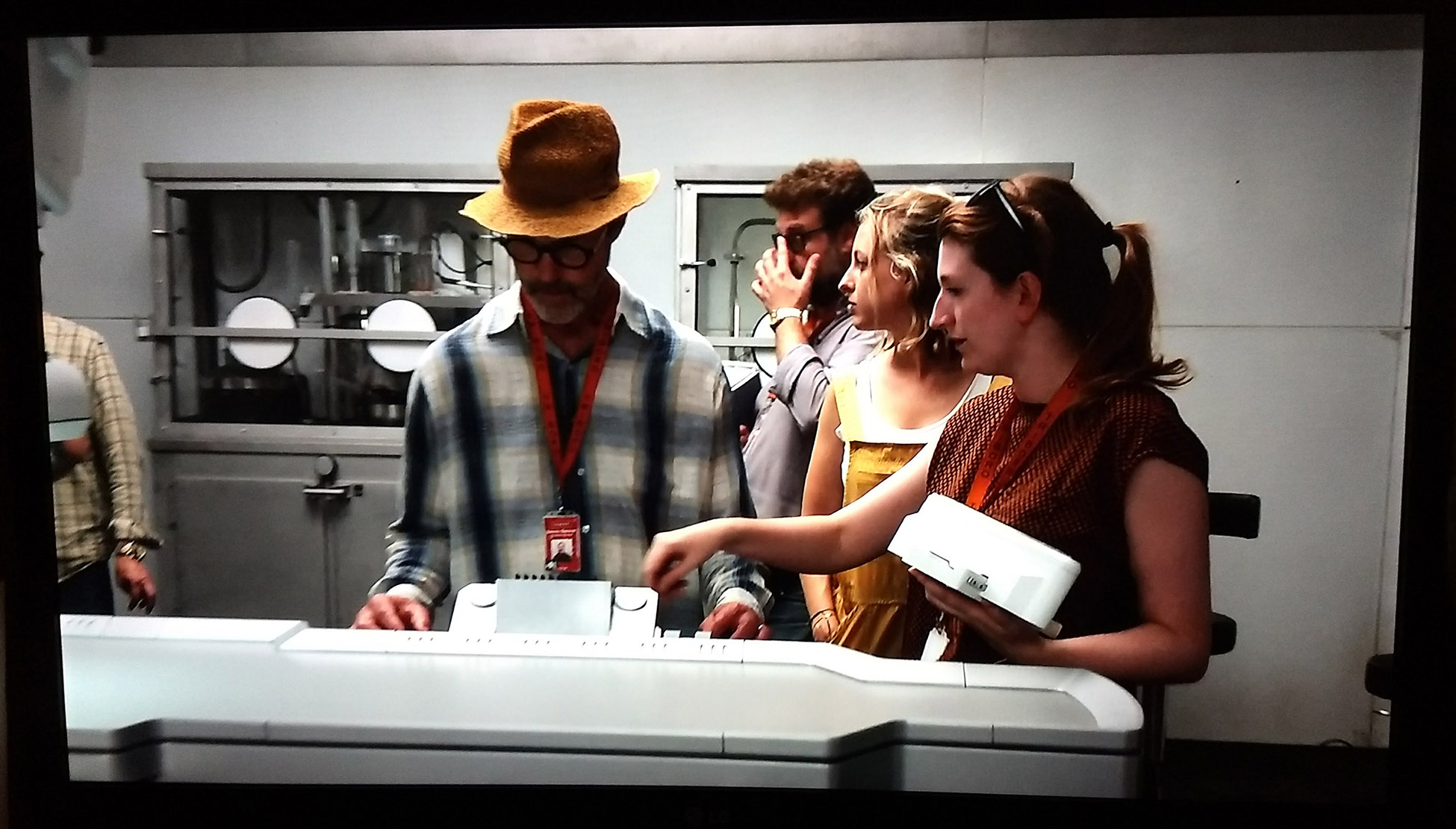

This is the best I can do for now. I don't have a way to do screencaps at the moment, so this is a photo of my TV from my phone.
Request: We could really use some Blu-ray screencaps of this, if any of you have the capability.

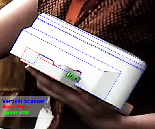

I'm outlining the major visible elements in the shot. Here's what I am seeing in the image...
Great find! I think the base plate is pretty accurate in overall size, but yeah the vertical scanner is way thicker! also looks like it was definitely intended to slide horizontally as there is a gap, I might still keep it as one solid piece though just to make things easier
also great reference for the silver railings!

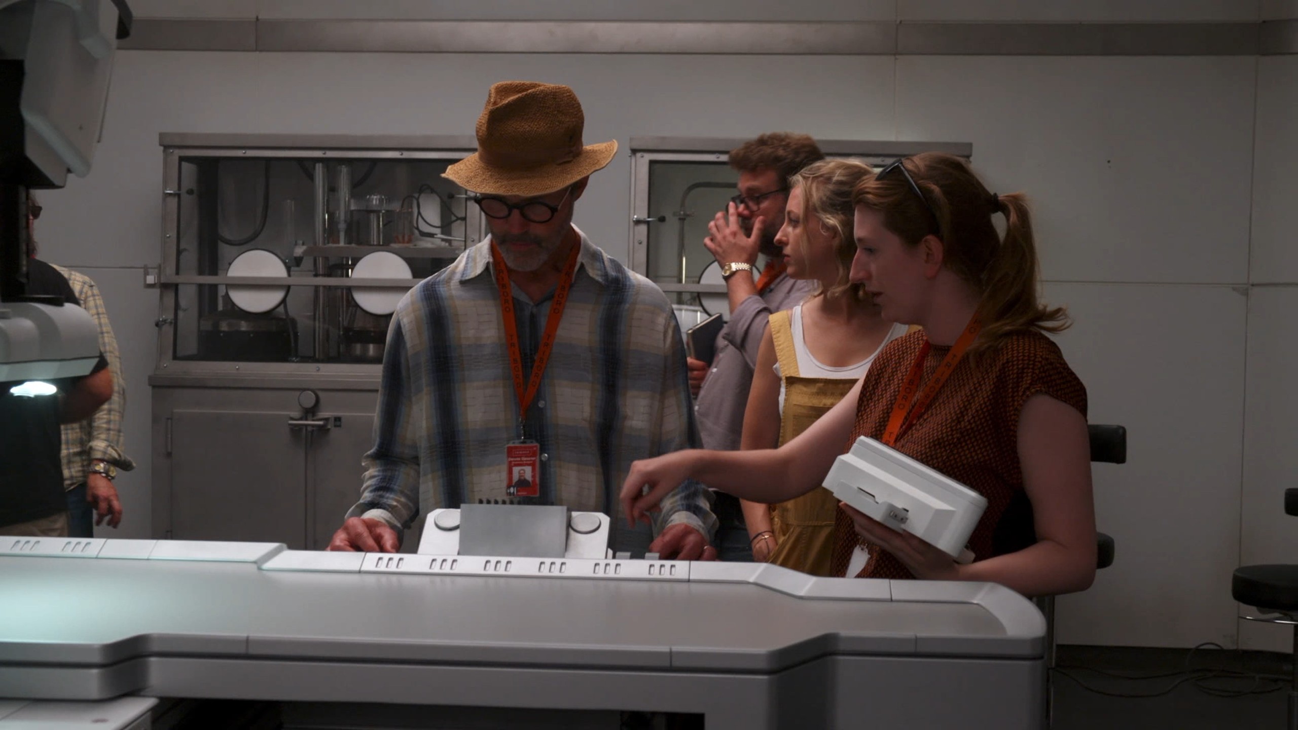

Picked up my copy today and got some screenshots
screenshot005.jpgscreenshot004.jpgscreenshot003.jpgscreenshot002.jpgscreenshot001.jpgscreenshot000.jpg

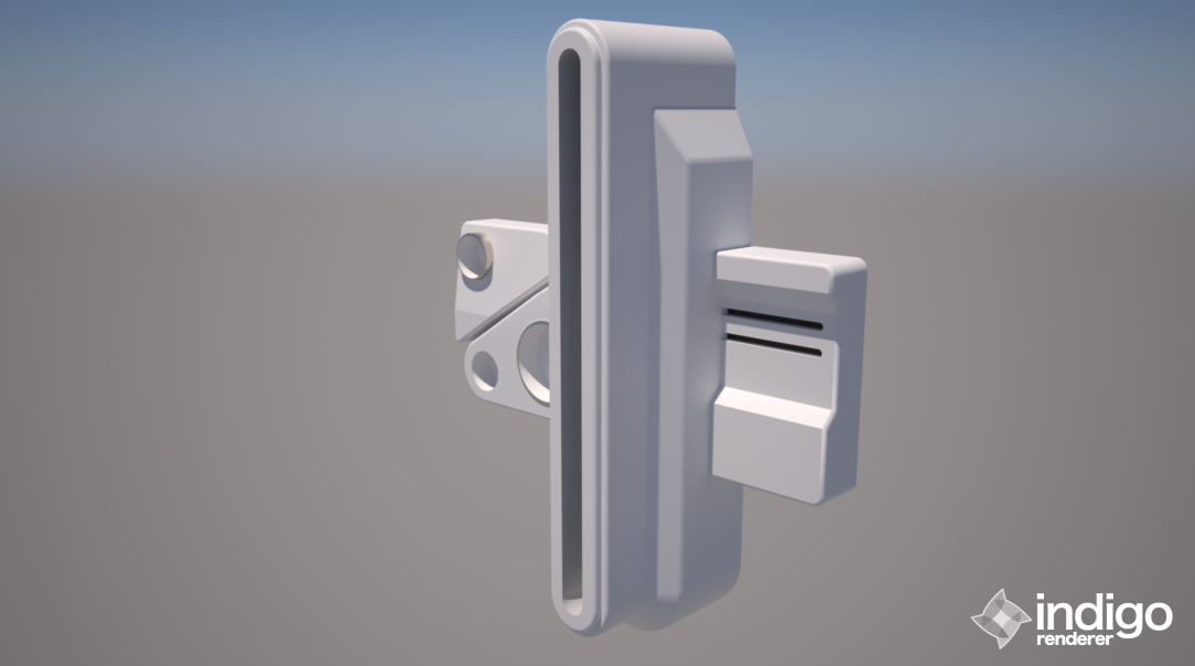

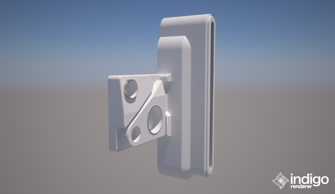

and the vertical bar still needs a lot of work (the top half of the largest oval actually has a straight edge not a curved one) but i fixed its overall size and fixed the shape of the left triangle

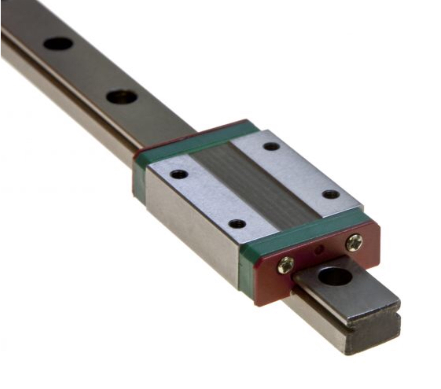

The silver railing you’re describing looks like a linear rail, which makes sense if the vertical scanner slides horizontally.
definitely looks like that's what it is, ill look at various rails online for reference

I own the 4K UHD version of the film. The problem is the only shot seems to be front on because it is mounted to the wall.
A 4K screenshot of it mounted on the wall would still be twice as clear, as that one image we have so far. If you can pull it off we sure could use it. Thanks.
That could still prove super helpful, especially in areas where its hard to discern details (like the black rings around the lenses and the vertical black bar)
if you are up for grabbing some 4k screenshots that would be awesome!
just keep in mind that the "close ups" of the device are in the second baseline test scene, not the first
