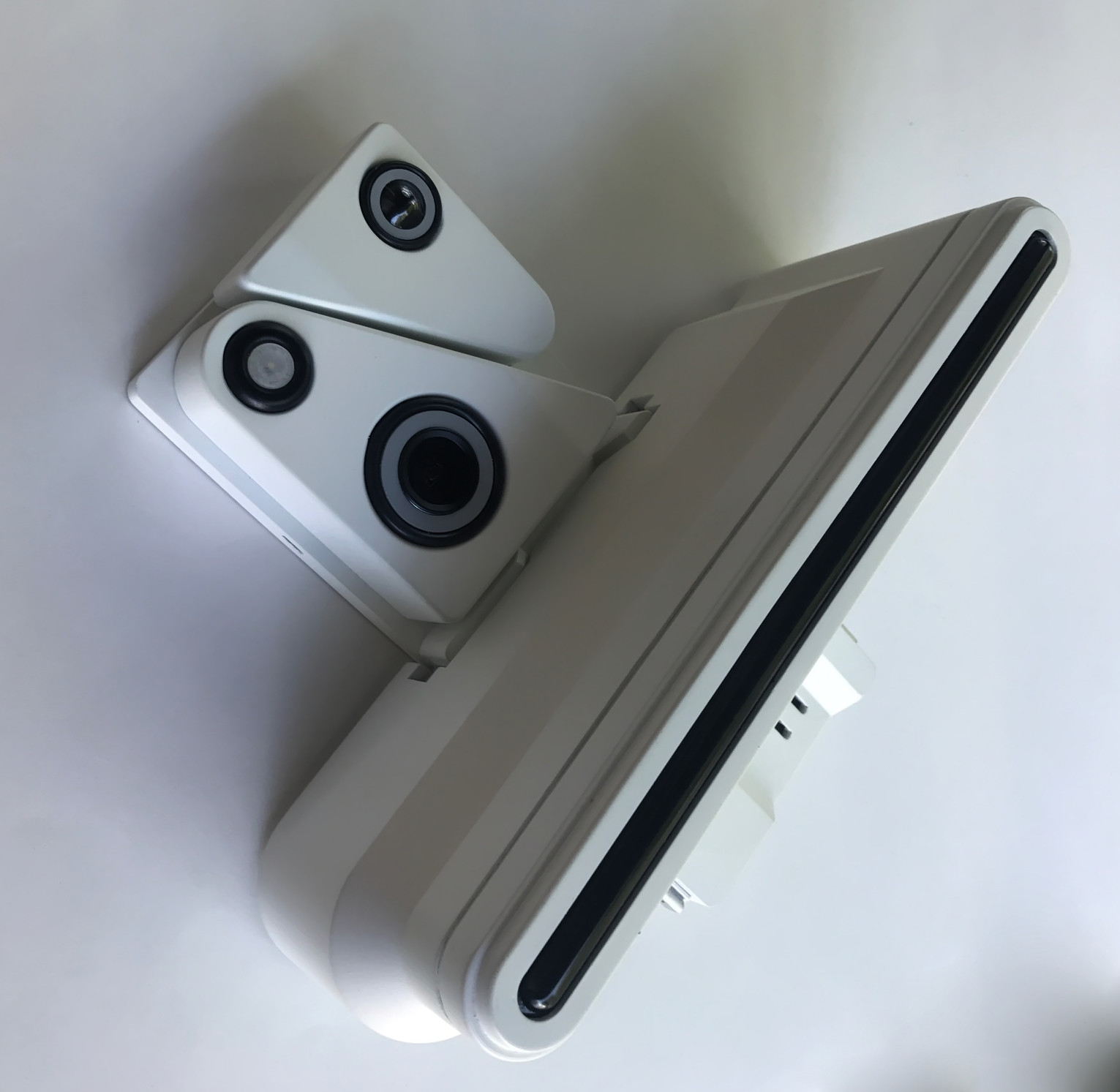

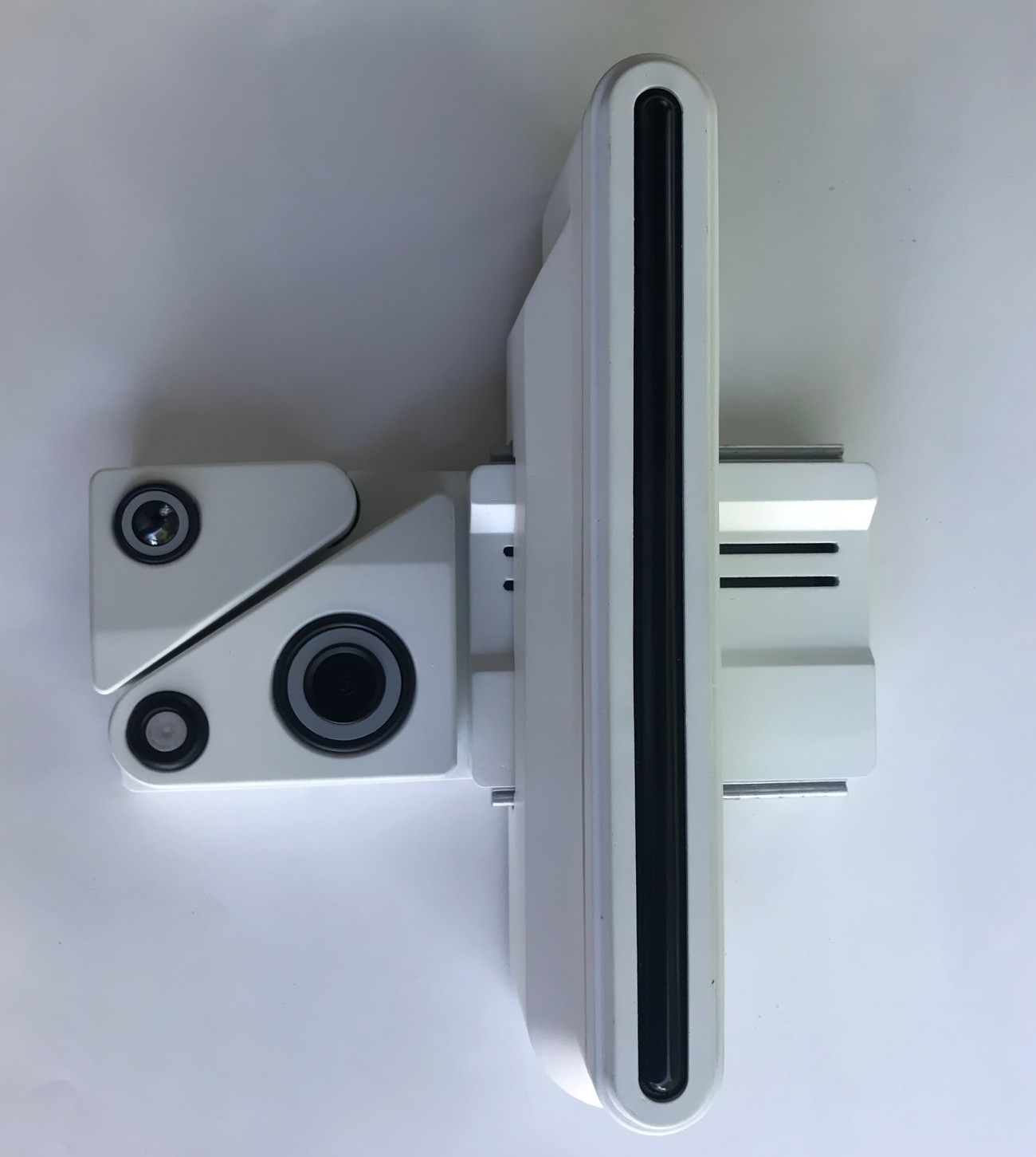

I finished the overall design and put the stls on thingiverse for all who are interested in building one as well. Right now there is space for a Pi zero, Pi camera and wide angle lens. The internal mechanics for the servos and the sketches are not finalized so there will be updates for that. https://www.thingiverse.com/thing:3042100. Have fun.

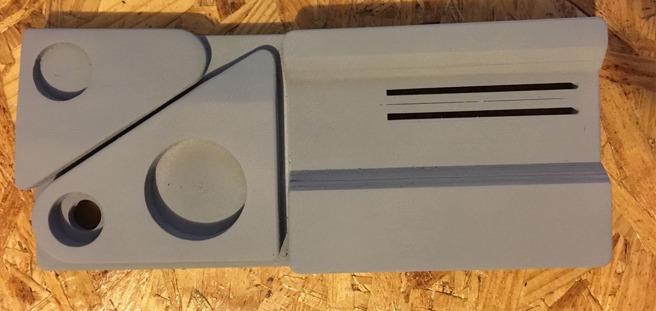

Sorry for being mostly absent, I got some prints over a month ago now and was really excited working on them, but then I noticed they had begun to warp pretty significantly? (or perhaps were warped from the start and I didn't notice) which was bugging me and I was sort of burnt out lol
Still plan to finish (might need to order prints from somewhere) but since Empiricus and djdrthq had great builds well underway I figured no harm stepping out for a bit haha
Here was my work in progress, was filling and sanding the left side and was pretty happy with how it was turning out but the whole thing seems to be bowed downwards (dont know how obvious it is in the photo)
Im still new to 3d prints so idk if there is a fix for warps like this but im thinking it might just be best to start over. For most projects I wouldn't care so much, but I put so much time into the digital model I want the real thing to be the best I can get lol

What filament did you use? Warping occurs mostly with ABS. To avoid that you need to print in a heated chamber or better dump ABS for good. PETG is far superior no warping nor shrinking ever. PLA is easy to print but a pain to work with as it is hard and brittle.
It was printed in PLA, I don't know how much heat effects it but it was in my hot car for a day or two which i figured was the cause. It was also printed in two layers since the printer ran out of filament, so gluing on the thin top layer may have done something as well, not sure haha
