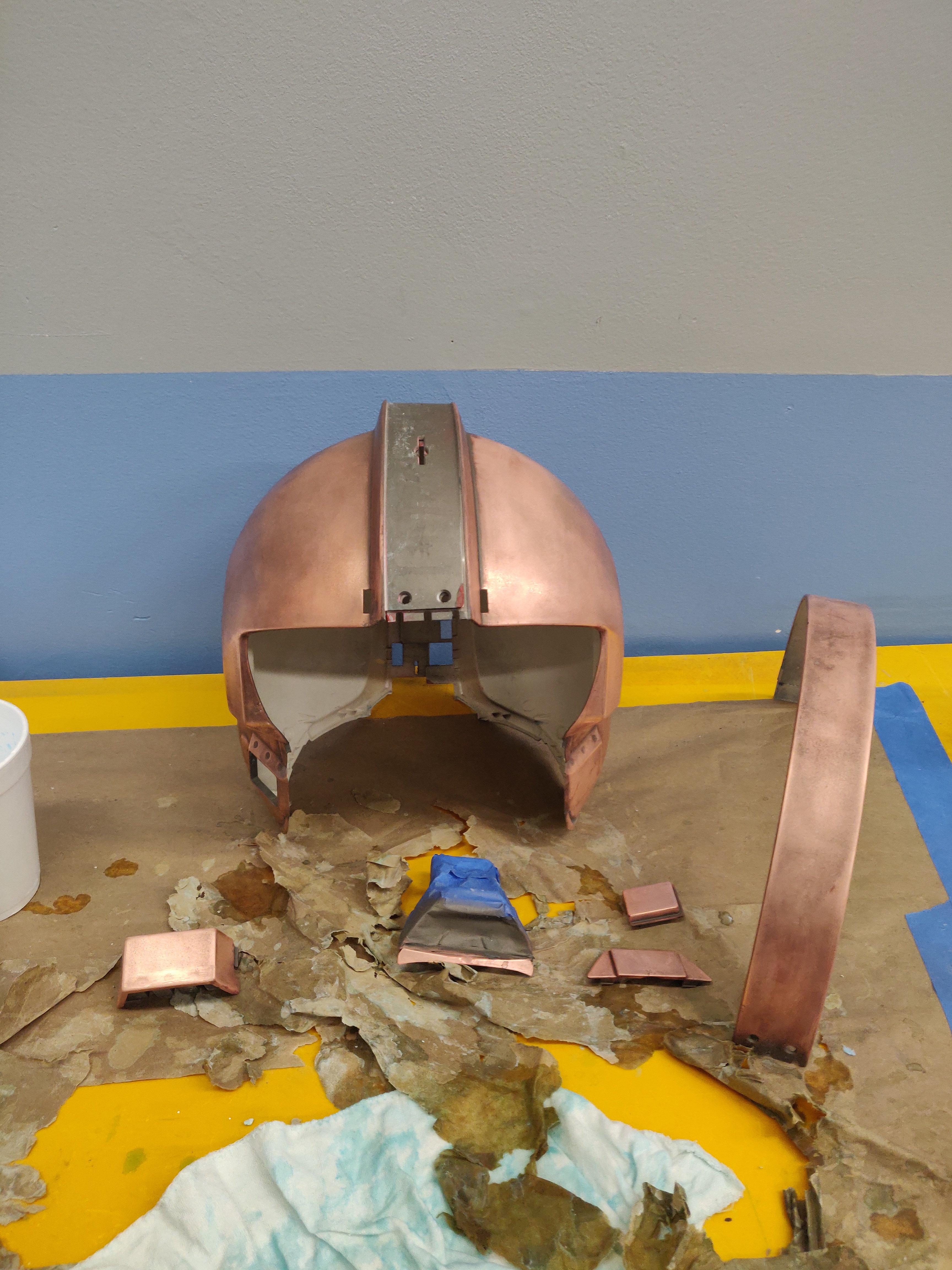

I'm at it again with another HBS repaint/conversion... Only this time I'm making a run at one of the appearances from Squadrons - the Bayora Bronze appearance. Like with the Gold Leader helmet, I've shot some videos of my progress through this adventure via my phone (hope the quality isn't too terrible, haha) - and this one is an "adventure", as I'm using an electroplating technique called "brush plating" for this one, so the color you're seeing on all of the external parts is a layer of actual copper metal. I got the idea for taking this route from a YouTube channel called "Infosmercial", where he tried this technique on a 3D printed Phasma helmet... and it seemed to work out pretty well. This project so far hasn't been without it's stumbling blocks and such, but it's rolling ahead fairly well :) I've got a picture below of where the helmet is at (more or less) at the moment, and another Google Drive with videos and more pics - I'll be updating it/uploading more videos as I continue on! Check it out, and let me know what you think!!

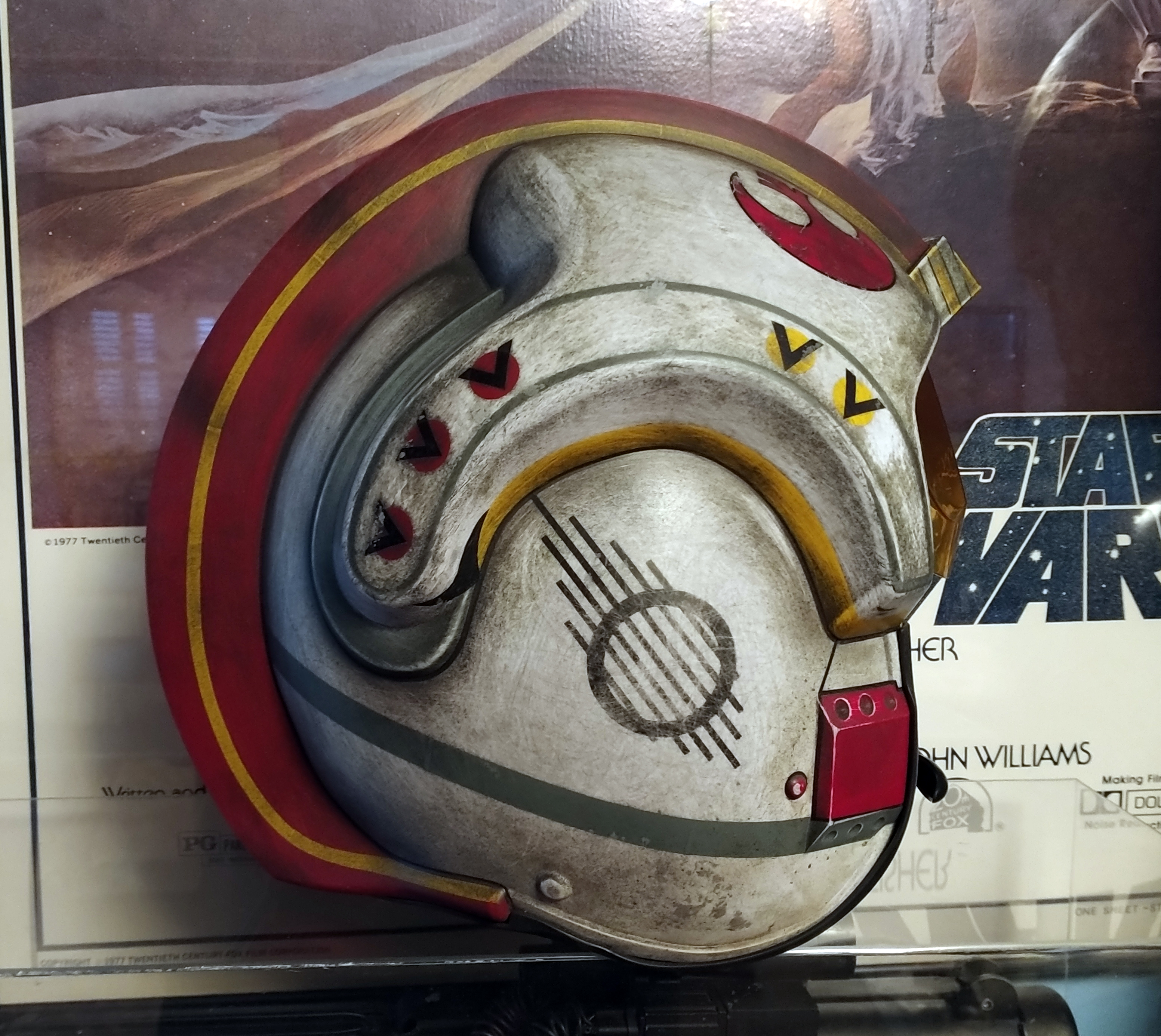

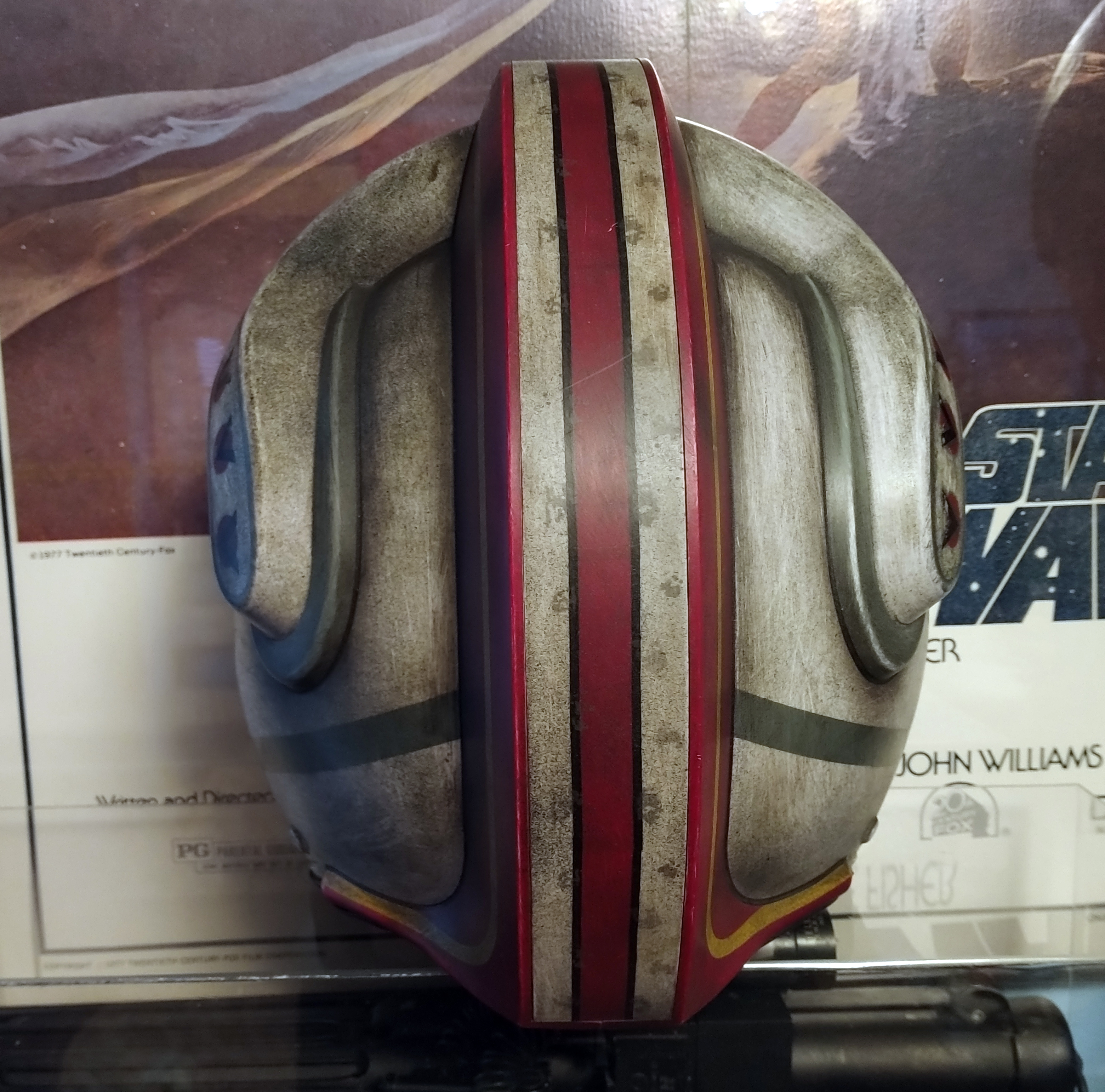

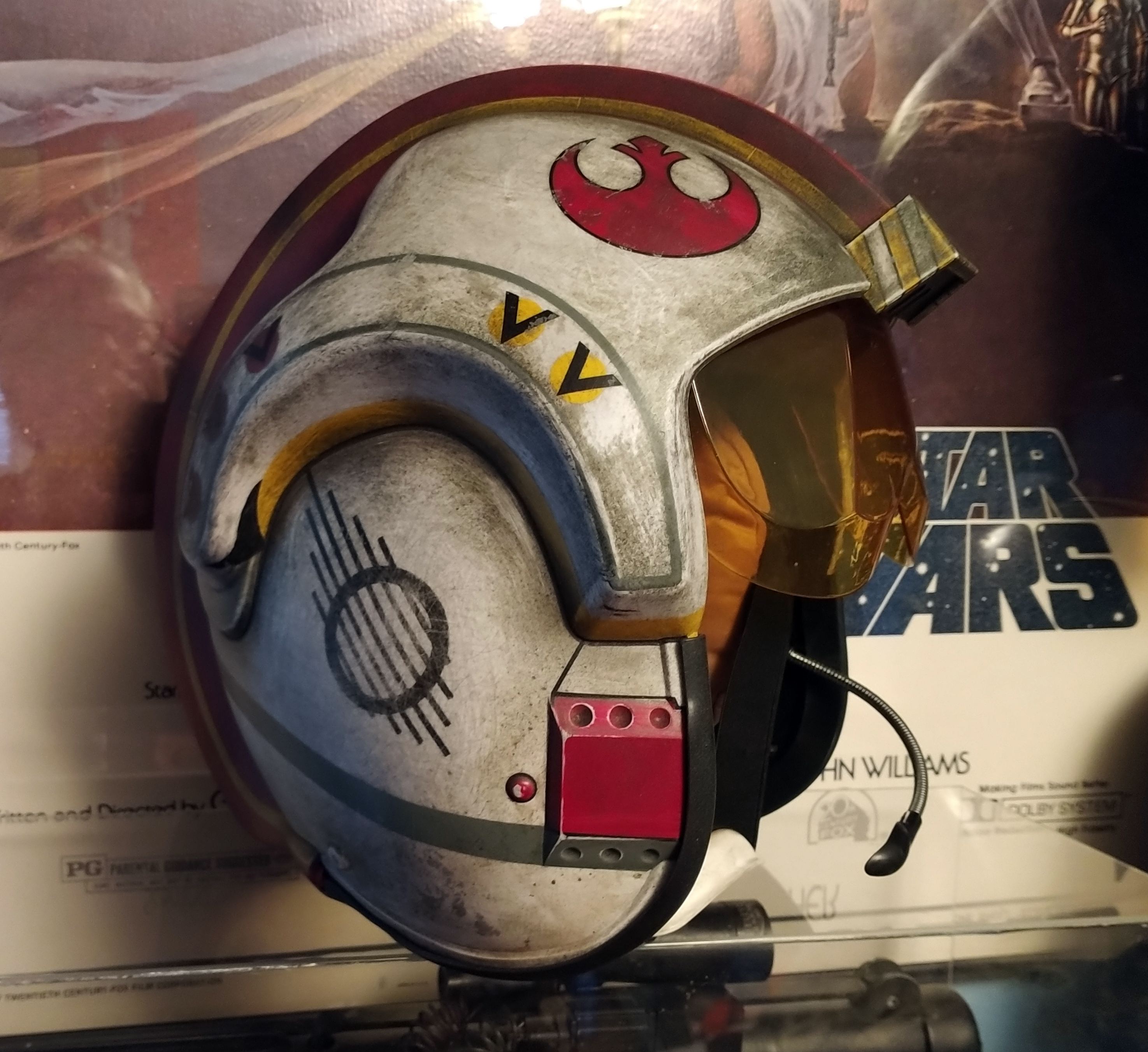

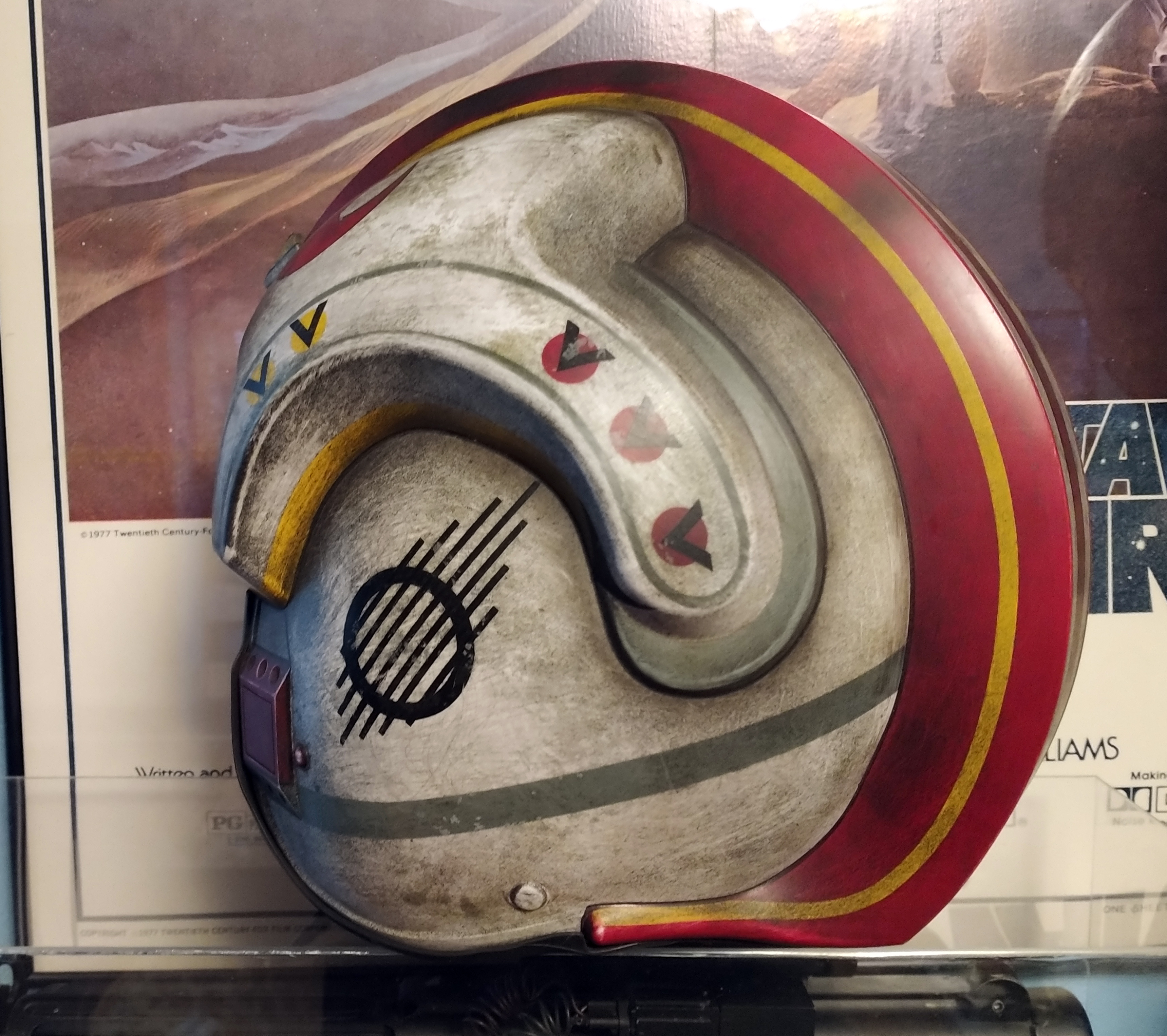

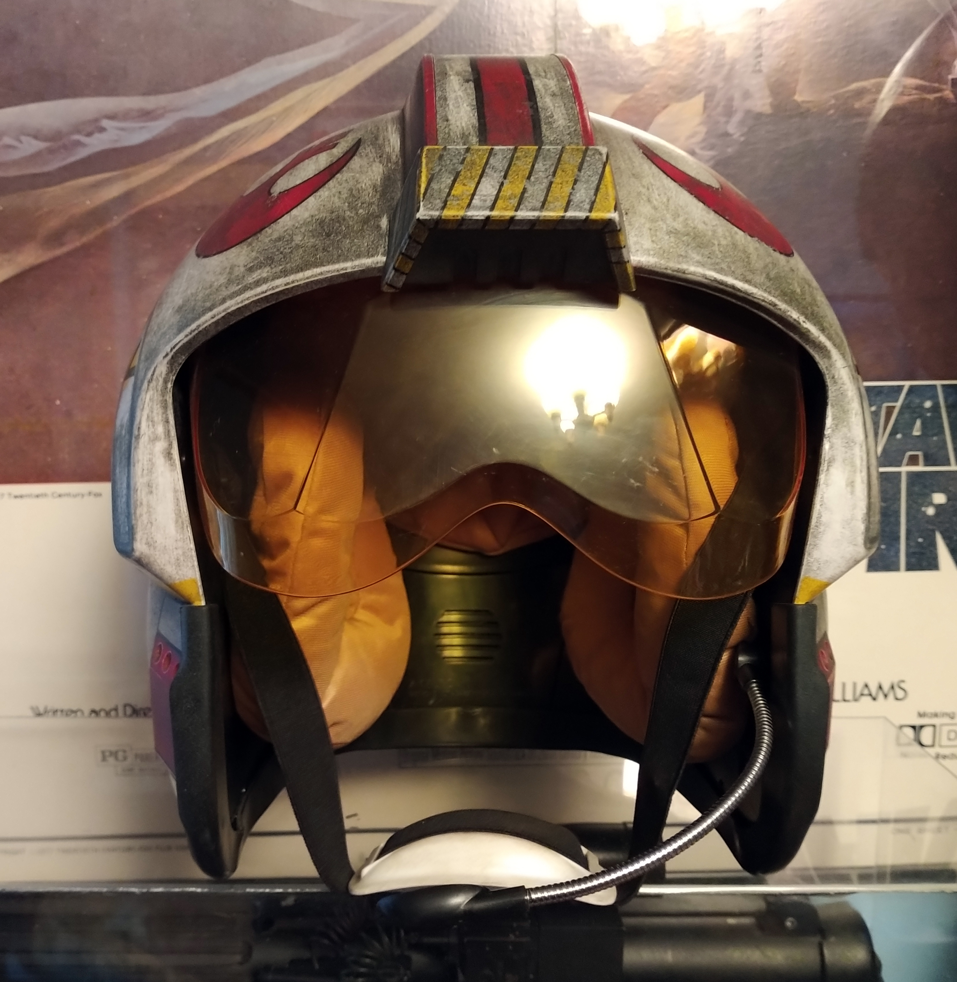

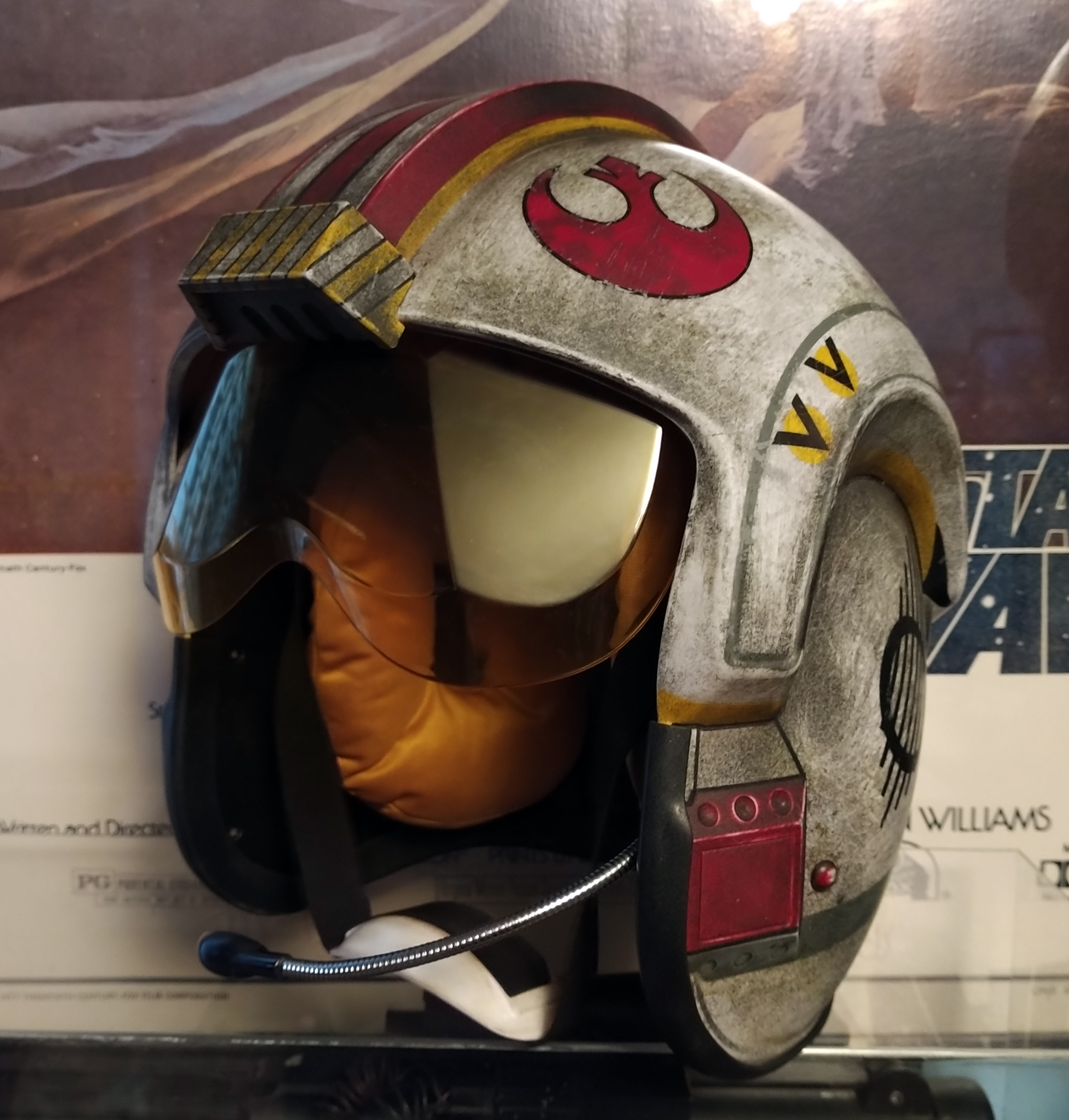

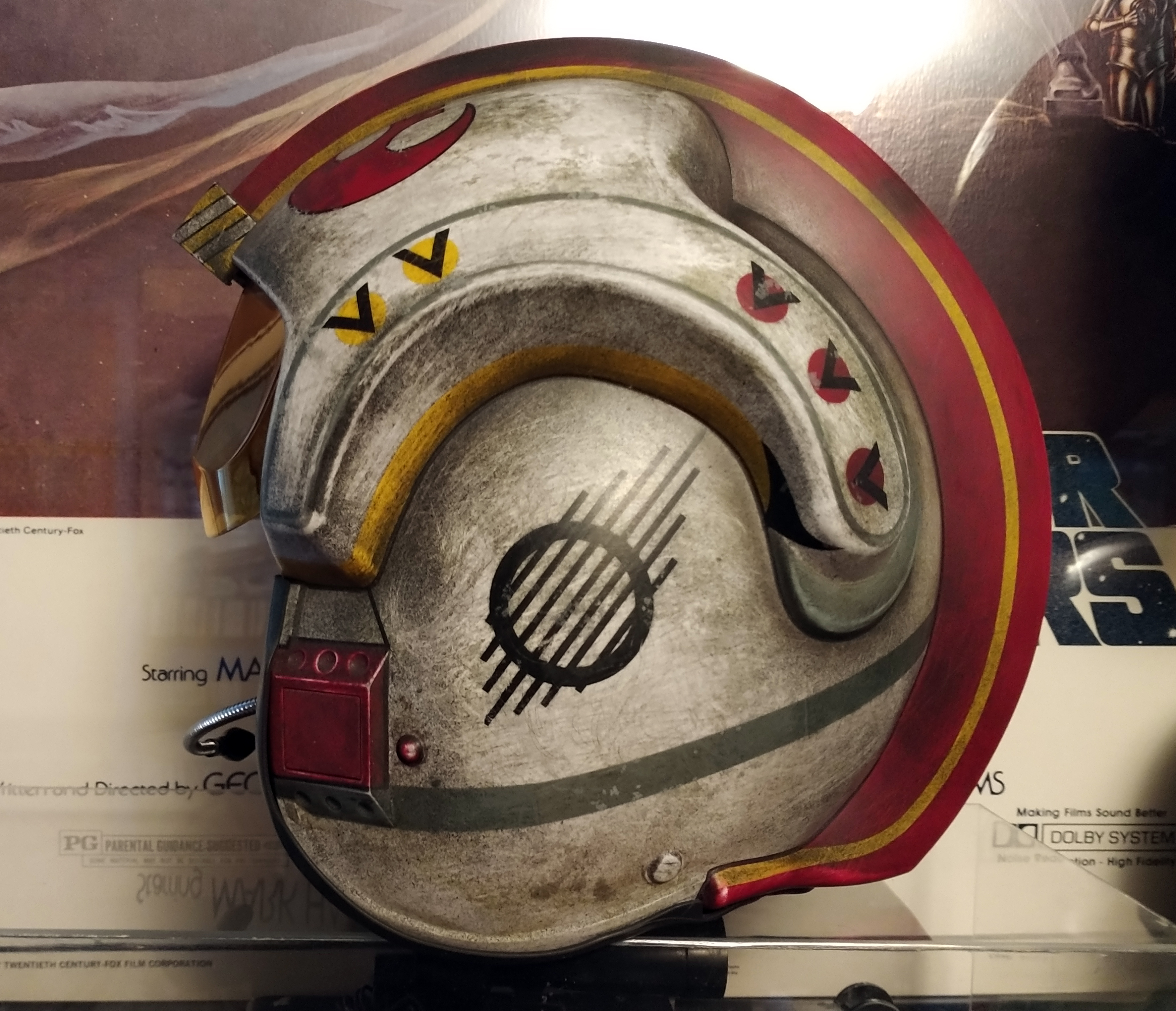

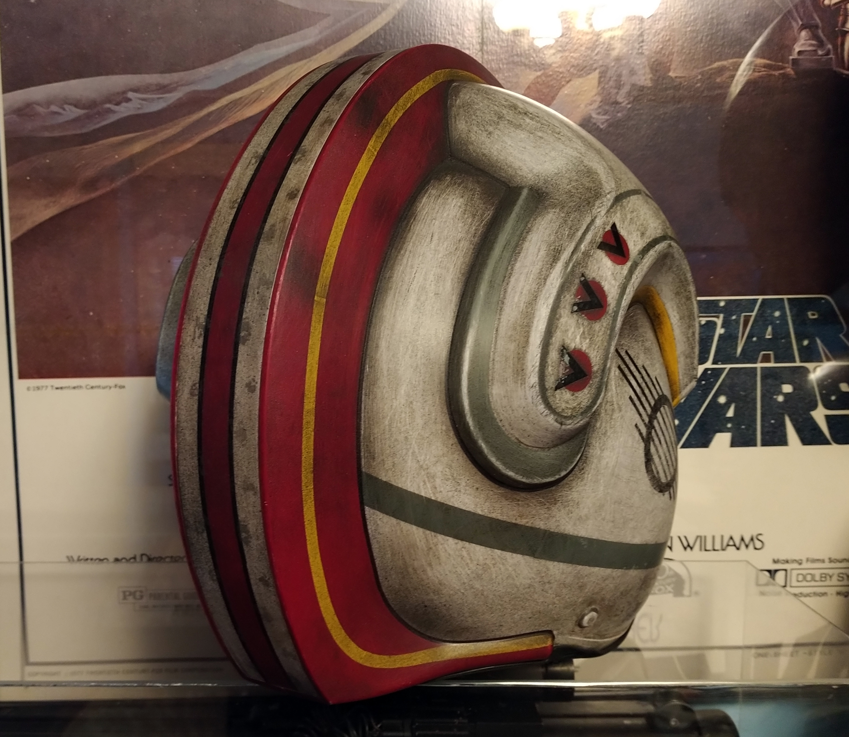

Got a Galaxy's Edge Luke helmet that I added my own weathering to. I also have a Black Series Wedge, and there are differences in the base helmets. They obviously share a common origin in the production process, but there was a divergence at some point, resulting in detail differences. I'll have to take and post comparison pics at some point.

I’ve been playing with electroplating plastic with mixed results. Can I ask what conductive paint you used on this? Looks great!
Hey man! The conductive paint I used as a primer is from MG Chemicals, and it's the "841AR-340G 841AR Super Shield Nickel Conductive Paint". It works really well, but you've got to wet-sand between layers to make sure you get it as smooth as possible. I put the Amazon link below for you, man!
MG Chemicals - 841AR-340G 841AR Super Shield Nickel Conductive Paint, 12 oz Aerosol https://www.amazon.com/dp/B01N3AWGN...abc_Q24Z2B1RVHGYY23C3WVY?_encoding=UTF8&psc=1

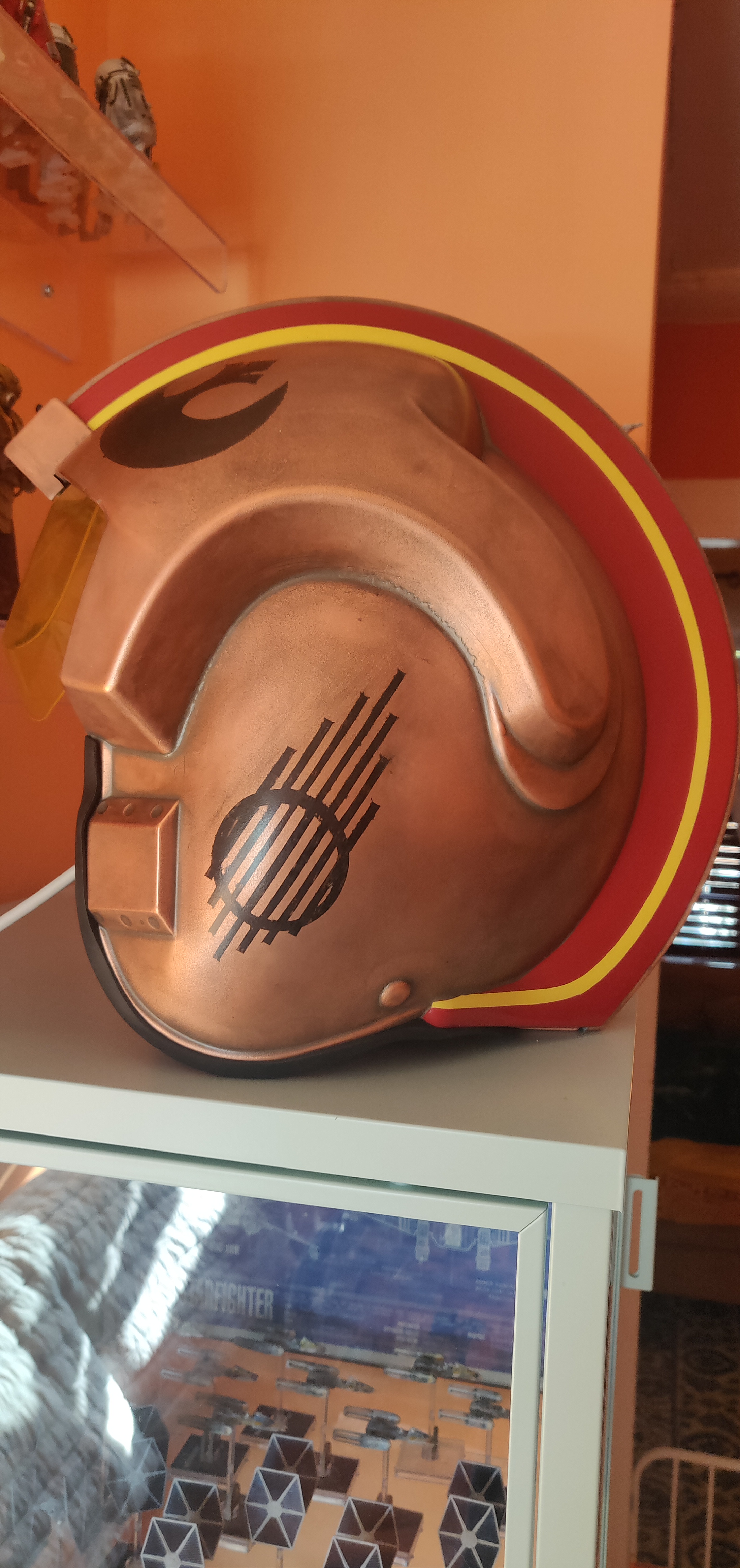

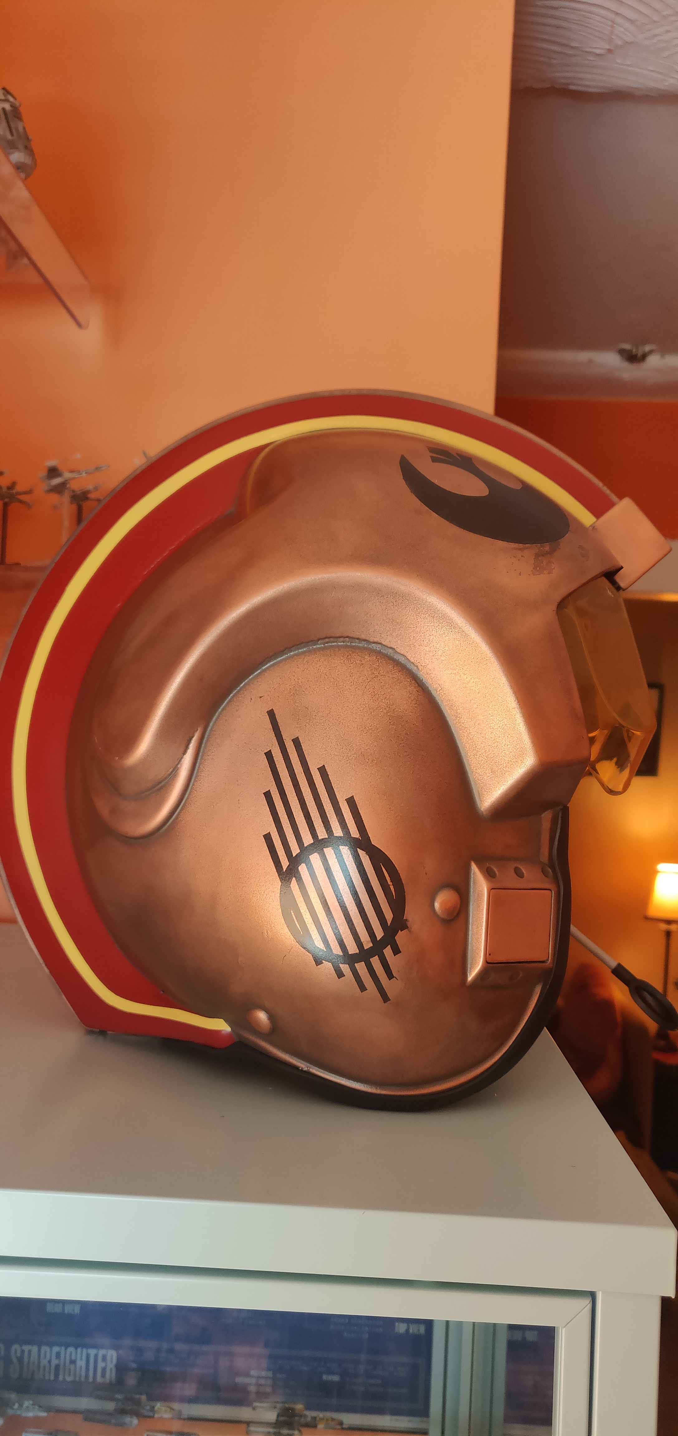

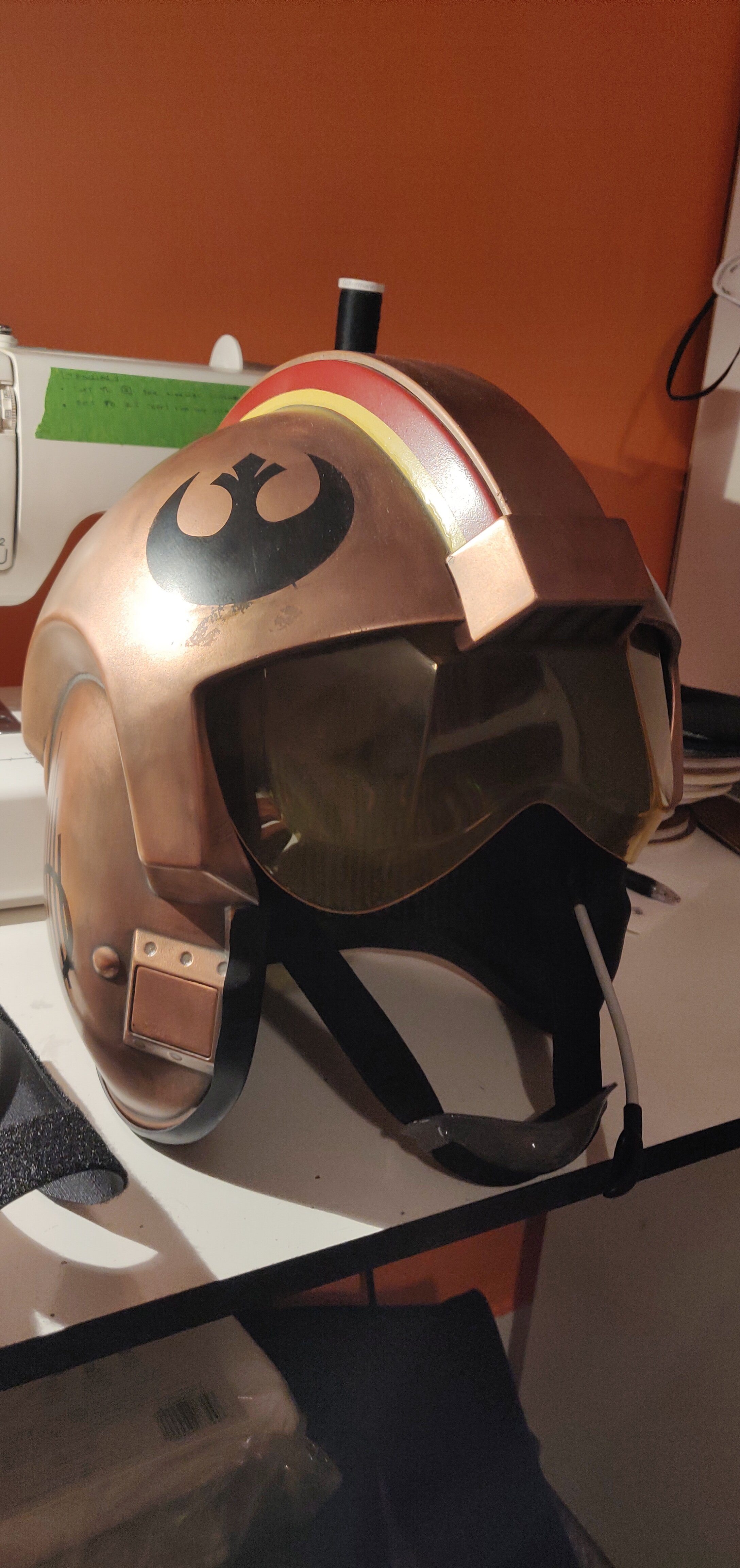

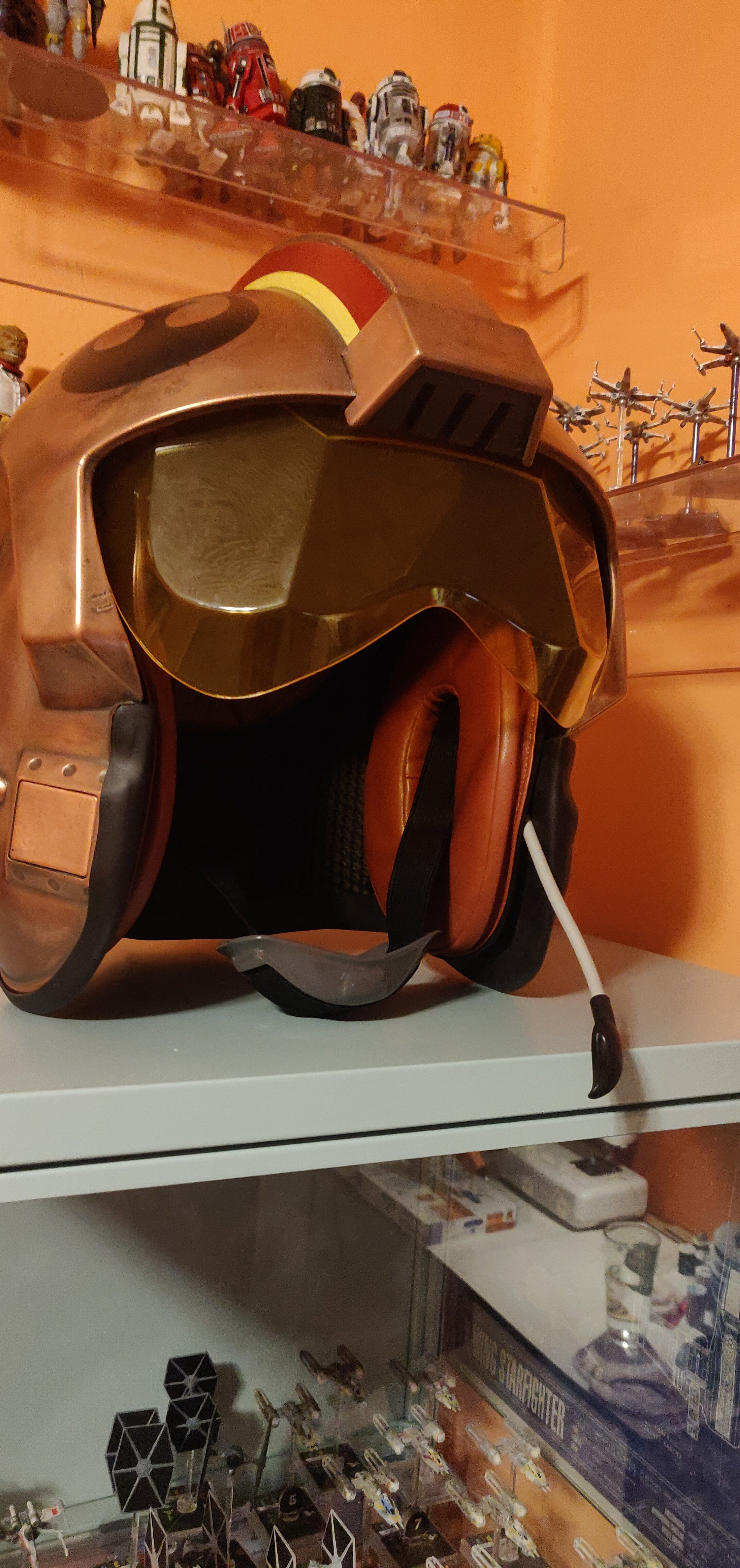

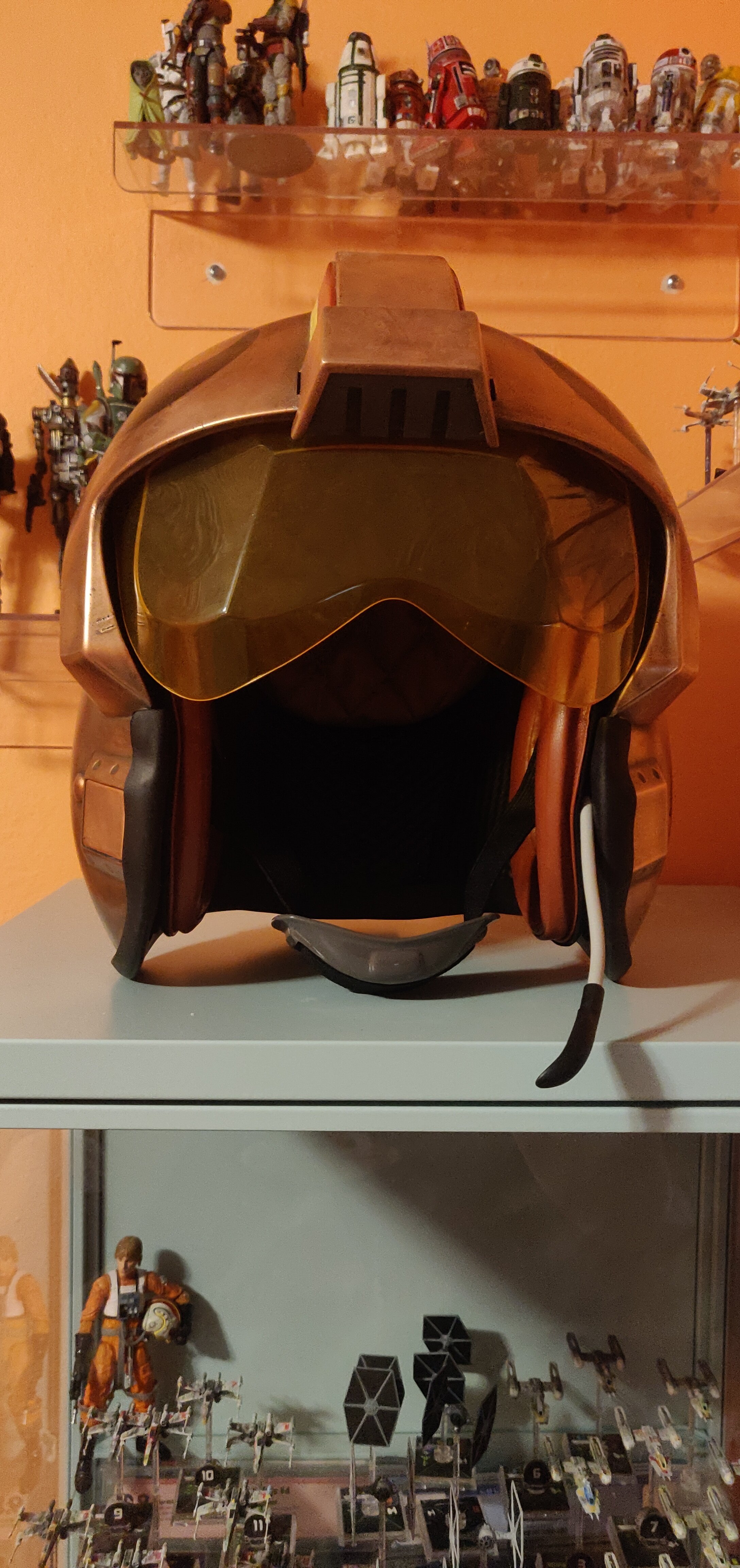

Alright - so, it's been a while since I've updated everyone on the Bayora Bronze helmet... Here it is! One thing to note on this: the Rebel starbirds and the commlink graphics (the "onion slices") are done with a darkening fluid to patina the copper to create the image, the only paint on this helmet are the stripes on the sides of the mohawk (and the chincup). The earpads are custom made by me, as well!

Man that looks cool! Thanks for the info on the paint. I’m familiar with this one but have hesitated to try it. Definitely going to order some now. Thanks again!
