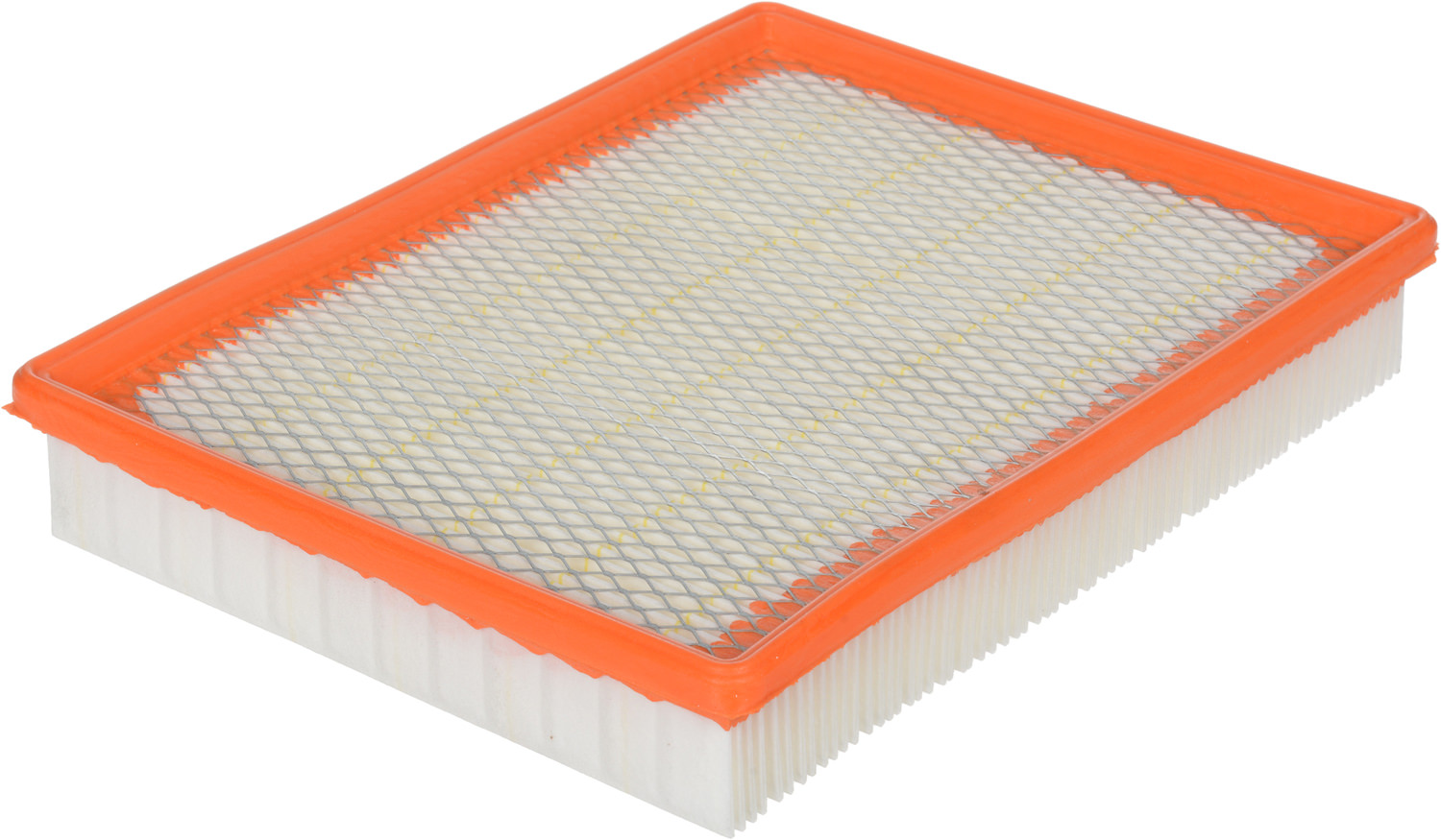

DarkLyte, I went with the metal grill off of a Fram engine filter for the mouth & chin vent. I spray painted it after cutting to size to prevent any rust from sweating like a pig in it since I wear the helmet

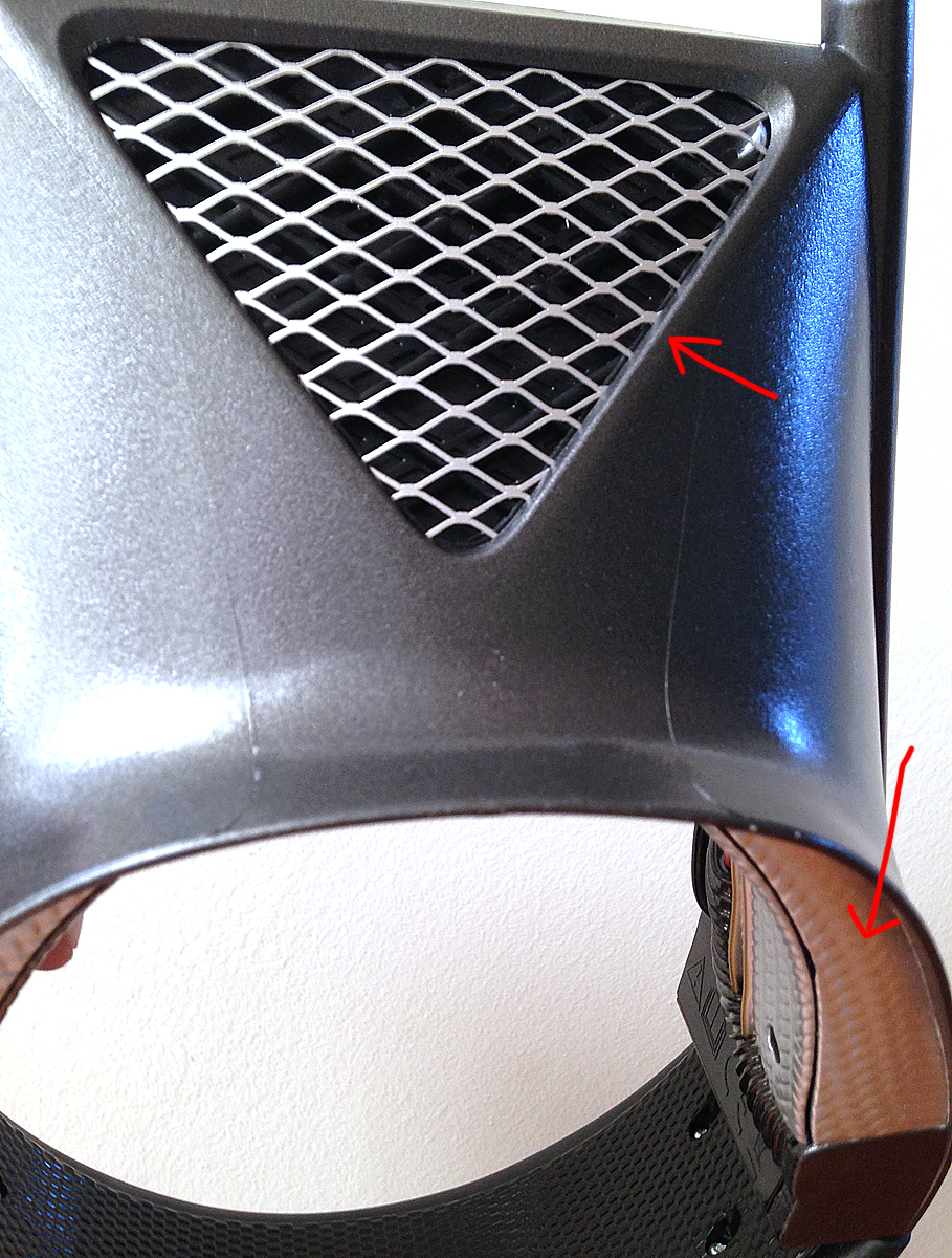

@DarkLyte (and every1 else, sup every1), I added the filter mesh to the mouth and chin, but didn't add extra behind it on the mouth since I was going to be wearing it and it gets crazy hot (so much so that condensation sometimes poured out the mouth like old man Vader was drooling *ewww), but if I was going to set it up for a display, I'd def put a 2nd layer of mesh behind it. I would probably go with some denser black screen mesh from a house window's window screen or screened-in-porch screen or speaker grill screen if I could find the right weave-pattern of it out there somewhere, that'd look good behind the metal filter mesh for sure, brother.
1st arrow: On the chin, I put the metal filter grill inside the chin hole from the inside, then on top of that I simply replaced the speaker junk (along with it's molded grill garbage) back behind it b/c I didn't want to scrap that bada$$ opening/closing/breathing sound efx. The extra thickness of the filter grill being added to the chin didn't hurt being able to close the whole neck piece back together either.
2nd arrow: Although no one would ever see this, I went ahead and painted the underside of the neck where it should have been painted silver like the inside neck area, since it meets up with it and is part of the same Vadery wiring-component thingy.

That looks fantastic! Gonna have to grab a Fram filter this week and make it happen. I have some styrene sheets on the way and am planning on extending the neck and flaring it out a bit. I’m debating on shrinking down the chin triangle for more of a ANH/R1 look as well. Not sure if I’ll go that far or not.

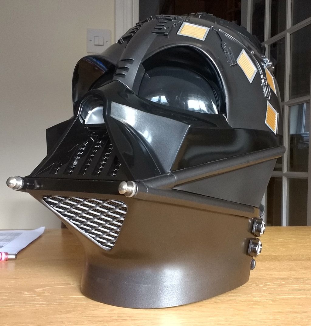

Great work so far DarkLyte. I thought about reducing the size of the lower grill myself but decided to just add some stainless steel mesh and metal tusks instead. I have extended my neck though by about 3/4" but didn't bother with any flare. The longer neck has made a huge difference to the overall look I think - it looks much more balanced now. I will have to repaint the lower section though - I used a diffrerent filler to my usual blend in the neck extension and, in the intervening weeks, it seems to have shrunk back a touch which has left a tiny line where the joint is. It only really shows when the light catches it but it's annoying me royally so I'll have to do something about it. I used a graphite colour for the two-tone. It looks a touch darker in real life than in these photos, but is just enough to remove the general 'blackness' that was the problem when filming ANH and which led to the gunmetal being applied in the first place.
My next job is to get some putty in the 'nose' to give it the proper concave curved shape, rather than the square-cornered recess that Hasbro gave it, before getting some silver paint on it.
I'd very much like to redden the eyes too and am experimenting with things at the moment as I'd like to retain the clarity. One method that looks promising on some test perspex is airbrushed Tamiya Red Clear followed by a few coats of Klear (Future) floor polish to restore the clarity.

Your earlier photos of your next extension are what motivated me to do it on mine. It's crazy how much it adds to the balance of the helmet as you said. Yours looks fantastic! The paint job on yours looks great as well.
Did you use the Fram air filter mesh on yours as well? Where did you get the smaller mesh for the mouth?

Yes, it's a shame Hasbro made the neck quite so short - that extra bit makes a massive difference to the overall effect.
I knew about the Fram filter mesh but didn't use it. I got mine from a supplier here in the UK called The Mesh Company (there's a definite lack of imagination with that name!). It's expanded mesh so isn't flat like the Fram stuff but does seem to match the mesh used in at least one Vader helmet I've seen in exhibition photos. The chin mesh is a 16mm x 7mm expanded steel mesh which I cleaned and polished before dipping it in Klear (Future) to stop it from rusting. The mouth mesh is a smaller 10mm x 5mm aluminium mesh. I haven't done much with the mouth yet (other than cut the mesh to size) but I backed the chin mesh with an offcut of steel hex mesh left over from my Rubie's Stormtrooper helmet project. I'll probably do the same with the mouth.
