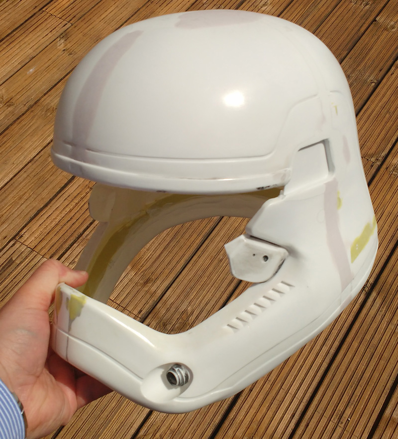

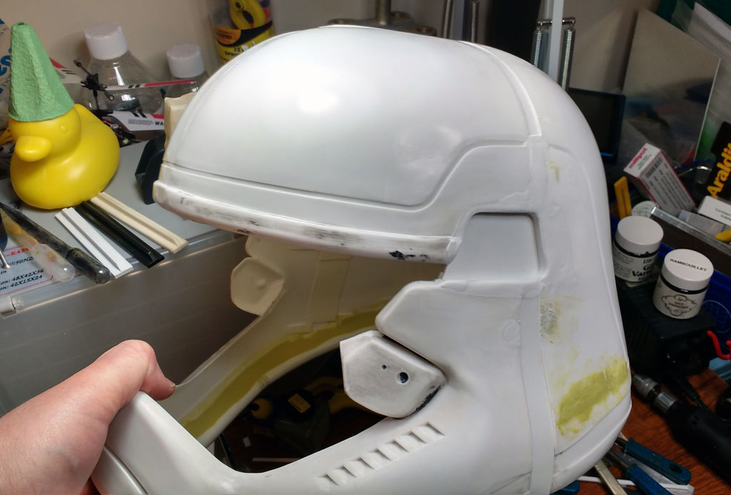

Here are a couple of pics as things stand. It doesn't look hugely different from the last time but I have done some work on it..honestly!
I wanted to beef up the bottom edge so I took some 10mm diameter ABS rods, heated/shaped them to fit around the bottom edge and glued them on. I backed that up with some Milliput (2-part epoxy putty - the yellow-green stuff in the photos) and I now have a solid bottom edge which holds the whole thing rigid. I plan to build the bottom up further with more Milliput now that I have a solid base to work on.
Most of the gaps have now been plugged with plastic sheet ready for filler to smooth things out. Next job is to sort out the 'temple' area.
The random looking strip of plastic on the very top of the helmet is where I'm starting to build up some extra plastic to round off the crown. At the moment it's too square - both as a result of my cutting and patching and because the original Rubies shape was not rounded enough.
Overall the dimensions are much closer to actual size now I think so I'm pleased with the way things are (slooowly) progressing. :)Rubies-mod6.jpgRubies-mod7.jpg

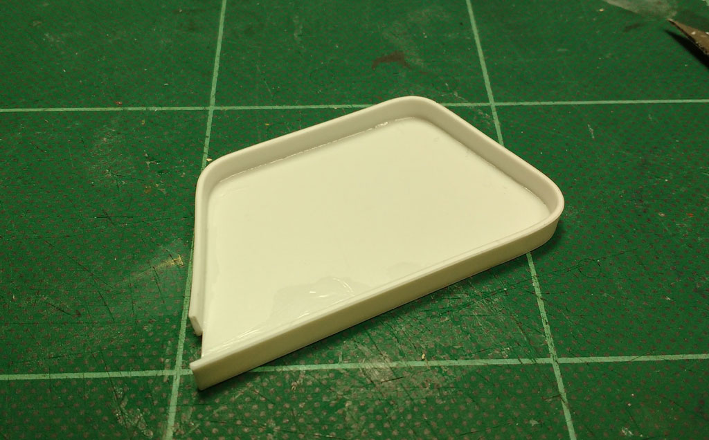

Been doing a bit of work on the 'temple' area which was a complete mess after my cutting and chopping!
I made a couple of 'trays' the correct size/shape for the black trapezoid area then glued them in place. I then packed the area around them with Milliput - white this time rather than the yellow-green stuff so I can get a better impression of how things look. It's really transformed the look of the thing so I can't wait for it to harden so I can sand it smooth.

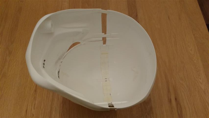

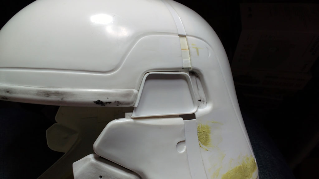

A bit more progress. Filler applied to the sides and crown where my 'stretched' sections are. Sanded and smoothed.
I've also built up the bottom edge with Milliput to extend it and to curve it under a touch. The original Rubies helmet had no return on the bottom edge at all. It's had its first sanding but there's lots of dimples to fill and wavey edges to tidy up yet. The Milliput has stiffened the whole things up and given it a bit of weight. It's feeling a bit less like a plastic flower pot now!
Next job is to fill the moulded-in joint running above the brown, over the 'temples' and round the back. Its too wide so I'll fill and re-scribe it in due course.
It's never going to be 100% accurate (which was never my intention) but it's starting to look quite nice now. :)
