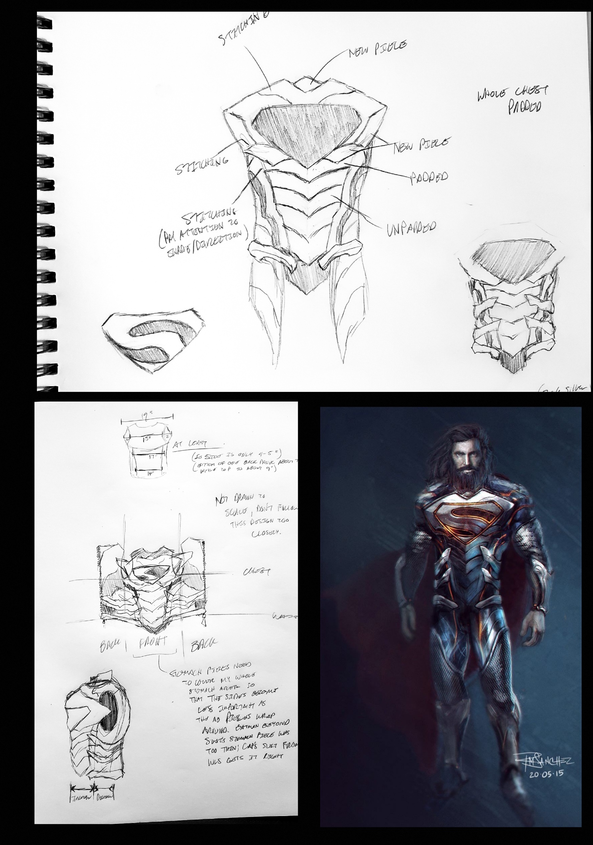

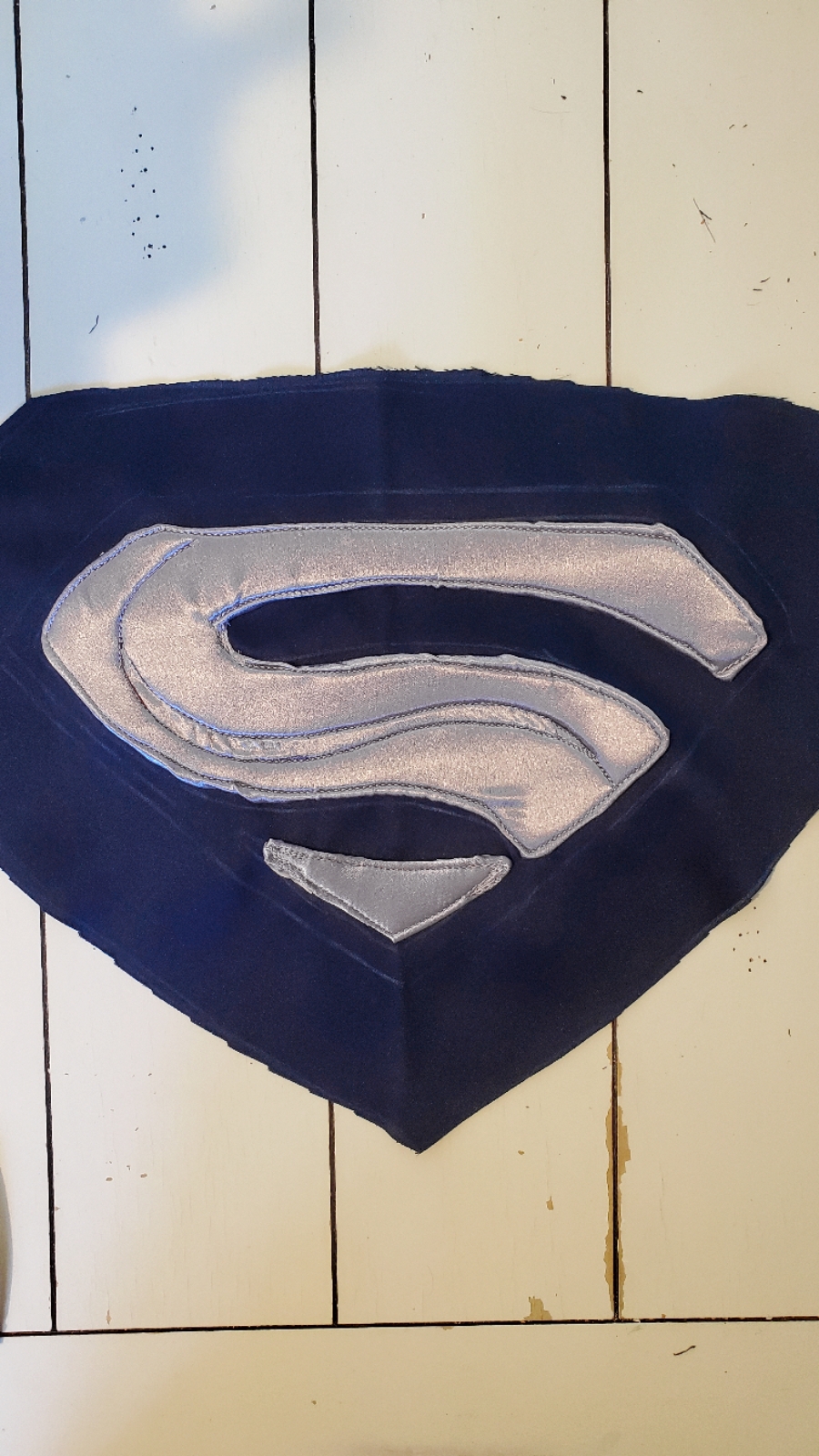

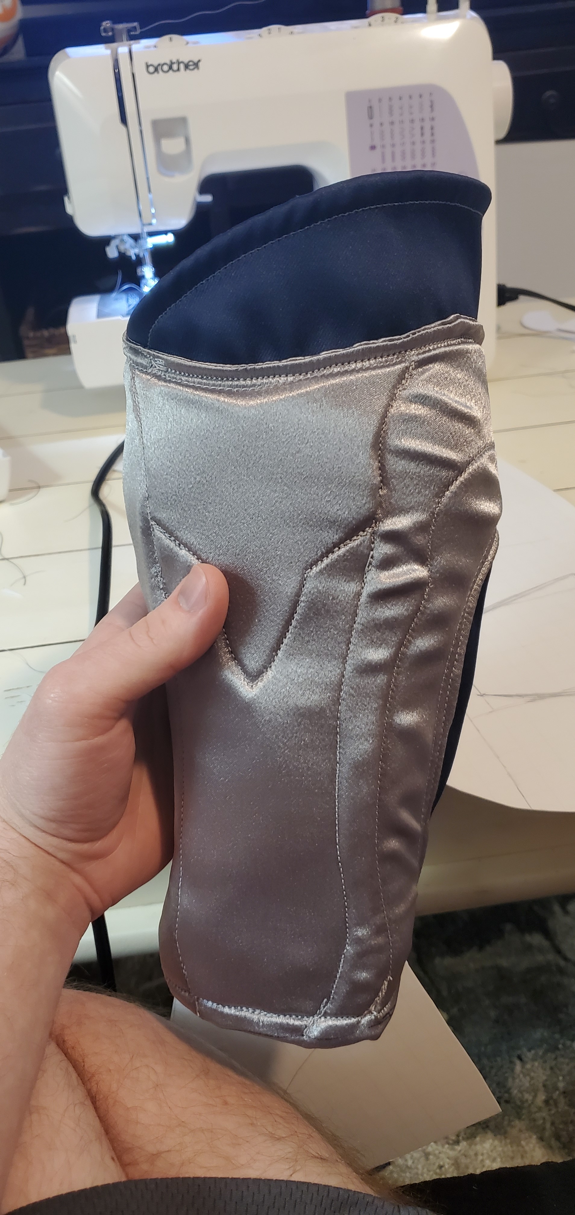

Attached are pics from an unfinished armored Superman build I did a few years back. It’s made with metallic polyester fabric from Hobby Lobby, and thin craft foam inserts (not the thick kind that is usually used for Iron Man suits, but not the weak paper-thin stuff either).
I drew templates myself on poster paper, based on an awesome artwork I found online. Then I traced the template shapes 3 times: 2 copies on the fabric (plus seam allowance), and one copy on the foam. After cutting it all out, I’d sew together the 2 fabric pieces, flip them inside out, and insert the foam piece like a letter into an envelope. Finally, I’d finish it off by topstitching around the edges. The pieces all held their shape very well, looked and felt just like armor. But with great flexibility and comfort. Heat wasn’t an issue either, because the armor wasn’t tight and had air gaps between some pieces.
I’m proposing a similar method for Iron Man, using foam Pepakura templates for design accuracy. But all the tracing, cutting, and flipping inside out took forever on the Superman suit. Plus, the sewing became very finicky at times. And the armor did show a lot of wrinkles. So I’m looking to slightly improve this method.
