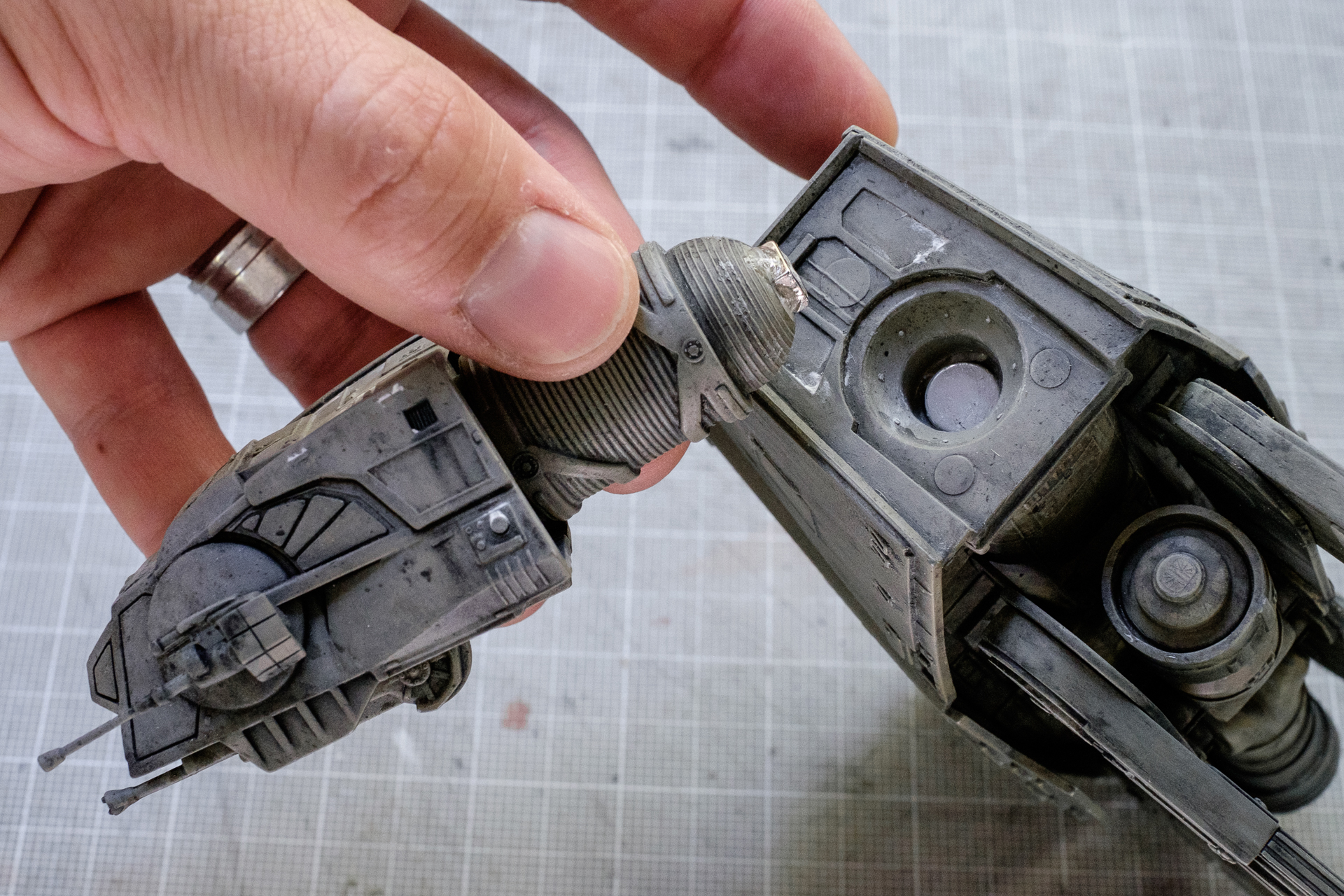

I don't like the kit's rubber band method for attaching the head. Someday the rubber band will break and it would be a pain to replace. I decided to use magnets so the head could still be re-positioned, or simply removed if I want to make changes or repairs. My LHS has lots of magnets in different sizes and these worked well:
I had to saw off a little of the neck on either end for clearance, and then I just used super glue to hold them in place.
Helpful tip! Make sure your magnets are properly aligned BEFORE gluing them in. I suggest marking the sides that will attract each other with a Sharpie. I didn't and I glued one magnet on in with the wrong orientation and the head was repelled by the neck. Duh. That was a pain to change because super glue really works, and super glue remover will strip off the paint. Ask me how I know... :rolleyes

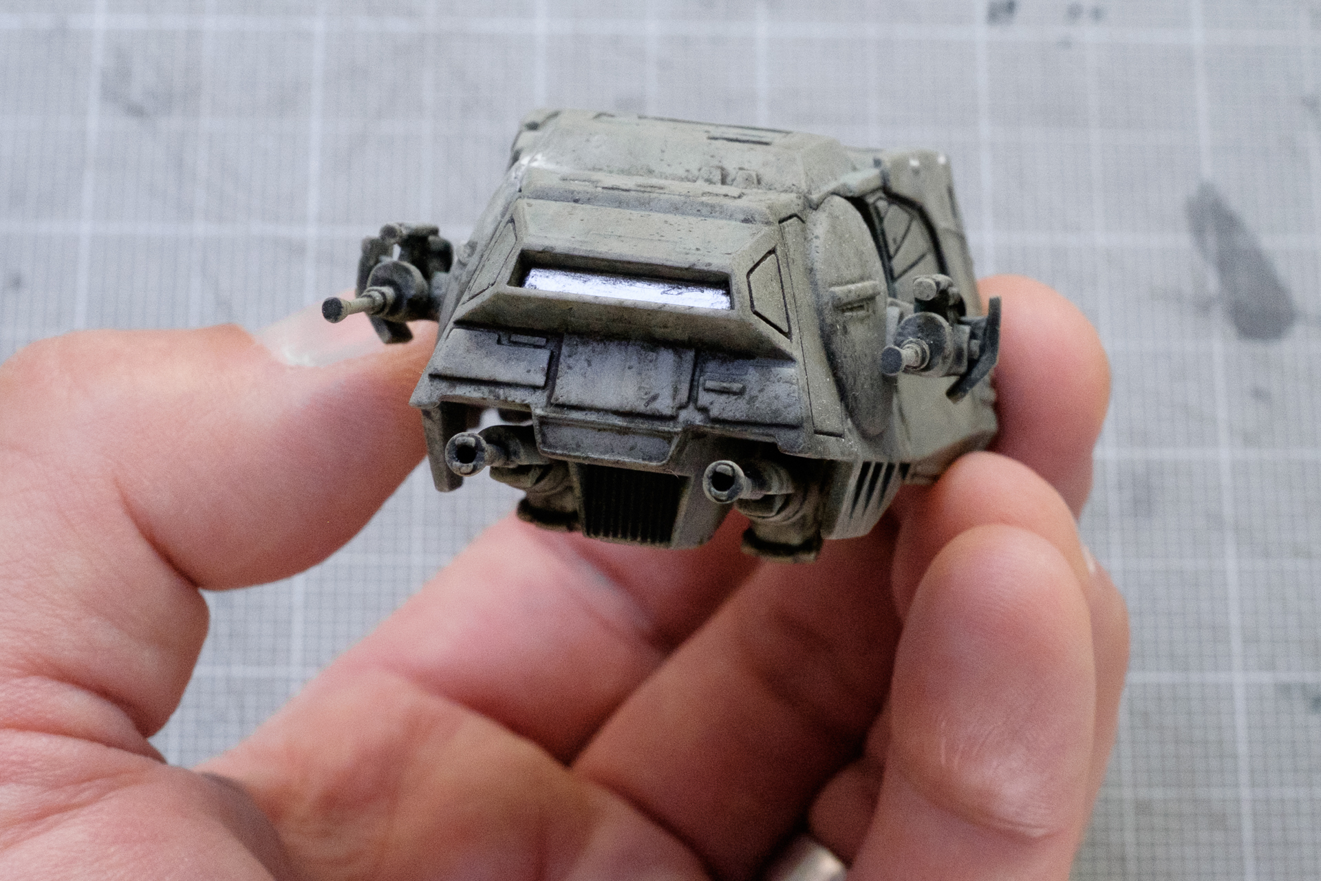

And one other thing that I think worked pretty well. What's the best way to do cockpit glass? I was planning on painting clear gloss over black or maybe even red (there's only one shot in ESB where a Walker has a red illuminated window. It's the first hero shot of them approaching. Did they give up after that because the lights were battery powered and they caused problems during animation? I'm curious if anyone has any insight.)
I saw a tip in an AFV modeling magazine that suggested using a pencil to give glass ports on a tank a reflective sheen, so I tried it on the Walker:
I think it's pretty effective, and it's really easy. The only tip here is not to rub too hard with the pencil or you will scratch away the underlying paint. I did that a little bit but I think it just made the port look like it had taken a hit, so I'm okay with it.
Looking at this photo I can see I should have drilled out the barrels of the cheek guns, but when I was gluing them to the head I hadn't yet gained enough confidence to do it correctly. Now I think I could and it would look better.
Also notice the color variations on the head. In this case it's mostly because of ambient light. There's green light bouncing off a nearby table and blue light reflecting the sky. It's really important to control the light hitting your model when it's time for the hero shots, which these aren't, so I didn't really care.

A couple more details...
