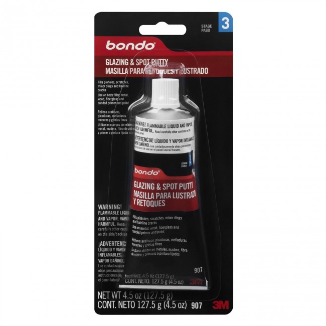

For filling gaps, I use Bondo spot putty. It does shrink a little when it dries but I really like how well it sands and files. I haven't tried the surfacer products or what Tox recommended so I can't compare. Bondo is just what I'm comfortable with. Here's an image of what it looks like and can be found at Walmart.
Instead of the red Bondo spot filler (which is really too runny for many modeling applications), try the 3M Acryl-White Glazing Putty (available through many outlets, including Amazon as seen HERE) Not only is the consistency superior, the fine grain of the compound allows for trouble free polishing and engraving plus the lacquer-base provides superior adhesion to polystyrene plastics. I have been using this for years (previously as the blue tinted version, Acryl-Blue) and can vouch for its performance for filling fine seams, scratches & depressions. Like all 'spot putties' it is not intended for large-gap bridging or contour work, which is best done with 2-part epoxy products that have a much higher structural strength.
Although the Bondo brand is also made by 3M, it is not the same formulation as the Acryl line of putties. Plus, the 'red' seems to suffer greatly from 'settling' in the tube, so if it has be 'on the hook' for a while in the store, you might find (as I did) it coming out as a pure liquid!
One other note: CA & filler combos (such as talc or - best! - Microballoons) do set immediately & only get harder with time. So sand it right away.
Regards, Robert

^^ Thanks for the comments and the tips, Robert. I really appreciate hearing what works from the people who know what they're doing. I'm heading to the Amazon page now to get some 3M Acryl putty.

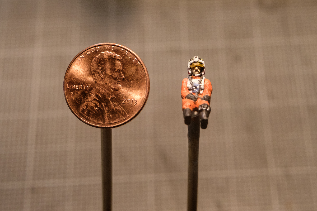

I will make another post shortly. I solved yesterday's problems by throwing out dozens of old tins of Humbrol enamels that had turned to gunk. I like them for brush painting and haven't had luck painting with any of the acrylics. I watched some tutorials, read a bunch of FAQs, and decided to try the Vallejo Model Colors for brush painting.
So far the learning curve hasn't been too steep. It's taking some time to think in terms of building up thin layers of paint, but I hope I'll eventually be achieving more realistic results from my brushwork. I painted the X-Wing pilot for my 1/72nd scale Fine Molds kit. I tried to make him look like Biggs. I really should have picked something bigger to learn how to use these paints!
As long as you don't magnify it too much it gives the impressionistic idea of Biggs. It will never be seen as clearly as this through the plastic of the tiny cockpit. I still need to figure out the right techniques for working on something so small. It doesn't help that my hands aren't the steadiest, so at this scale it's like trying to paint a moving target!

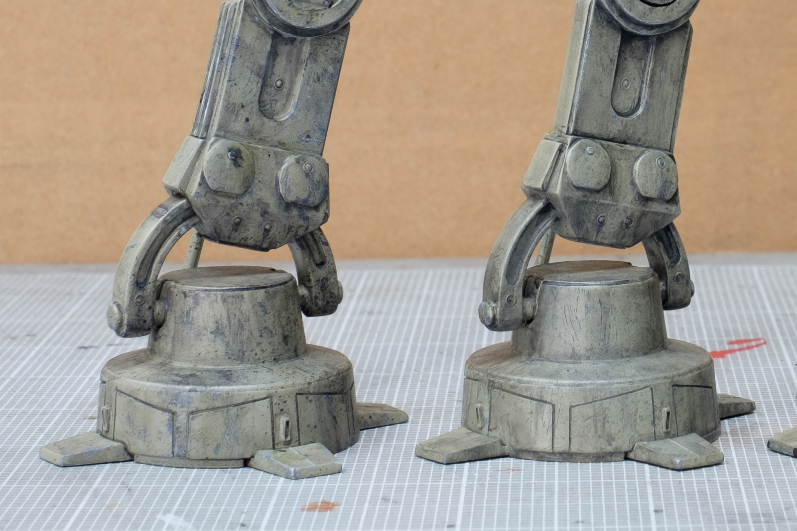

My favorite detail:
I was waiting to see if anyone noticed one particular detail I added to the kit. No one has mentioned it yet so I’ll just go ahead and post about it. See anything unique about this shot?

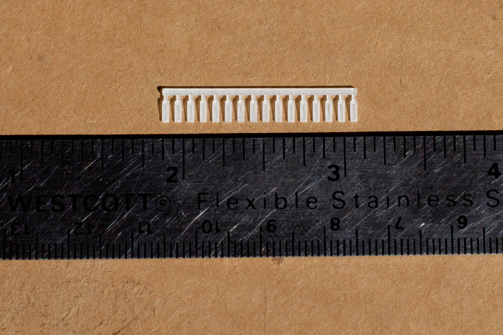

It’s the tiny Flakvierling parts above each “toe”. I hadn’t planned to include them, since I didn’t think I could manufacture something so small. However, fellow RPFer and resident AT-AT expert and computer modeler, Dragnink, offered me a way to get perfectly scaled Flakvierling parts. I traded some stuff with Matt for a file that he’d compiled, that I then sent to Shapeways, and here’s the result of that:
These things are tiny! And they’re perfect. Matt has modeled the part beautifully and they came out perfectly. The Shapeways order page said they were too small and wouldn’t necessarily print well, so I had to check the “Print Anyway” box and hope for the best. They were all flawless.

If I ever build another one of these (hopefully Bandai will come out with an accurate kit and I won’t have to worry about that) I’ll shave off all the oversized Flakvierling (it’s such a fun word to type!) parts and replace them with Matt’s printed parts.

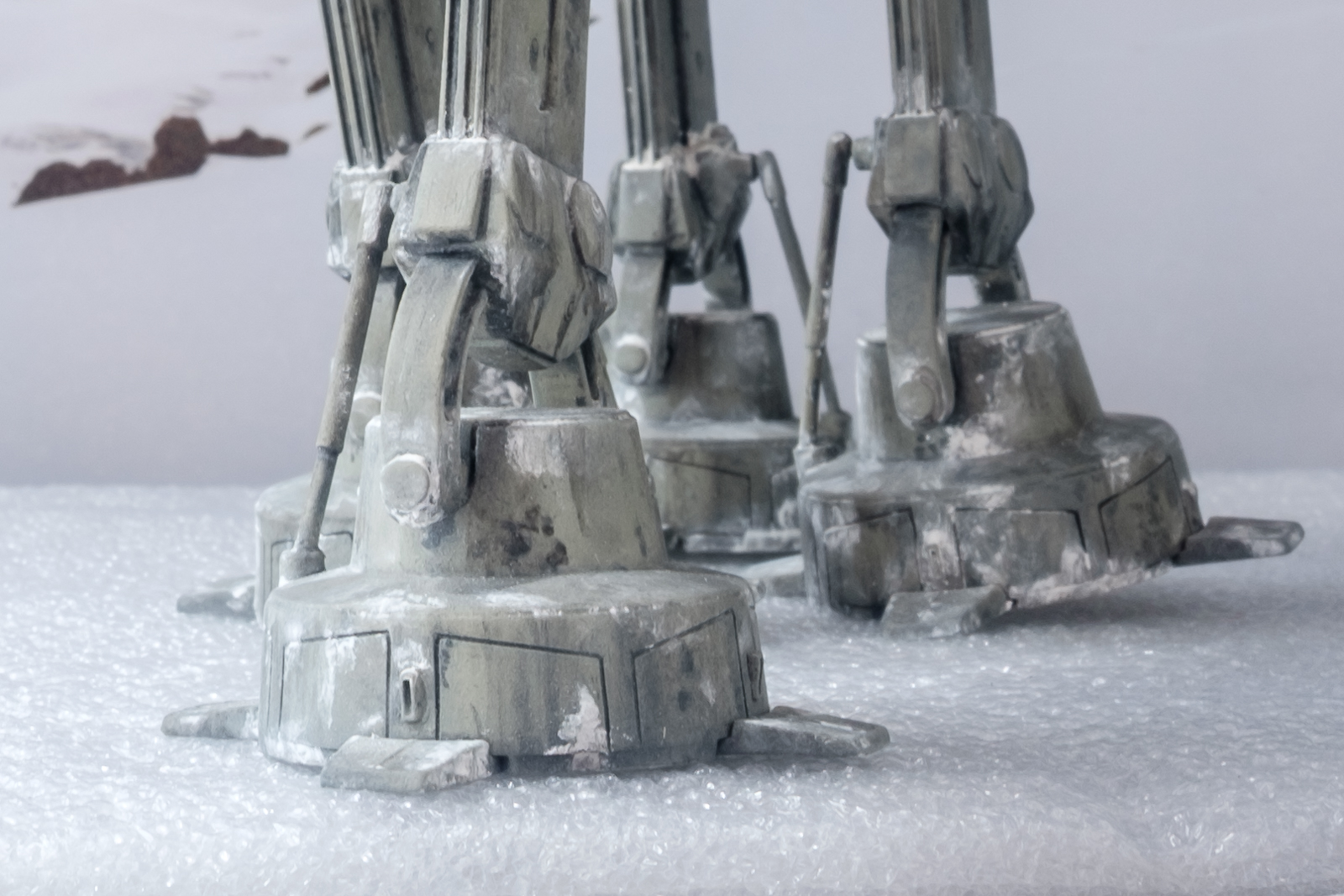

I think they really add to the feet, which were sorely under-detailed to begin with. Here’s another look at the final result, this time with snow added, (which I’ll get to in the next post).

So thank you, dragnink, aka Matt Riegel, for the cool parts and for making my MPC AT-AT look that much better. And thanks for the very kind words in your earlier post about this thread.
