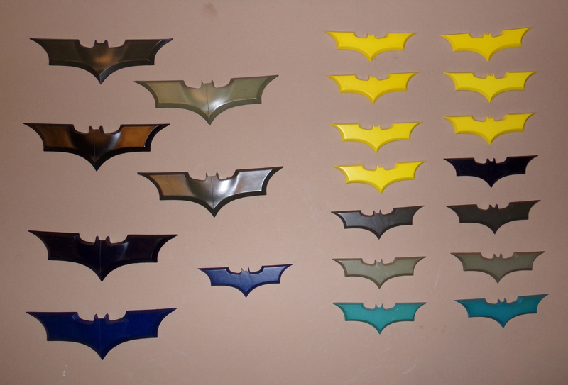

Lightslinger, do they have to be Batman Versus Superman batarangs? I have 21 plastic Dark Knight batarangs that you could have. I was experimenting with colors curing processes and made a bunch just playing around. I've attached a picture of them. Let me know if you want them, it's for a good cause... children should have Batman toys...
