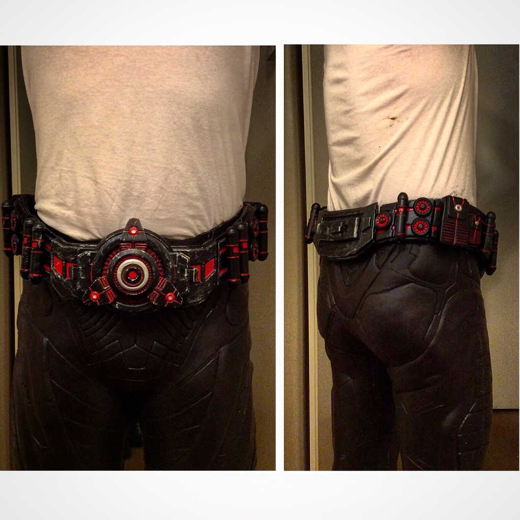

Batman Beyond-based on art by Mark Vick

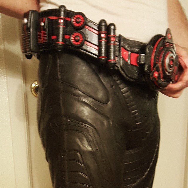

Right side of the utility belt finished
Sent from my iPad using Tapatalk
That belt came out amazing! I still can't wait to see the whole thing together. This build so far is awe inspiring! :D
Man, this is looking SWEET!!! LOVE the belt! I CAN'T WAIT to see the upper part of the suit molded! This is going to be SO KILLER when this is all done & put together!!! AWESOME JOB!!!:thumbsup

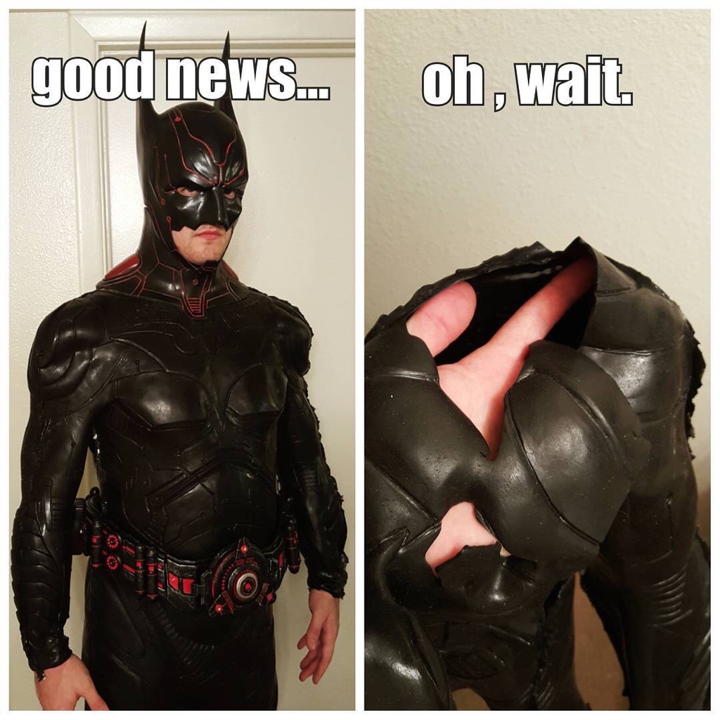

Bad news gang. After having what I felt as a successful cast from the upper body mold, I was wrong. After I removed the rubber from the mold, I trimmed off a little flashing to see how it all fit. Aside from padding the shoulders and a few other places, it fit! Then as I was trying to take it off, a weak spot in the arm that was not reinforced, tore and went all the way up the shoulder. Needless to say, I was upset. So unfortunately I don't have the money right now to finish it, nor the motivation either. Sorry.
