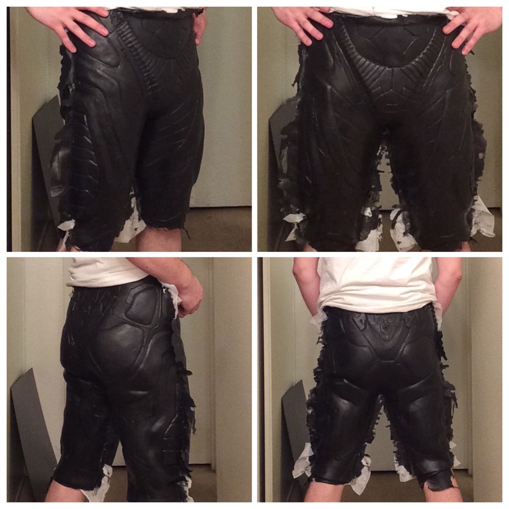

So when you're finally about to put this stuff on, will the silicone stretch enough to go over feet/knees etc or do you not think there will be any of those issues? Cant quite see the width of things accurately obviously. Great work - cannot wait to see the first pull being detailed up
The silicone will have enough stretch no problem. The lower half will be like a pair of pants but attached to a spandex undersuit... like wise with the top. Knee pads will fill the gap between the boots and the thigh

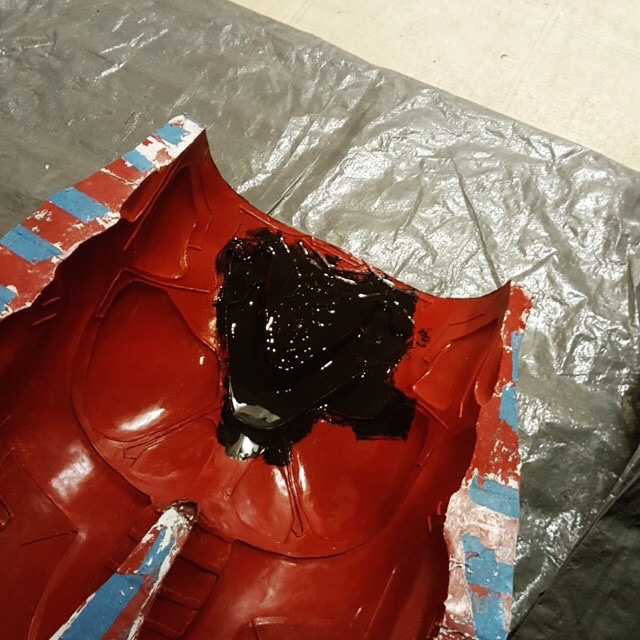

Doing a test patch of dragon skin silicone. This way I can check the finish and how thick or thin to make it. Now I have to wait 4 hours

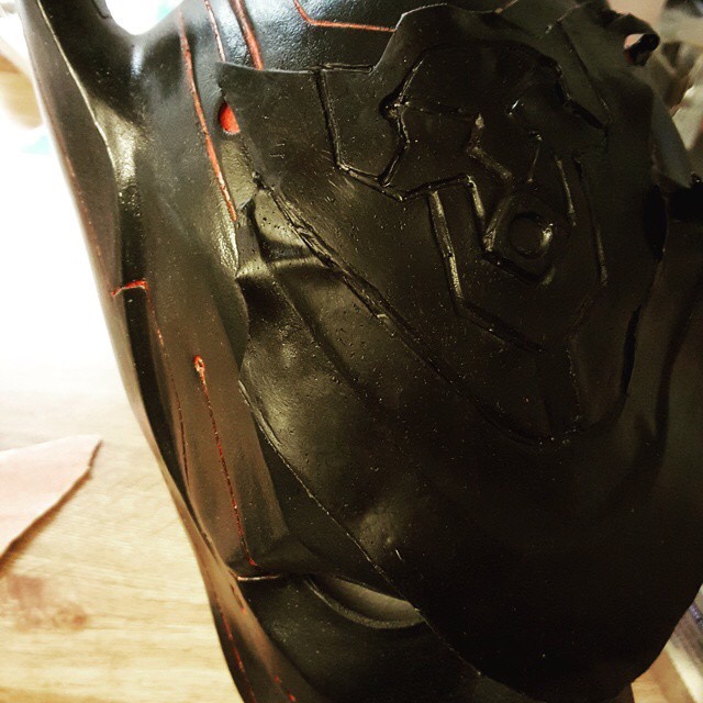

The test patch was a success! Laying the swatch of cast dragon skin over the cowl for comparison. The color is about as close as you can get, the texture is nearly the same. I learned how thick I'm gonna need to make it now. So next week Tuesday when I have a day off, I think I'll attempt to cast the lower half.

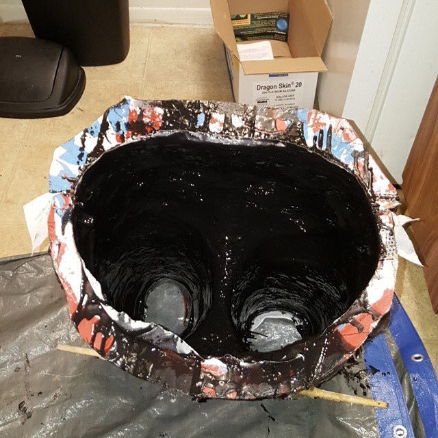

Well the lower half is cast... Cross your fingers that I made it thick enough and that it comes out. Hit it with a heat gun but I still wanna wait the 4hours to be extra sure it cures.
