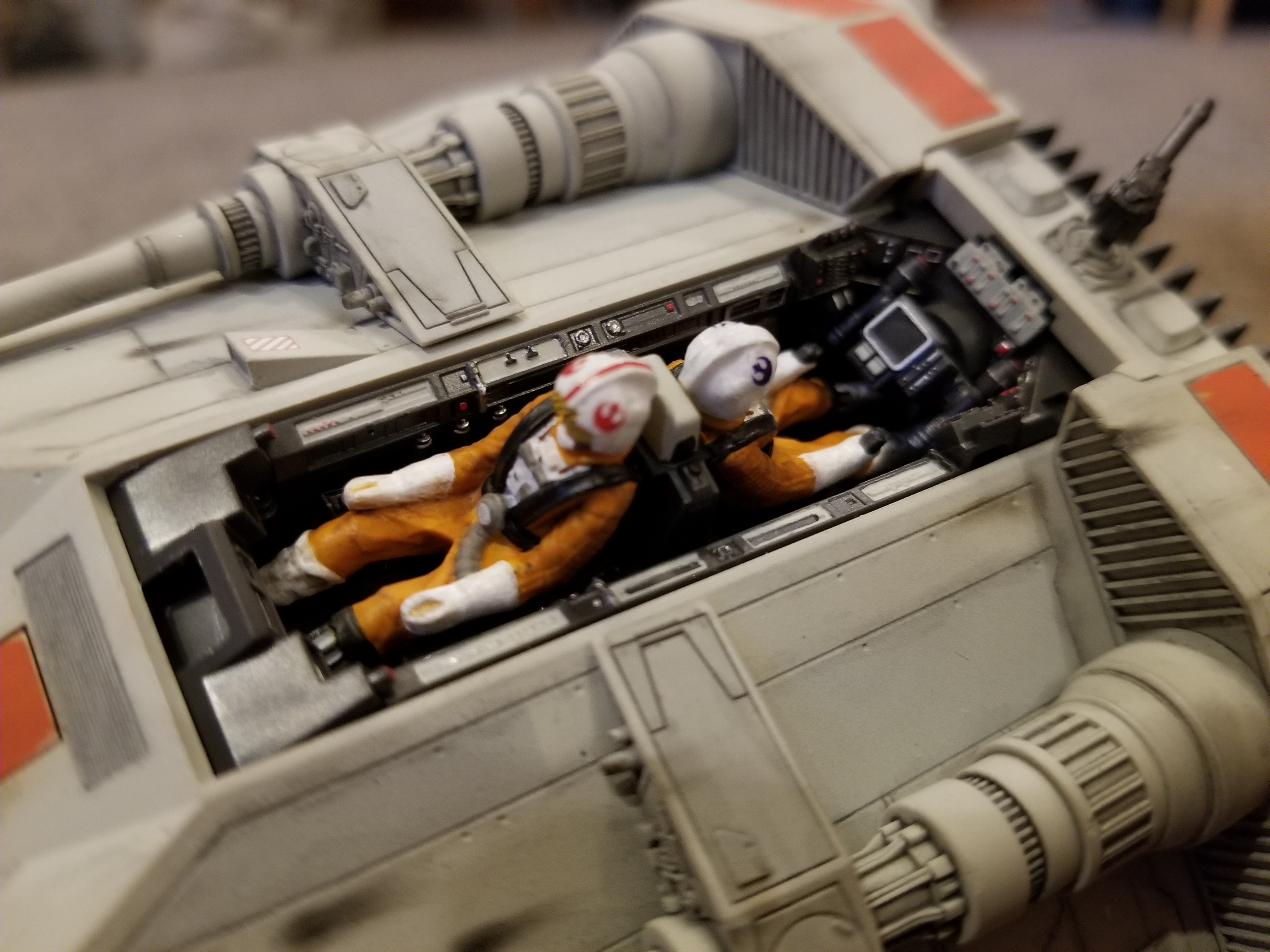

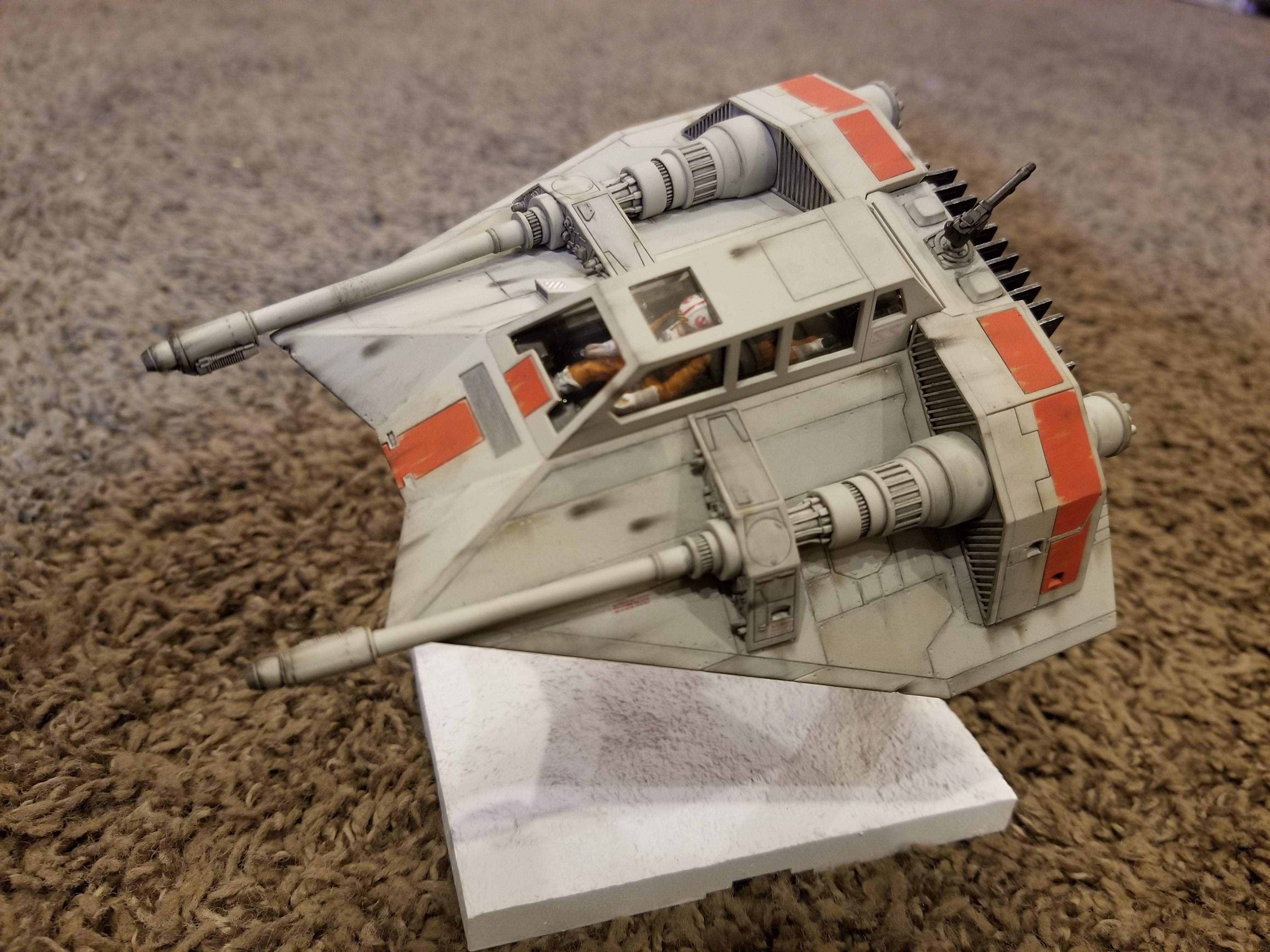

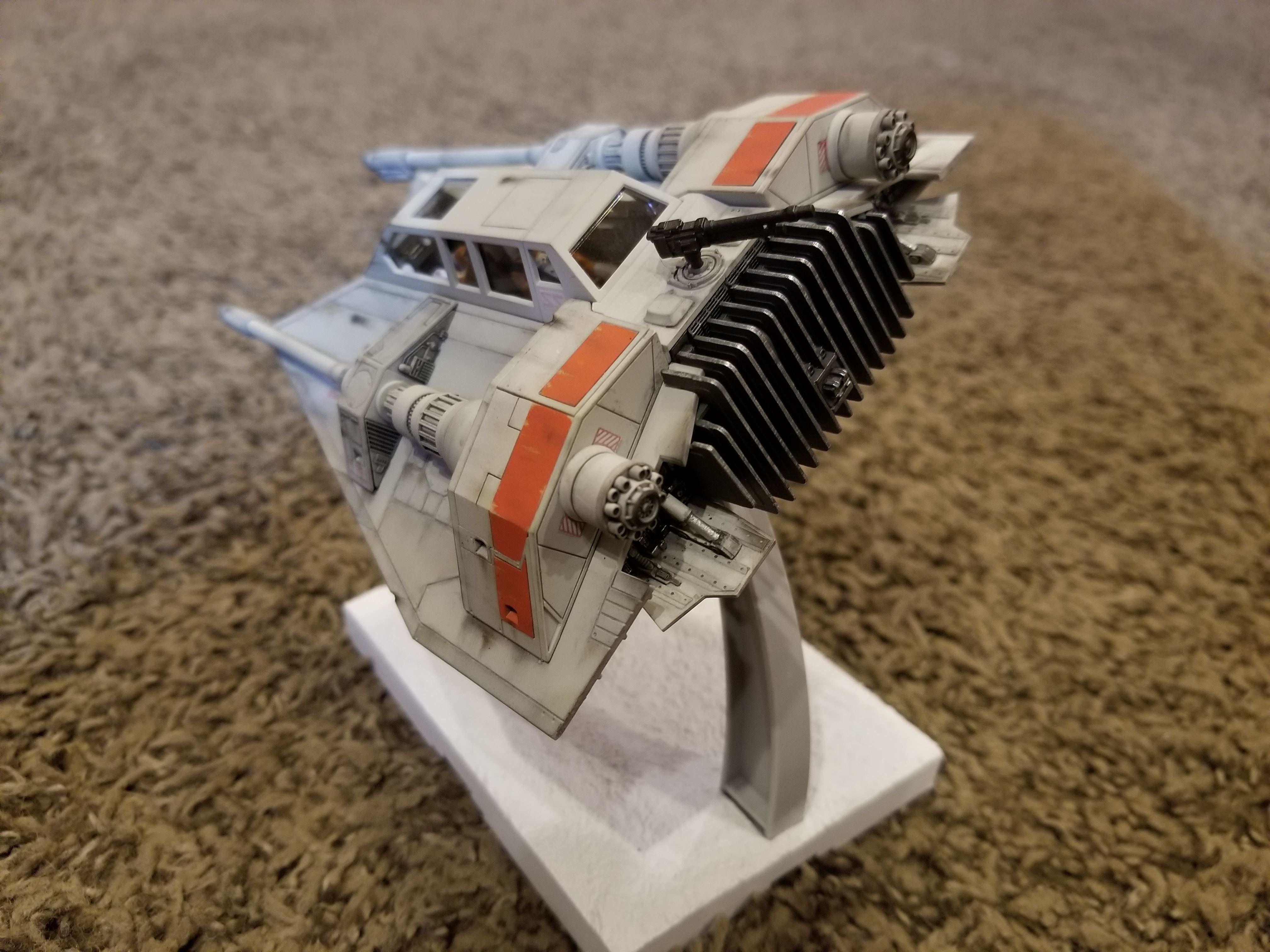

Hey all! I normally hang out in the prop side of the forums, but just "finished" my first model kit since I was a little kid, and thought I'd share what I've got so far and see if anyone has tips on how to improve it (or just advice for me moving forward).
I'm really happy with what I've got, but I'm sure there's plenty of room for improvement. Especially when it comes to decals - I just applied them before airbrushing dullcote over the whole thing, and they ended up lighter than the surface around them...
Also any advice on how to get acrylic paints to adhere to the plastic would be amazing. I used model master since it's already nice and thin for airbrushing, but it's extremely non-durable. Maybe I should prime with a enamel first, then I could use acrylic over that?
Anyway, here she is:

Looks great! So you used the exterior decals but painted the cockpit?
Yep! I liked the realism the text and "hazard stripes" added, but I didn't at all like the decals on the inside. And maybe that's because I don't know how to properly apply decals; For me, the decals just sit on top of all the interesting 3D controls, and so give them color but no depth. Seemed kinda pointless. but if there's a way to get decals to get more flexible and form around those intricate details, I'm all ears!

Awesome job. I prefer to paint panels like that too, even if it ends up less sharp. The decals never look real to me.

MicroSol will 'melt' the decals over complex surfaces. I, however, agree with Scarecrow Joe. The only exception is the many tiny decals that are little words, etc like on the Falcon. Any interior detailing I hand paint.

I too like the look of painted details over decals for the interior. It just takes longer :) But you don't get anything good without working for it...

Nice work on the model, it looks great!
