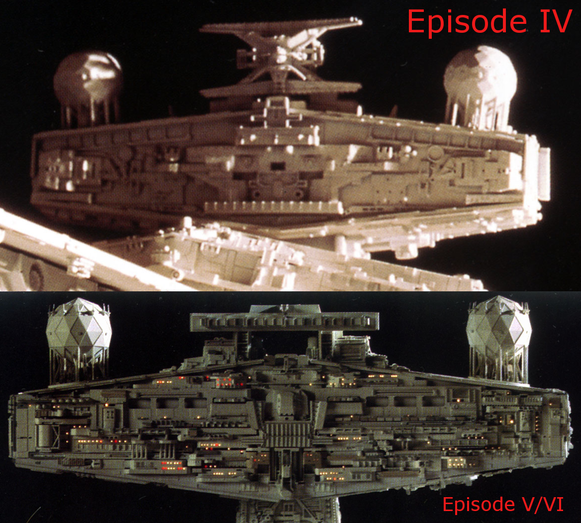

I would love to see them option out the different towers, like ESB or ANH, and I would especially like to see the upright "whatever you call it" between the two deflector balls as seen in 1977. I always liked that that element kind of had a samurai feel to it.
That "X" shaped antenna is on both versions, it's just laid down flat on the ESB.
And of course a few other differences. The shield generator globes are angled on the ANH and completely vertical on the ESB. The ESB also has the famous SF on the bridge!
