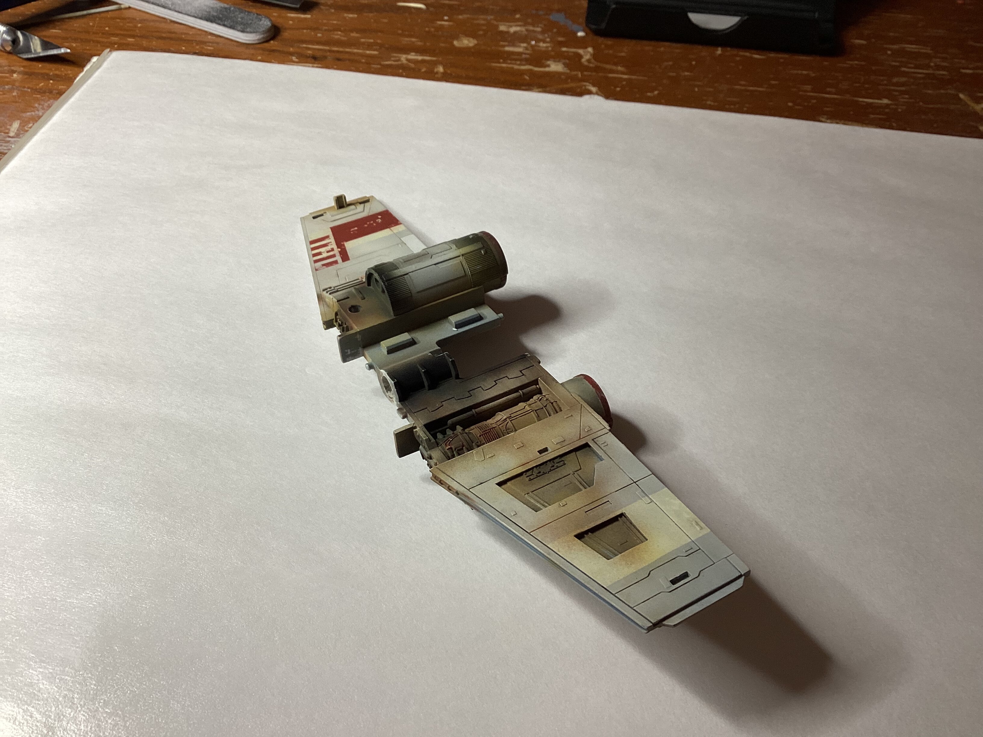

There are 5 major groups of 'attention areas' to watch out for.

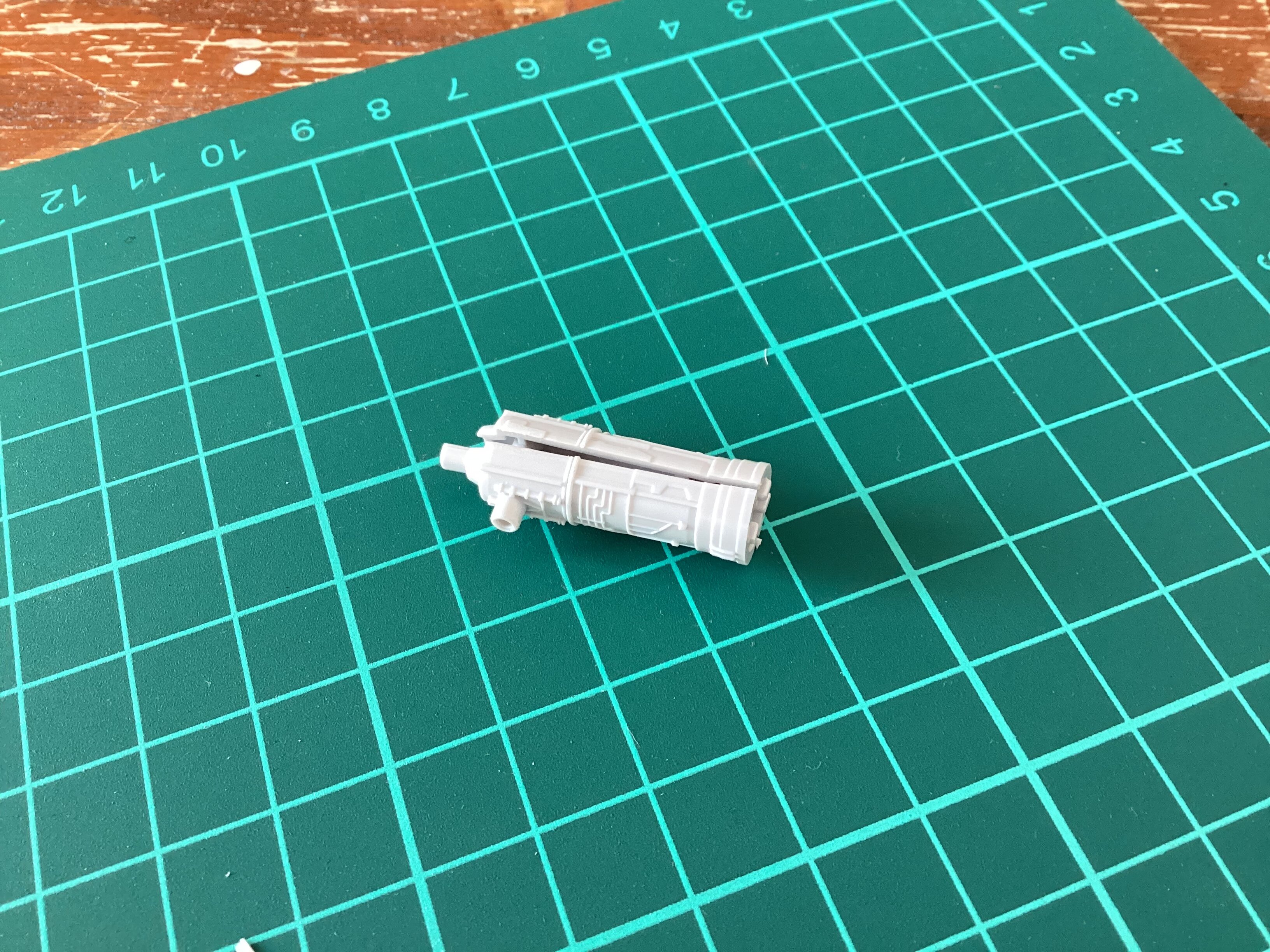

1. Each of the engines has a seam.
2. Each of the guns has a seam.
3. The gun tips should be drilled out so that they don't look like solid rods. I drilled in approximately 1 mm for each tip.

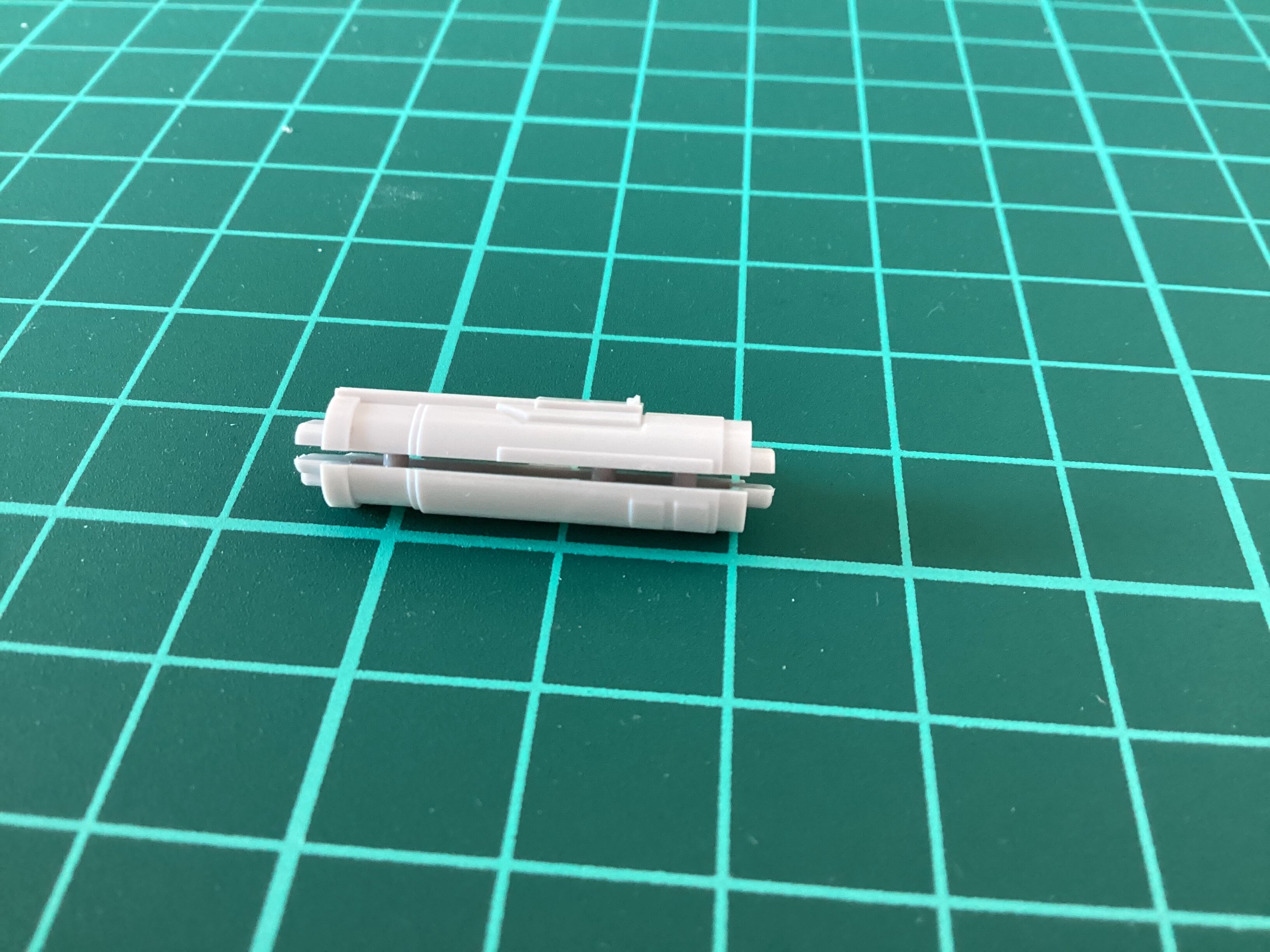

4. Each of the engine intake cowls has a seam when assembled. They are easily corrected with putty.

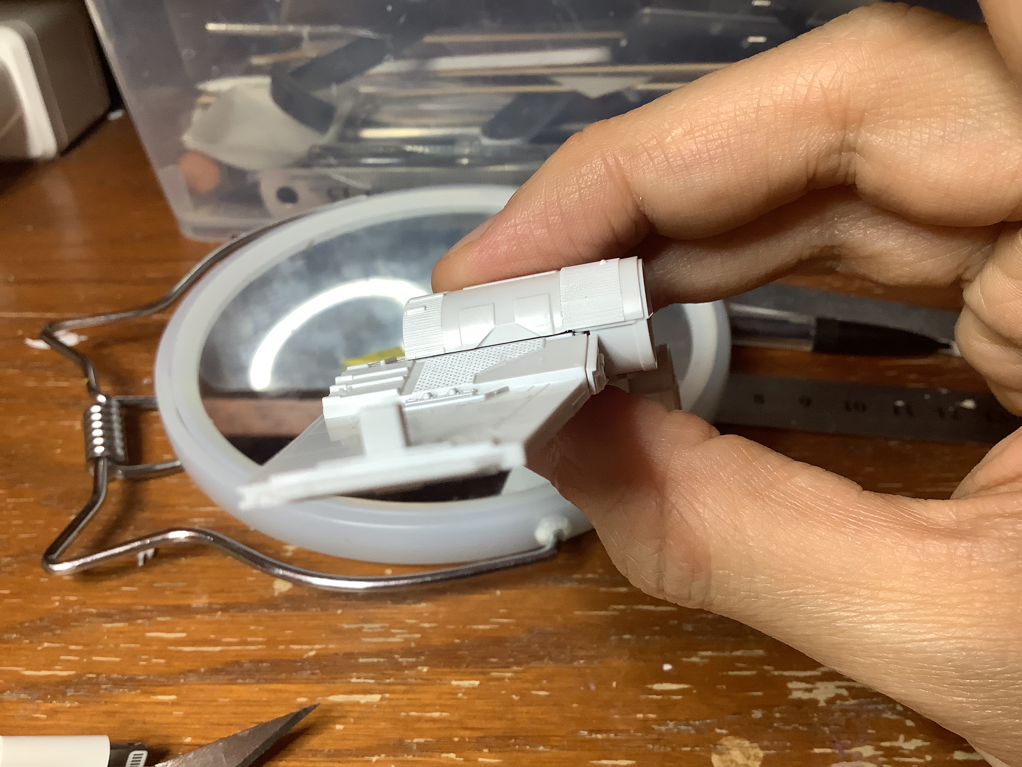

Item 1 and 2 are difficult to correct because the parts are small and there are tiny features in the way. I ended up putting on multiple coat of Tamiya extra thin cement to 'anneal' the seams. Then using an exacto to scrap the seams flat. Finally I used some fine sandpapers held in tweezers to sand the areas flush.

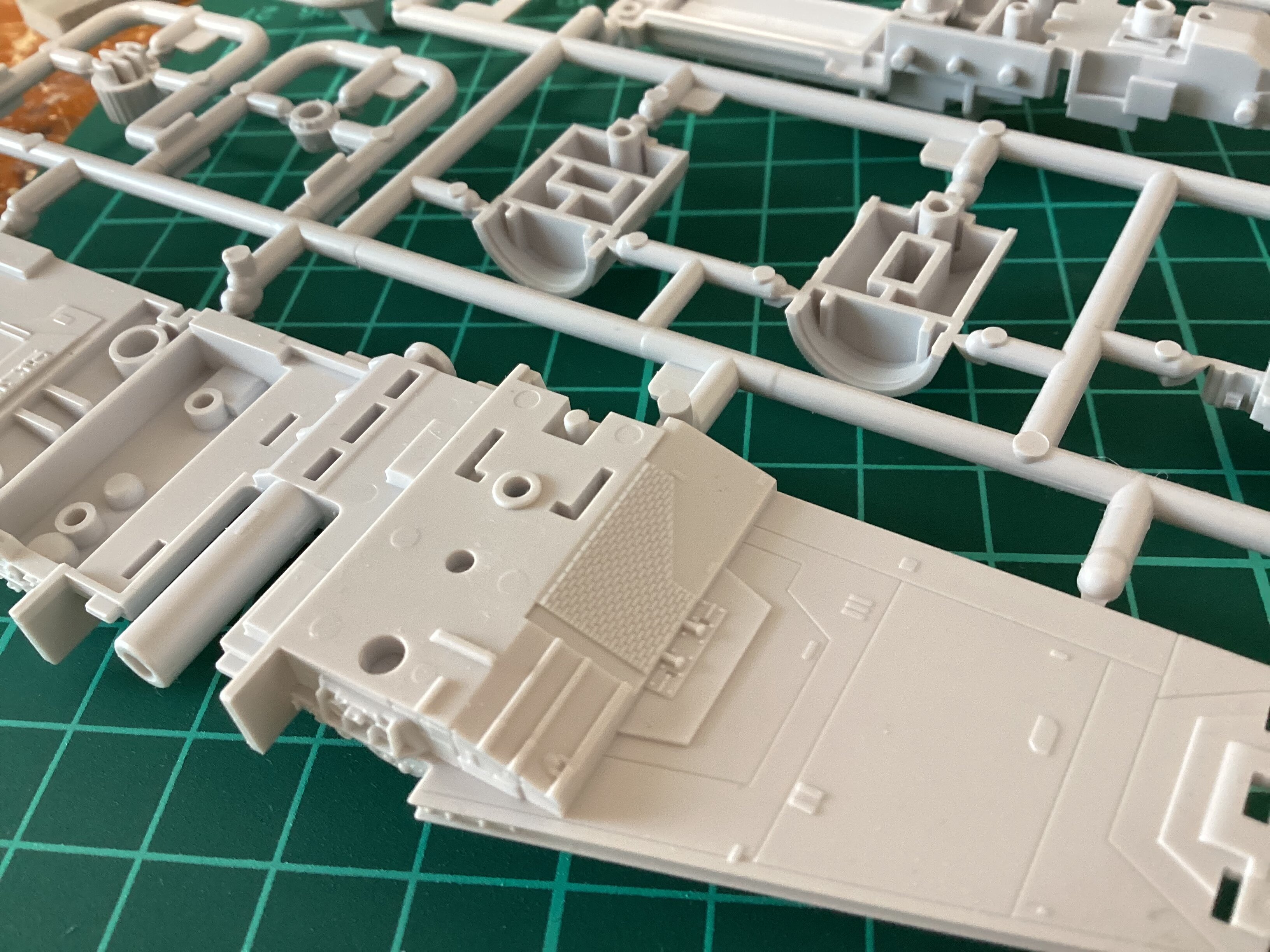

5. The wings have ejector pin marks. They are somewhat hard to see, so look for them carefully. I simply filed them down.

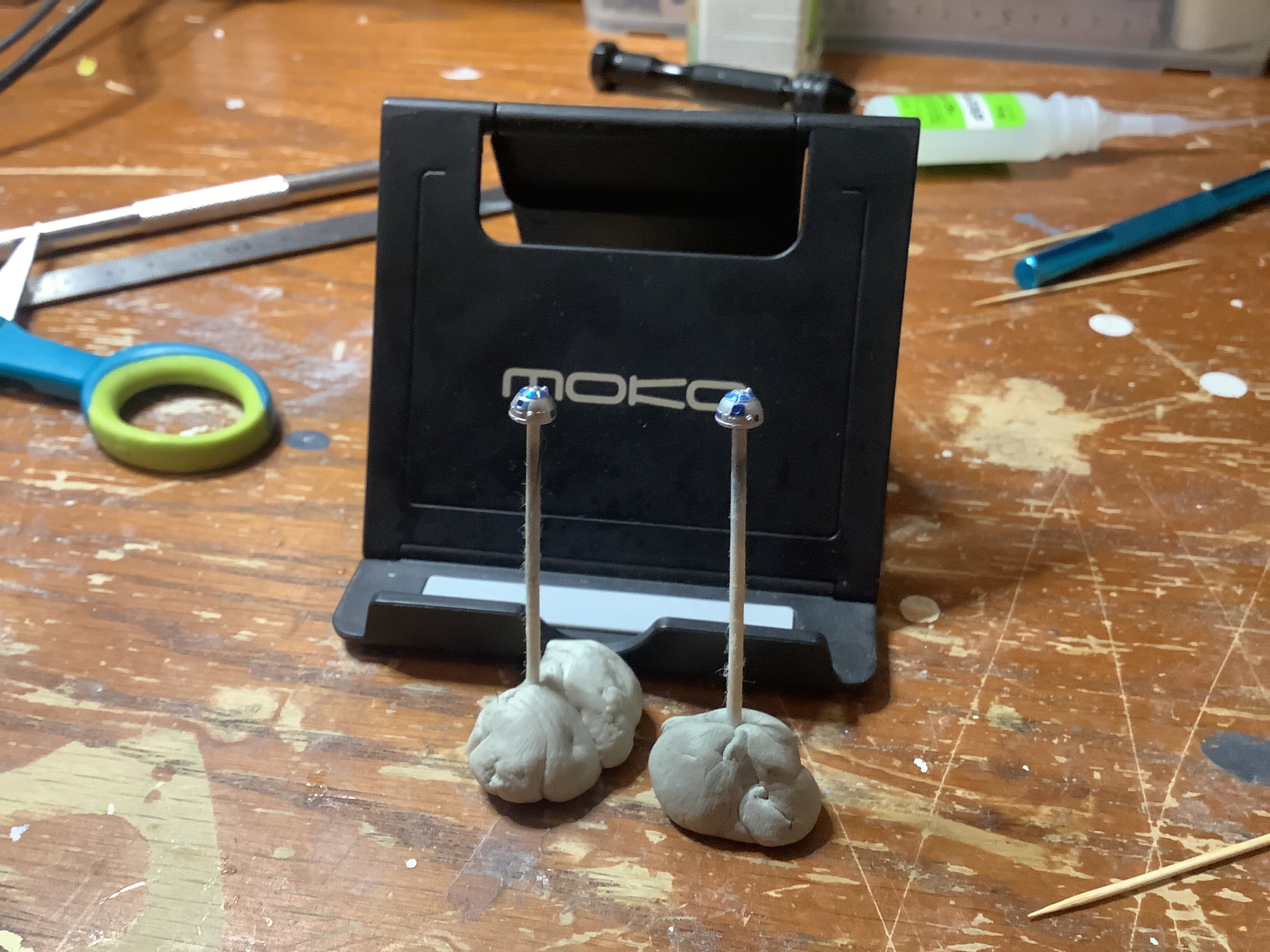

There is a 6th area that is optionally worth correcting. The canopy comes in 2 pieces. I found that no matter what I do, the gap between them is big enough to let through light. I solved this by gluing the two pieces together with canopy glue and carefully filling the gap on the inside with canopy glue. Once dried, I carefully painted in an opaque layer of paint (on the inside seam) to stop the light leakage. This is a delicate operation because there isn't much room for a big glop of canopy glue.
B840DA25-D281-4A73-AE1A-C7CBA7F605B5.jpeg14BF748C-01B8-49DA-B6BF-12913B4F7690.jpeg35867B58-13AC-4735-B5A1-00EE230645DF.jpegEFE47A88-884A-4533-96AF-D453BB5B9919.jpeg

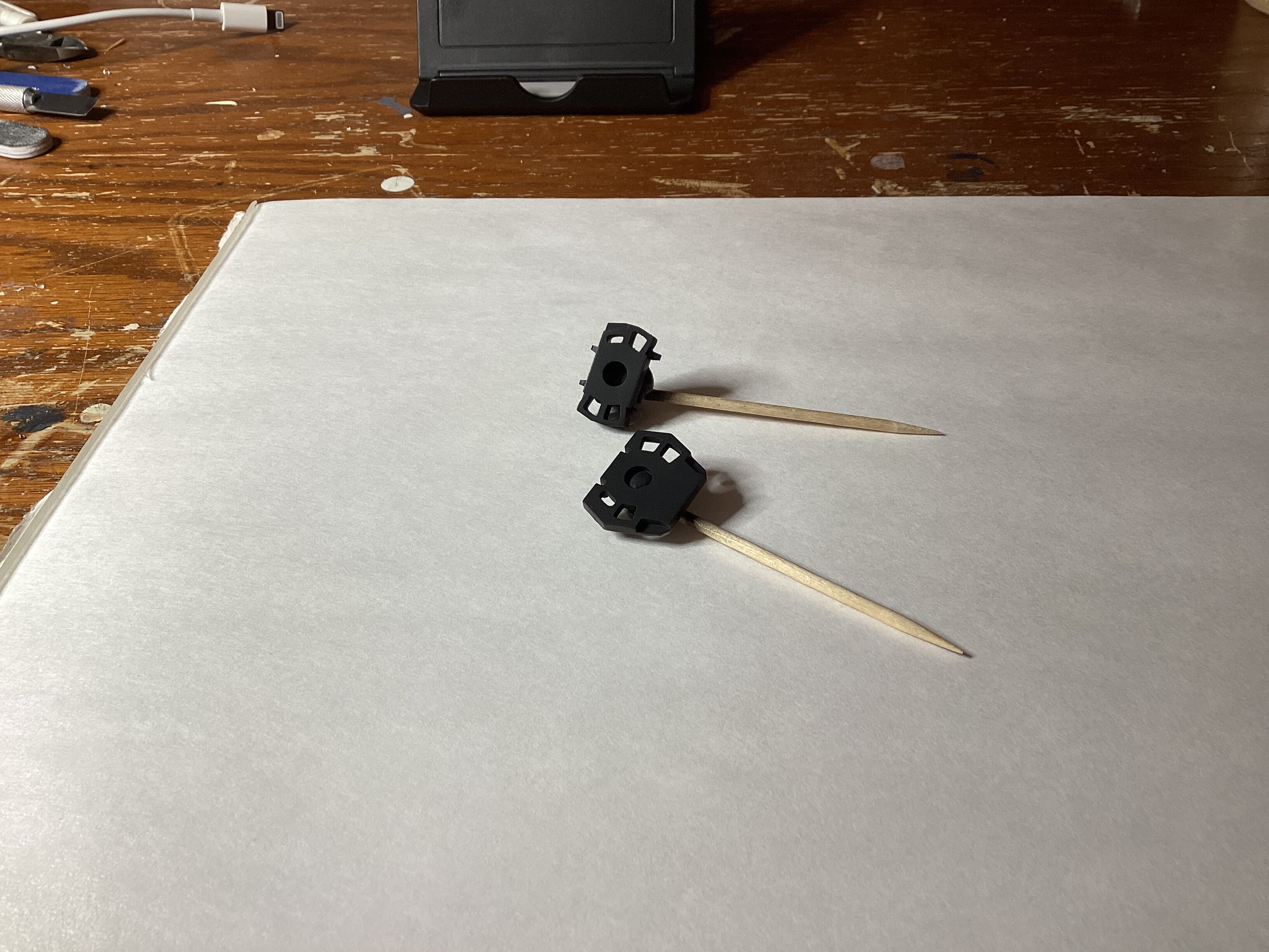

Though the kit came with decals for the astrodroid, I found that the decals are opaque and they look 'pasted on' when placed on a chromed astrodroid. I instead printed my own droid decals on a waterslide decal film ( Sunnyscopa Waterslide Decal Paper for Laser Printer). I sprayed Alclad chrome on the droid and put on the decals. The chrome finish showed through the decals well. I was much happier with the result.
Definitely paint these pieces! They nest in the middle of the plane but a careful eye will see them peeping through between the wings.
I painted the wings before assembly because it would be impossible to airbrush certain areas once the plane has been assembled. I used Tamiya grey green (XF76) for primer layer. The white is made of 85% flat white (XF2) and 15% deck tan (XF78). Some of the panels were painted with flat white. Flat white should be used carefully. A thin layer so that the primer can peep through works well. Too thick a layer will ruin the look. The pale yellow was made of flat white with 5% flat yellow (XF3). The weathering were created by using a bunch of different yellow, brown and grey mixes. I just eyeballed and mixed them in the airbrush pot as I went along. The darkest shade I used was 50% flat black and 50% JN Gray (XF75). I did not go any darker than that. The red was 10% flat red and 90% Hull Red. I think mixing in some flat white would have helped push the color back better. I sprayed on chipping fluid before putting on the red.
The engine exhaust and interior and the canopy were painted with Alclad 50% jet exhaust and 50% dull aluminum. Some weathering with Tamiya acrylic were airbrushed on them. I then used windex on a fine tipped cotton swab to pick off some of the weathering. I had bad experience removing acrylic on Alclad with acrylic solvent. Windex is fantastic! It dissolves acrylic paint well but is inert to Alclad.
