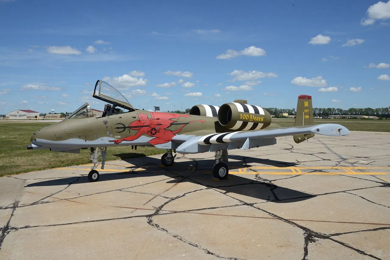

Probably something like the centennial markings for the Red Devils:
