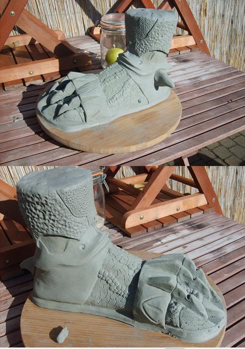

I started sculpting the AVP feet for my second suit, so I could work on something different.
I'll be making these with the ankle armor and dusters allready on to the feet.

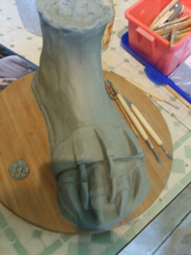

Here's a picture and I'll be updating the project every few days.

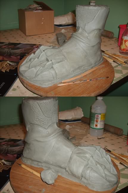

Did some more sculpting today, here are the pics.
It's almost ready so I can start detailing the sculpt.
It's plastiline, FORM FX, that's the house brand of a real good FX shop in the Netherlands. It's a nice clay to work with, and that for about 8 USD for a kilo

The sculpt is almost finished, I have to smooth a few blades and some minor details but it should be finished today.
Most of us should have seen it that there are only 3 blades instead of 4. I've still did not made up my mind if I leave it with 3 or make 4 blades on it. What do you guys think?
I'm going to cast them in a one part mold, so there will be no seems to cut away. The sool of the foot will by attached with foam and a layer of latex paste over it.

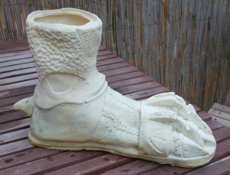

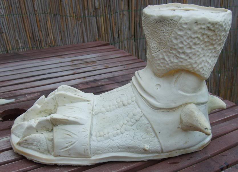

The first cast is ready and I was a bit surprized myself of the pretty good result.
This cast was done with a thinner layer of latex because it was a "testcast" and to get the leftovers from the clay out of the mold. But even cast with a thin layer they stay nice in shape.

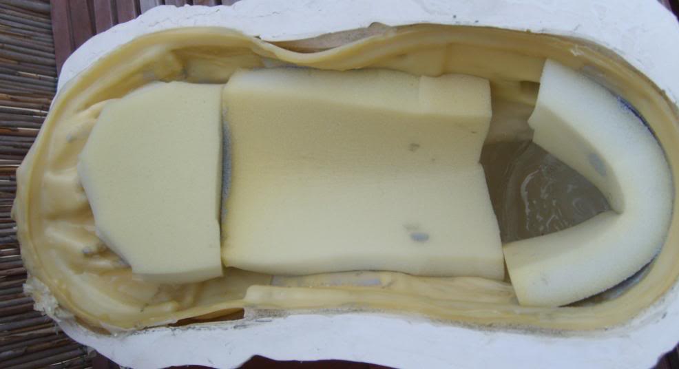

I also did some filling so the shape stays the same when there's a "real" foot in them. There's aslo a picture of the foam filling.
And I must say, they are realy nice to wear. In the feet I use for the moment, (Not that I want to say that who makes them is not doing a good job) something pushes on to my big toe and when I wear them for about an hour, I have a blue toenail.
Anyway, this feet feels like a sneeker when I wear it.
Here's a picture of the filling, because I wanted to inspect the cast before doing the rest of the work, I took it out first and after inspection back in the mold for attaching some foam parts.
The final cast. Like you can see there is only minor cleaning to do on the sool, the rest of the feet comes out of the molds "seemfree".
And now the other one...
