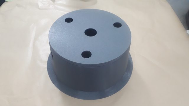

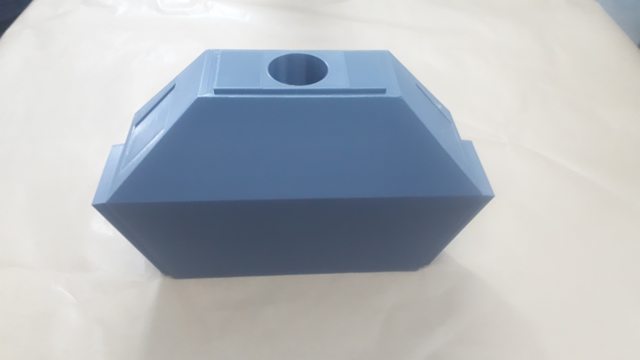

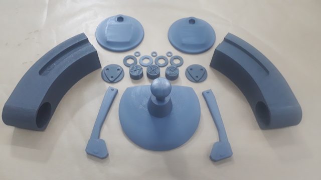

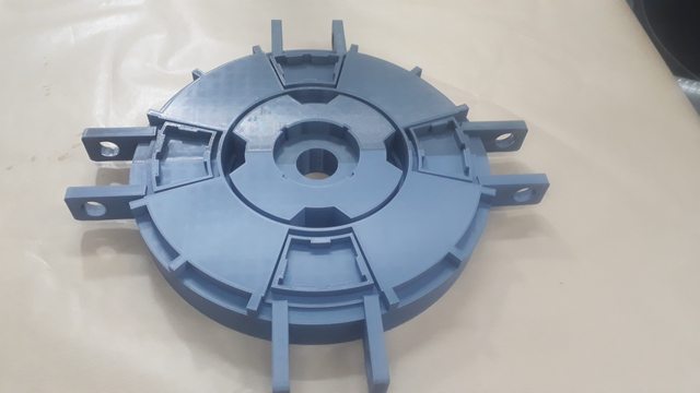

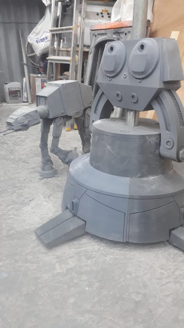

So here is the first foot at 1/8th scale...seems big enough. As u can see the concession is to have the steel pole run thru the foot to handle the weight of the top structure. The steel will be welded to a plate underneath the foot, which will be bolted to the ground in situ;
View attachment 1765370View attachment 1765371View attachment 1765372

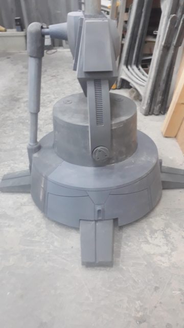

Assembled
View attachment 1765374 View attachment 1765375

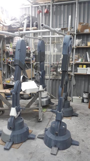

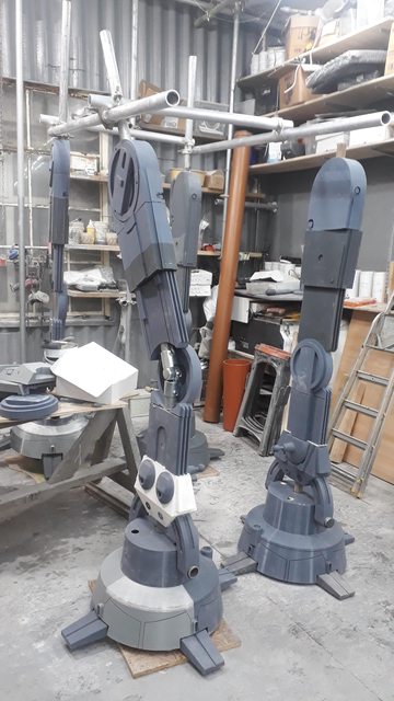

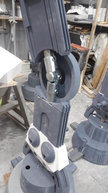

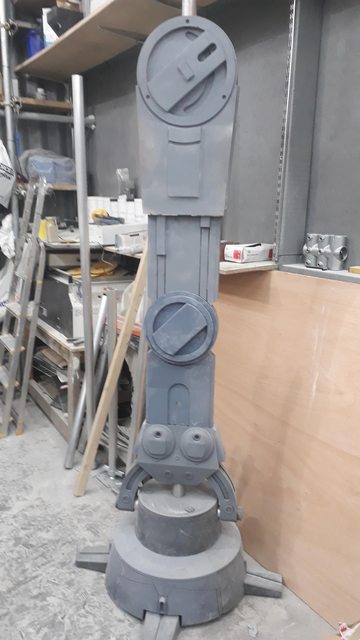

The leg... is growing; got the shin and the thigh printed and fitted. Just another 3 to go.
HOLY CRAP, that's HUGE! I love it! Can't be all 3d printed? Seems like other materials could be faster and/or less costly.

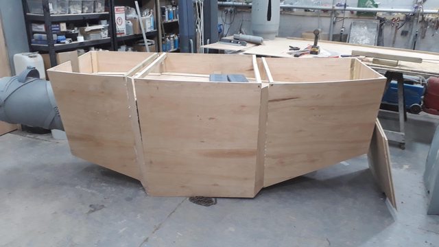

Thanks...No, I will probably scratch build the Hips, main Motordrive armature and body shell boxes

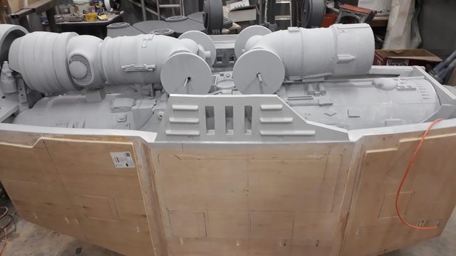

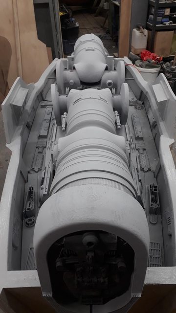

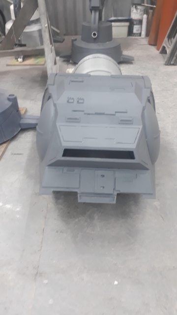

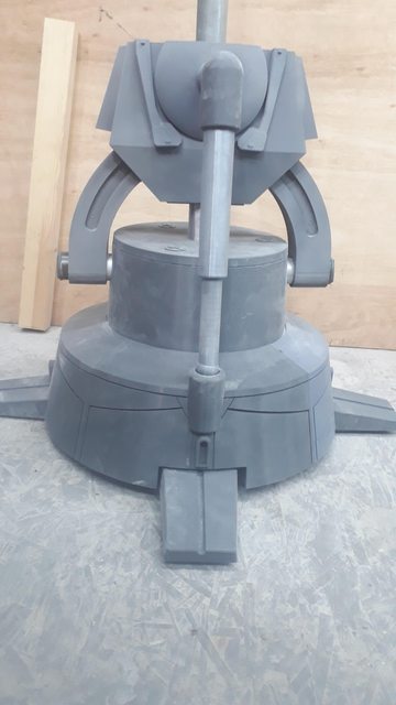

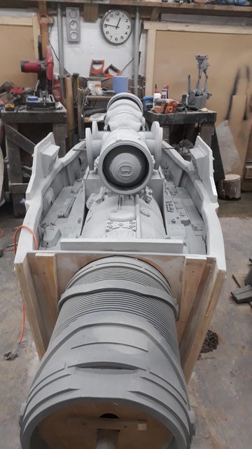

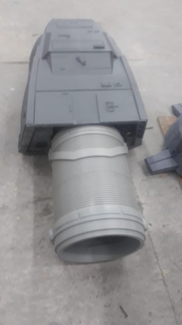

OK, got the Motordrive done...added a skirt to brace the shell in the correct curved profile, fitted all the Saturn V/Harrier parts and all the greeblies and attached the hip flange discs with tapped all thread into aluminium poles, to receive the legs. Have also routed all the panel lines in the bodyshell. This is just a base primer, not he final colour
