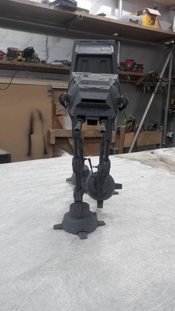

Interesting stuff! So it has been decided to make a 1/4 scale walker and with that in mind I have printed out my model to test the possible problems of undertaking such a prop. The biggest issue will be top heavy-ness, so I am thinking steel armature thru at least 3 of the legs, with probably plywood bodyshells on top, sitting on a flat steel box. We shall see

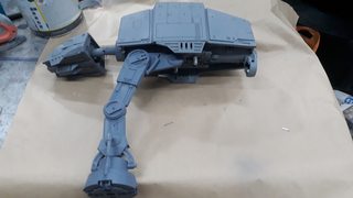

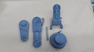

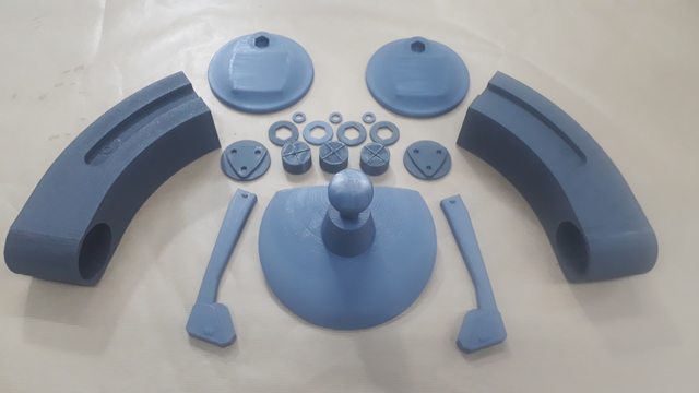

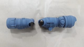

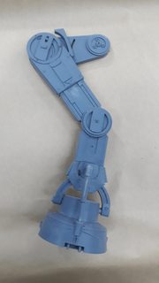

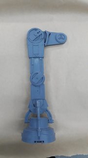

So this is all the foot and leg components assembled...the knees and hips are posable so I will choose an iconic shot and copy that

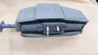

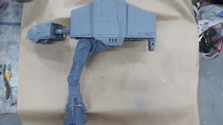

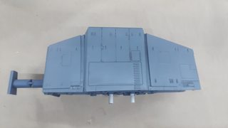

The Motordrive and Bodyshell sections will be a mix of plywood and printing with possibly a motorised neck movement

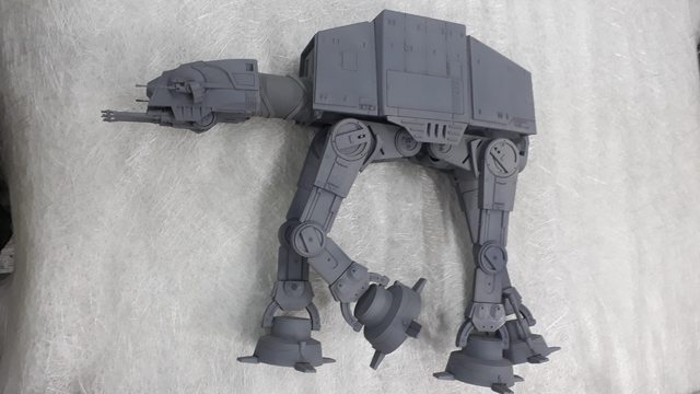

I will print the other legs and remaining motordrive and head parts to have a 'working' maquette, to figure out the best pose for display before starting on the big version
View attachment 1762071 View attachment 1762072 View attachment 1762073

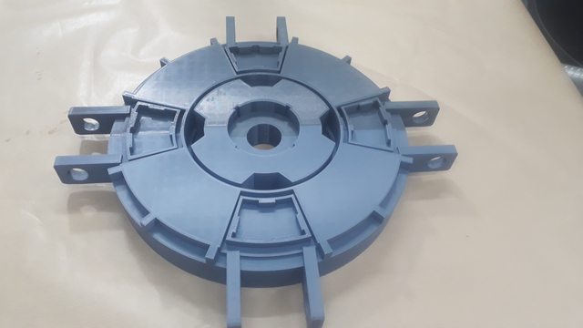

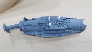

View attachment 1762074 View attachment 1762075 View attachment 1762076 View attachment 1762077 View attachment 1762078

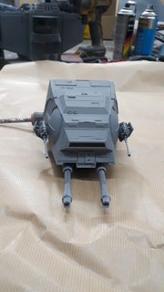

And the head probably all printed with hopefully moving chin guns
View attachment 1762079 View attachment 1762080

It is studio scale 1/24 and not resin...printed in PLA on my Bambu lab Carbon.

Wow that is a clean print It doesn't even look like it's FDM!

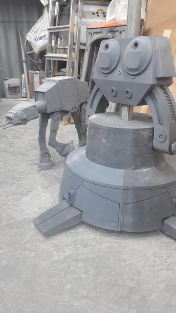

Ok, so not 12 meters dude...even I am not that crazy.
And it seems that the studio model is not 1/24 but more like 1/48; if the 1:1 is 22.5 meters, which makes my build around 1/8 scale...still gonna feel pretty big I reckon

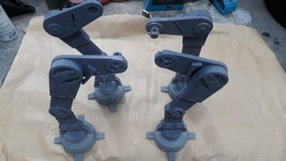

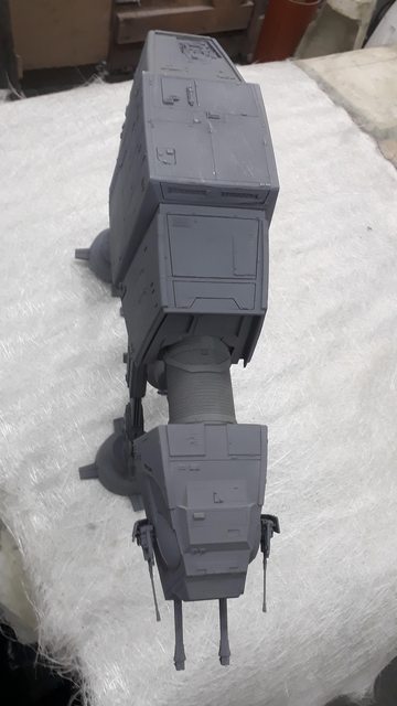

Got the rest of the parts printed for the maquette...just some assembly required and then to strike a classic pose

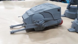

Head guns on;

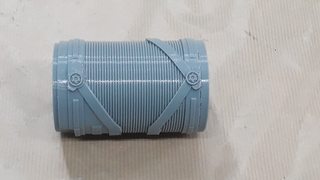

Neck...this is printed in flexible TPU to allow some head movement;

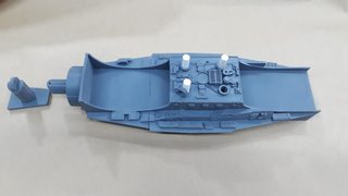

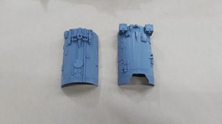

The Harrier motordrive parts;

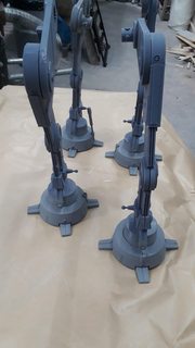

And the rest of the legs;

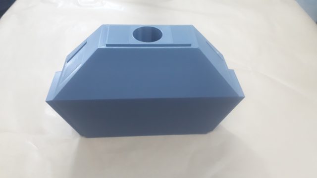

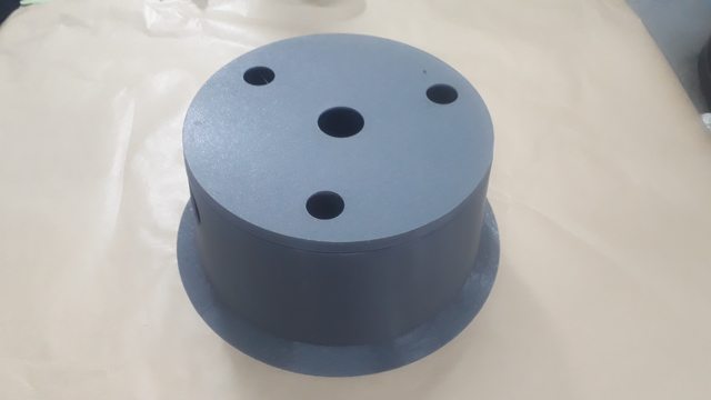

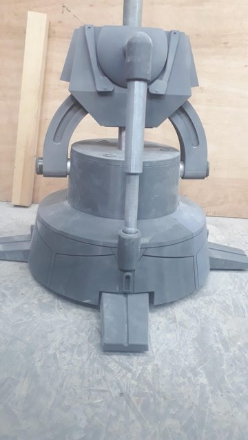

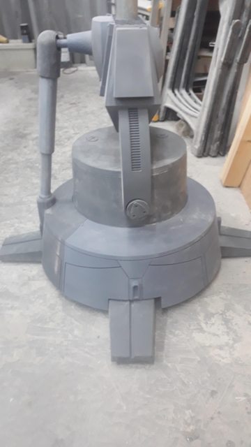

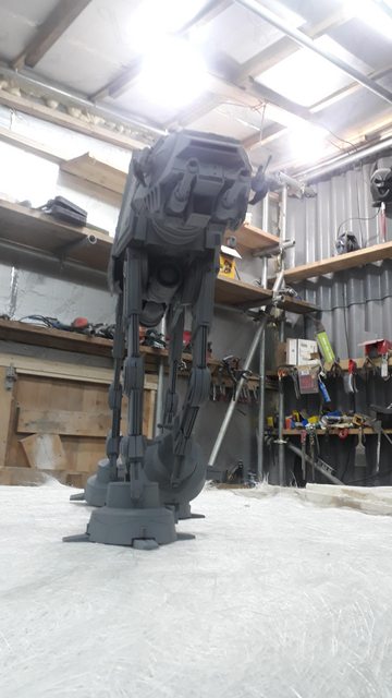

So here is the first foot at 1/8th scale...seems big enough. As u can see the concession is to have the steel pole run thru the foot to handle the weight of the top structure. The steel will be welded to a plate underneath the foot, which will be bolted to the ground in situ;

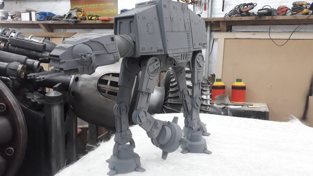

Assembled
