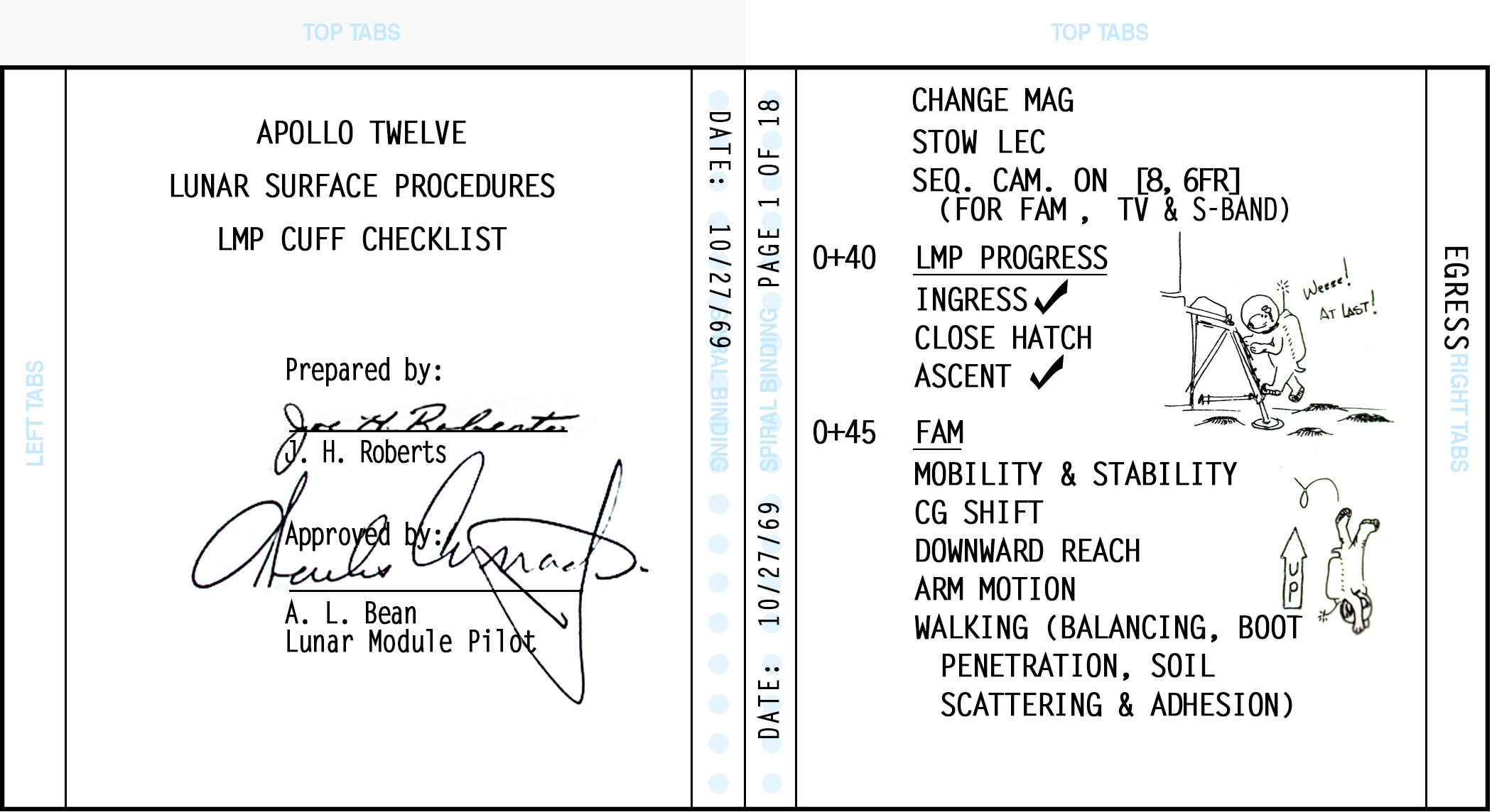

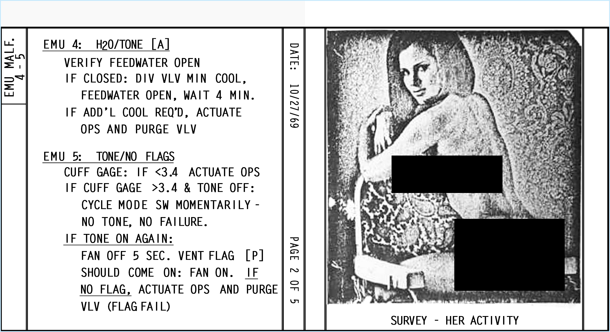

Cuff checklist all finished being re type-set and cleaned up. Took a while since the modern day equivalent of the font was not to be found so I had to create my own.... Now to find a decent repro plastic covered stock to print on. I'm attaching a clean vs Xerox dirt versions of a page. Not sure which to make yet. Also one of the playmate pages (censored on here of course).

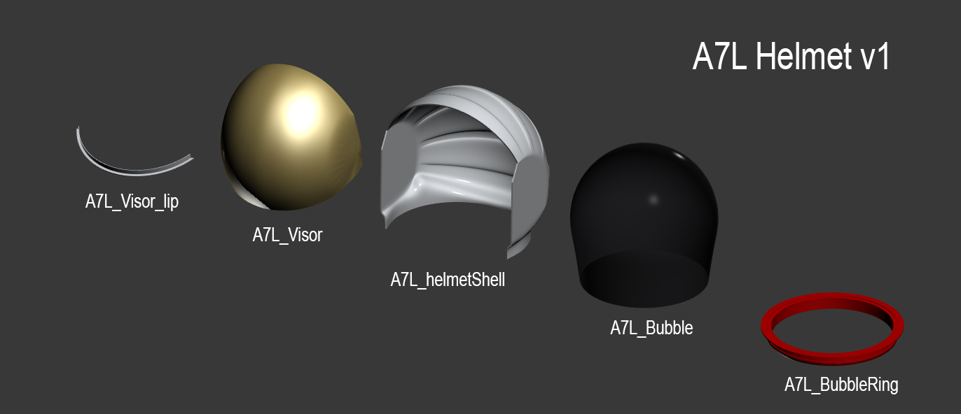

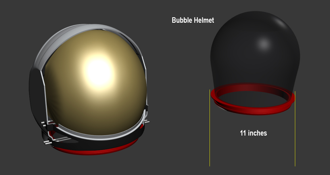

This is what I have separated so far. Will share files with anyone wanting to test print.

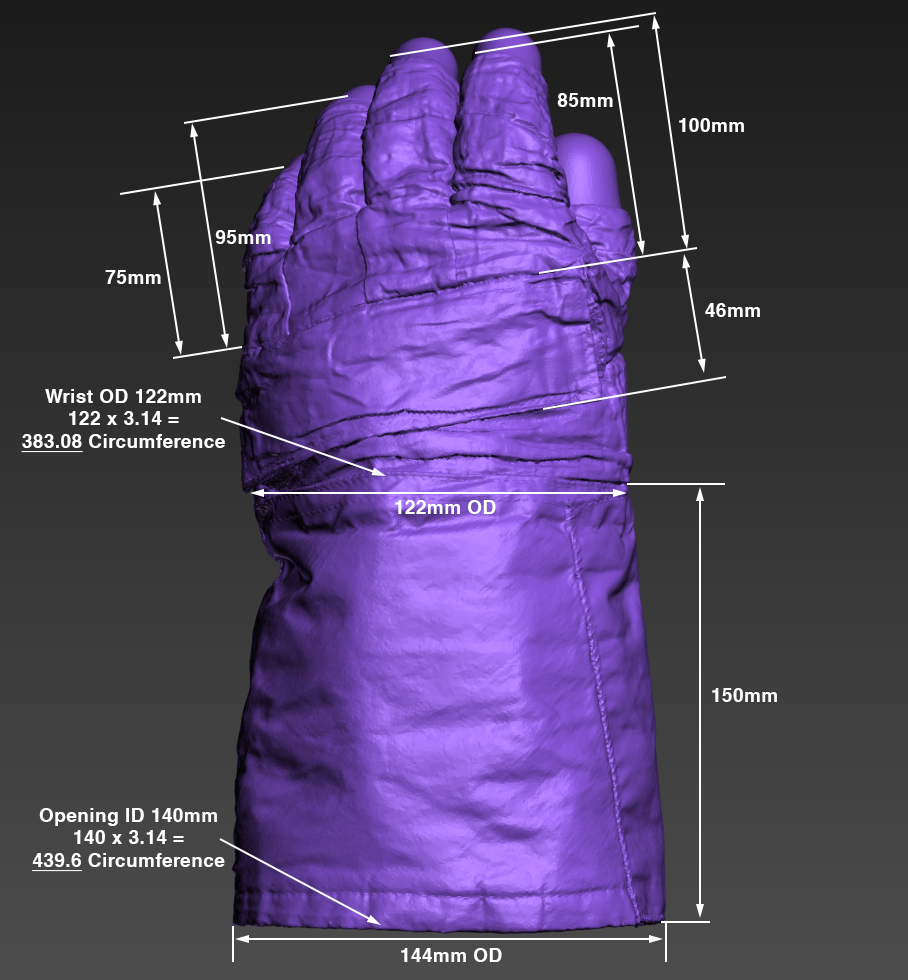

Hello everyone, new here.

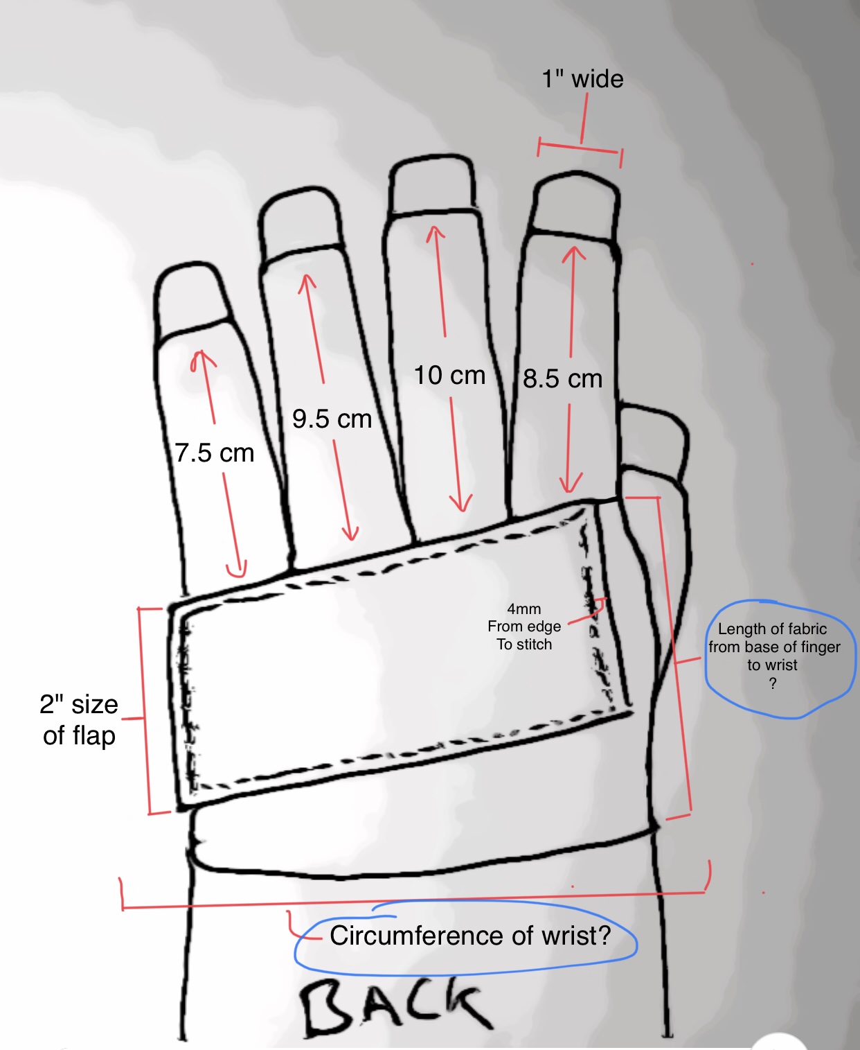

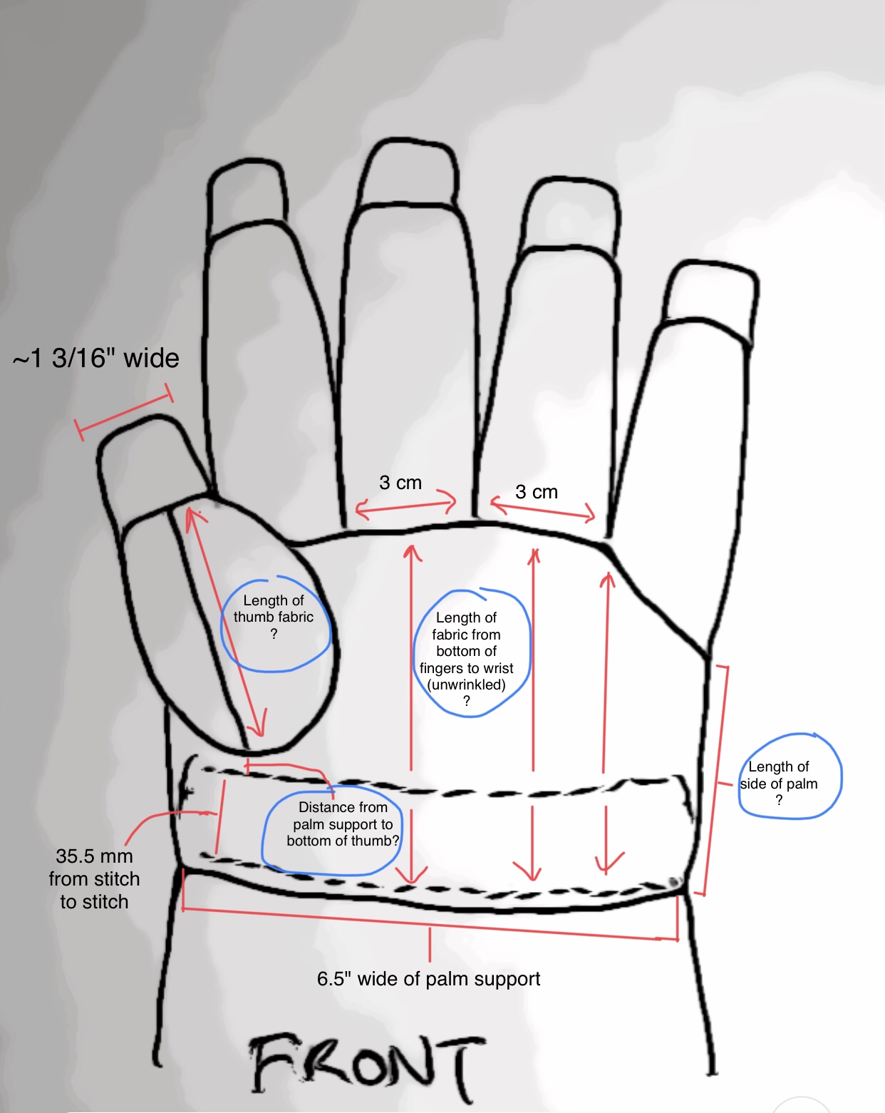

Definitely in the thick of the research phase and I was wondering if anyone had in detail measurements for the EVA gloves for patterns etc. Right now I’m using the Smithsonian 3D scans, and I’m having a little difficulty getting around all those wrinkles to make clear measurements. I have ideas.
Too, does anyone know if the palm restraint webbing strap under the back flap of the EVA glove goes inside the glove and wraps around the inner bladder (like the IVA glove), or is it patched sewed down to the sides of the opening?
I’ve attached my photo of my ongoing measurements here (let me know what you think).
Any details would help!
Does anyone know where to source the palm restraint buckle used for the 1/2” nylon webbing? Most factories won’t make it unless you order 1000 pieces (severe eye roll), and there’s nothing similar to it anywhere (closest thing I’ve come to is a 2” one meant for strapping down patients or pianos lol)
I put the measurements at around 14mmx18mm, but I don’t have the tools nor the materials to fabricate a buckle.
View attachment 1079025View attachment 1079027

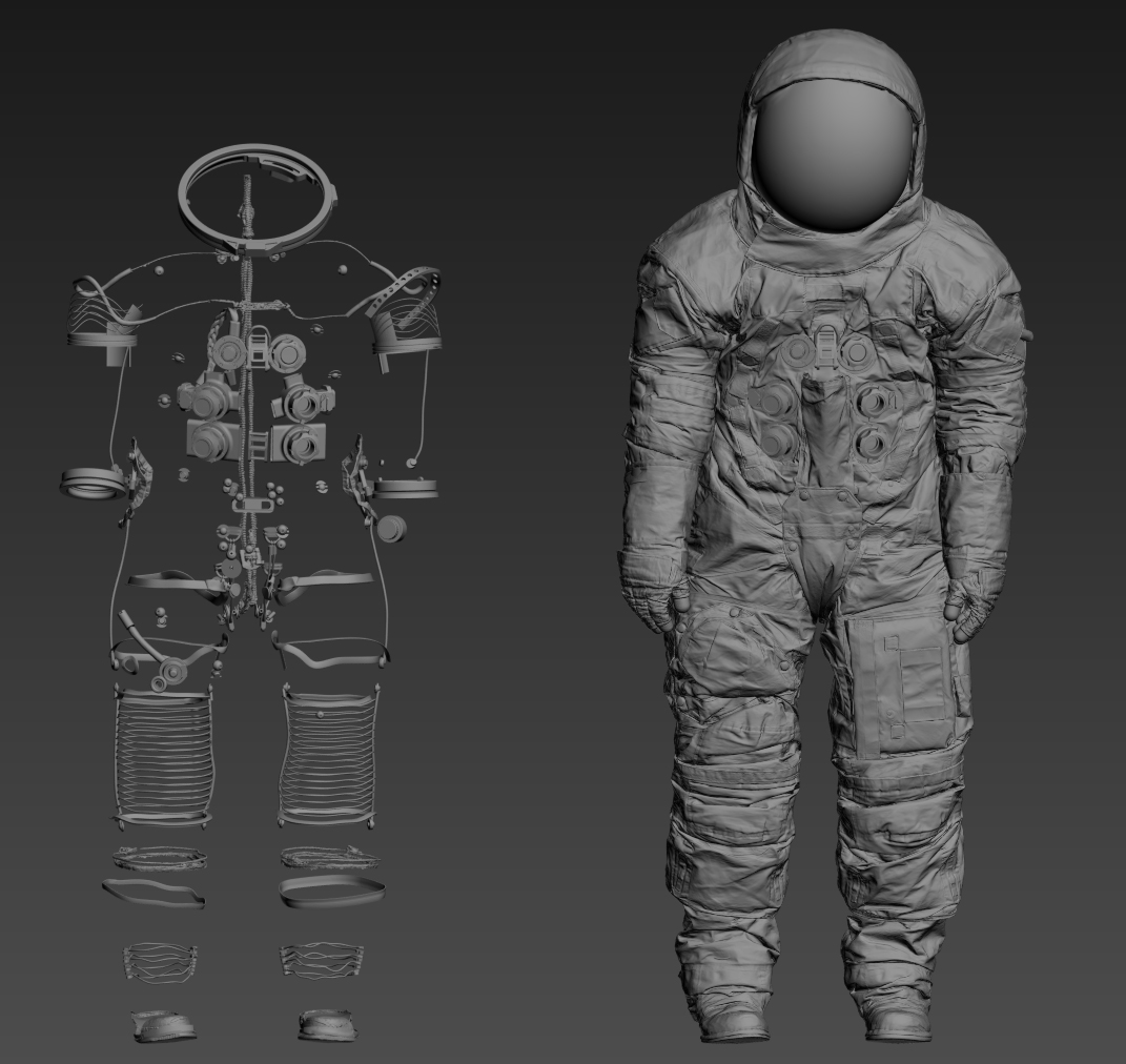

I'm currently working on the same part... I found it best to cut the model in pieces and rebuild the hard parts. Measuring the soft parts will be a little tricky but there is so much reference out there to help make it easier.

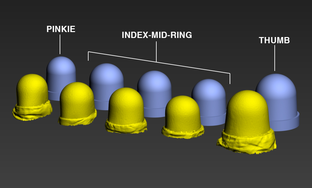

Here are the models and reference I have so far. (some measurements included)
enjoy!

From what I can tell, the inner IVA bladder is like the normal IVA glove, and the palm restraint buckle, along with the nylon webbing comes out of an window opening in the EVA glove cover. There appears to be some sort of nomex colored fabric that is under the webbing in a few photos, and is overlapping the unnapped loop velcro for the palm flap.
For accuracy's sake, I'm not sure how that little piece of nomex colored fabric is placed there. Is it sewn into the underside of the EVA cover, and the webbing just sits on top, with a little overhang spilling out?
This is what I have so far. I've tested the fit on paper, but have yet to sew one up yet.
Stay tuned.

Loving the pattern! This is probably the only one in existence online, so I applaud you.
I do have a question though. In the glove assembly from the moonwalk one video, and from the 3D scans, it appears that the Fingers on the Chromel-R abrasion cover are one solid unit, and are on not multiple pieces.
Are you able to confirm?
