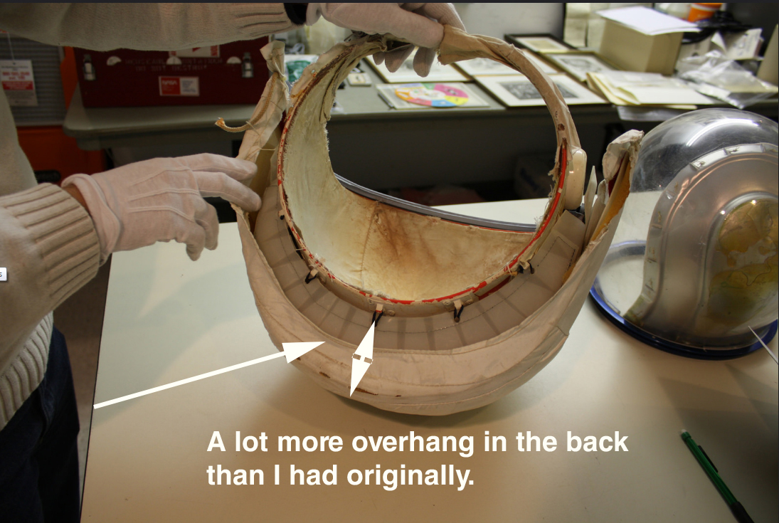

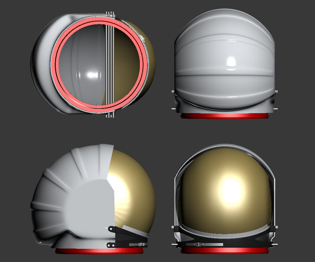

The step from the pressure helmet interface and the visor rest looks too small. The radius is only slightly larger than the bubble. It look like you have made it larger than the helmet side of the disconnect.
Here are some dimensions:
Suit side disconnect- ID 9.900"
Bubble helmet OD at disconnect- 9.415"
Helmet side disconnect ID- 10.350 (flange) / OD- 10.350"
Excellent! Thanks again for the input... I found that the pressure helmet was sitting to far back so I moved it forward and adjusted the helmet around the back neck. Also pulled the visor rest fwd and enlarged it as you suggested... Still feels like it may be too narrow side to side. little by little.

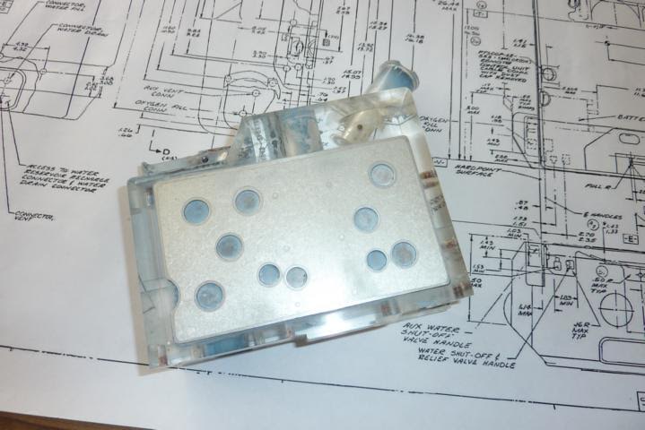

Starting to make some progress on my RCU.

Hi
Here is an original RCU
The basis for the part used in the Apollo flights
The pictures of the mechanical parts will follow in the near future
The RCU dimensions of Shapeways are not correct
I own an original part of Apollo era
In the previous posting are the images of the Ingeneursmoduls
