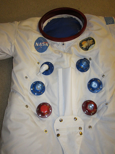

Good question. If you had a shirt collar, like a Priest, it would stick up about 1.5 inches. There is velcro inside of the 'shirt collar' on the suit....... it attaches to velcro on the outside of the aluminium ring (which slips inside of the shirt collar). Now the Aluminum ring is solid on the suit and the base of the helmet ring fits into the aluminum ring.
Ill try to post a pic later tonight. A picture is worth a thousand words.
Here ya go. This is a shot from the side of the helmet. I pulled down the suit collar so you could see how its velcroed in place. The helmet is three basic pieces: 1) base ring that sits inside of the aluminum suit ring 2) main dome 3) face shield.
[url]http://i265.photobucket.com/albums/ii203/lear60man/Helmut_zps0ebe3eb4.jpg[/URL]
The suit is on a hangar and thus tilting forward. When the suit is being worn, the neck ring is only tilting forward slightly. The weight of the helmet doesnt make the ring wobble at all. But just enough to make a good seal.
My neck ring is attached to the suit with velcro. I would have done this reguardless but on my suit it is critical to take the ring off since the suit has the zipper in the front. The real A7L has the zipper in the back, but I wanted to be able to get in and out a little easier at least on this first attempt.
The helmet is held onto the neck ring with rare earth magnets. There are 5 in the ring itself and 5 in the helmet. It is strong enough to keep the helmet on as I move but I can pull the bucket off with a quick twist and lift motion. My next one would have a few more magnets in it as well.
And the helmet dosent wobble. It leans forward on mine due to an error when the the collor was pinned, but once the neck ring is on the helmet stays locked in one position (i.e. I can freely move my head inside without the helmet moving as a result.

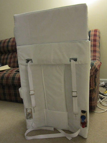

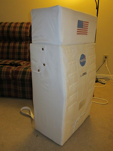

I spent the better part of the 4th of July weekend with my sewing machine and Netflix. First I covered the PLSS and OPS boxes with cloth. This turns out to be much easier than making the jump suit.

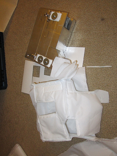

The control box was a bit more of a headache. It is a ply wood box with knobs carved from MDF.

I also added the patches, Velcro, and connectors to the suit:

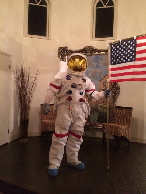

And here is one with me in it
1044496_10102674138586650_882112554_n by 2StoryProps, on Flickr
Before Dragon con I still need to cover the hoses, make the gloves and boots, and modify a flag for the masquerade. After the con I’ll work on the over-visor, the commander stripes, and a camera. My friend David is also working on a wrist check list. Stay tuned.
