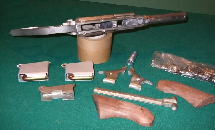

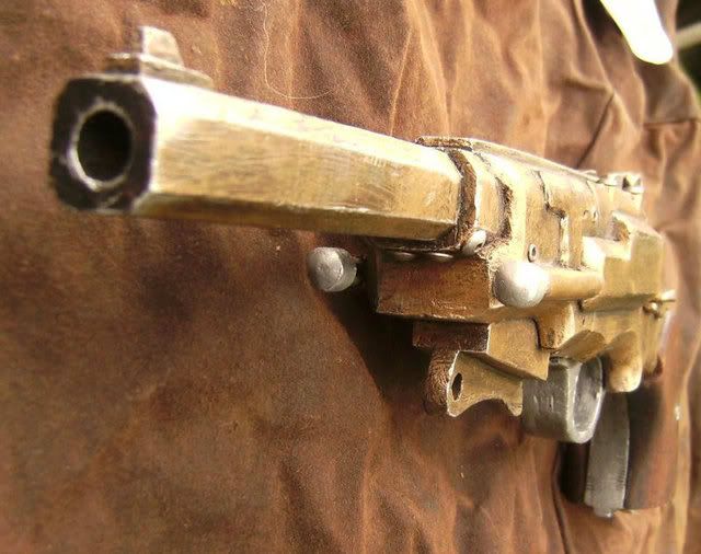

I started one about three years ago. The barrel is the only portion that has been machined, the rest was hand shaped with metal files and a dremel. I haven't finished it at the moment. Here are a few pics with one of phil's resin casts for reference:
-Jon

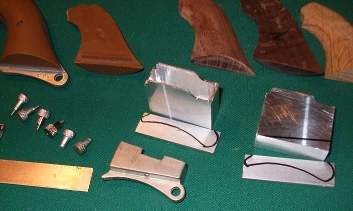

I have access to a vertical mill (Bridgeport) which makes everything easier.

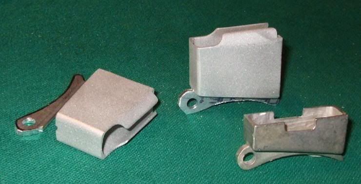

I had to make a 3-piece fixture to bend the feed lips on the mags.
I want to display the gun, 2 spare mags, a cleaning rod and 24 rounds of ammo
in a green velvet lined presentation box.
My bending fixture didn't work quite like I planned,
but fortunately these are static display and not for a working weapon.
All the work on the scrolls was hand file work.
I put a 1/4" dowel pin through the hole and located off the flat.
That way, all the filing is done on both pieces simultaneously so that both pieces are the same when you are done.
After I finished the scrolls, I cut a piece of dense, kneeling pad foam to simulate the mag follower.
I "loaded" three rounds of live M-1 Carbine, FMJ ammo for the photo.
The final touch will be to drill and tap the bottom for two 2-56 button-head-socket-cap-screws.
Mike

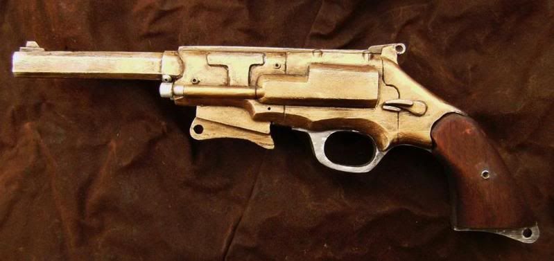

I bought a cheap injection molded copy off ebay and have been working on getting smoothed out and as accurate as I can because I have it cast in bronze.
Does anyone have any tips to finding someone with a means to melt some scrap bronze and pour it in to a sand casting? I live in Washington DC, if anyone have and connections in the general area. I have been having a really hard time finding any info of this and I would love to talk to some people about pricing it out
