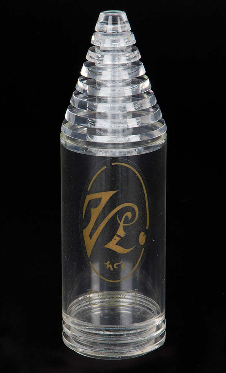

I've been looking around for a Romulan Ale Bottle or build walk through, and found out that The Wrath of Khan Romulan Ale Bottle was auctioned off last year, and the detail photos reveal that it's construction is a little different than most people have speculated. Or, at least, it seems most of the builds I'm seeing are based more on the Next Generation version with solid tiered steps on the top and base.
But in the TWOK version, the top tiers seem to be individual panes floating off a central tube, rather than solidly stacked. Also, it looks like the top cone and the bottom foot are pieces added to the main acrylic cylinder.
The description from the auction reads: "Romulan Ale bottle from Star Trek II: The Wrath of Khan. (Paramount, 1982) A clear Romulan Ale bottle measuring 10.5 in. tall and 3.25 in. in diameter. Constructed of clear acrylic cylinder with a tiered foot at bottom and a graduating cone of rings ending in a flat cap shaped top. Gold Romulan brand decal at front and a smaller decal printed, “Vintage 2283” below. Minor crazing to interior ringed portions of the top and bottom, and very minor chipping to the logo decal. In exceptionally fine vintage condition."
Yep as I posted earlier the WOK Prop just got harder to replicate, the next gen ones are a breeze to replicate compared to the WOK prop

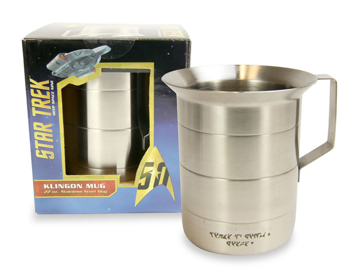

They had the Klingon Bloodwine mug available for a while a few years ago. Wish I ordered more than one as they were pretty cheap.
That looks like a commercial kitchen liquid measuring cup, though those seem to be aluminum rather than stainless and the capacities seem to jump from 16 oz to 32oz.
I believe the original ones used on TNG and DS9 were measuring cups
