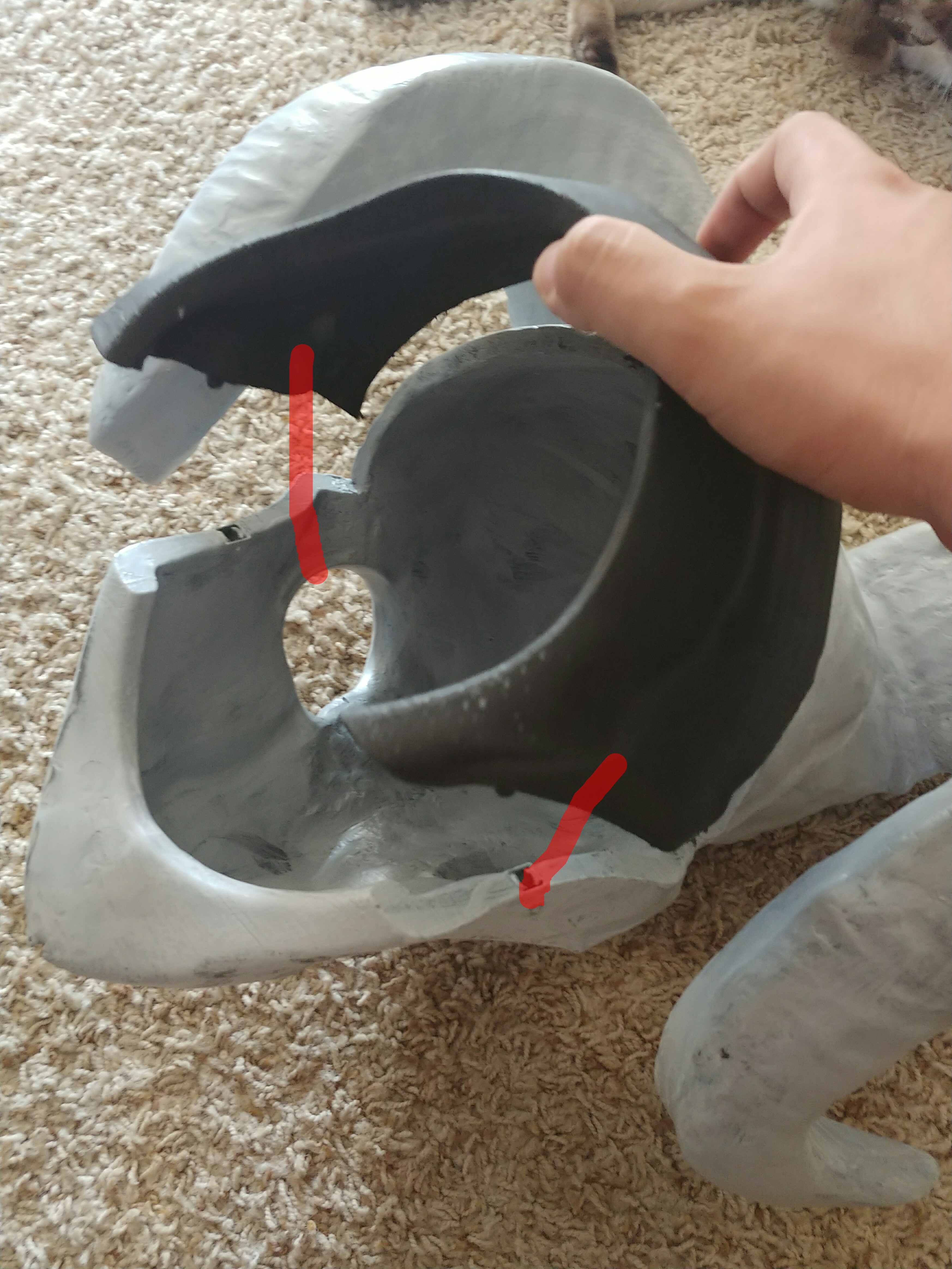

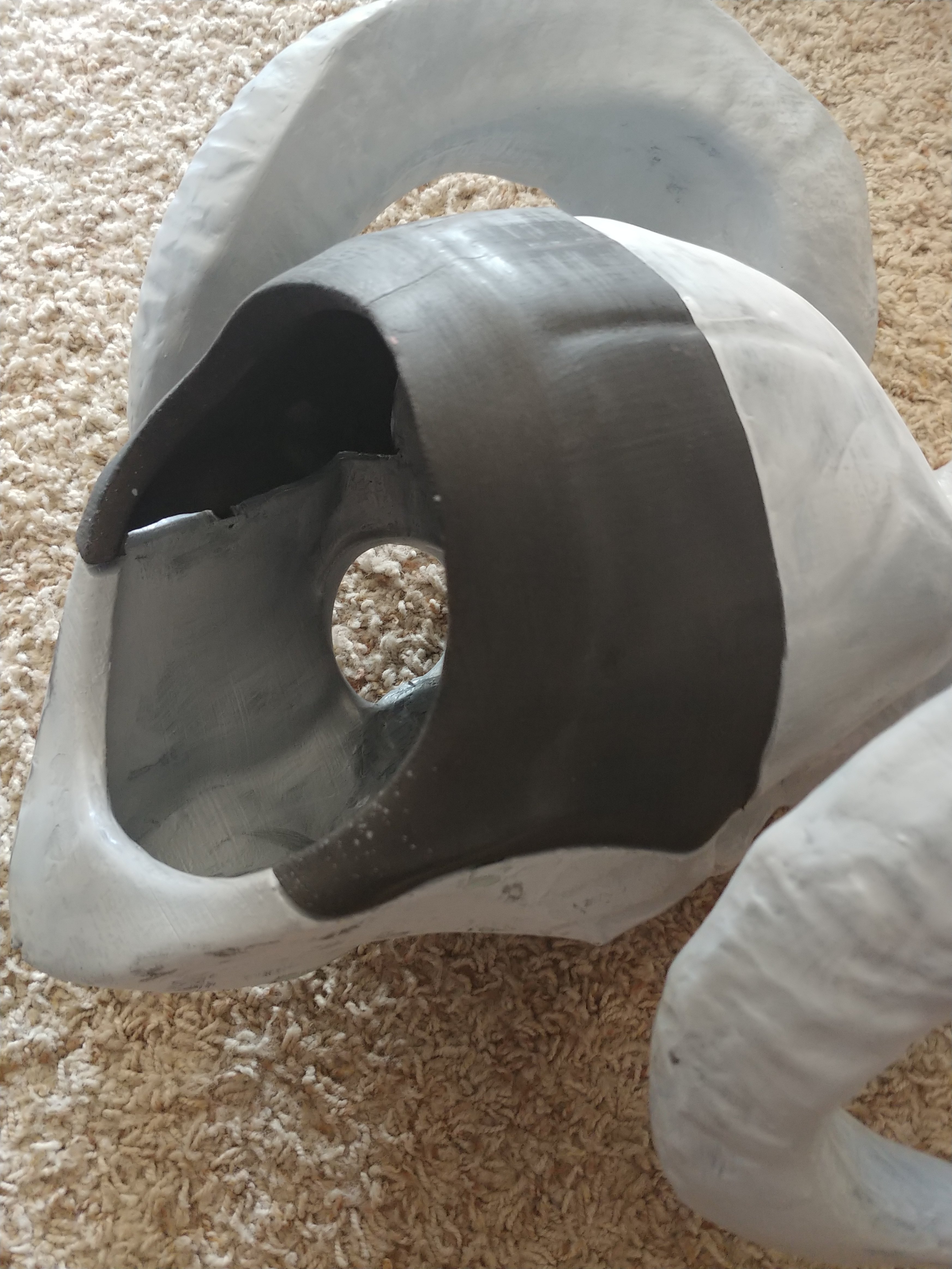

any idea how to keep pieces together??
BoomCo
the neodymium magnets are too weak... any advice?
im looking some alternatives..

If you put some elastic where the red is, it will help hold it together, and allow you the widest lower opening, for the least amount of stretch in the elastic.
Straps and clips? Not certain if you have enough room to read a finger through the eye socket or through the bottom to affix. Perhaps using several magnets?

i was looking some option like clamps or something similar, the elastic doesn't work cuz i need to remove the whole piece to put the helmet (i cant put in the helmet is very tight to the size of my head).
I would just add more magnets. you can space them out/closer etc to get the exact fit/resistance you need and want. :thumbsup
