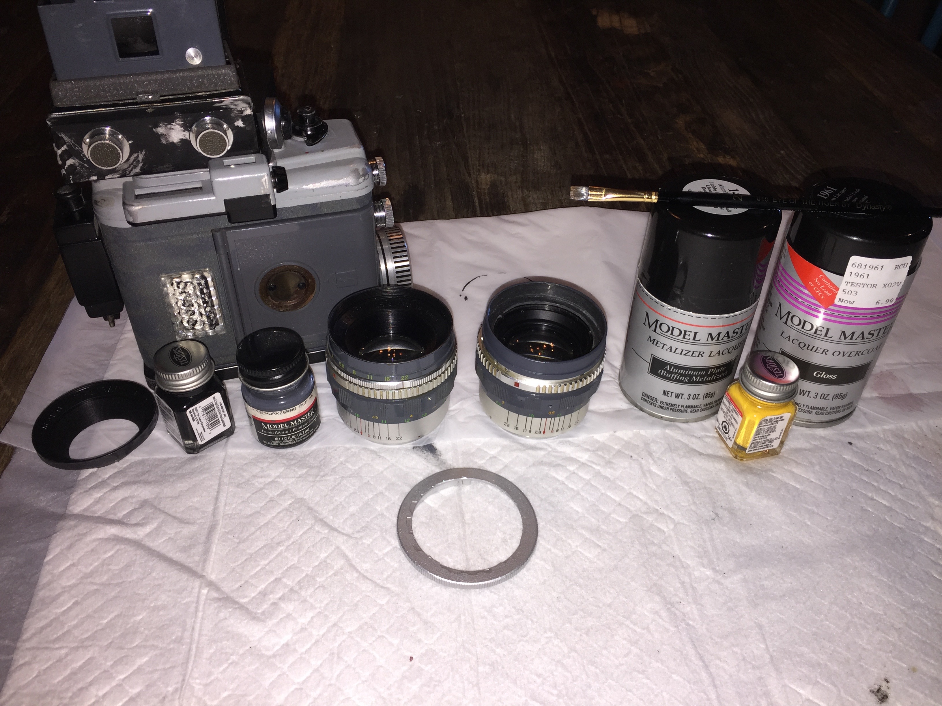

i also will be selling my remaining parts - stripped and ready Eumig w bubble strip glued in place, pre drilled for Seagull knobs, my aluminum triangle w mesh, & Eumig knob, and paint, Kalimar knobs.
So my RussRep lens plate isn't as cool as I thought. I cannot get ahold of him either....

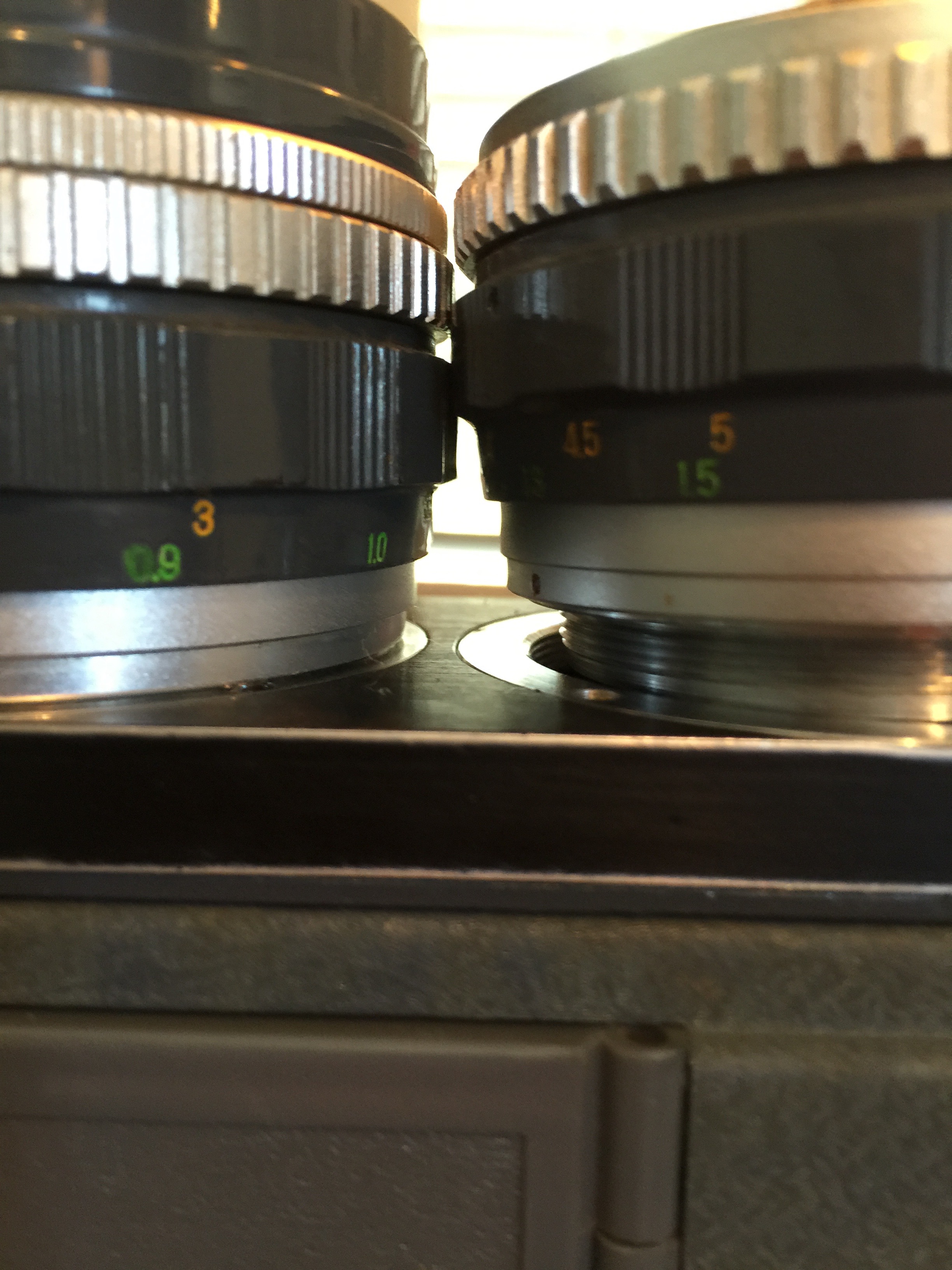

The lenses will not both thread into the plate, they hit each other badly. I guess I'll be visiting the machine shop....
Who would be interested in a machined aluminum lens plate that did not need the Kalimar lens rings? I'd engineer it so it had the threaded rings machined in the lens plate and 2 mounting posts to go through the Eumig body. I'd also laser cut the shims I made to fill in the step in the Eumig body so the lens plate sits flat and solid. Let me know, thanks!

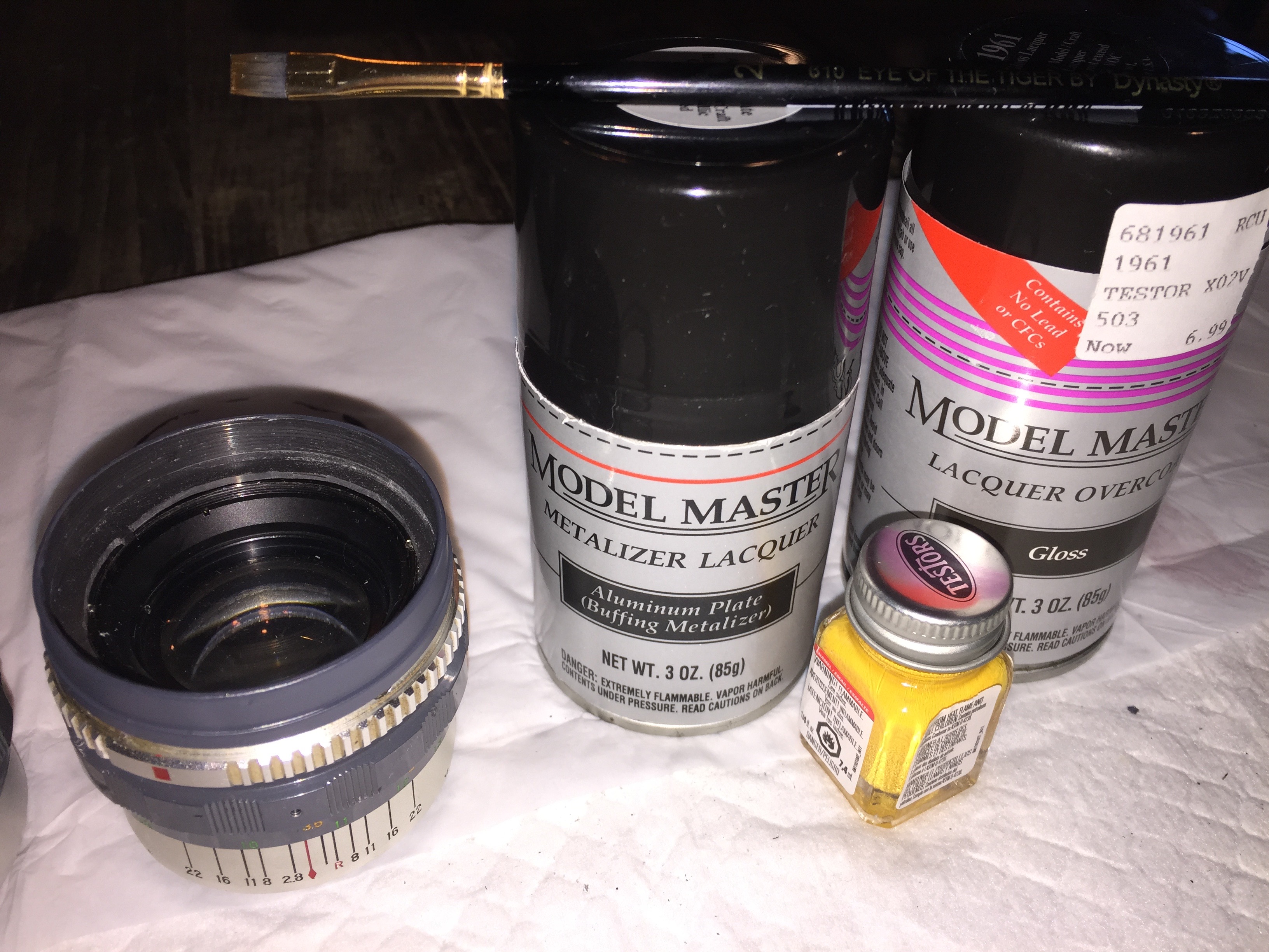

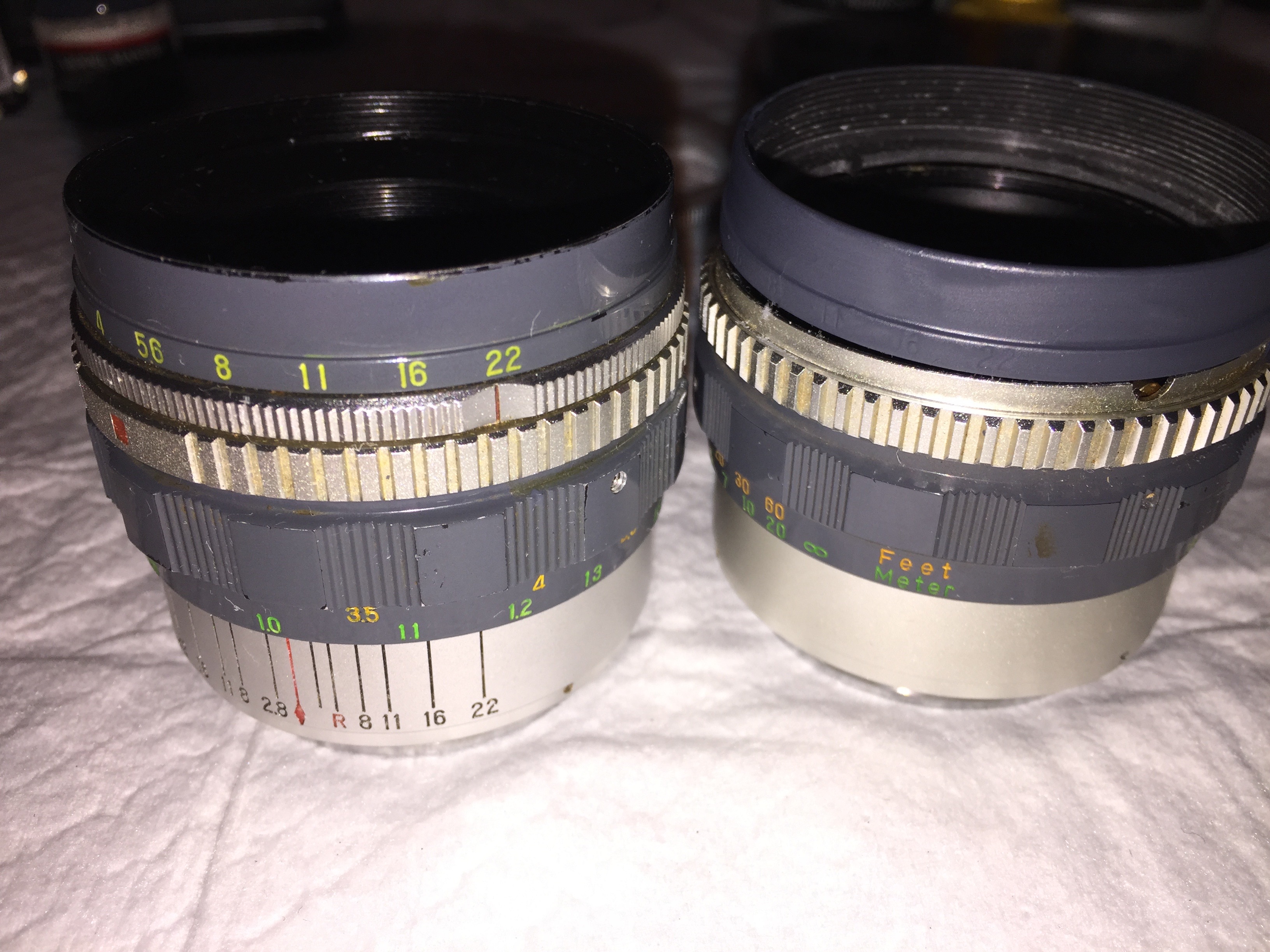

I think I matched the Kalimar gray OK on the lens cap. Got some cool buff-able aluminum metalizer paint from TMM and it works pretty cool. Applied a second coat after buffing and need to buff it again. Later today I'll clear the lens cap, then do the yellow detailed numbers, clear again, then weather the gray lens caps and aluminum focus rings like the screen used prop.
Gray looks good to me. :thumbsup
But: Screen used was all painted over. ;)
Not with all the original colors like most builds here. (That´s why i have 2 on my bench, one will be nice looking, and another screenaccurate under paint)
Yeah, I know, I know. I'm kinda doing a hybrid.

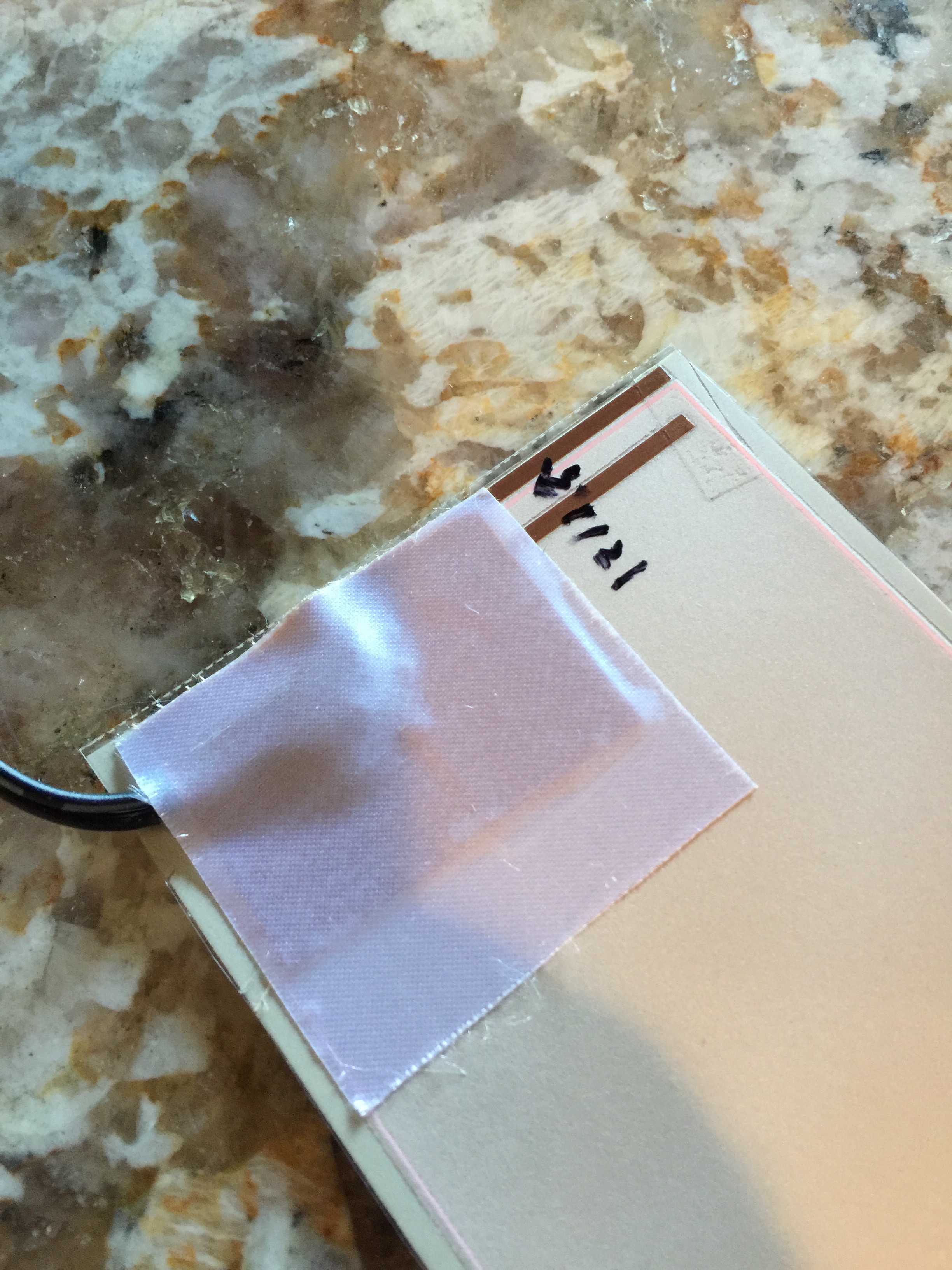

So the EL sheet wires have broken off of the sheet several times and they are now unrepairable. I found a new EL sheet with a long flexible contact wire w/ a molex plug end vs. the hard tin leads. This should allow the sheet to be mounted securely and w/ no more damage to the wires. Live & learn right!
pretty cool! Would you mind posting the source or brand/model?

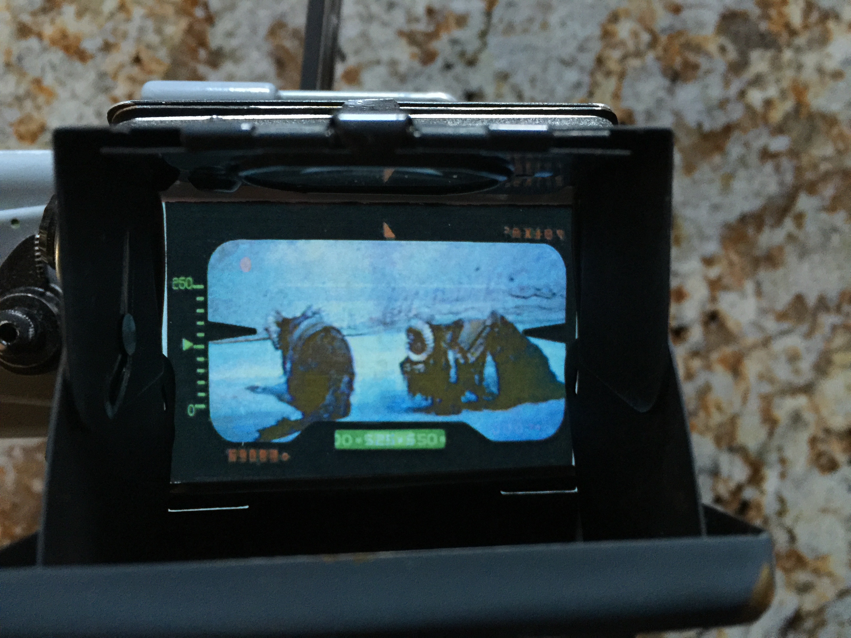

EL sheet arrived, much nicer unit than the first one! The electrical leads are perfect for this prop. I simply trimmed the excess plastic film on each side, used clear tape to attach the Banta slide, and coiled up the wire lead and slipped it into the view finder hood bracket.

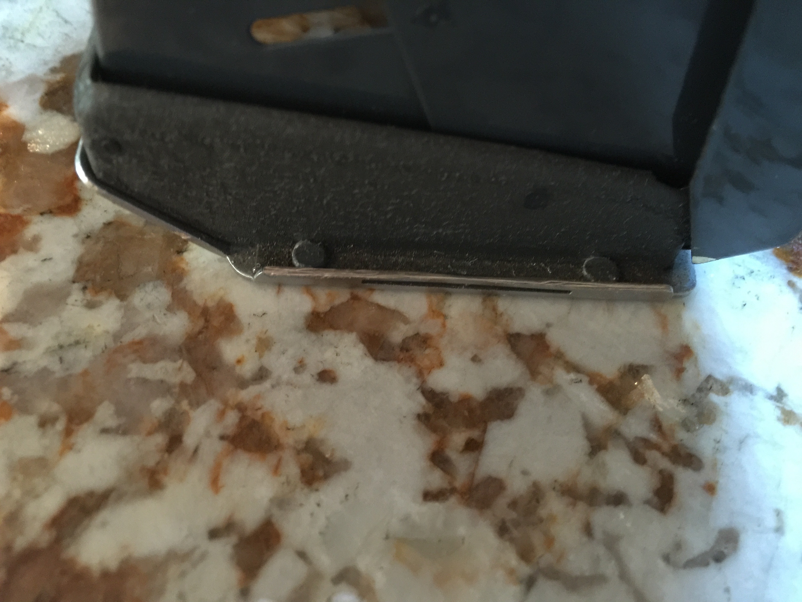

I then filed the view finder bracket top edge to clear the added thickness of the EL sheet and slide. Works perfect and no worries about binding or clearance too.
I may add some black pinstripe tape around the outer edge to hide the light bleed and picture frame it nicely.
