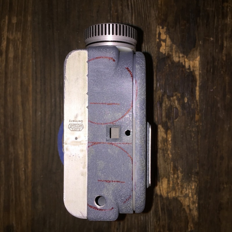

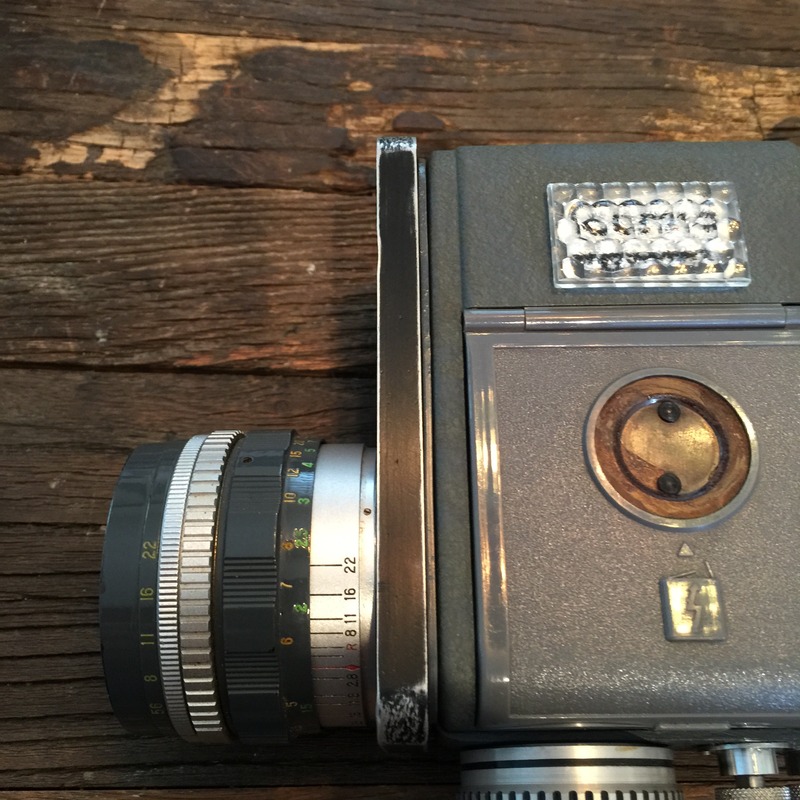

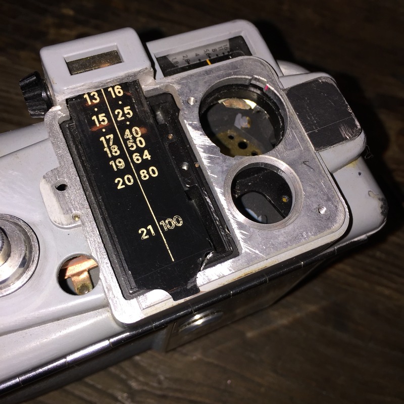

Some Progress. There was a gap between the lens plate and the Eumig body so I used the flash plate from a Lietca handheld flash, flattened it out, and shaped it to the camera body.
Painted it grey, I think it looks better but most of all it's nice and solid.

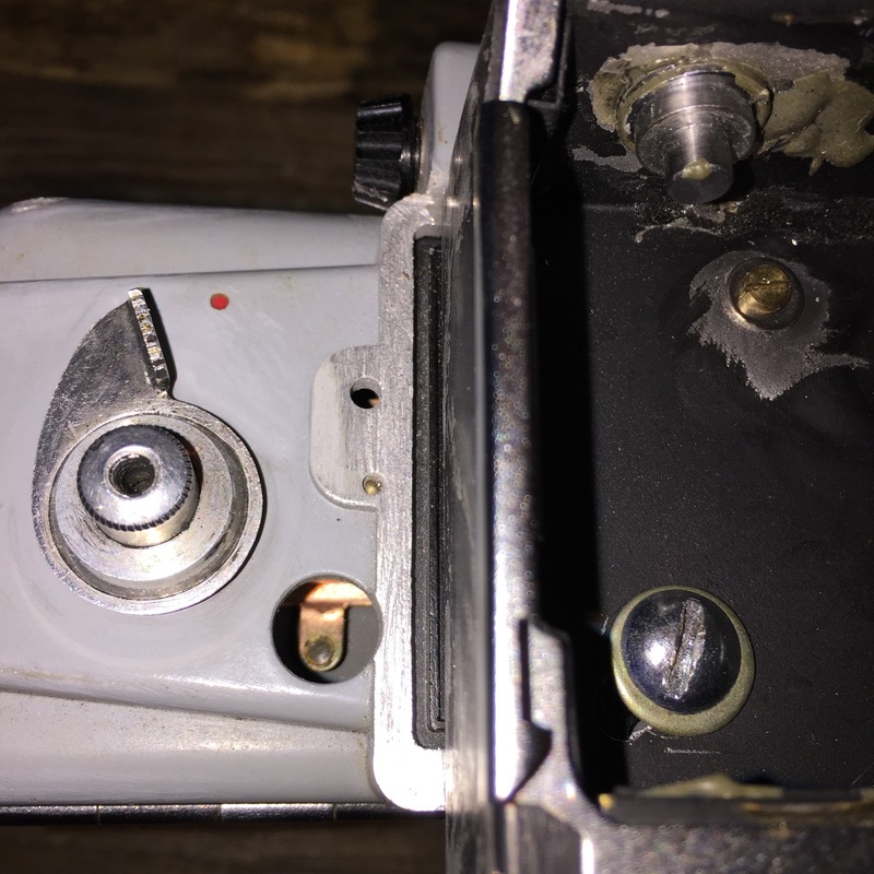

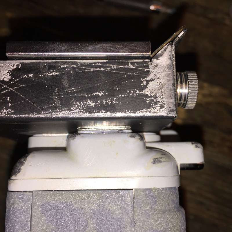

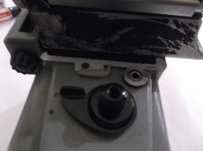

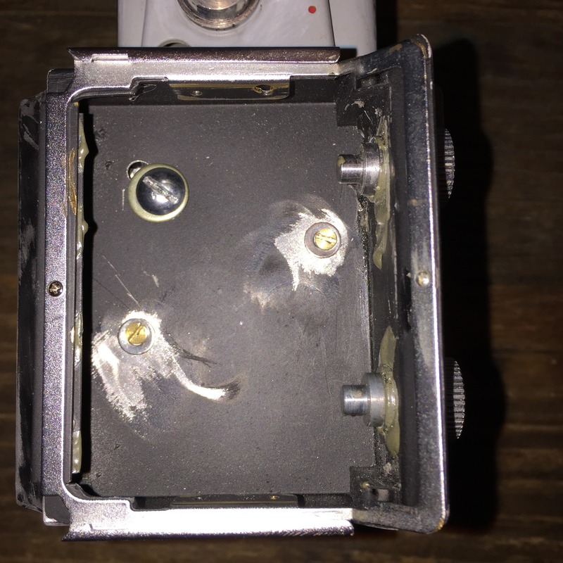

Made 2 thin pieces of sheet aluminum to shim the transition box at the original Eumig view lens for the other side of the transition box that overhangs the Eumig body.
Mounted the transition box with another screw that goes all the way through the Eumig body so it's nice and flat.
More progress pics -

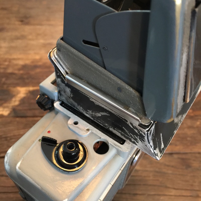

Filed down the Eumig body so that the triangle box would sit level and lower.
With the transition box mounted

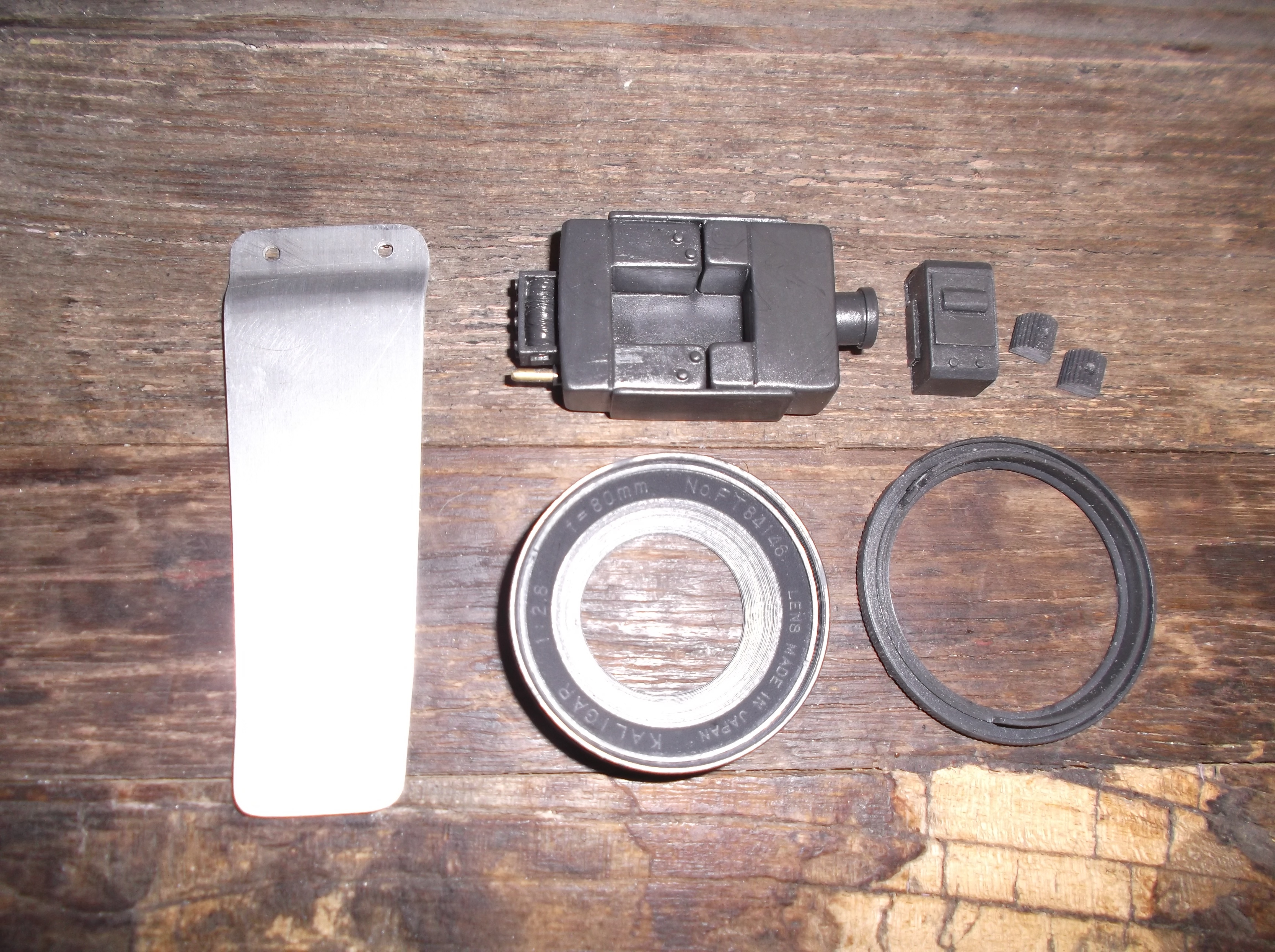

Still need another Kalimar for the lens mounting ring & lens, and make the triangle box. Trooper is sending me the unidentified box and the Kalimar lens finger nubs! What a cool guy!!!

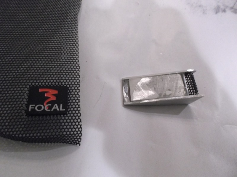

Built the triangle box today. Draw, buy stuff, & cut!
Put this together from aluminum C channel, flat stock, and an old speaker grill

I chose to leave the Eumig button unpainted for now. I love how the aluminum triangle came out with the speaker mesh. I added a piece of the aluminum plate to the inside of the triangle at the same angle of the face cut so the mesh would have a backdrop. I liked how ZombieKiller used mesh on his, so I tried my version. I know this isn't seen in any of the reference photos, but it finishes it off nice and there's a bit of interpretation on this prop. I also like how the holes I filled in on the Eumig body keep the triangle level to the transition box. I'm real happy how this is coming out for my first prop!

Trooper Jerry is sending me an aluminum belt clip, his resin cast mystery side box, and a few other parts so I can finish these up. Jerry's a great guy and incredibly helpful!

I used some aluminum stock C chanel and flat stock I found at Home Depot. I simply cut it, glued it together w/ 5 min epoxy, sanded, & painted it. The mesh is from an extra speaker grill I got at my local stereo shop bent to fit in the recess. The little round aluminum part w/ the black cap on top is from the Eumig parts removed.

I came home to a Priority Mail box from Super Jerry AKA Trooper with a belt clip, mystery side box, lens knobs, and Kalimar lens parts. Jerry you are a fine gentleman. Thank you again! Painted up the belt clip. Sanded & primed the mystery side box too. Now I'm gonna have a cocktail, cheers!

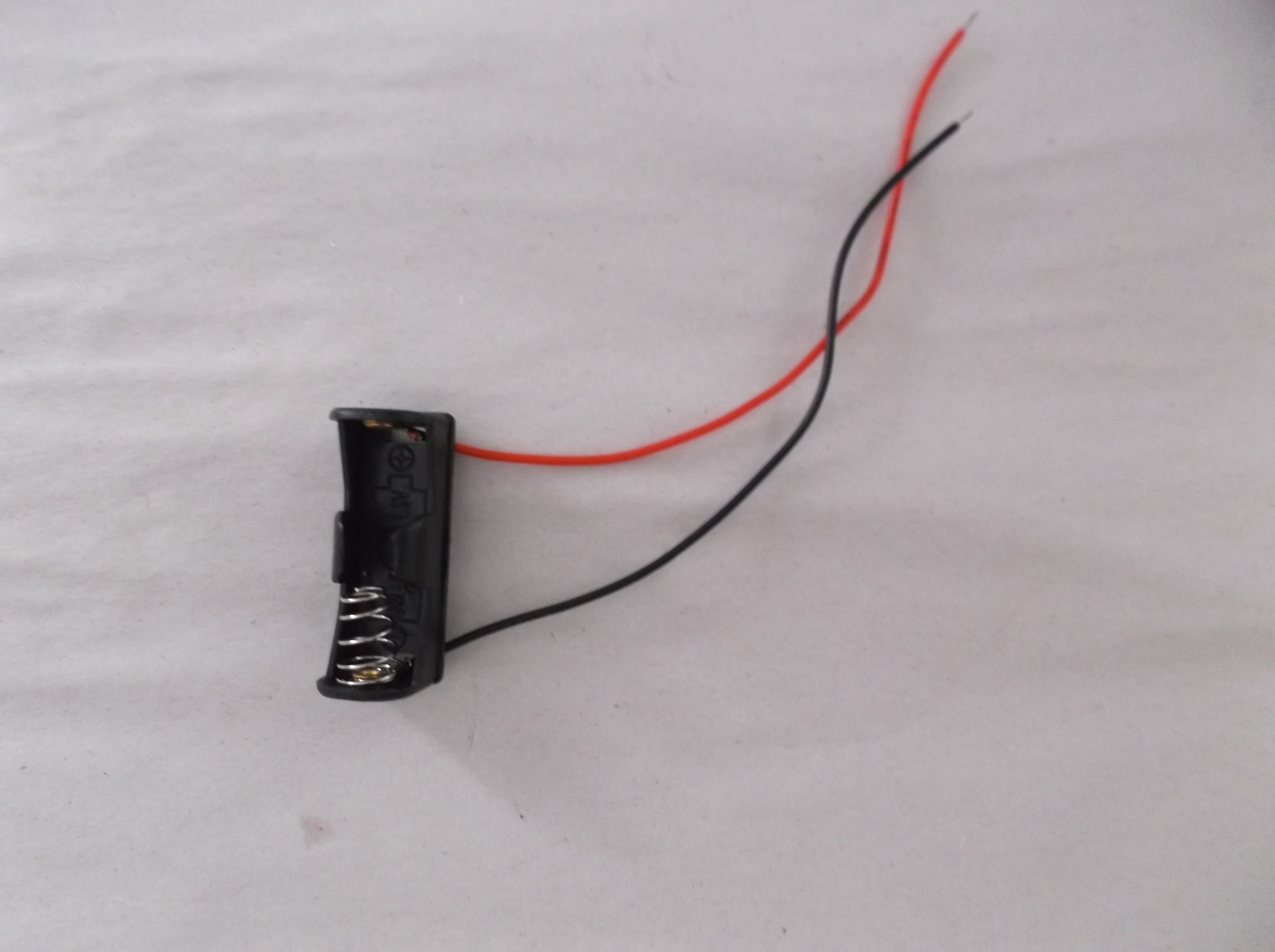

I received my A23 battery box from good ol' China.

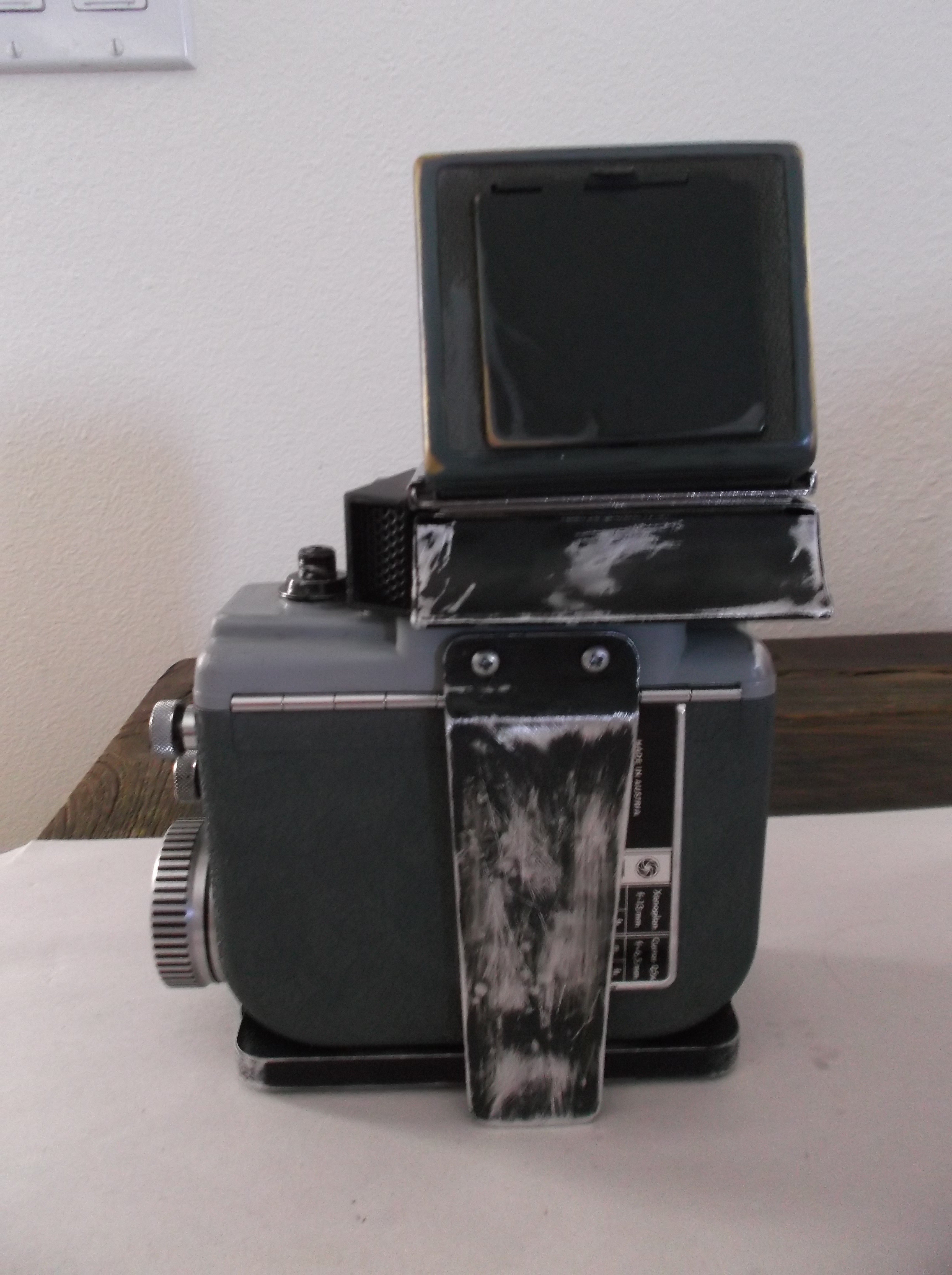

Bad pic but I used these spacers for the belt clip and they're perfect

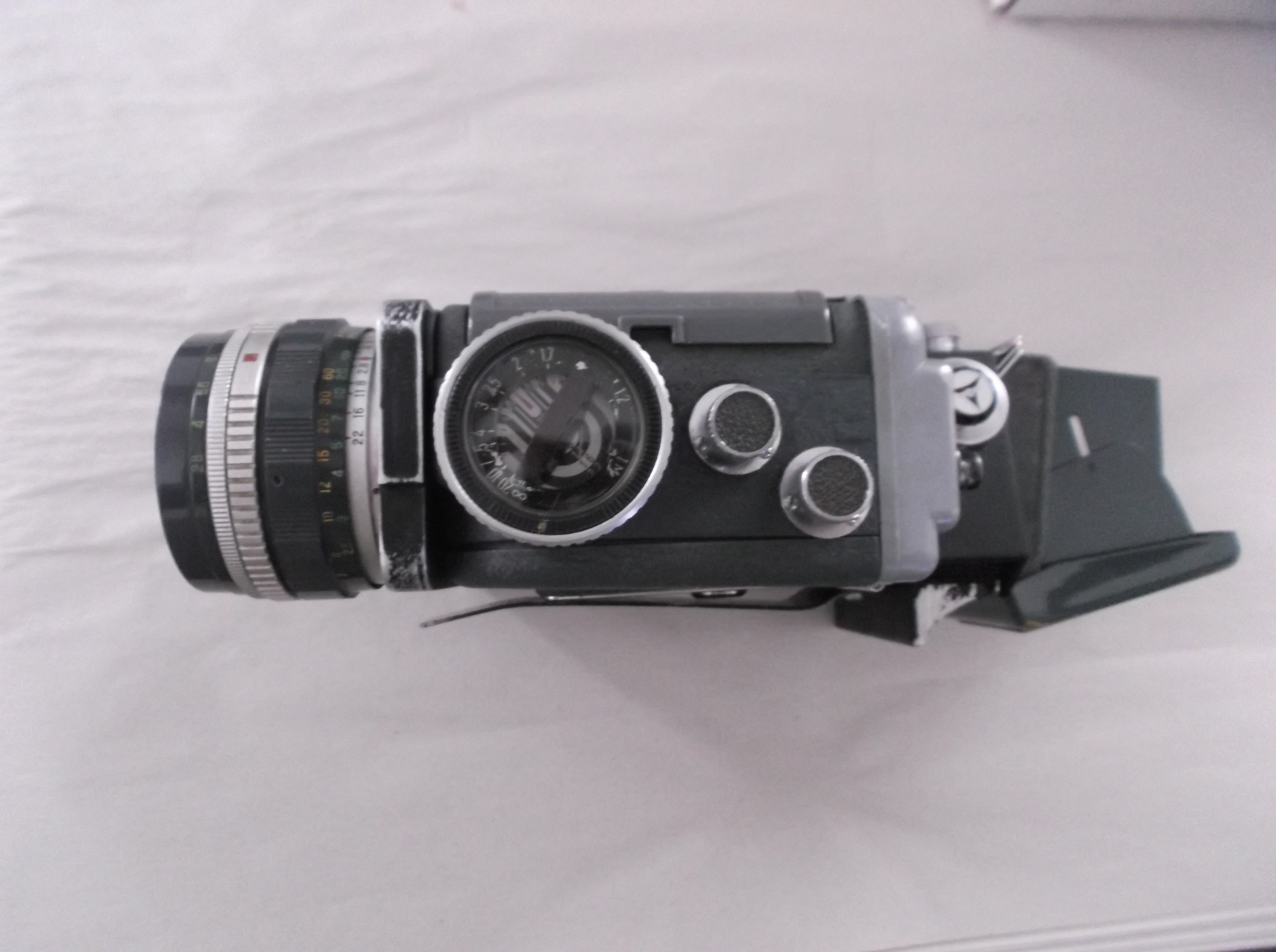

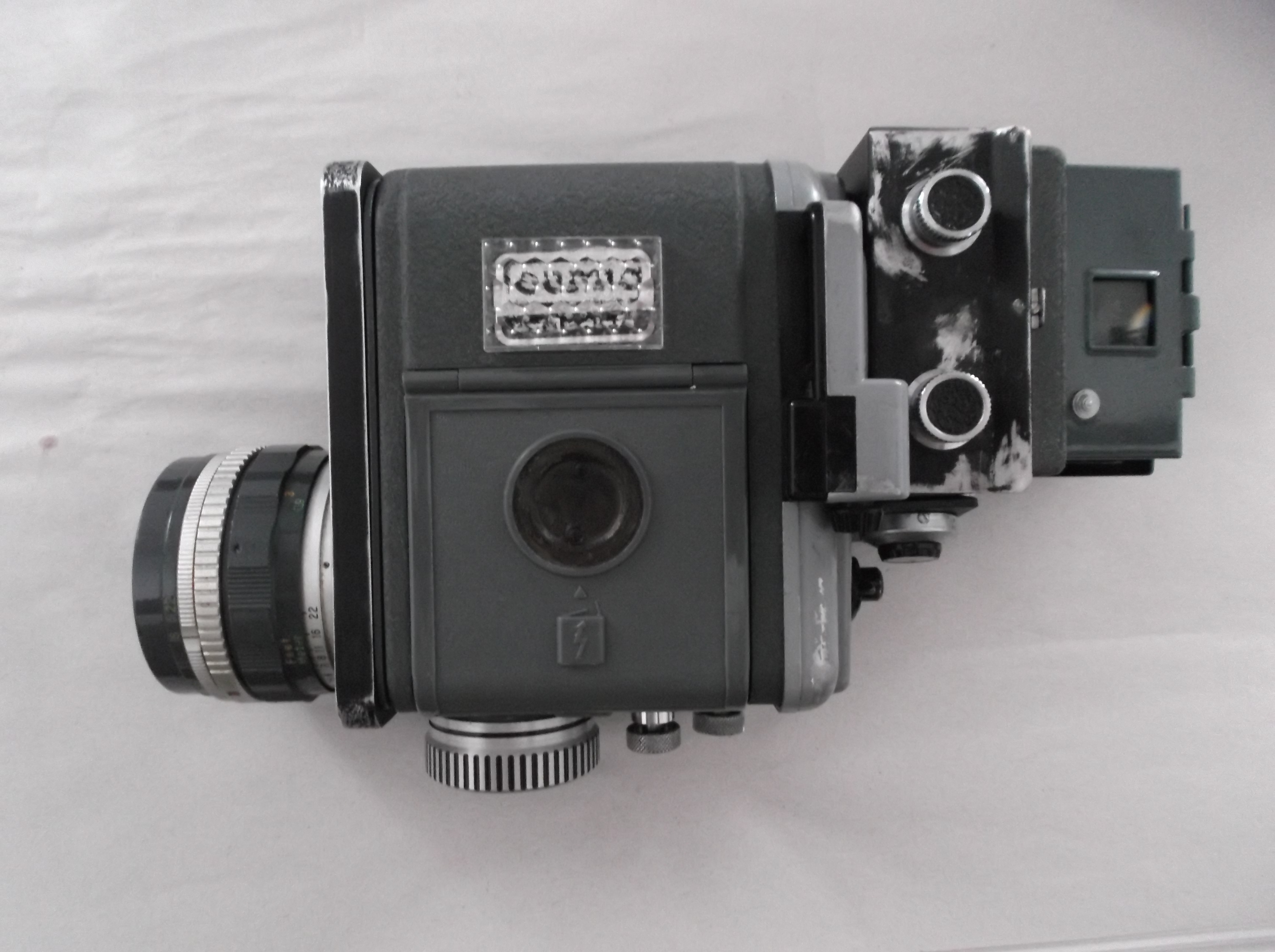

Here's a few pics of where I'm at right now. Still need the mystery box installed and another Kalimar lens....
