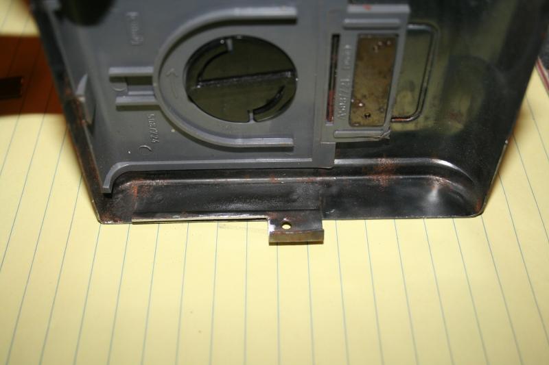

Stripped the Eumig
Cut the bracket to clear the lens plate screws

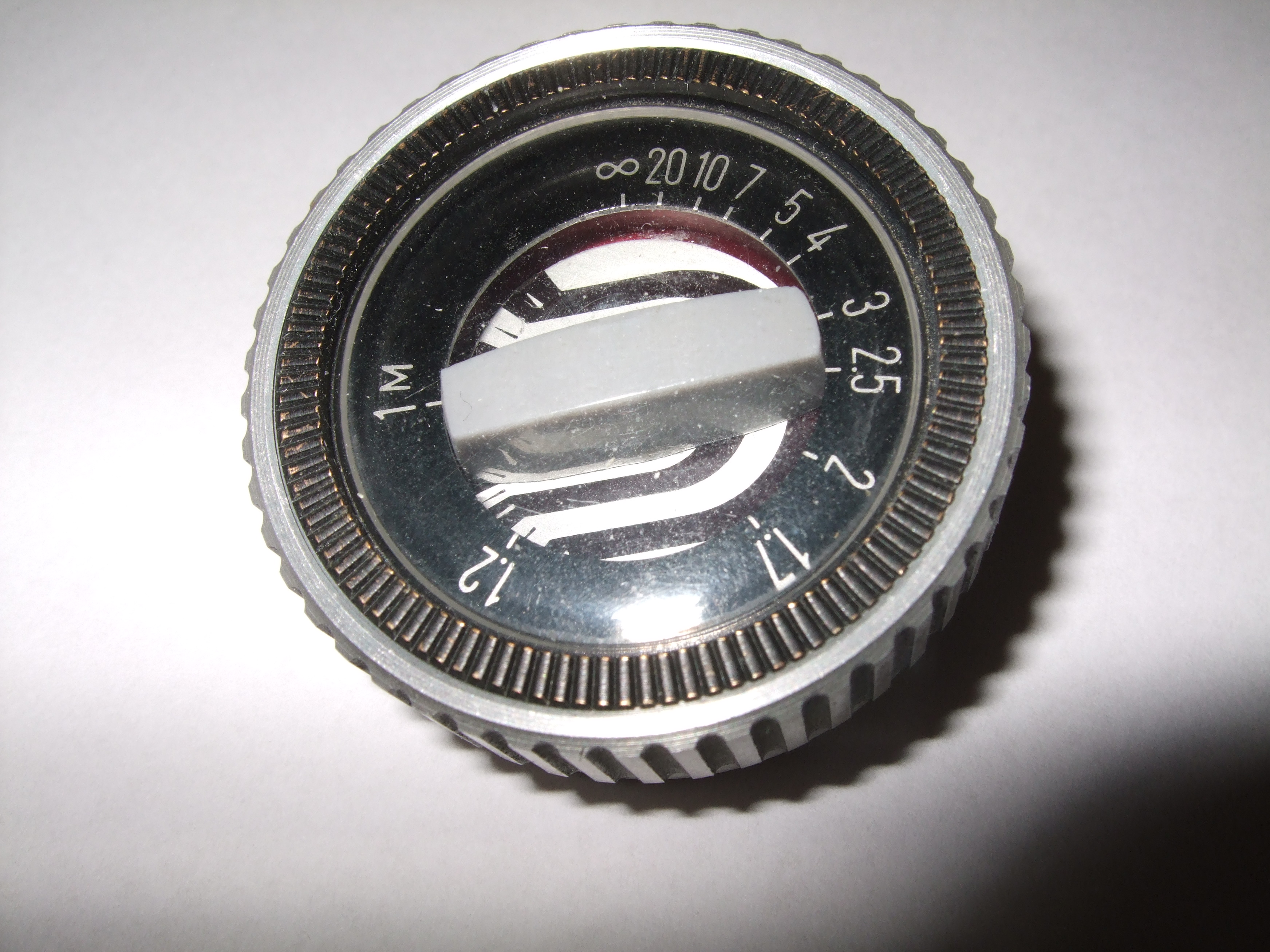

I want my Seagull knob to "look" like it works - I want it to spin. So I removed the chassis section from below the knob.

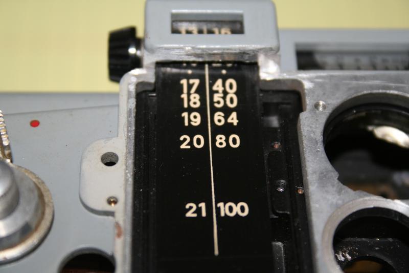

Got my Russrep lens plate.

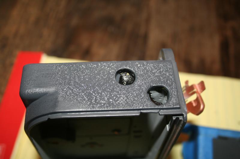

Made some good progress this weekend. I drilled one of the Kalimar button holes wrong. The new Eumig I got wasn't as nice as the mis-drilled Eumig, so I decided to fix the hole. I made a thin piece of metal and epoxied it to the inside of the Eumig so the Bondo would have something to hold on to, Bondoed it up, a little spot putty, primer, and some Wrinkle finish automotive trim paint and it matched the finish perfect. Touched it up and it looks perfect!

There is an easier way to put the seagull together without a back plate. If you drill through the center of the Bell and Howell and counter sink it you can put a screw right through the middle and cover it with the Seagull patterned plate.
Marv, I did mine a little different.

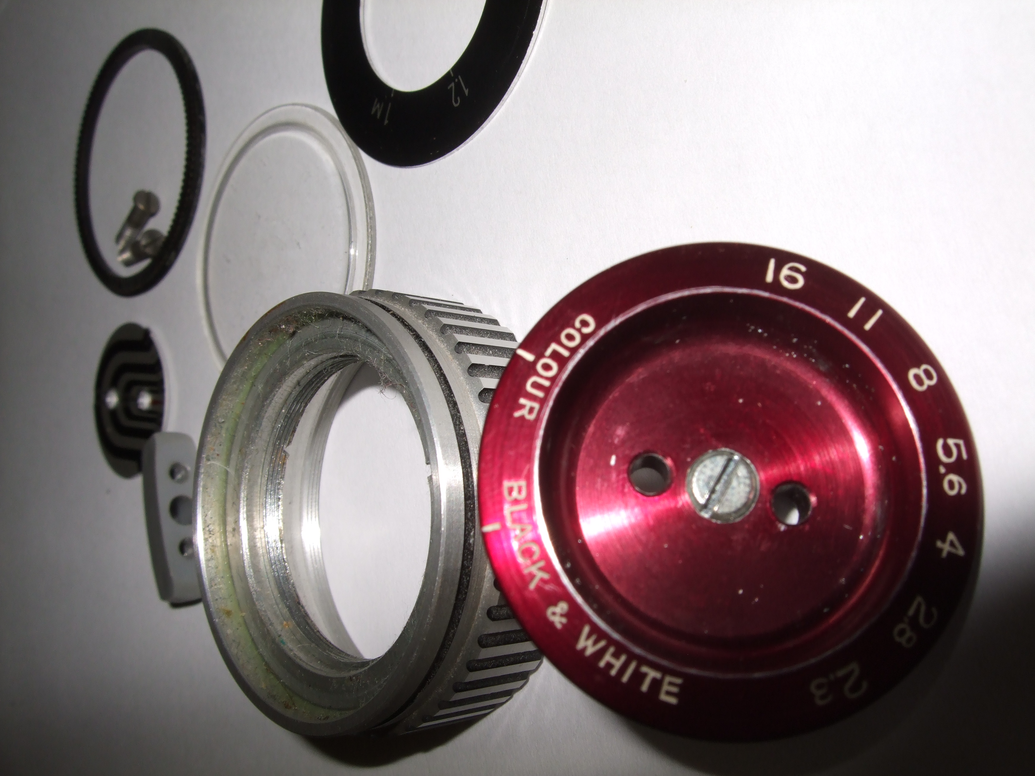

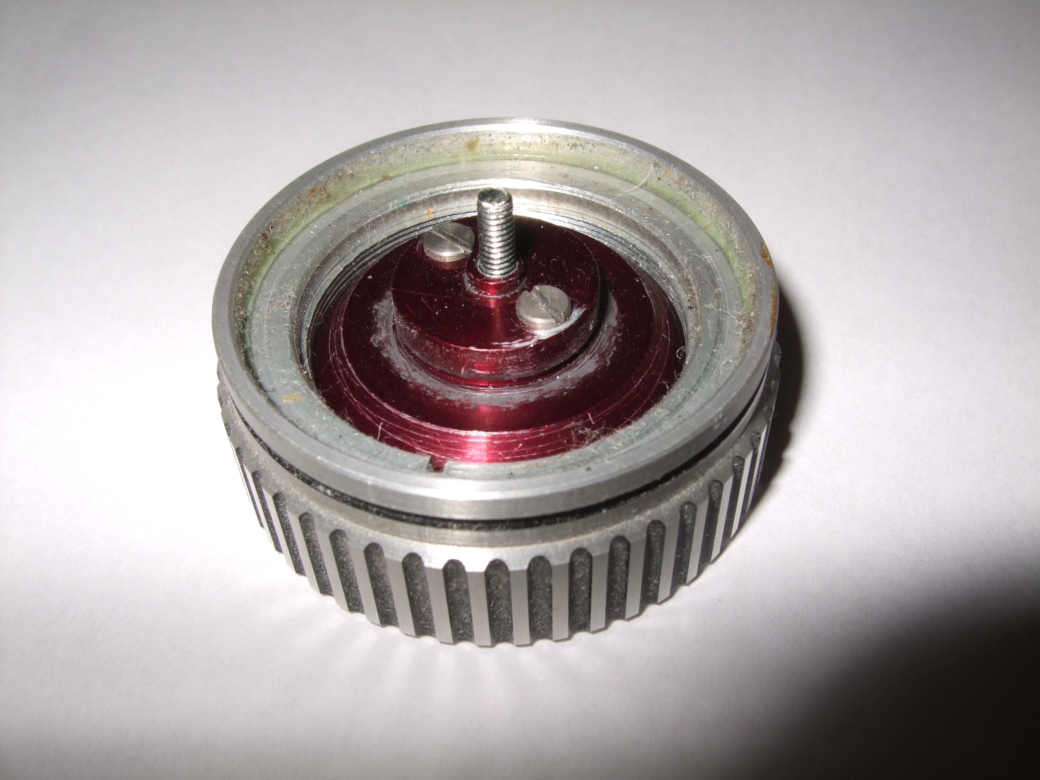

Drilled the Eumig and cut down the head to clear the screws in the Bell & Howell Knob
B & H knob

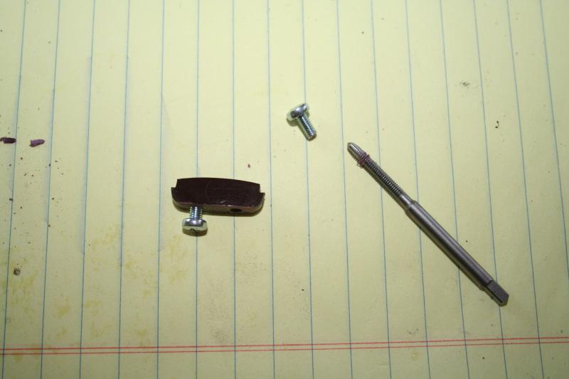

Notched the maroon B & H knob and tapped it for 3mm screws
I notched the 3mm screws on the back of the B & H knob to drop down as low as it could in the Seagull knob. I used the Seagull aluminum ring to shim up the B & H knob and the tan plastic ring to keep the B & H knob centered.

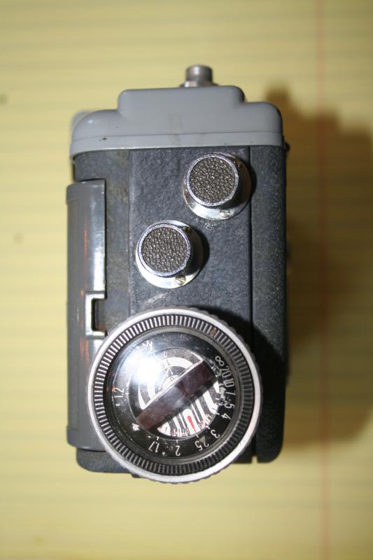

Then drop the black screen printed aluminum ring onto the maroon B & H knob, then the clear lens, then the knurled black keeper ring, then the Kalimar pop up knobs with screws and this side is done!
Lastly, I painted the Kalimar pop up view finder black. I'll start on the view finder mods when the transition box shows up. Thanks for the help Marv & Markus

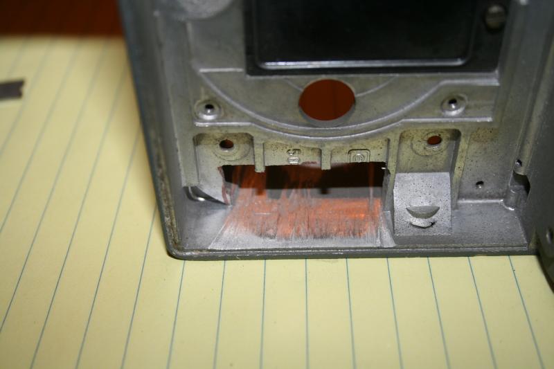

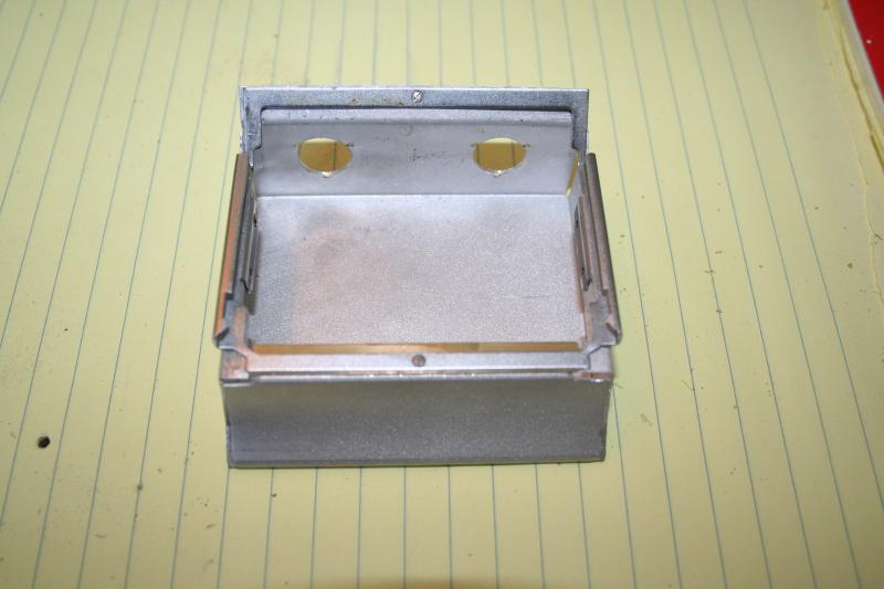

Filed off the lip below the window so the transition box can fit snug

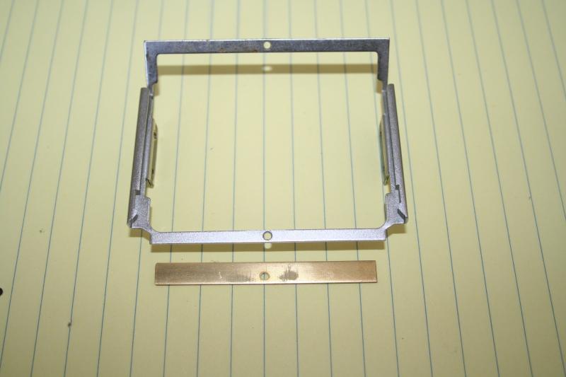

Made a brass shim for between the Transition box and the view finder chrome frame
T Box with shim and tapped screws

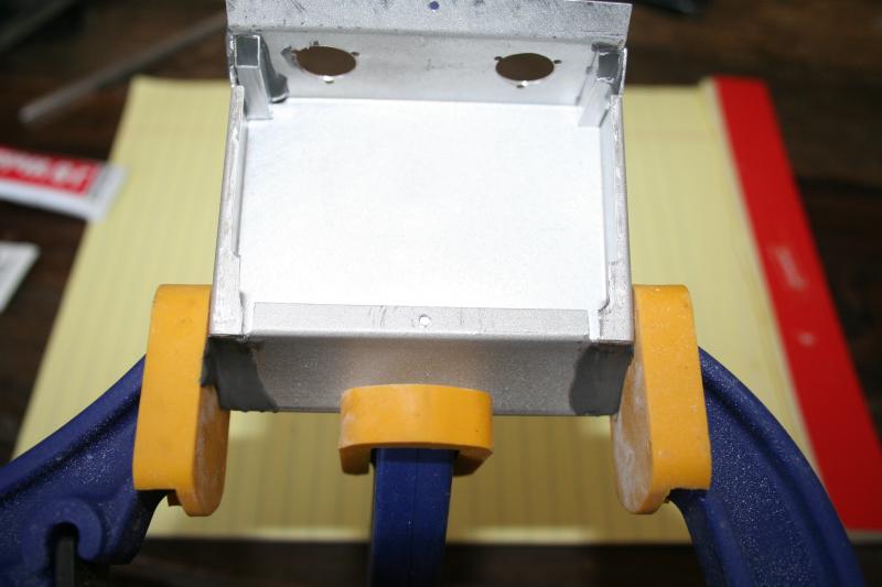

JB Welded the T box seams
