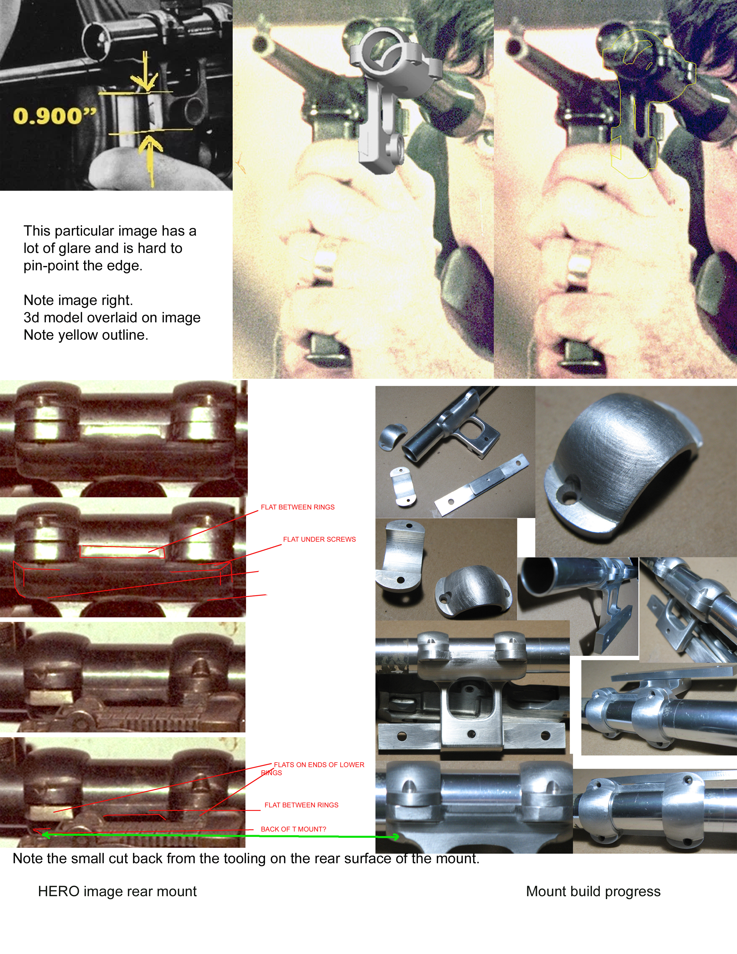

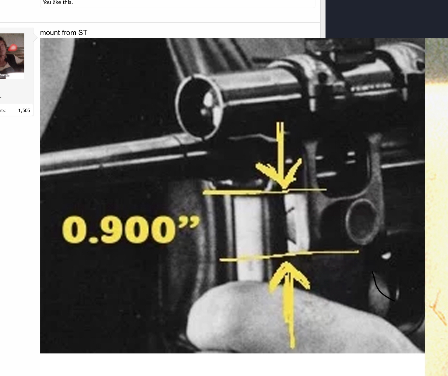

Ya you shared this with me a while back. That’s actually my pic in the top right of ur collage. I used this back then in detail when redesigning my mount :)
Which pic in the top right? The Sitting target scope mount overlays.? If I recall correctly, I think these are the overlays I made way back to prove out
Deadbolt's 3d modeling of the scope and mount. As it turns out the parts were very very close.
Top left! My bad. I get those mixed up every now and then!
I was asking a question using this image and u answered by inserting it into that collage. It was very helpful. Thank you again

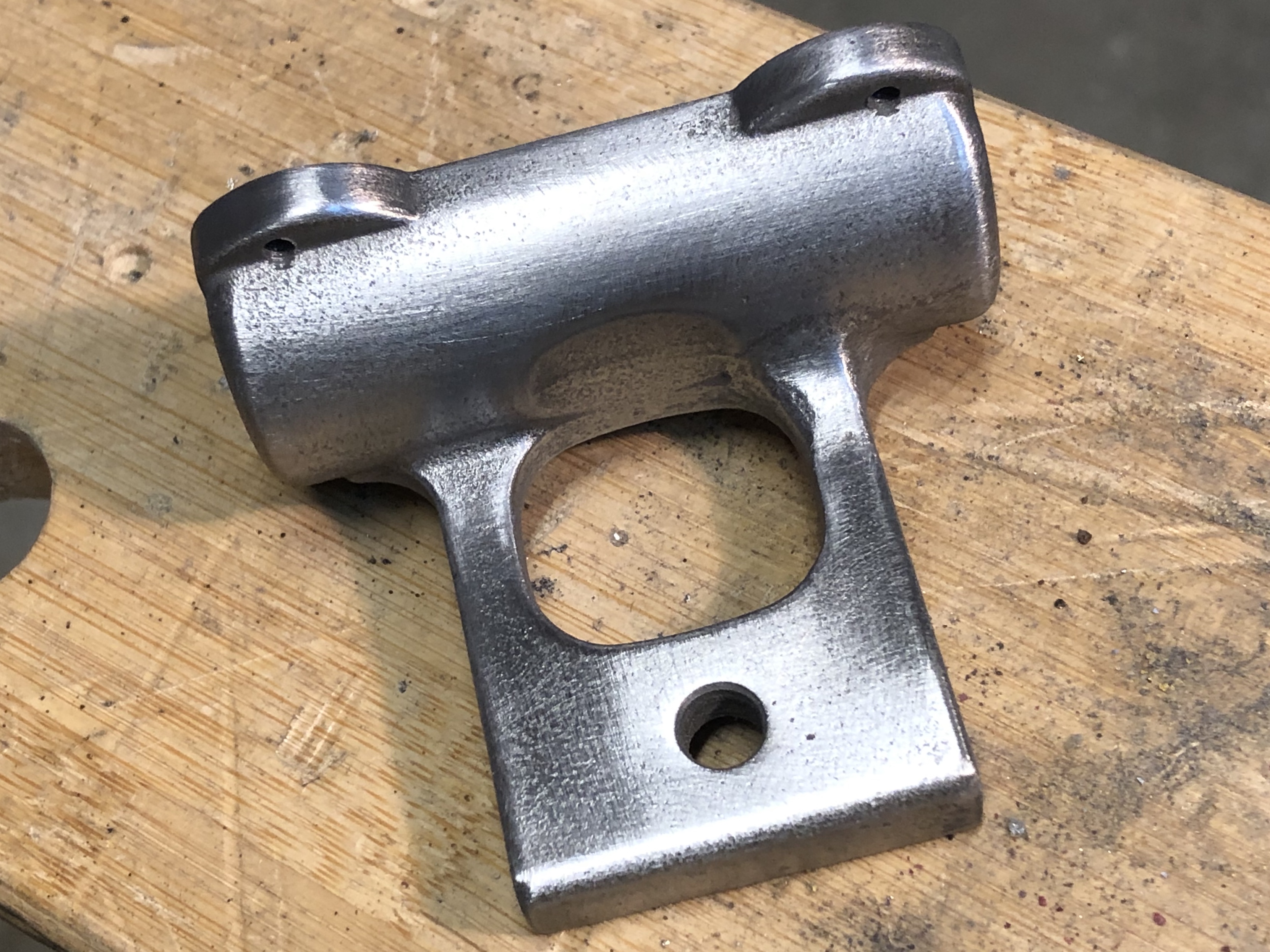

Dangit, I forgot to grind that flat on the back bottom/underside of the cradle! I've done it on other cradles in the past, so I swear I totally already know it's there, I mean it's fairly obvious. Hehe

Yeah, that was all hand-sanding, it took a long time!
Thanks, I think it looks much better with a smooth cradle/mount.

Dann you’ve inspired me to have a go at my FM mount but man that is a LOT of sanding! Still need to sand it some more. How did you get urs so smooth??!
Looks great!
