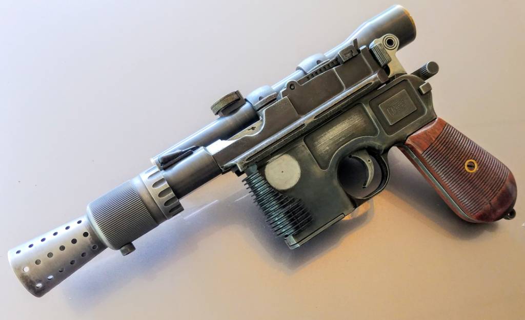

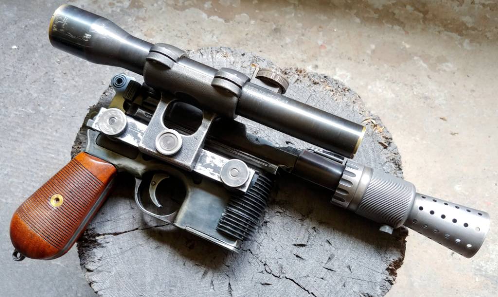

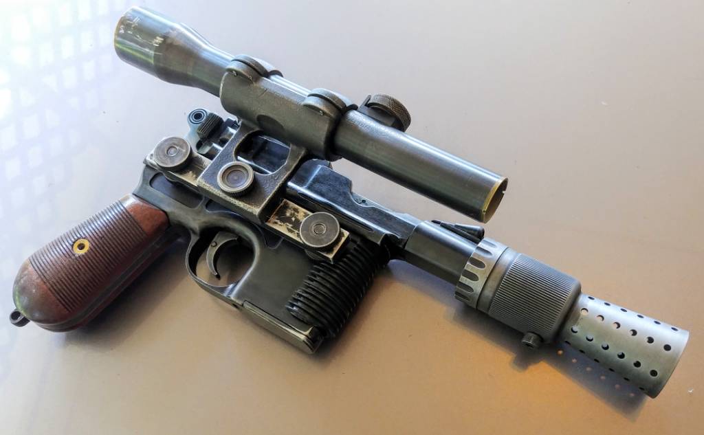

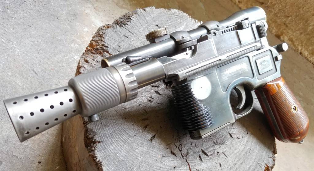

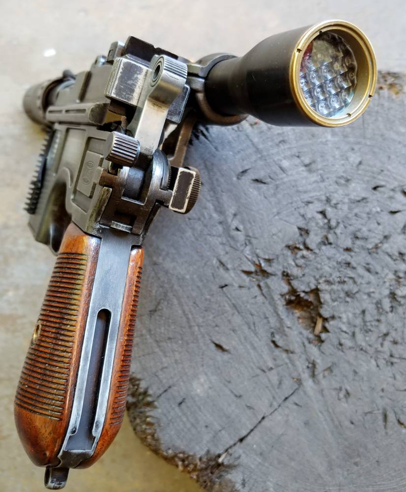

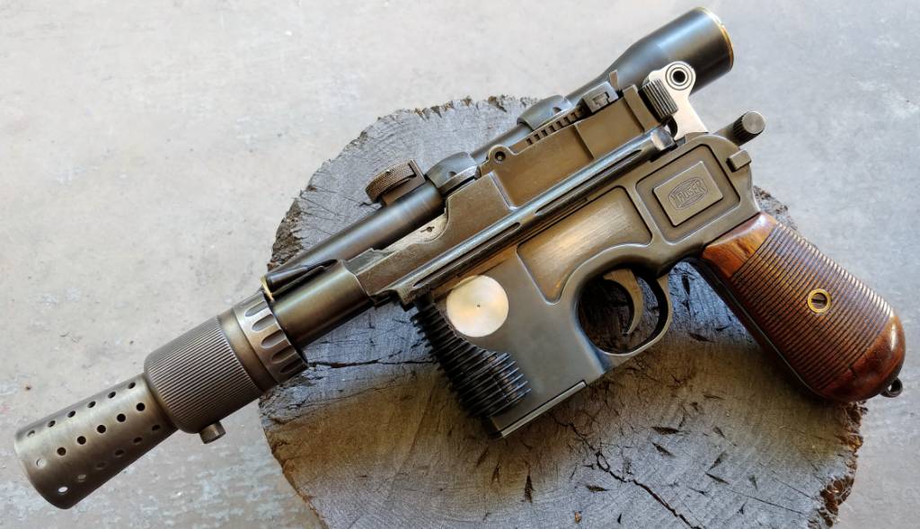

Nice work! I did mine last night, pretty much used all the techniques you described.
It turned out pretty good! I've also been playing with the finish on my flash hider. Trying to get it a little lighter in shade, more grey. It may be a touch too light as it is now. The body looks good, but the cone is too bright for my taste. I may play with it some more.

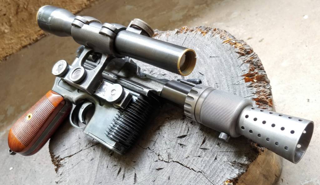

View attachment 942645View attachment 942646View attachment 942647View attachment 942648View attachment 942649View attachment 942650View attachment 942651View attachment 942652

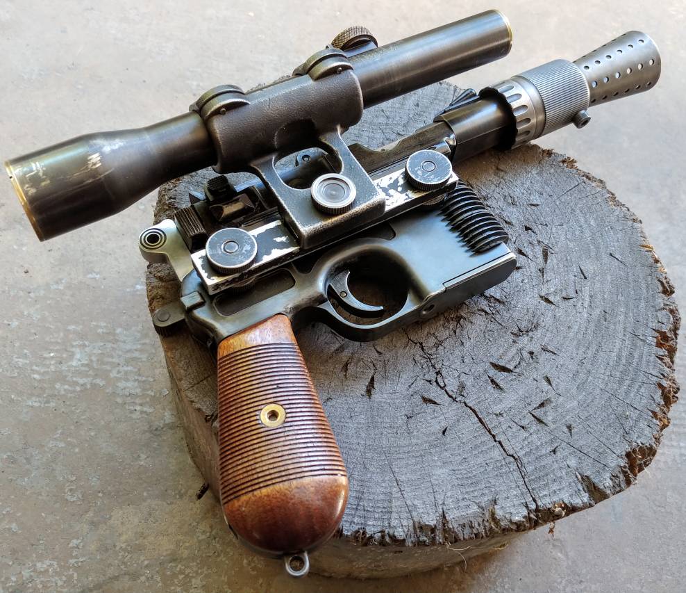

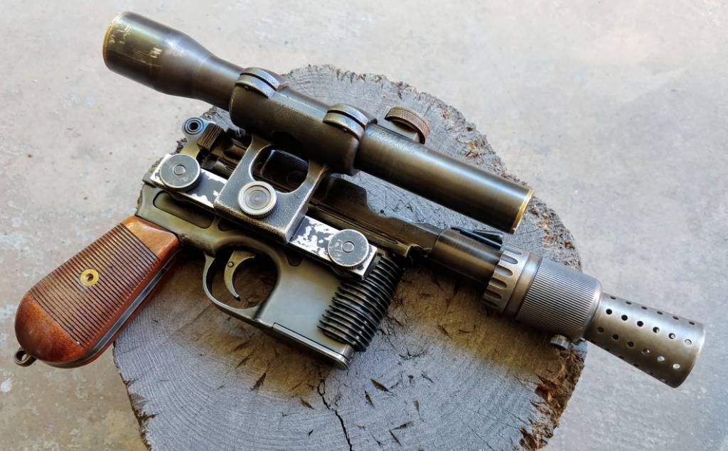

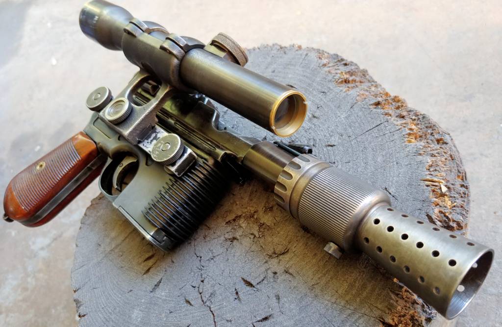

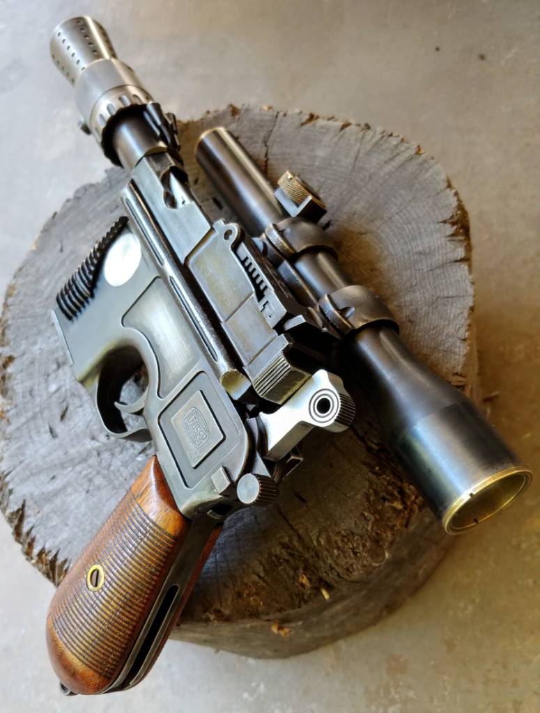

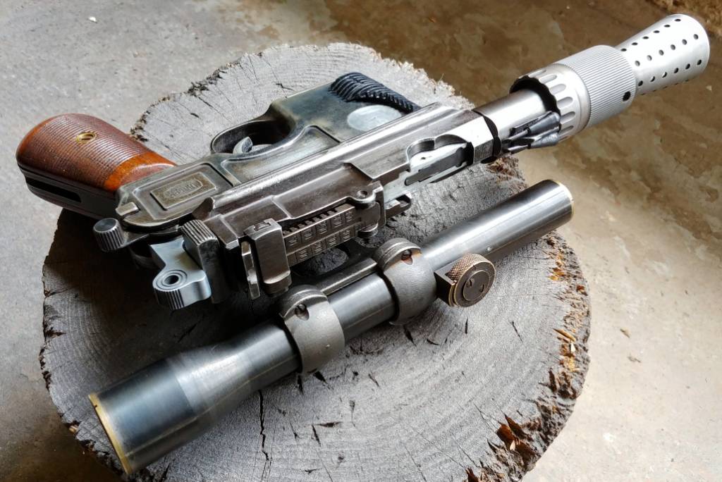

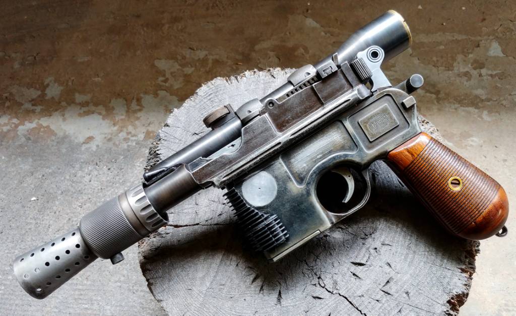

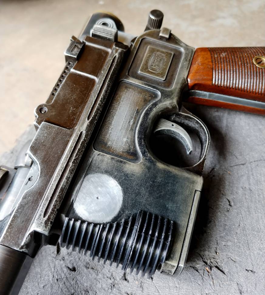

Did a little tweaking to the finish on the flash hider and the MGC...
View attachment 942653View attachment 942654View attachment 942655View attachment 942656View attachment 942657View attachment 942658
Hey Dan, Who's scope mount did you go with? Nice work by the way, It looks awesome
Interesting picture there. The windage knob looks to be at a less severe angle compared to the receiver than in other caps. It seems more parallel to the top of the receiver to me. Still off square, but closer than I thought previously.
