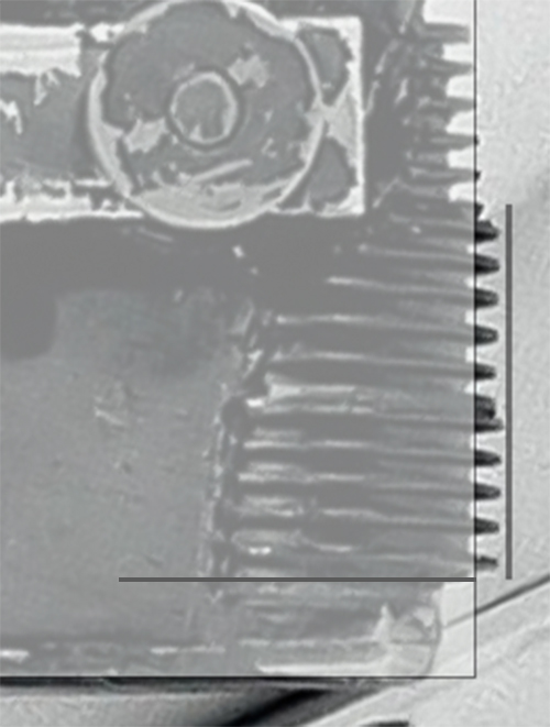

Here's a perfect 90 degree angle overlay, with the Mauser rotated so the bottom of the mag is perfectly horizontal. The front edge of the grills are vertical, but the ridges appear to angle up toward the back of the gun. It's apparent that none of the grill parts are perfectly cut, none of the edges line up vertically. This has got to be caused by perspective and slop, though I'm confused as to how you get a vertical front edge with angled ridges, unless the parts are warped! Slightly confused but still comfortable with doing them straight... :)
Ya perspective for sure has a lot to do with perception and if these grille cylinders hold true to the cylinders that are readily available today then warping is also probably a main factor to consider as well. The ones I've cut to date they do warp pretty easily.
These added straight lines do seem to emphasize the angle, as subtle as it is, even more so on the bottom grille [emoji106]
Clearly there is not an answer that will make everyone agree as to what and how this grille was achieved but it's interesting to see it in a bit of a different light.

I just rebuild the grille from the 3 individual cylinders trying to best duplicate what I perceive the grille to look like. I figure I have the parts, why not have a go at it and see how it comes out in the real world??
Also these are the best pictures I can find that show this grille from a few different angles. Not the best quality for the mystery disk side but what can you do..
And this is how it came out. I left it as rough around the edges as I could. Also it's not glued just tapped into place..

Ya it's tough to know what has or hasn't been covered with these pictures missing. Besides this HERO build will never be shelved anyhow. It will always be a work in progress.. at least until the real prop is finally discovered in someone's London flat [emoji106]
Nice job! Just about as close as you can get for duplicating the original.
The top section as you have it I believe is very close to original. Although I think on the original it is leaning back a little due to excessive glue underneath. Very hard to tell with the images as you say. The minor variations I think is due to your overly clean gluing!
I think the glue they used was the old single stage tube glue that hardened into a crystalline like glue that was strong but riddle glue when left in thick sections. I believe this is what you see on the edges of the grill and where the mystery desk is located and also on the upper rail where something was glued similar to the MerrSon sight.
This thick Glue was probably built up underneath the grill sections which caused them to be lopsided as your reproduction shows.

When we created the kit model, we idealized the look of the grill and simulated the non-straight walls as best we could to be able to be machined in metal part and still have the over all look and feel of the original We figured the prop if done correctly would have had everything attached Street and even and clean. But like the flash hider, the real prop is wonky. And lots of people like it that way.
Thanks ever so much kpax for the kind words! Means a lot coming for a person as invested as yourself with these builds. [emoji482]
I not sure if that residue is from glue or if it's what was left behind after a rough saw/cut when building these cylinders. What is clear is they certainly didn't do much polishing work.
I actually had it looking very clean at first. With the sides pretty smoothed out and flush with Mauser. Took a lot to rough it up lol.
But when playing around with how these cylinders are actually attached. I think the angle on both the bottom 2 and the top are simply from pushing them onto the Mauser itself. They pretty much naturally take that shape if u don't manipulate each to be straight. Or at least that's what I've encountered anyhow.
As of right now that grille is just tapped in place. No glue just yet.
Makes sense that the sections would push up against the Mauser magazine wall at a slight angle since the inside cylinder core must be molded with a taper to release from the mold. Just a few degrees but noticeable.
I agree that the edges were mangled quite a bit on the original but figure there must be some glue there as well since it seems fairly tight to that body on the original. Glue, paint, schmutz. Sloppy is a simple way to say it.
I would think that those parts were glued and re-glued several times after test firing. The original movie gun used fairly powerful blanks which rattled the frame quite a bit. No doubt shook parts off including the left antenna, mystery knob most likely, and maybe whatever was glued to the rail. That or Butterfingers Ford dropped it several times.
