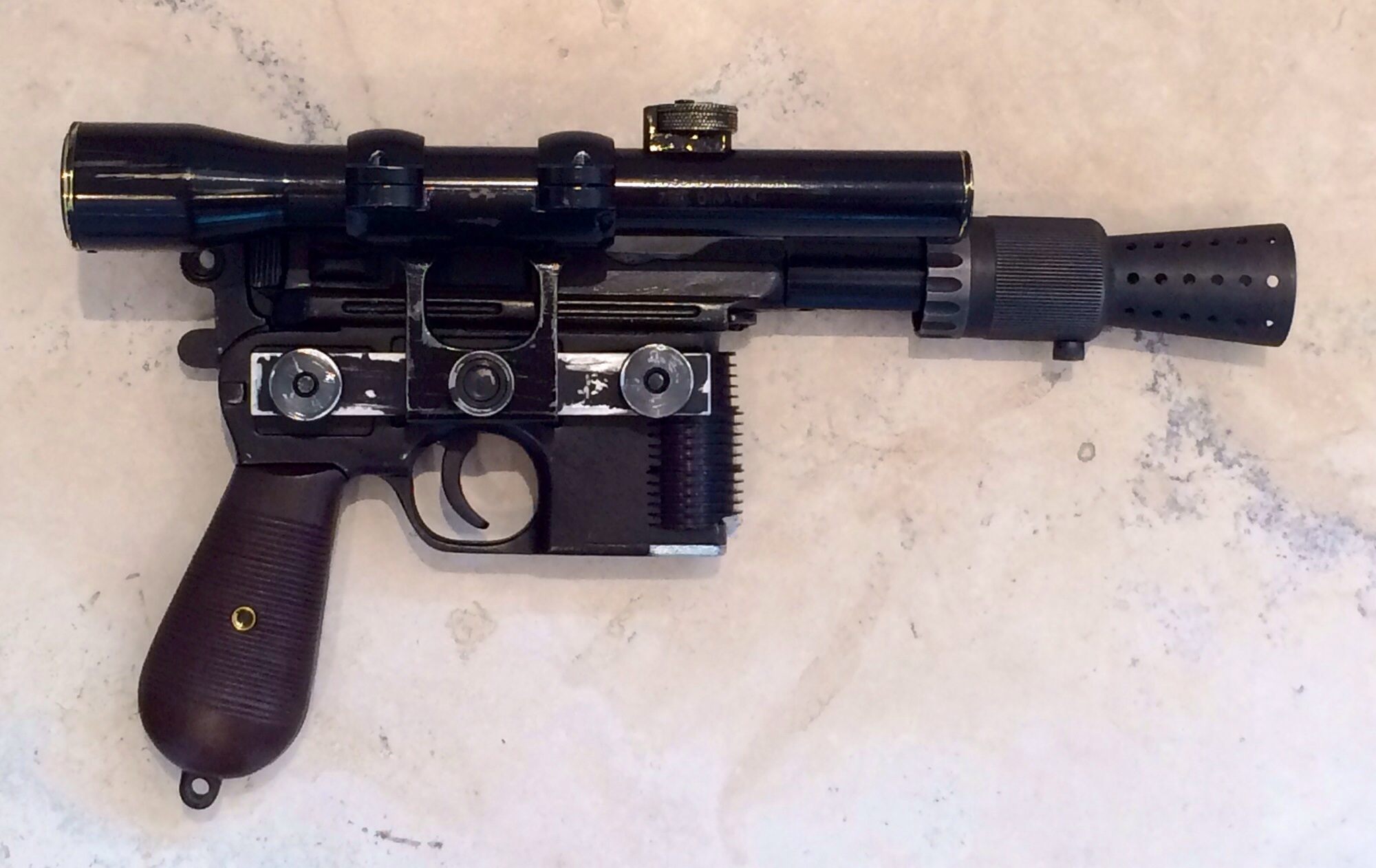

FINALLY finished my Han ANH blaster build from the original run! It's taken a while but I'm happy! Thanks again to all for making this all possible.

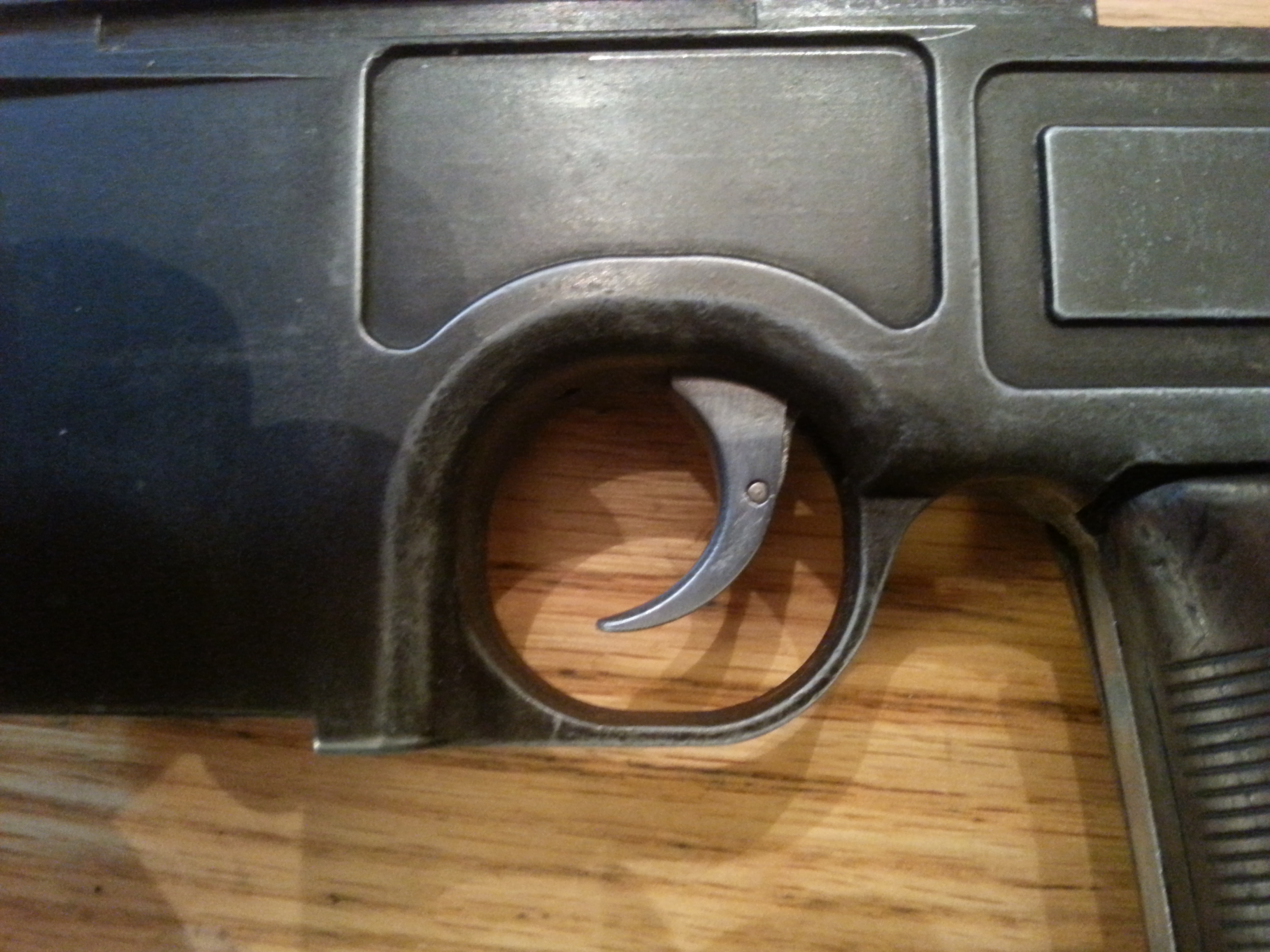

BTW, does anybody have any good ideas as to what to use to fill in the pin holes in the MGC Mauser's slide and trigger? I have sanded my slide and almost finished reshaping the trigger, but I really want to fill it with something before final polishing/bluing occurs. Should I use a putty, some solder/flux, or what? What would stick reasonably well and cover up good?

Why not trying the black JB weld, has got metal fibers in its formula and I think would work great!
Only con would be the long setting time required!

But does JB Weld take bluing? I'll have to reblue the trigger, and my slide will be left bare metal, except the extractor, to match the cantina pics of the DL-44. So the material that will fill the pin holes in the slide will have to be silver and bl3nd in well with the bare slid3, and the trigger will have to be reblued without looking off.
I would leave the slider alone or decide to use paint. I don't think there is any putty you could use that would be less visible than a real pin.
You could theoretically replace the pin with a longer one of a softer metal than the slide but which looks the same (even that would be difficult), hammer the ends so they expand and then sand these flush against the slide but after all that work the pin would still be slightly visible ...
Bare metal tarnishes with time, and the metals/putties would tarnish differently.
I would paint the trigger.

As for my Mauser, it is a MGC, not a Denix, although I have both. Still, should solder or flux not do the job well enough?

Regarding the blueing question obviously Jbweld being black will stay black, unless you paint to match the final color! But about taking sanding and milling it will!
