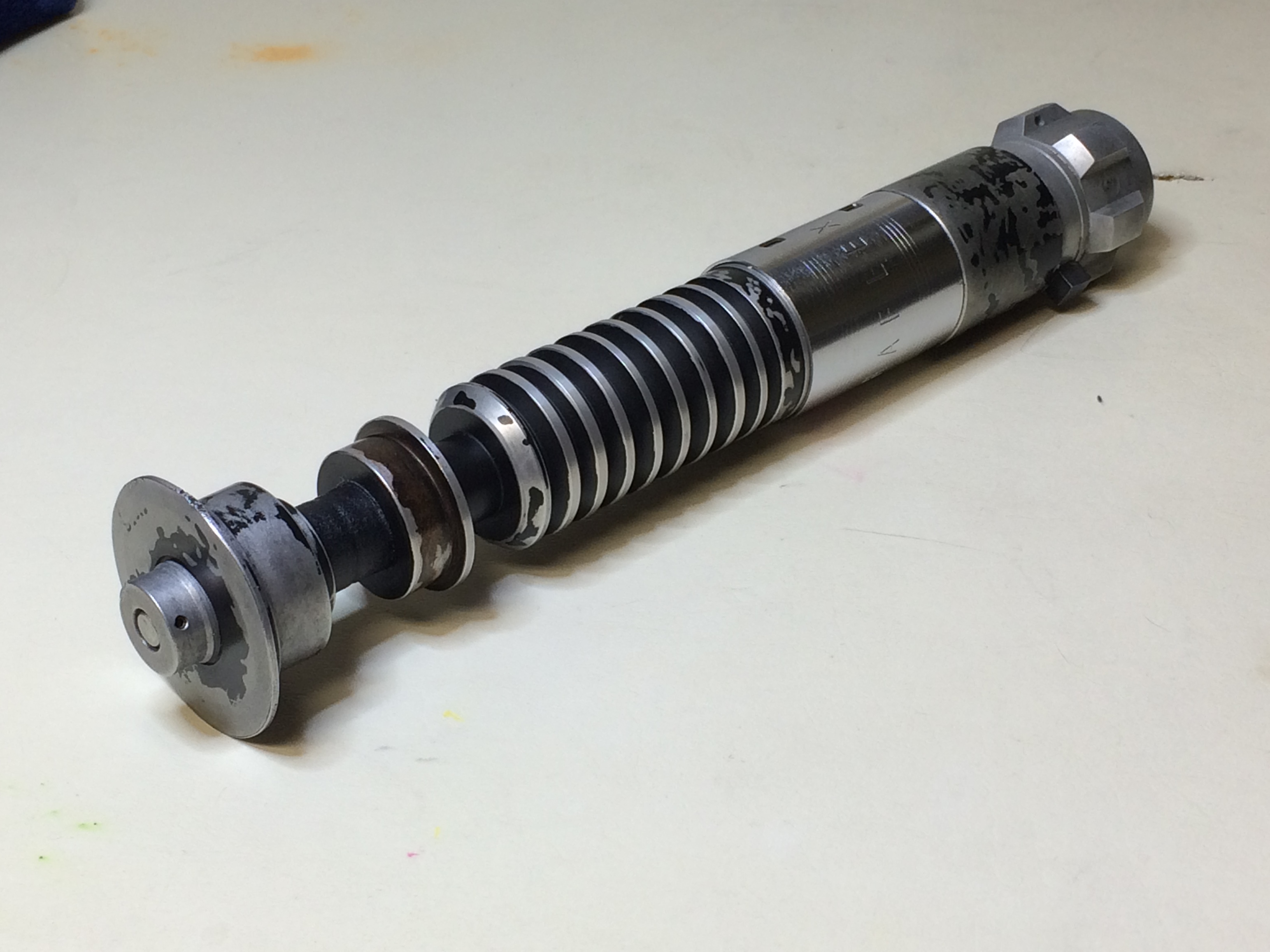

EDIT: I've been working on my V2 for a few days now (mainly weathering the hell out of that blank) and I tackled the paint job last night. Had a few minor problems with the stencils, which were mostly my fault. Long story short, I ended up "customizing" them a lot by diluting the freshly applied paint with a Q-tip dipped in thinner; this created a lot of more intricate chips, which made the paint job more realistic, IMO (at least when I compare it to the most recent reference pictures) I also had to improvise some smaller chips because the paint fused with the stencils in some places, taking the paint with them when I removed them. Regardless I'm pretty satisfied with the end results. Let me know what you think.

I like it! Funny how we take such pride in beating the heck out of our v2's :rolleyes
I really enjoyed working on mine and I love seeing the progress everyone is making, keep em coming.
Looks great! What did you do to darken the aluminum?
Thanks. :)
I started by deburring it in my case tumbler, dulling the surface and softening the edges. Then I dipped it in diluted Easy Off, which darkened it somewhat and dulled the metal even more. Afterwards I applied some Aluminum Black all over with a rag, taking care of not leaving any spots and repeating as necessary (especially on the booster) Then I threw it back in my tumbler to make the whole finish uniform and get rid of any unwanted stains. BTW I tried the dishwasher trick but it really didn't do anything for me, aside from cleaning the blank really really well (it was a good thing, because the tumbler fills holes and grooves with compacted dust) That's pretty much it!
