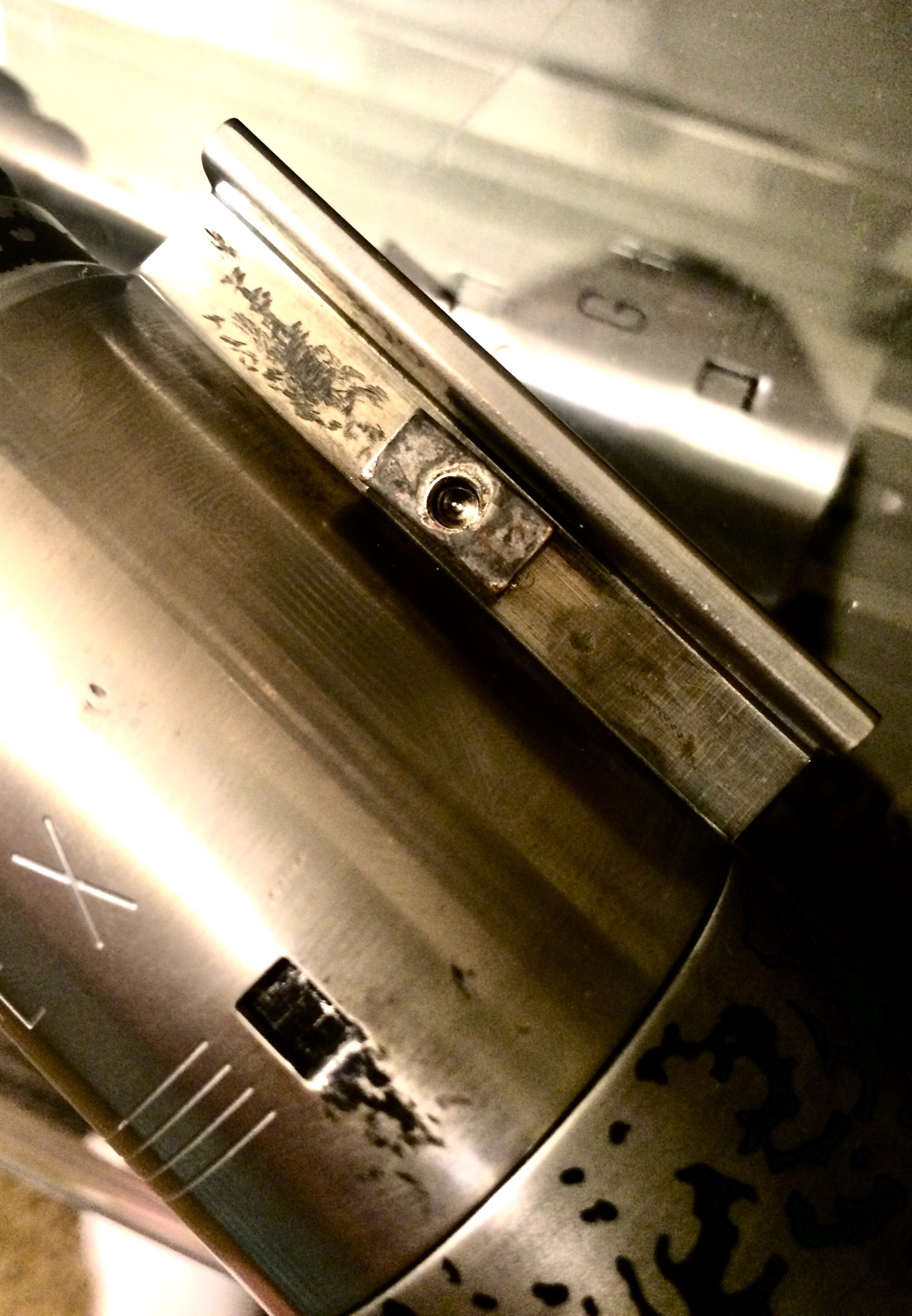

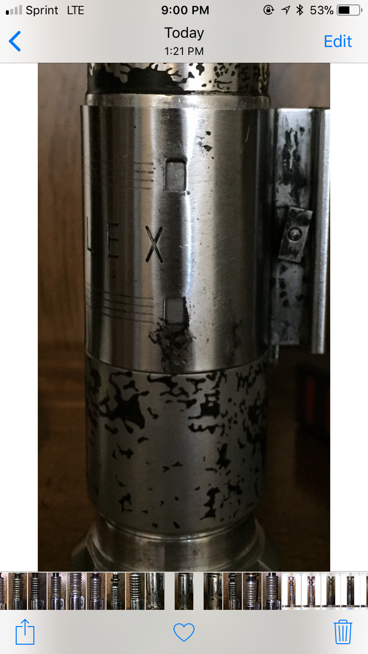

You might hate me for pointing it out, but I also did another scar just north of the nut in the groove where the clamp bar used to be. It may just be reflection but it looked like more rusting to me there and made sense since that may be where the original but rusted the solder holding the bar on the original. It may have blended in on my photos. I also found if you use super blue paste and let it sit a little too long in that groove you can get some of that oily darkening color.
also yeah it’s a pain getting those nuts out, sometimes they fall out with just a couple bends, all depends how much solder was used. I’ve found that just using two adjustable wrenches like you have there worked well to lock in and twist the whole thing flat.
Re: Anakin Starkiller FX V2 - Aging Weathering & Stencil Tutorial
I messaged you a really easy way to get the square nut out. I wish I knew you were doing that, I'd have saved you a ton of work. But it was really fun watching you fight it so hard. LOL
side note, are you sure that's physical damage on the clamp that you dremeled out? It just looks like gunk to me, like maybe the sticky stuff left over from gaffer's tape or something rather than a physical scratch / scar.
just curious what you were seeing there.
To me it looks like rust. It’s consistent with how Graflex clamps rust in spots, and the places where it’s happened make sense. Near the opening of the square hole where one tab was removed, where the open metal is exposed, and under the sidebar where water and moisture could have been trapped before the bar fell off. It’s so concentrated and concentrated to everything around it and every other side of that clamp that is perfectly shiny that I think it has to be rust. It’s as dark as the black paint below it. It also doesn’t appear to change photo to photo.
OK so maybe some of the plating had flaked off and oxidized.
Great eye!

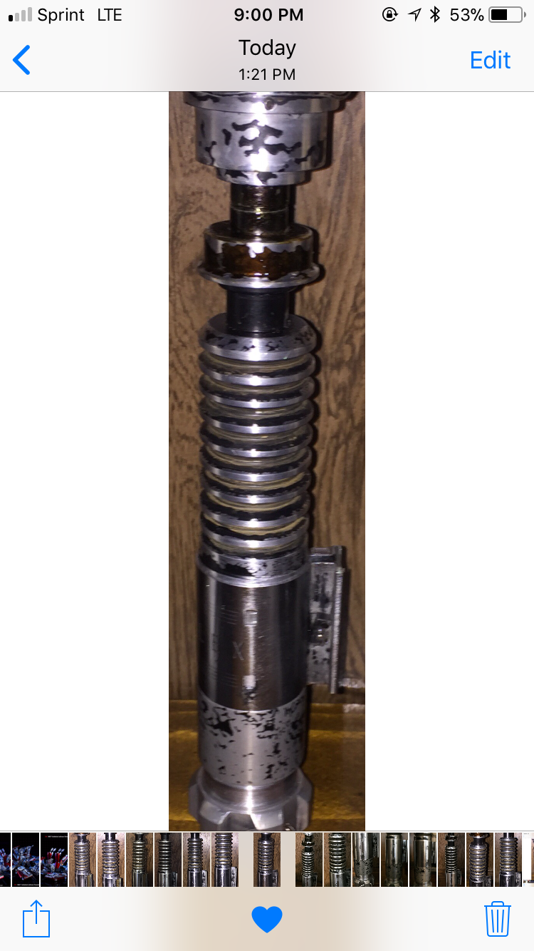

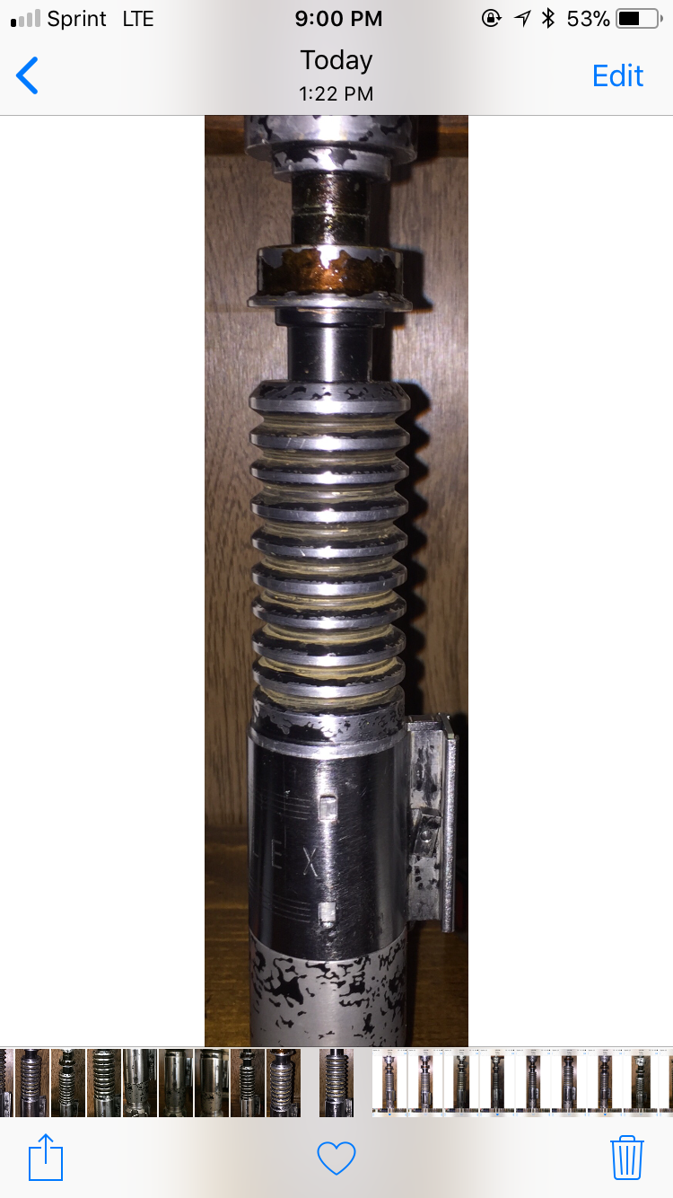

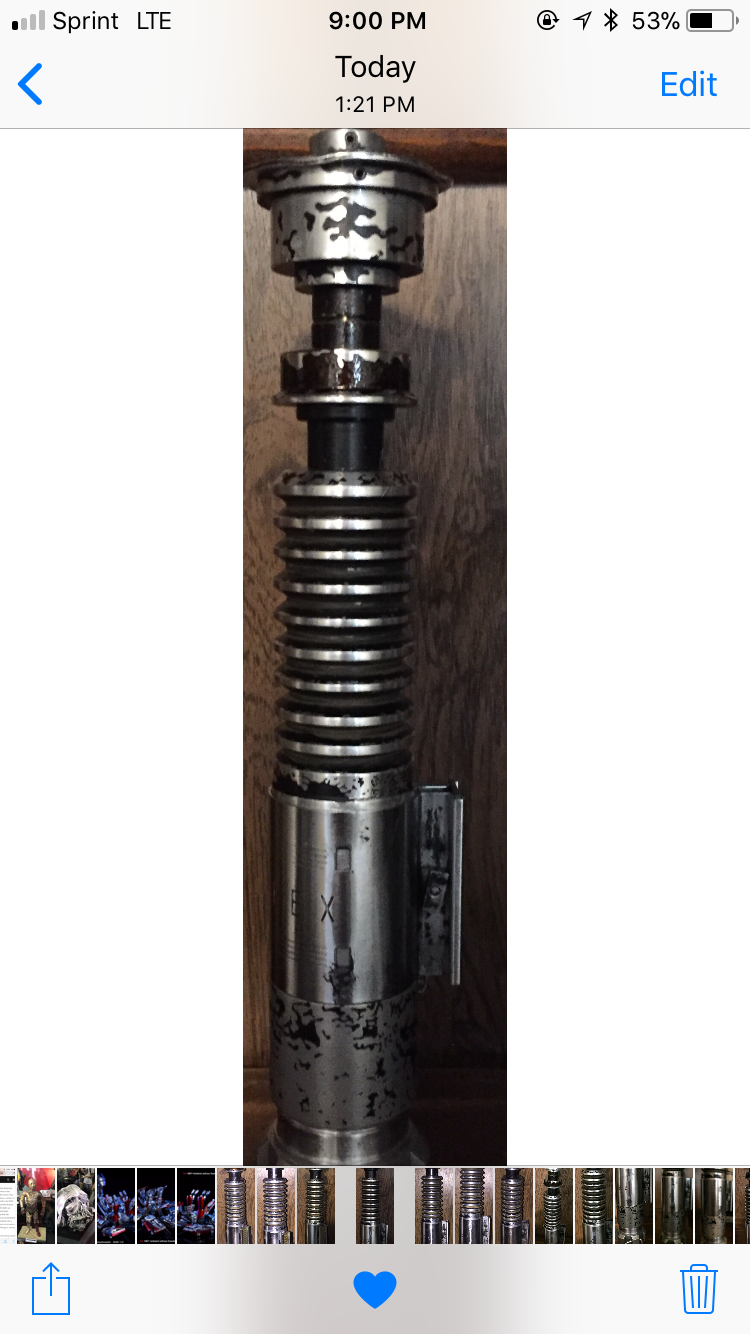

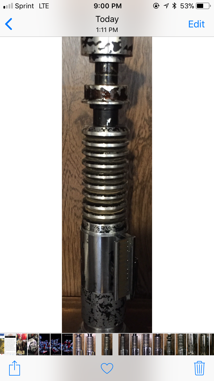

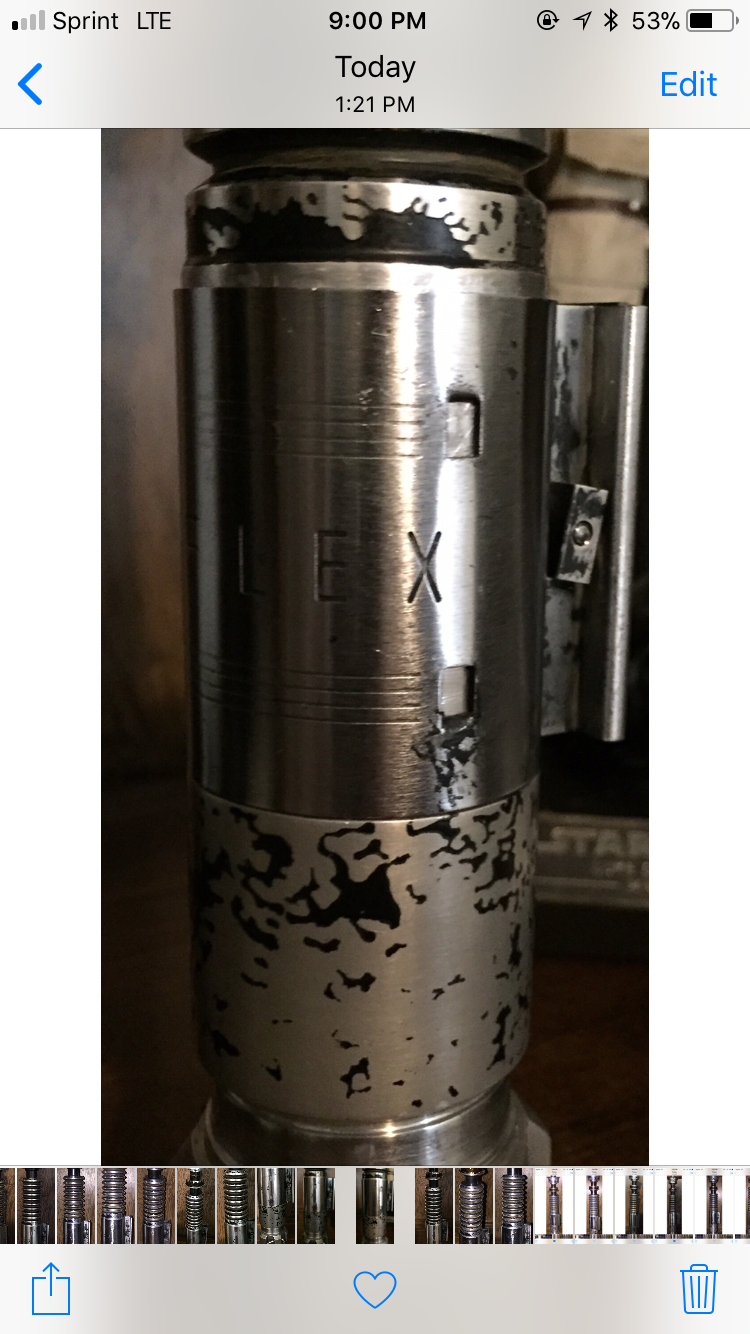

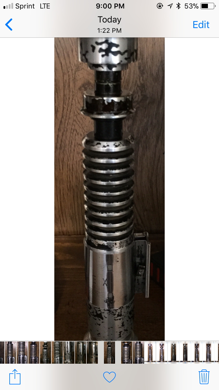

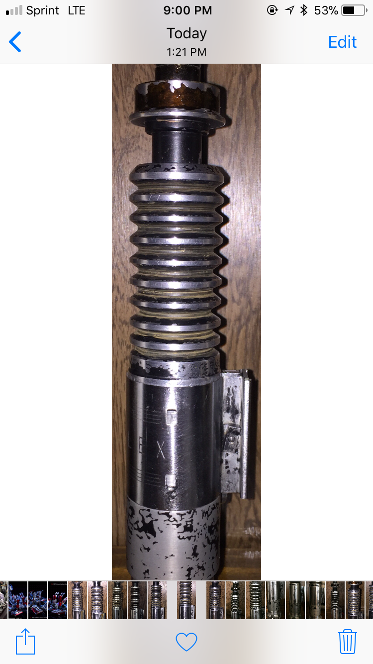

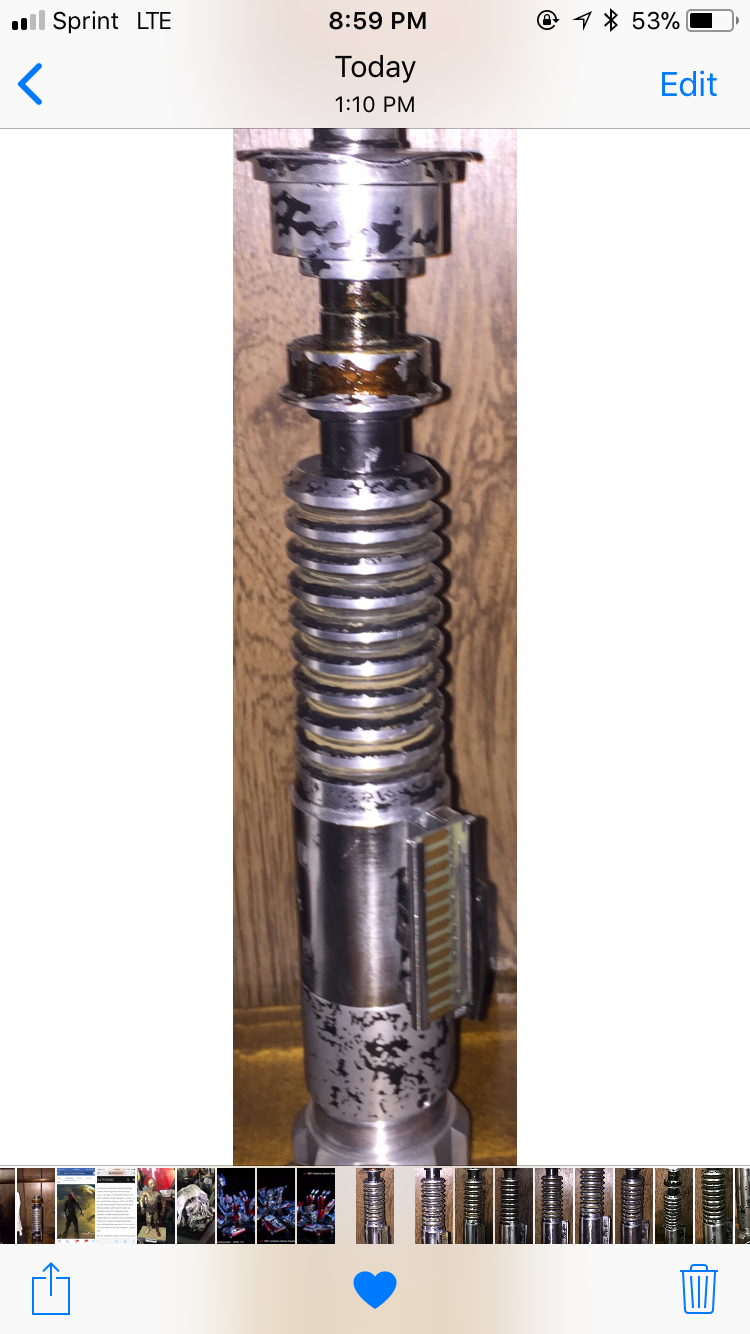

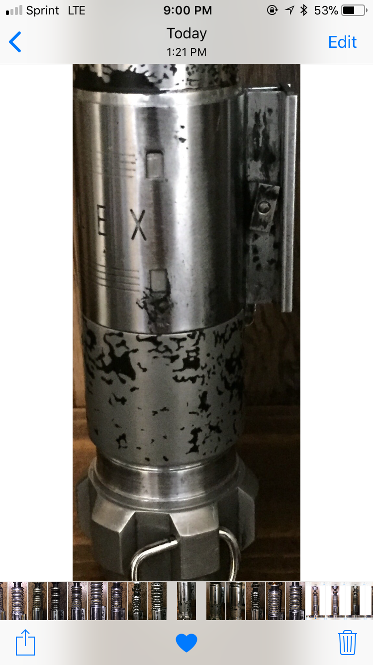

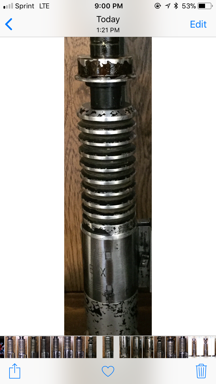

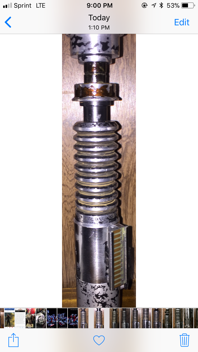

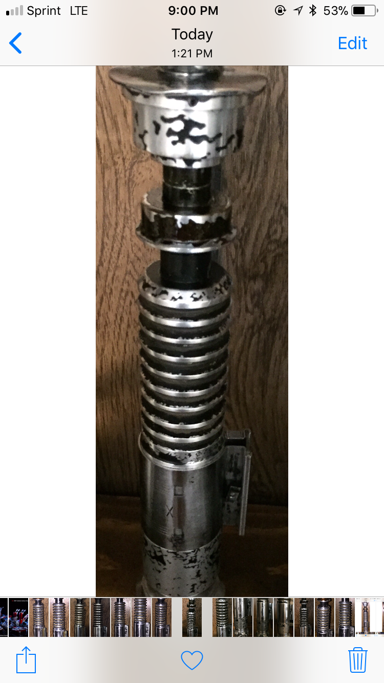

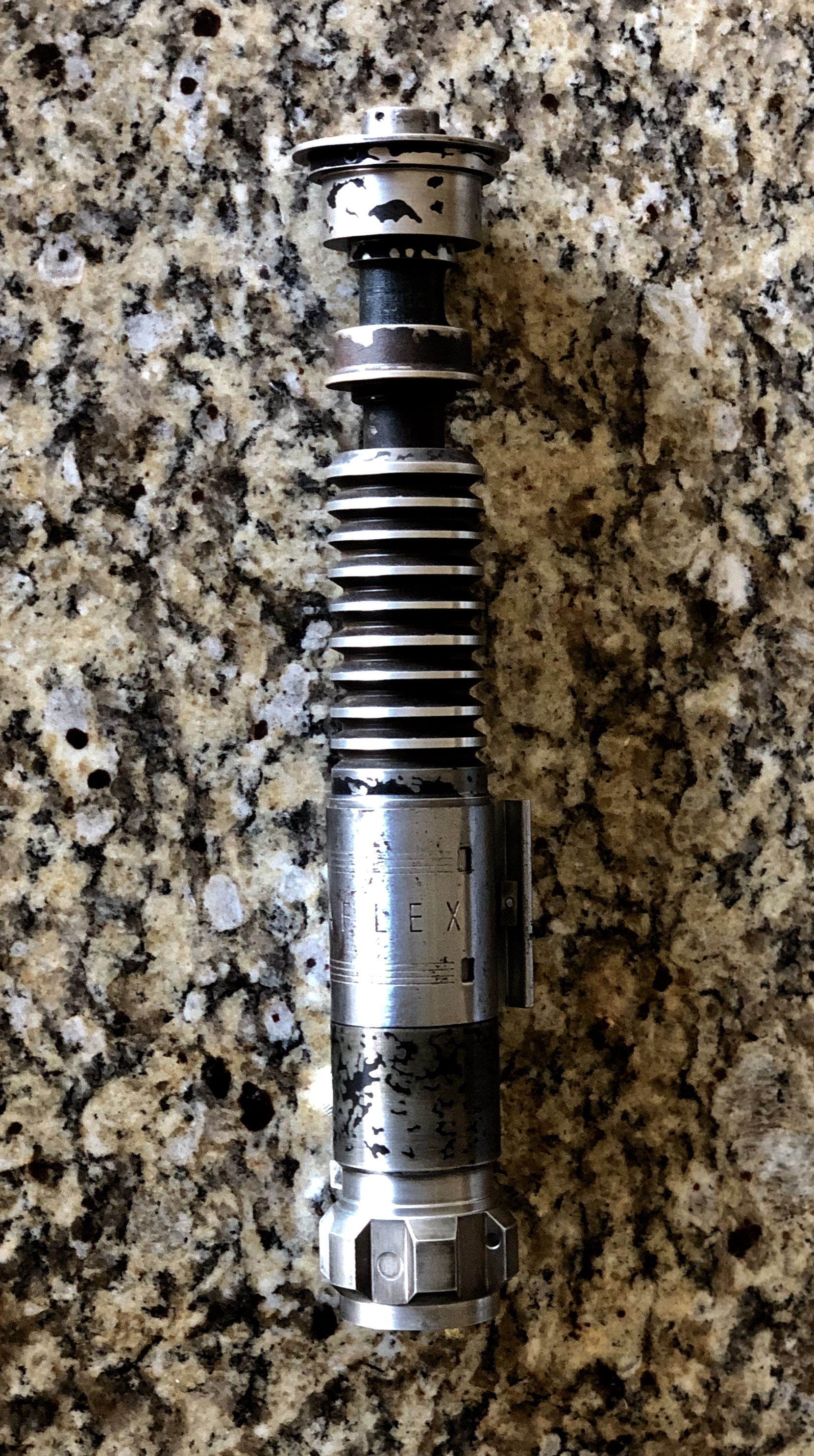

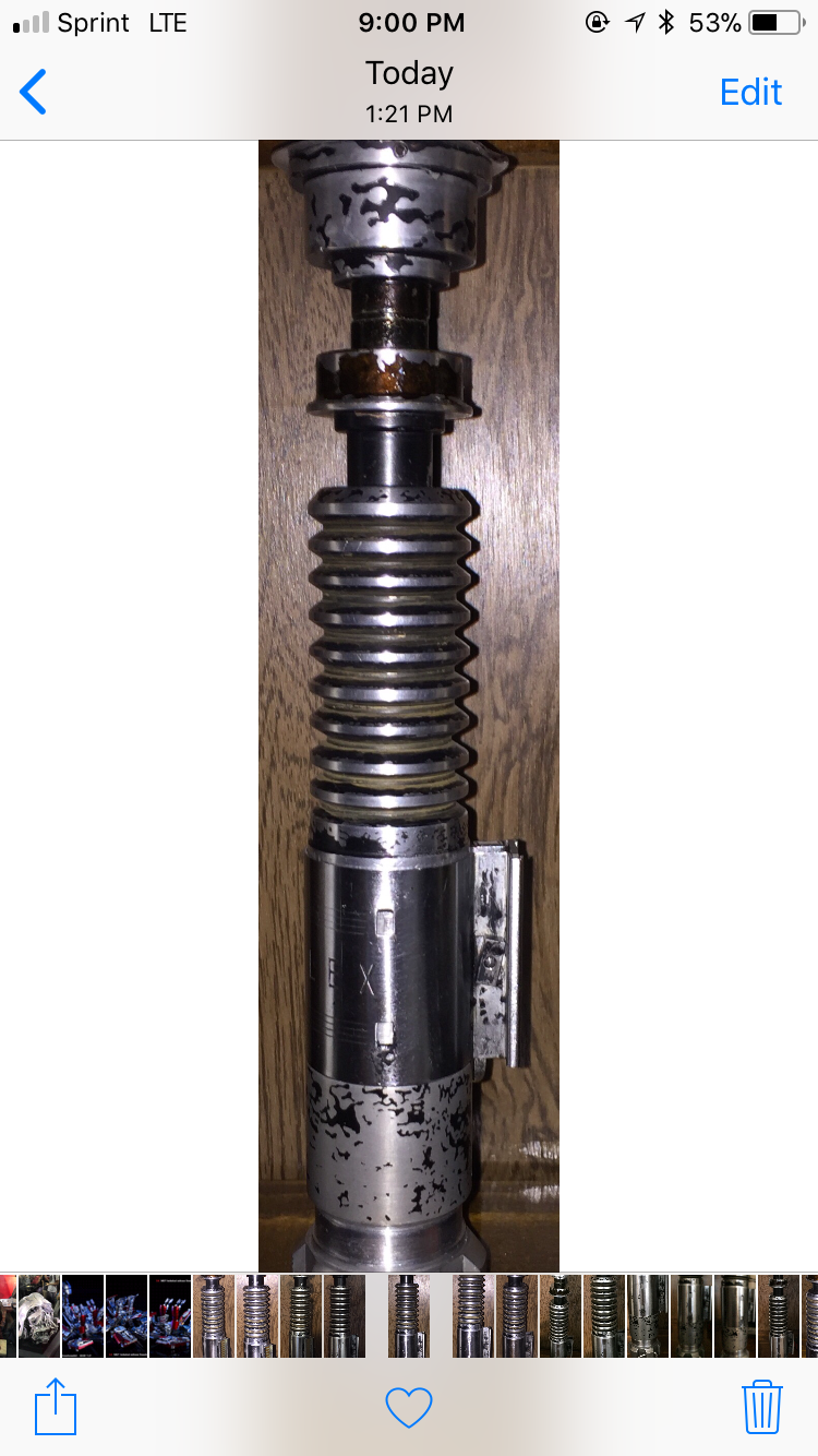

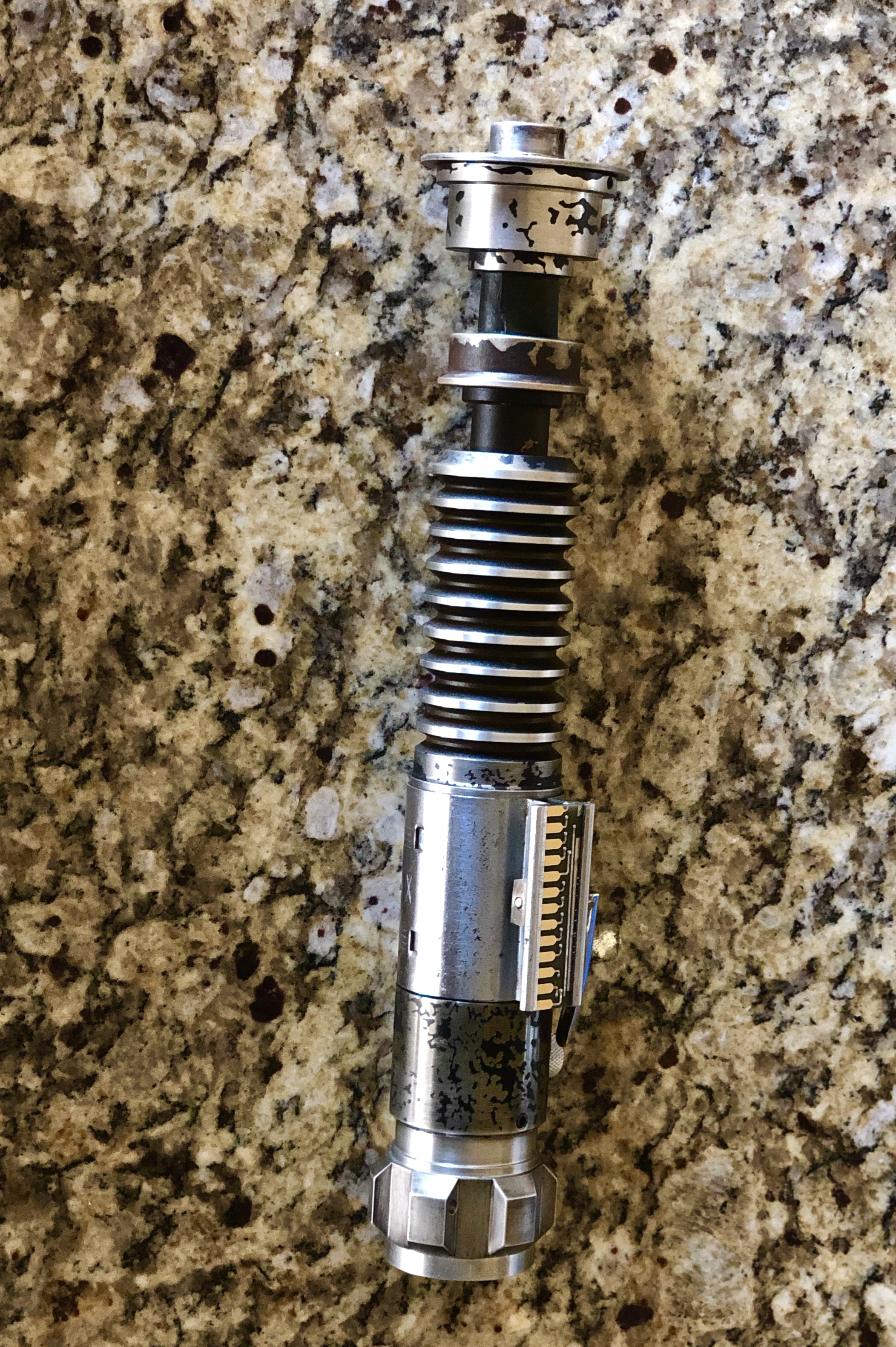

Been trying to replicate the Kylash mark on the clamp and the bronze/brown/black color of the neck. I’m happy with how it looks,from a distance or with little light it looks black but up close and with a light shining on it it has more of a bronze/brown color. I took photos with and without flash to try and show how it looks in hand.
That looks great!

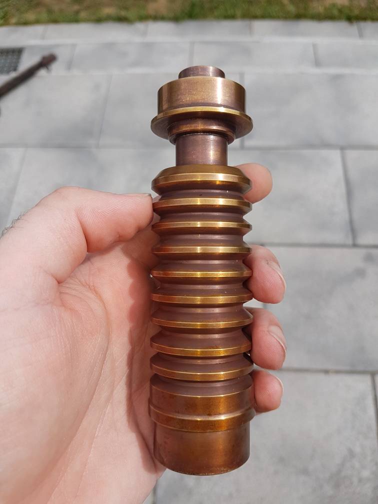

What colors did you go with on the windvane/ neck?
That looks great!
First I sprayed it black ,then went over it with vellejo earth brown,then I have a bottle of vellajo liquid gold copper,I let it sit for a few days untouched,the paint will separate and the copper will congeal at the bottom,above that there is a black/brown/copper color that matches the color of the windvain/neck almost perfectly. I dumped that top part into a separate bottle and used it to go over the windvain and neck area. I’m very happy with the results,In hand it looks pretty close to the actual prop.

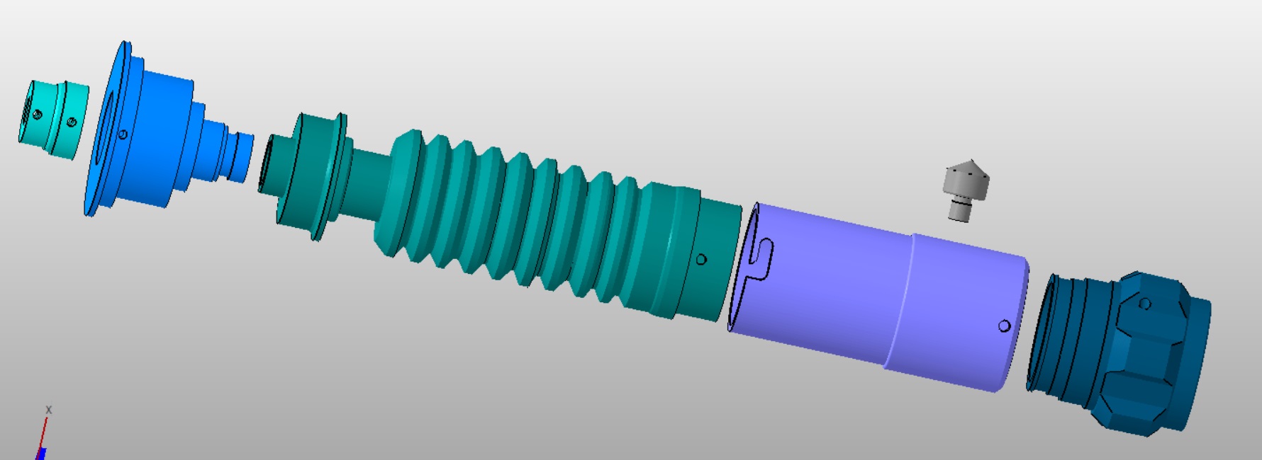

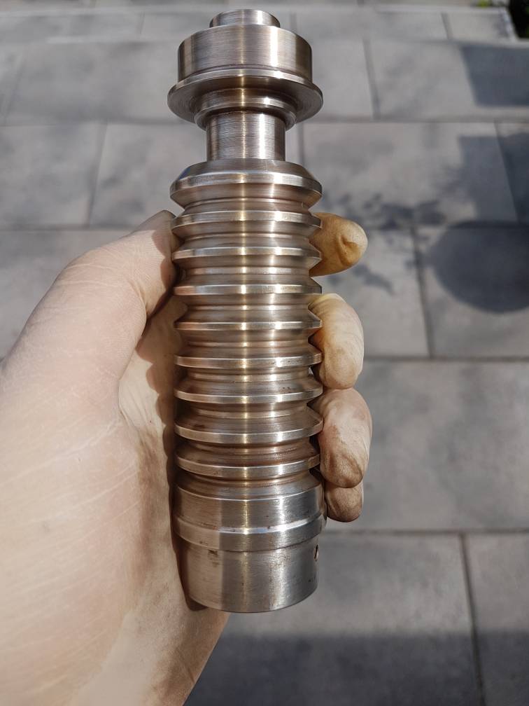

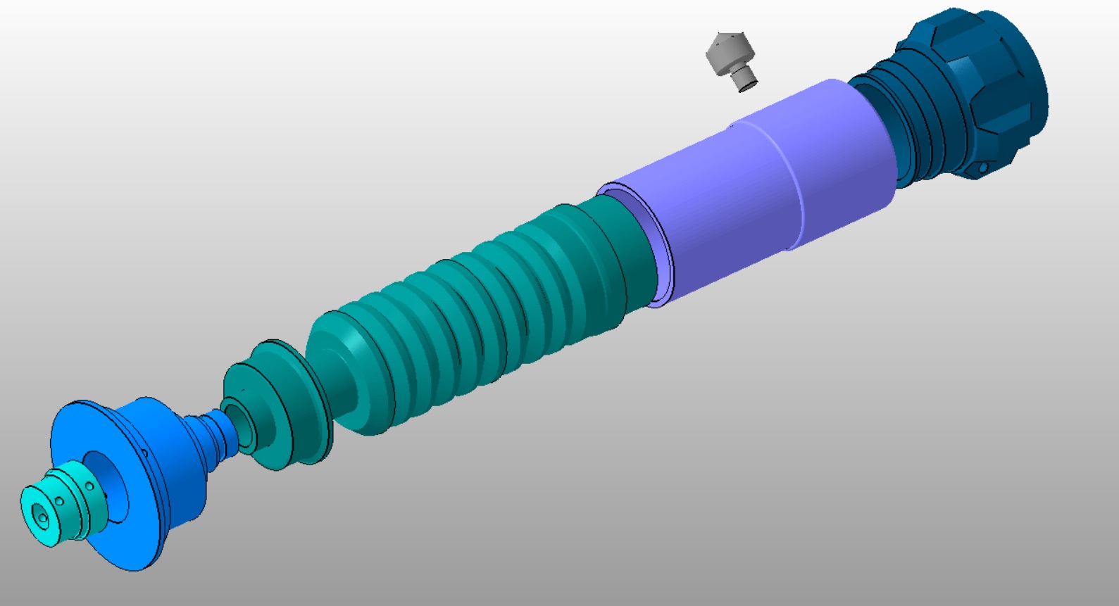

Hey guys. Most of you are all sorted for V2s I suppose. But, I just a heads up, by next month, I'll have a new supply of kits. These "builders kits" will be nearly identical to the last run in terms of overall dimensions, but will have a simplified construction and a couple different assembly options so that you can choose to which version of Luke's saber (V2, V2ANH, V3, V3post production) that you wan to tackle. I'll be using the leftover prototype grip parts that I got from the shop during the last run which, combined with the simplified construction, will allow me to drop my cost from the last run and hit a price point closer to my original 2016 offering.
Is that emitter going to be more solid since there isnt a heat sink and stuff in there now?
Yes. It's will be solid, with the emitter nipple sliding into it as a blade plug. The builder will have the option of screwing the emitter into the saber neck and using it a a fx kit with a 7/8 blade. Or, you can cut the threading on the back of the emitter off, and have the emitter spin on a steel rod like the original.
