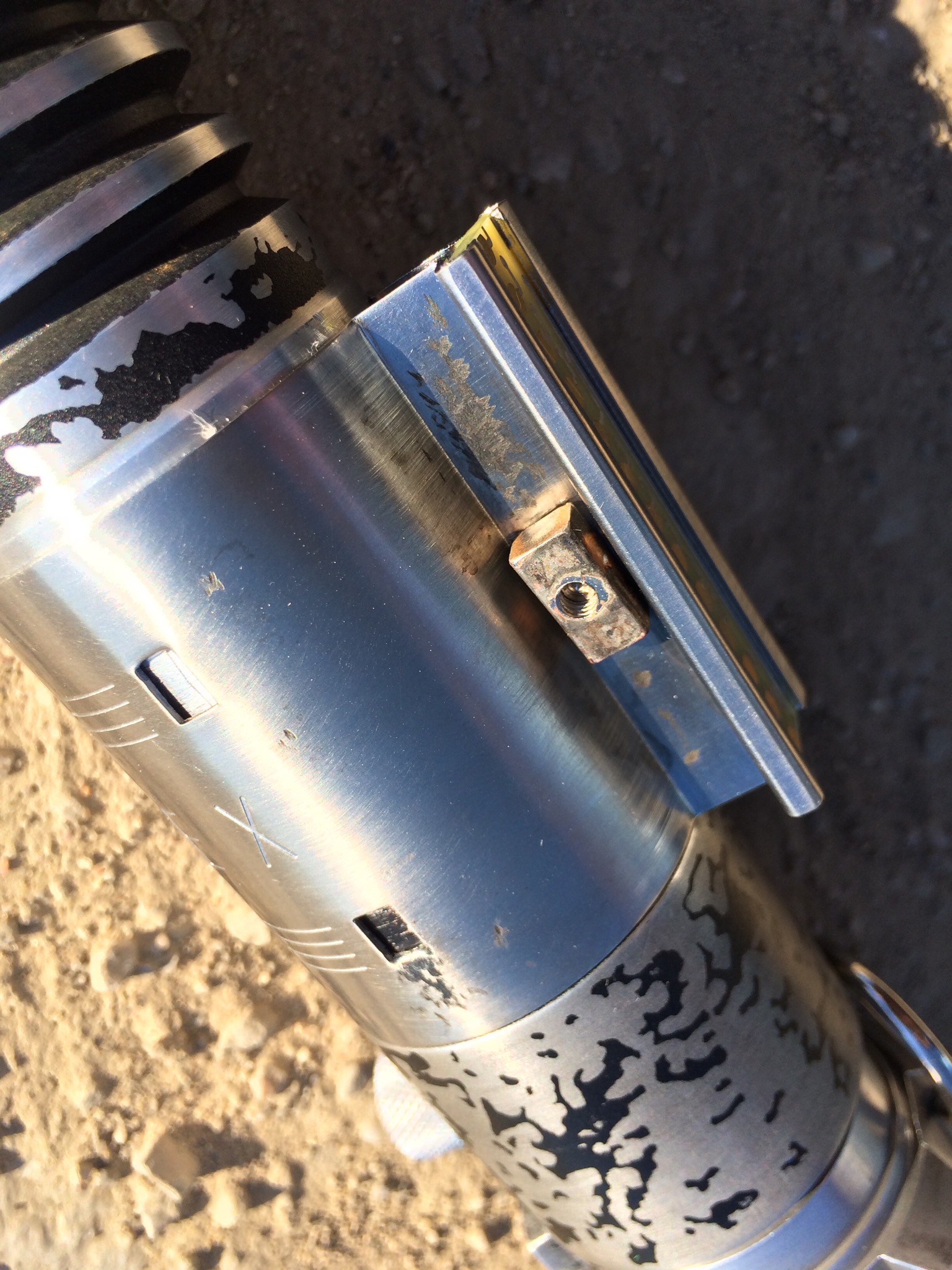

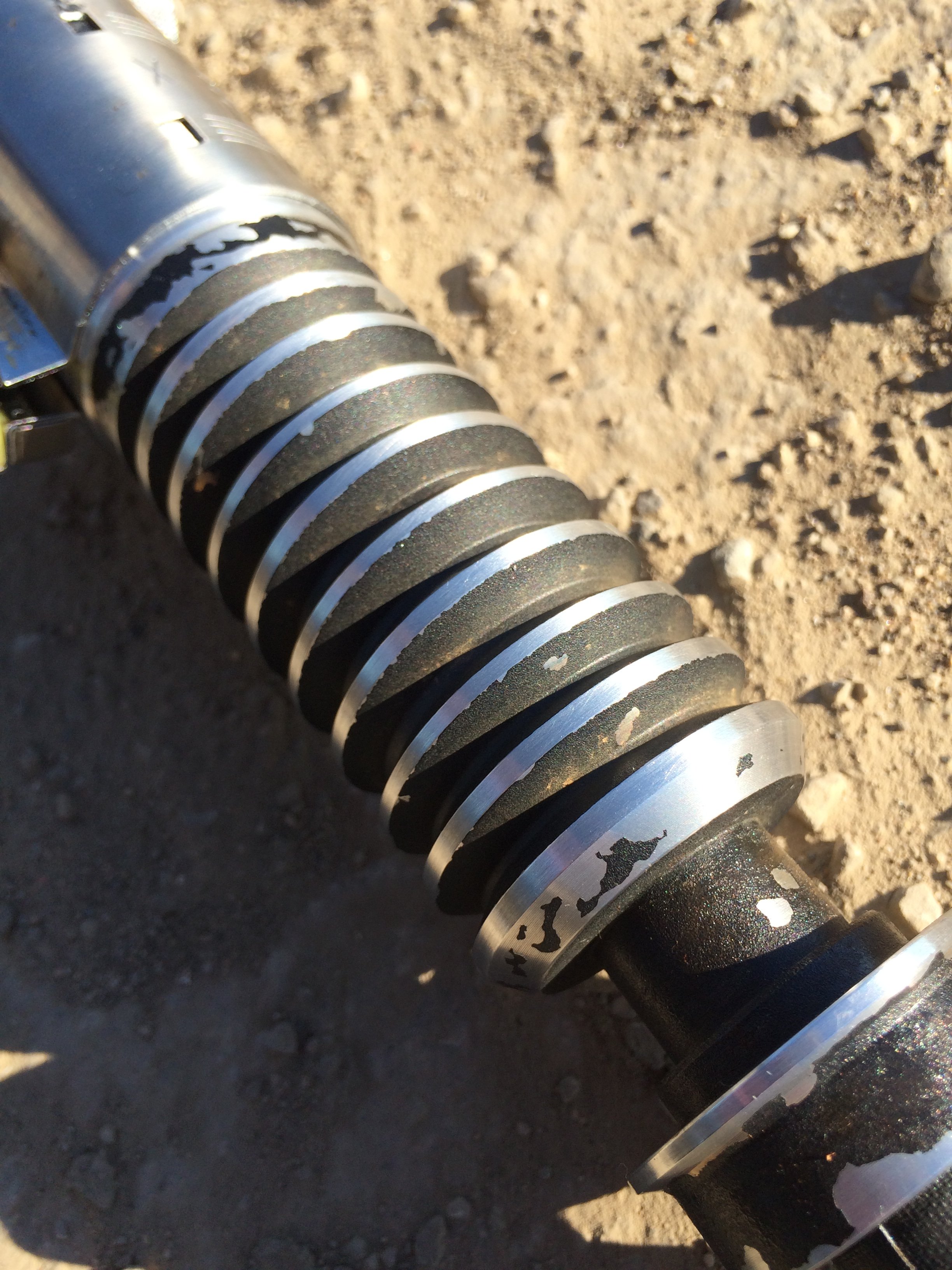

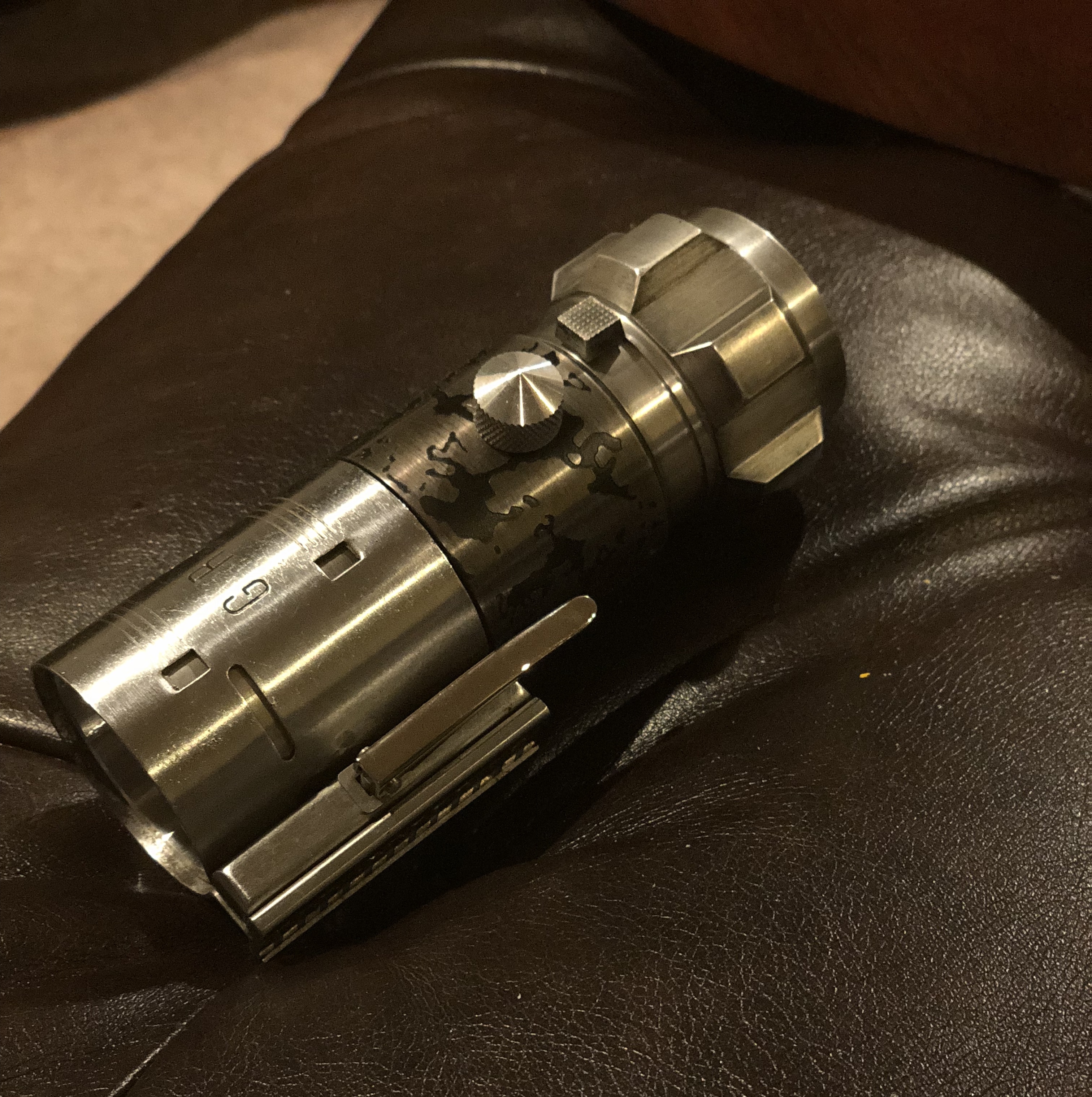

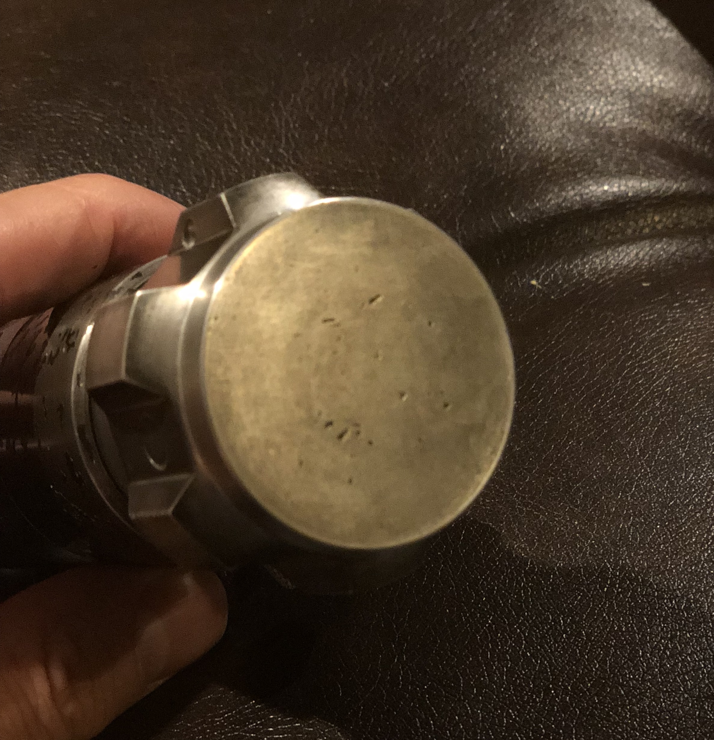

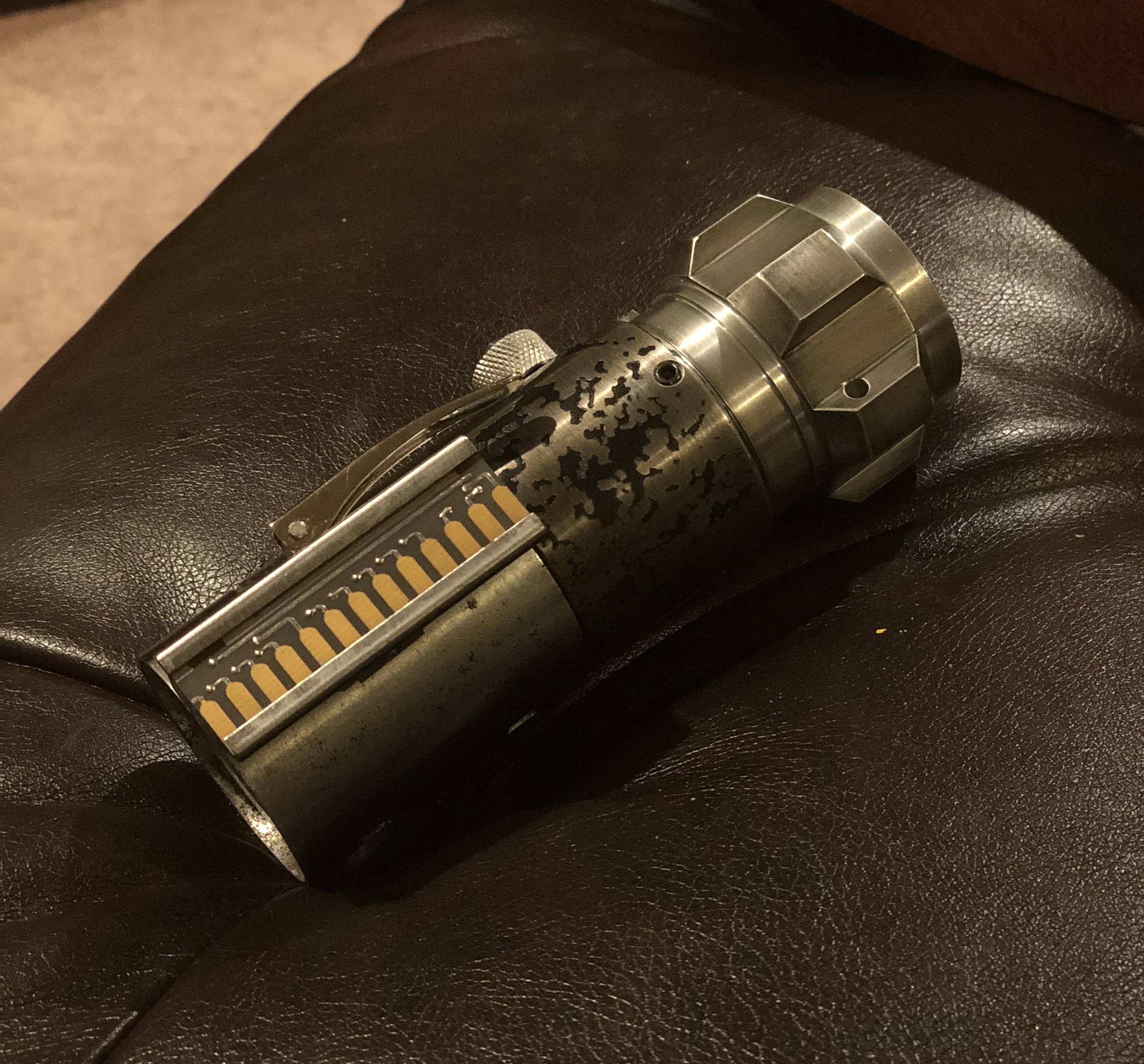

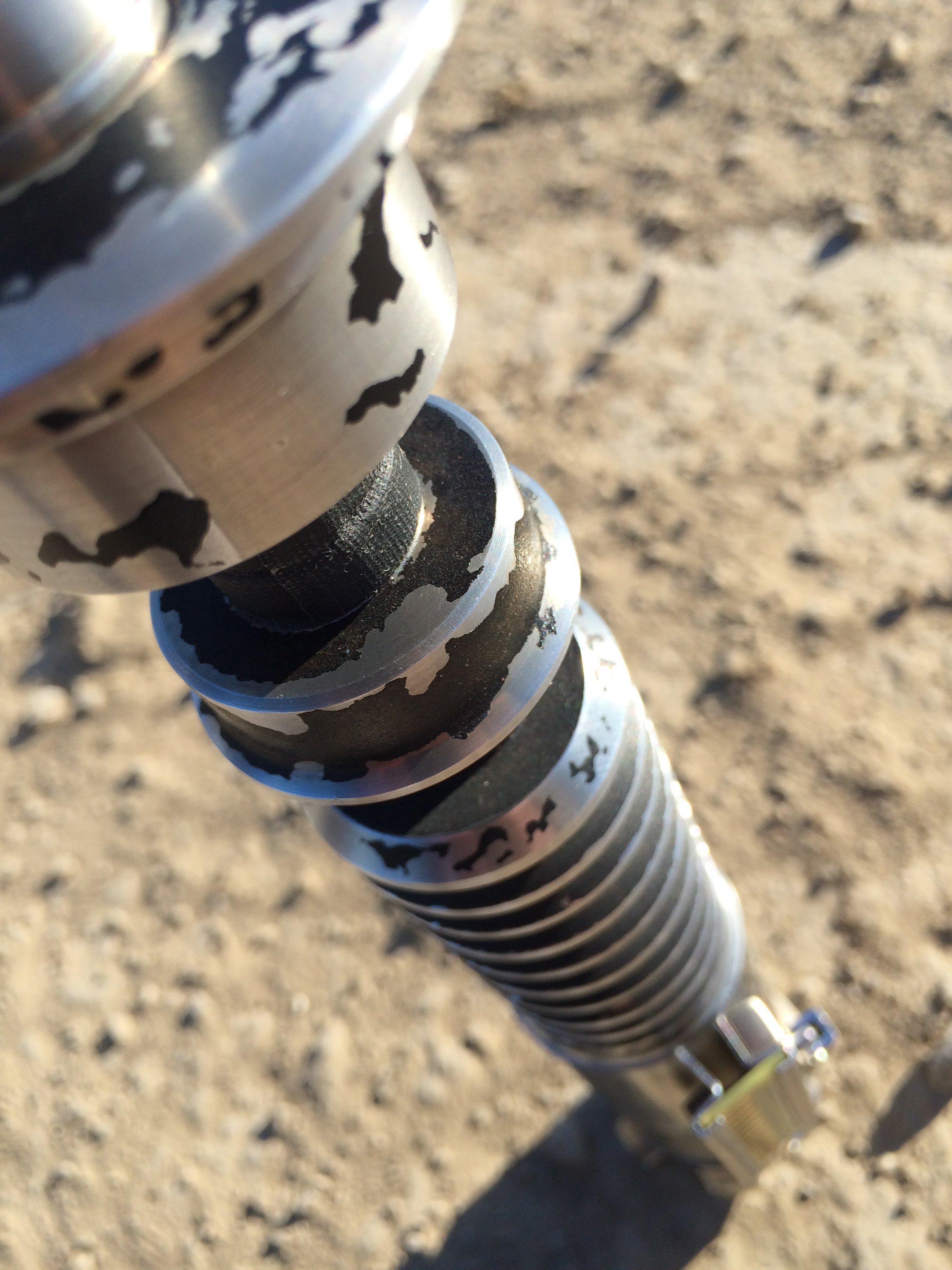

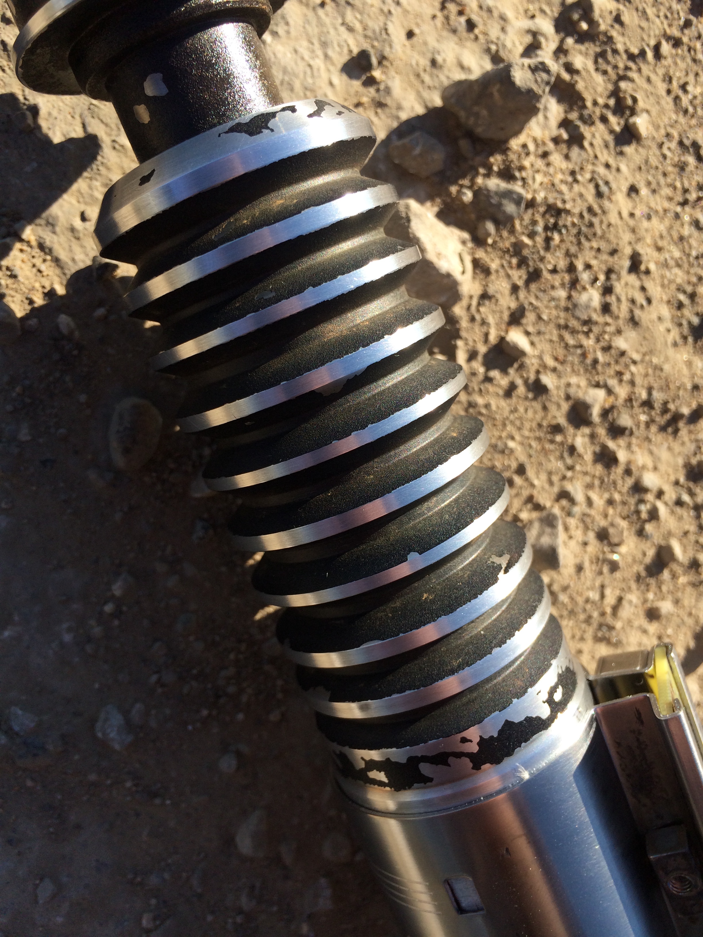

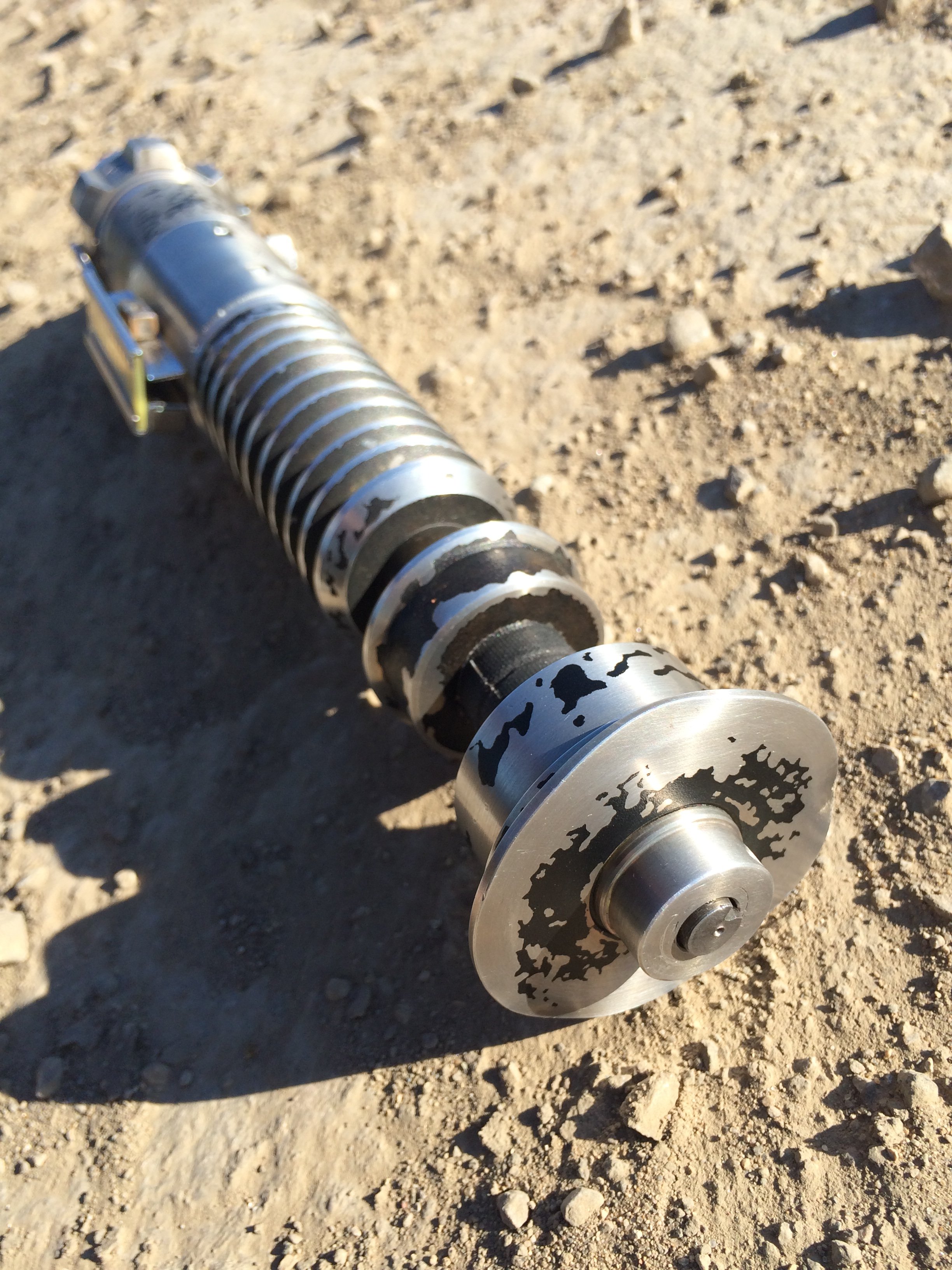

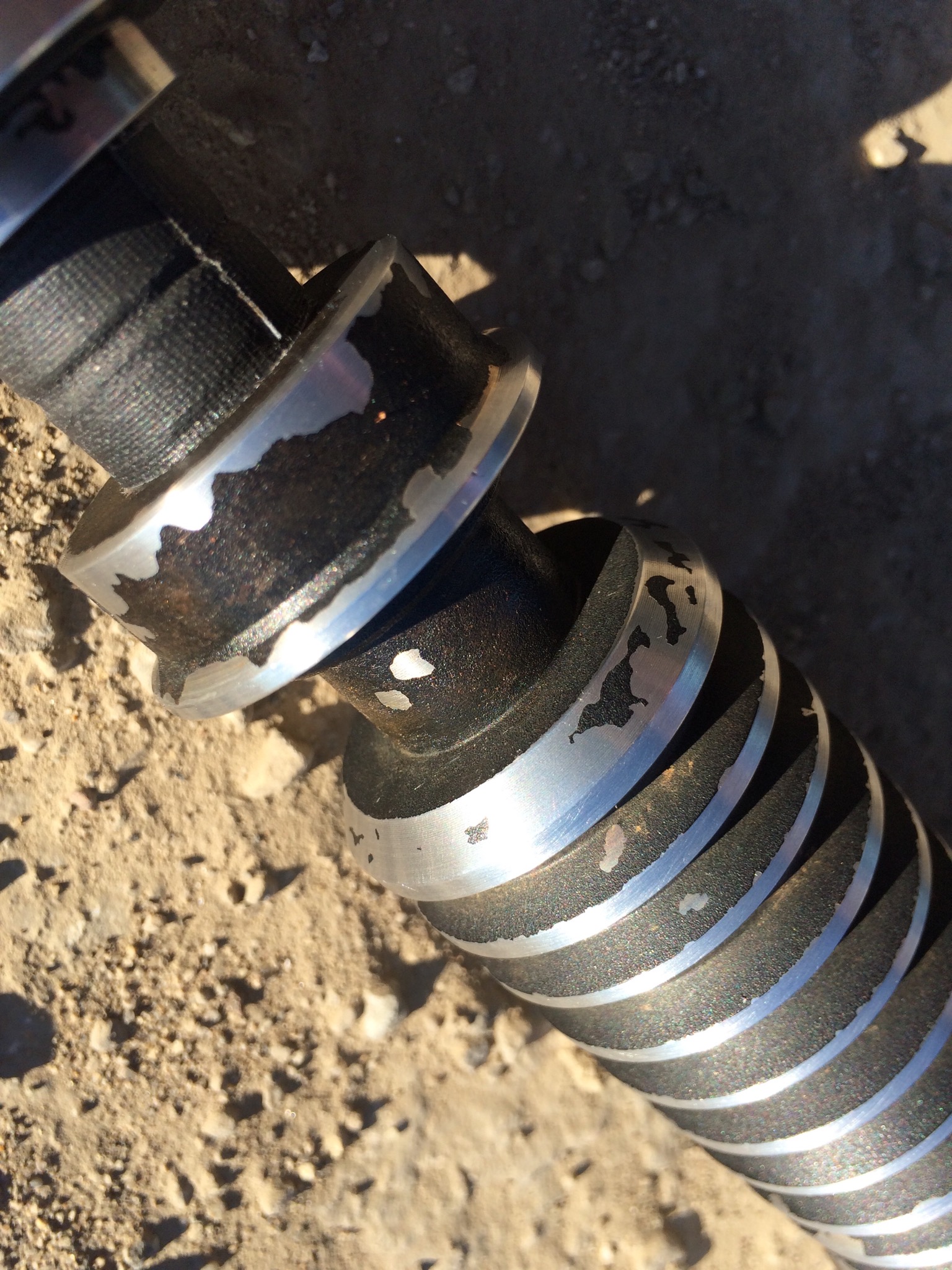

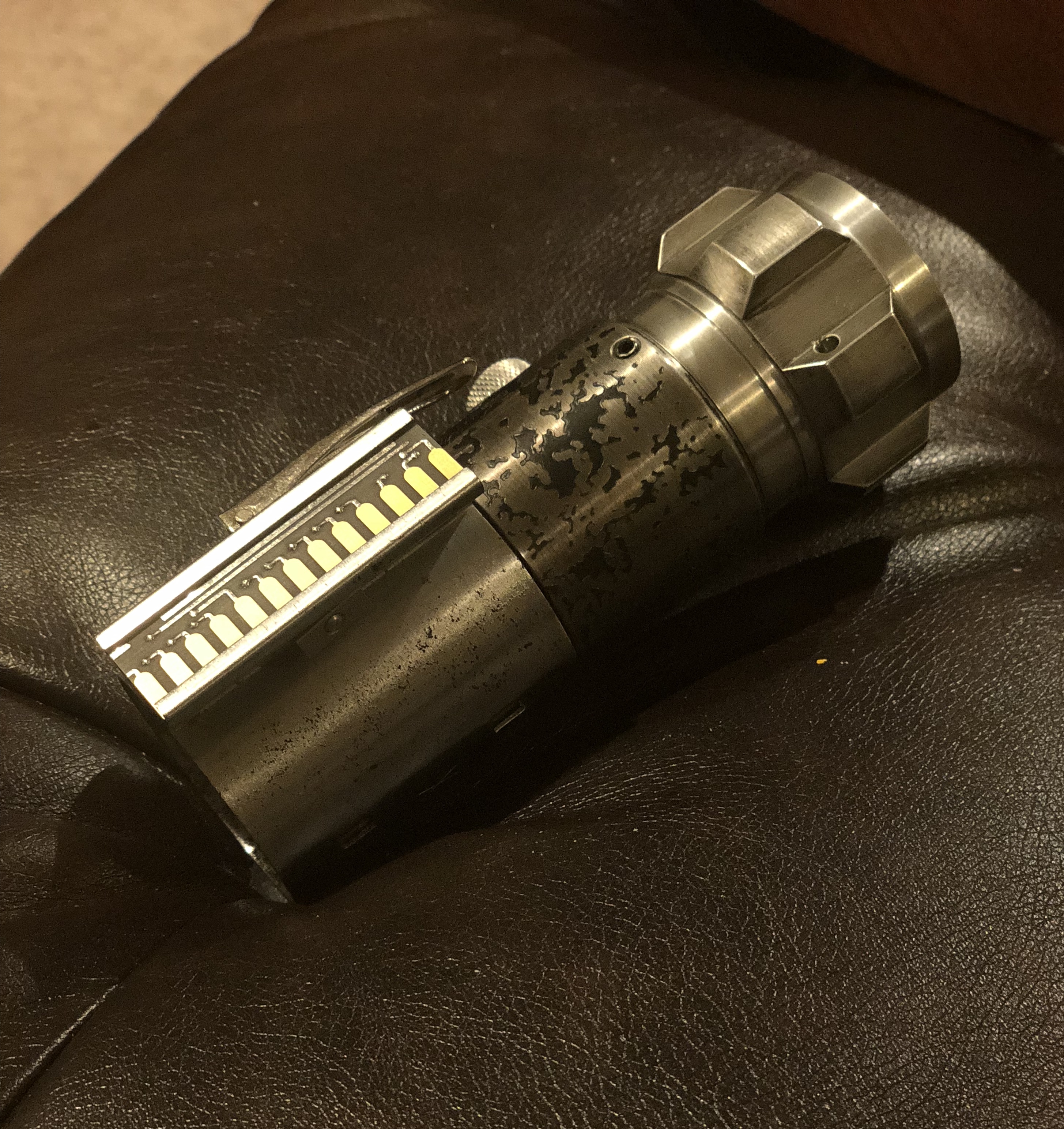

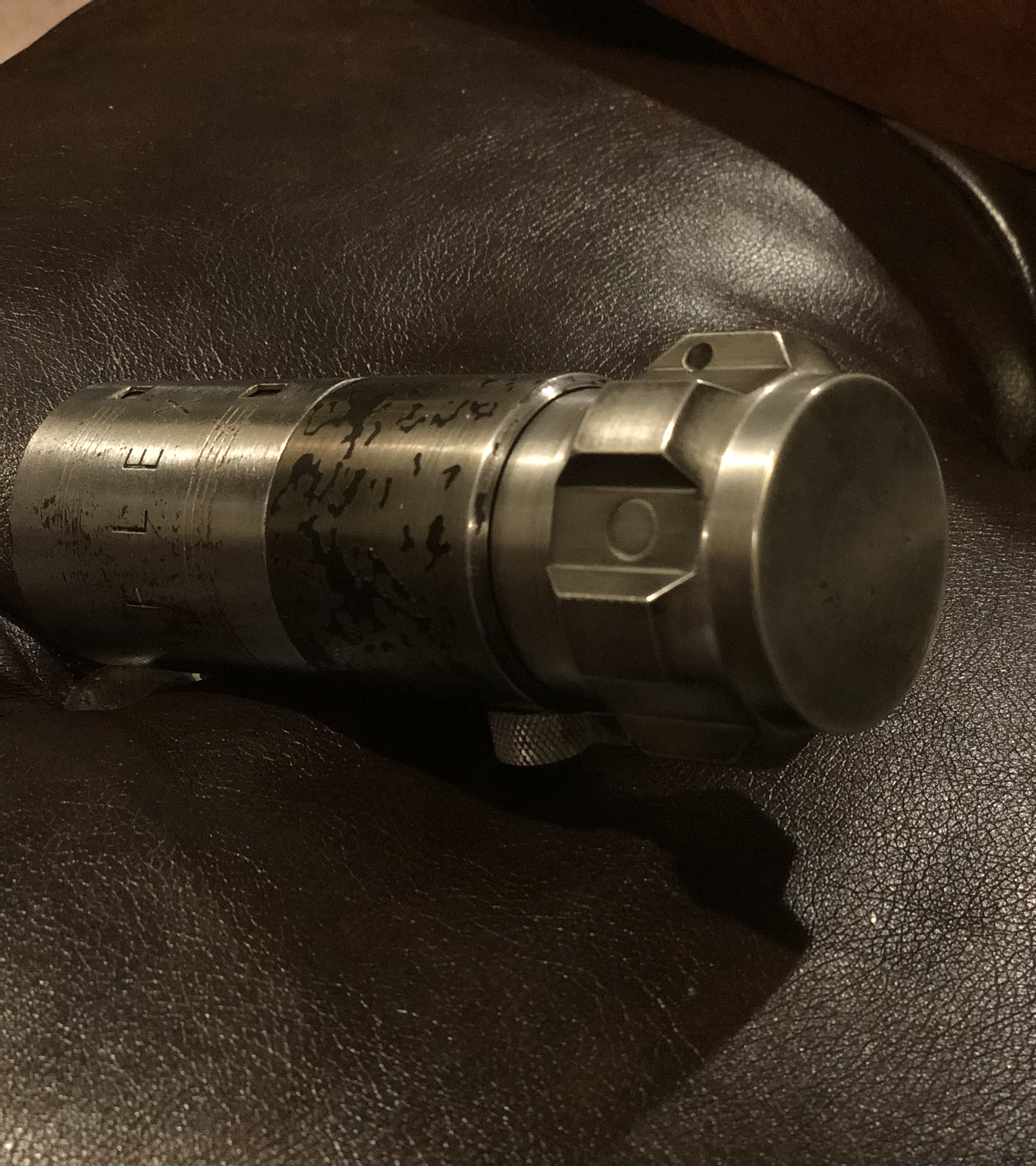

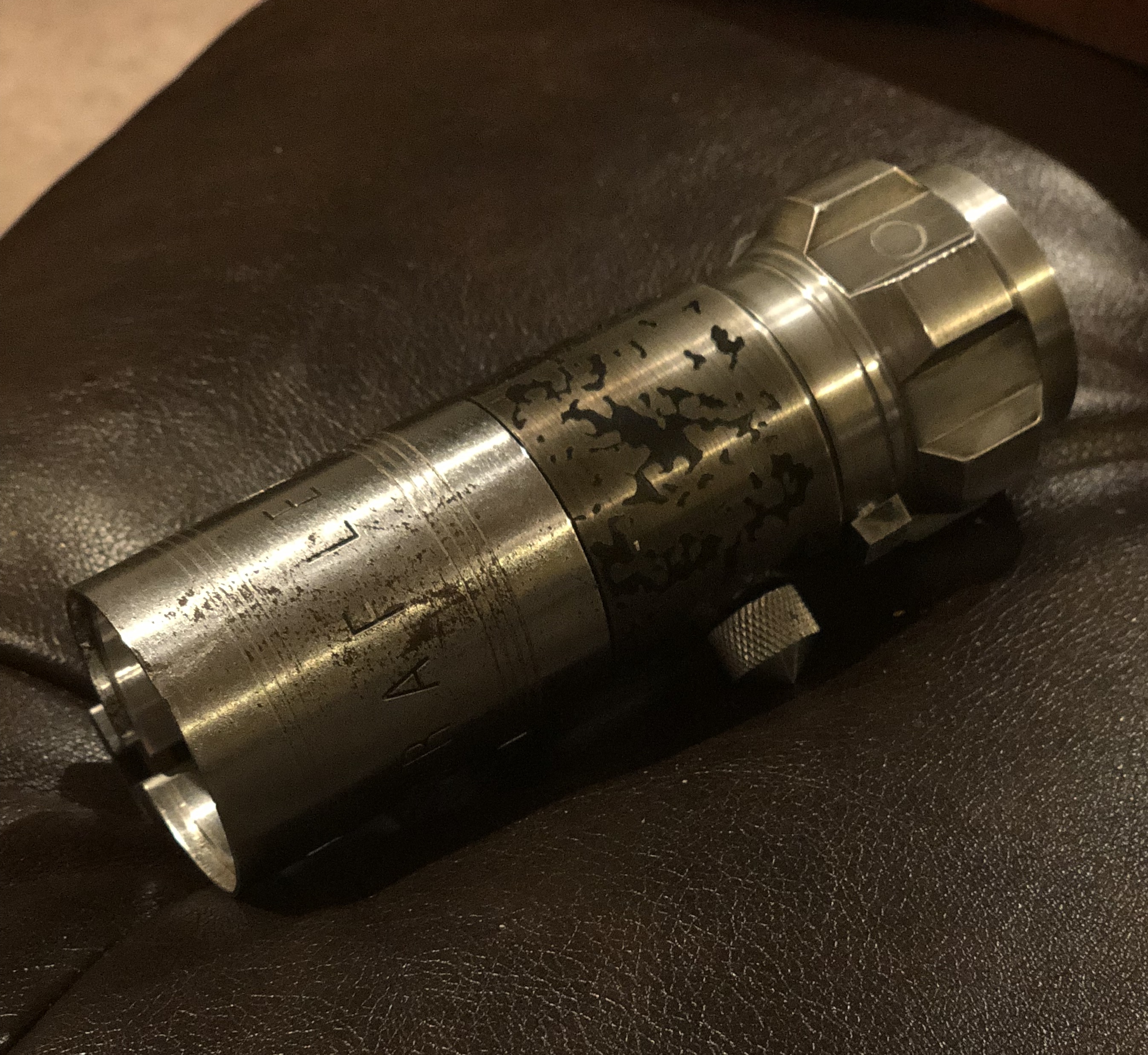

So I still need to get Roy’s lever, but I’m calling this done for now.
A0DEA814-D785-4C08-BDDA-270A5C7104A2.jpegFBBFE647-F6A6-42E5-9570-3E759E50365B.jpegA695B7FA-72D5-4A0D-A68A-0FEC4660D361.jpeg51BB0FEB-DF8E-4C09-AD7B-9A165B8CD8FC.jpeg91DCF6C9-DFE2-43FC-9FFB-FDBAA2BF29B7.jpeg7A8203EB-CC9B-431F-A3F6-C132EA92E58C.jpeg3131D28E-02C7-4C55-BE31-DC6489B3FF58.jpeg234D71AE-39A2-4A99-A694-9E12F1B5434A.jpeg

Like the integration of sand into the paint. Can I ask is that clamp one of Roman’s? If so I’m having a hard time putting it together with Anakin’s saver, Roys lever and Wanna’s board.

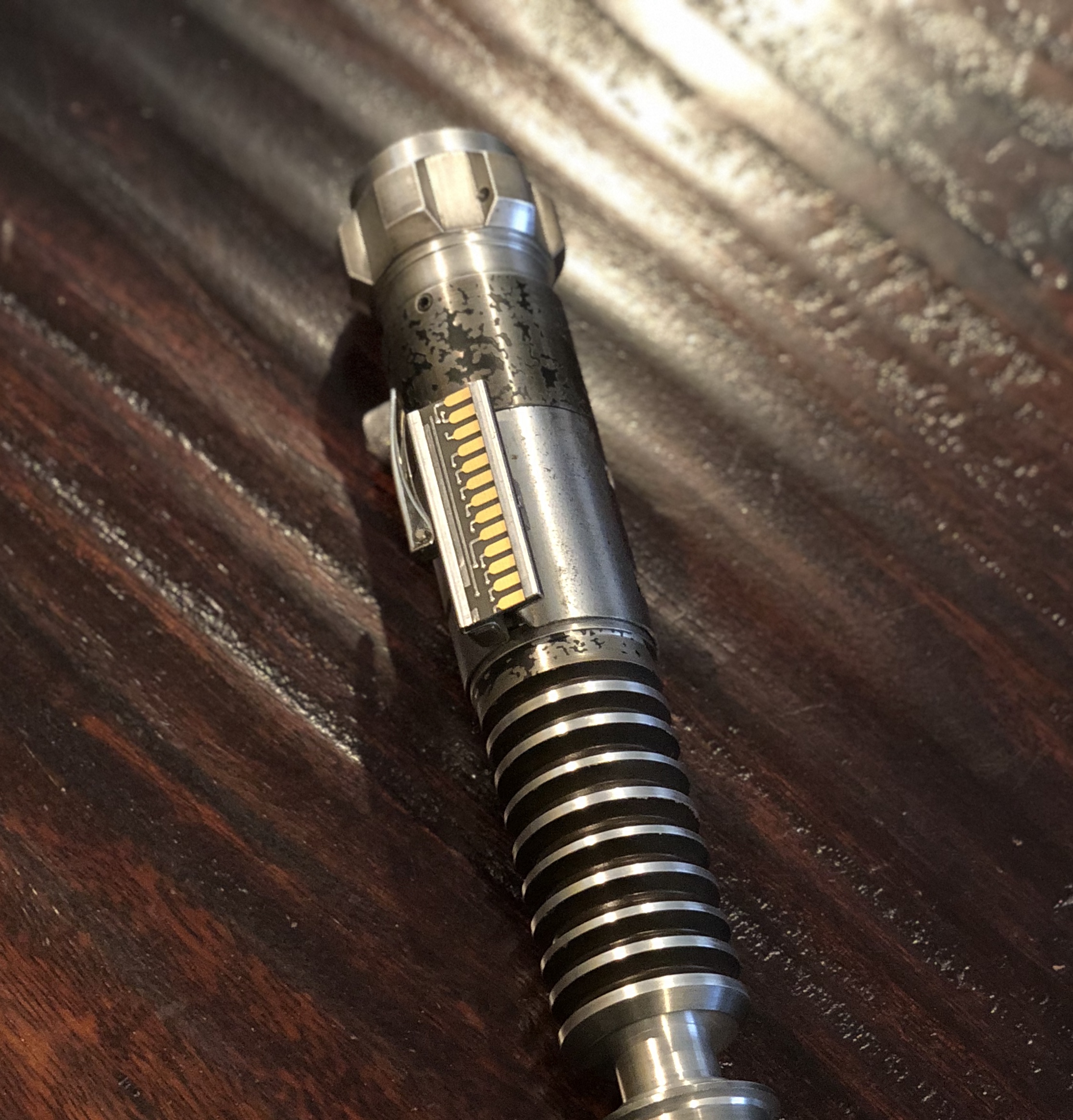

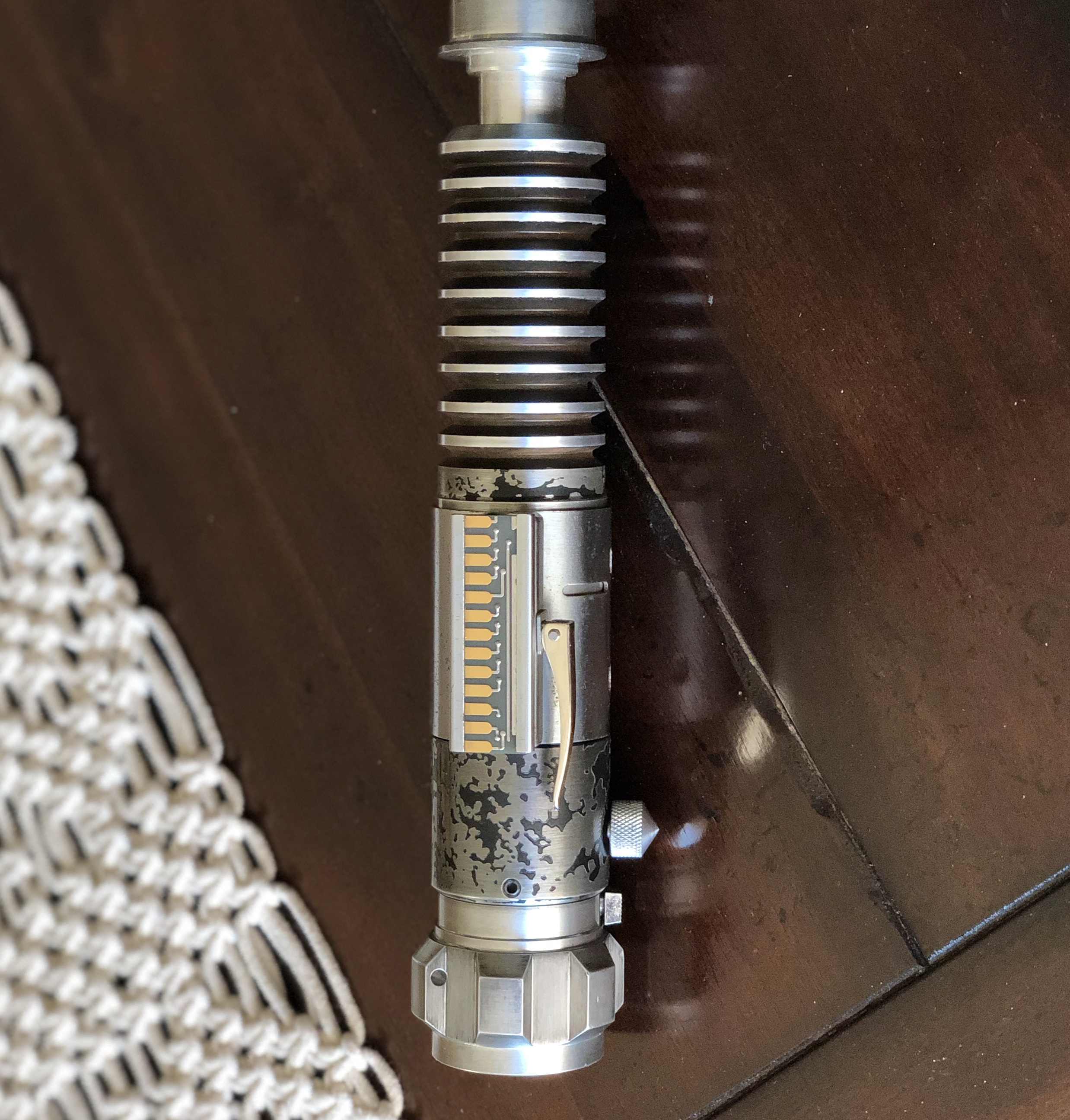

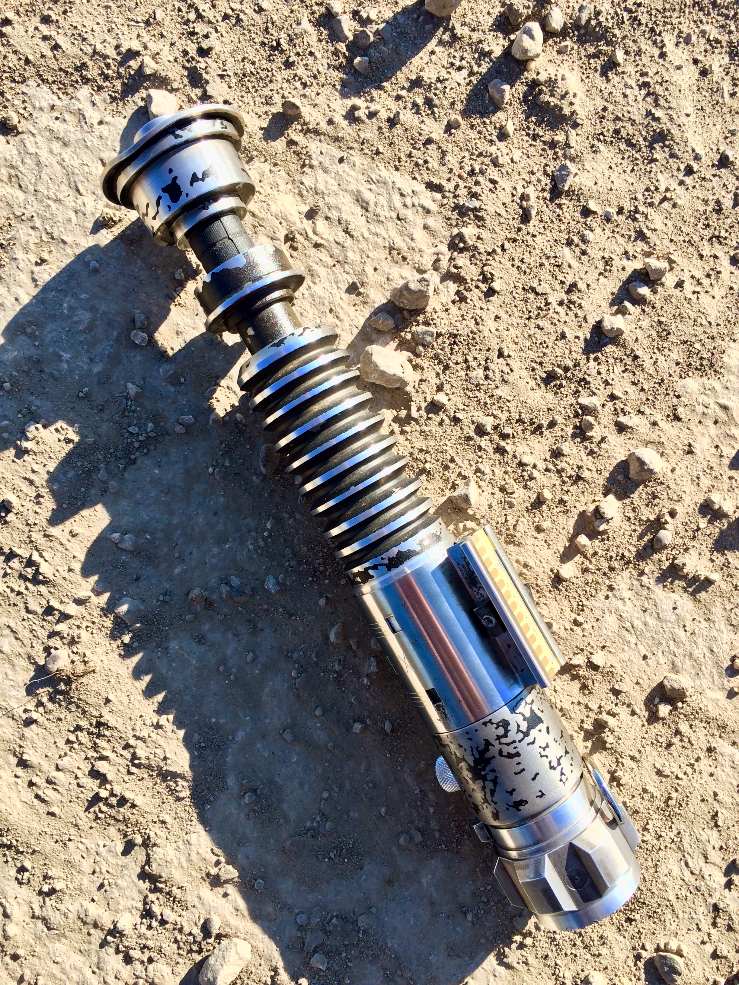

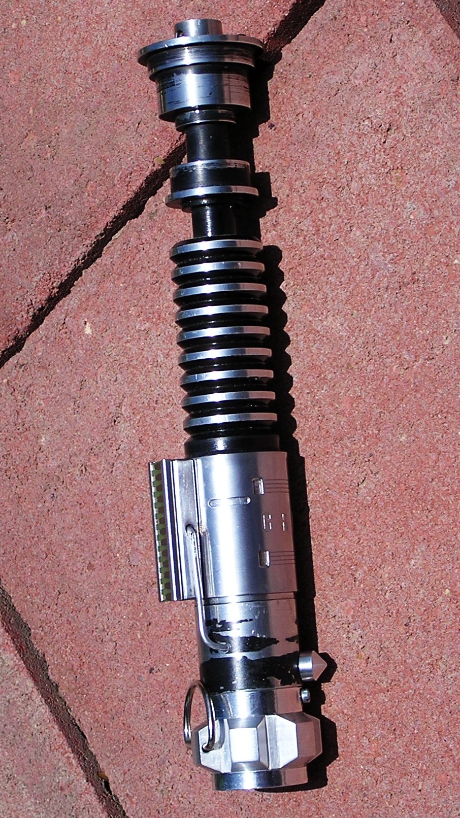

I picked up a vintage clamp over the past week that had the right look I am going for and started getting to work weathering and painting this thing. I just realized that this is the 4th or 5th iteration of the V2 for me over the past 17 years or so. I stumbled across this picture of the very first V2 I ever completed from around 2001. This was back when some believed that a bent wire replaced the Graflex lever in the clamp and was held in place via a corresponding hole in the booster. It’s crazy to see this now:
It was easy work removing the machine marks from the pommel cubes and booster. No secrets/techniques to reveal here with my build that haven’t already been discussed via the excellent builds in this thread already.
A personal debate for me had to do with the damage to the bottom of the pommel. I decided that ather than trying to eyeball and replicate the gashes and dings on the bottom of the pommel of the original saber. I went for the natural look that is the result of purposeful drops and strikes against areas of the floor of my basement/workshop and keeps within the “spirit” of the look of the original. I tend to find--at least for me--that when I try to replicate exact dings and gashes with Dremmels and files, it never quite looks authentic; almost like a forged signature that lacks naturalism. My hat is off to those who can pull of that level of authenticity.
I am working from the bottom up and have gotten this far this past weekend. LOVE the work by A. Starkillet and Trooper Trent on this project —a homerun from both of them that continues to make our jobs easier in finishing these off into beautiful pieces.
211E4DFC-4A14-4E7C-B656-067B15CDECDE.jpeg4A549A5F-2712-484C-B138-98C317E054CA.jpegD5C1CF5E-CA22-4E8B-8D9F-025CCAACF5D8.jpeg8726074E-C88C-43A5-92C7-34347D3BFC76.jpeg8FA4D539-2A16-4E3B-9E77-65E38F551EED.jpegAB01CF1B-64BA-497D-A5D0-4D43006589A3.jpeg

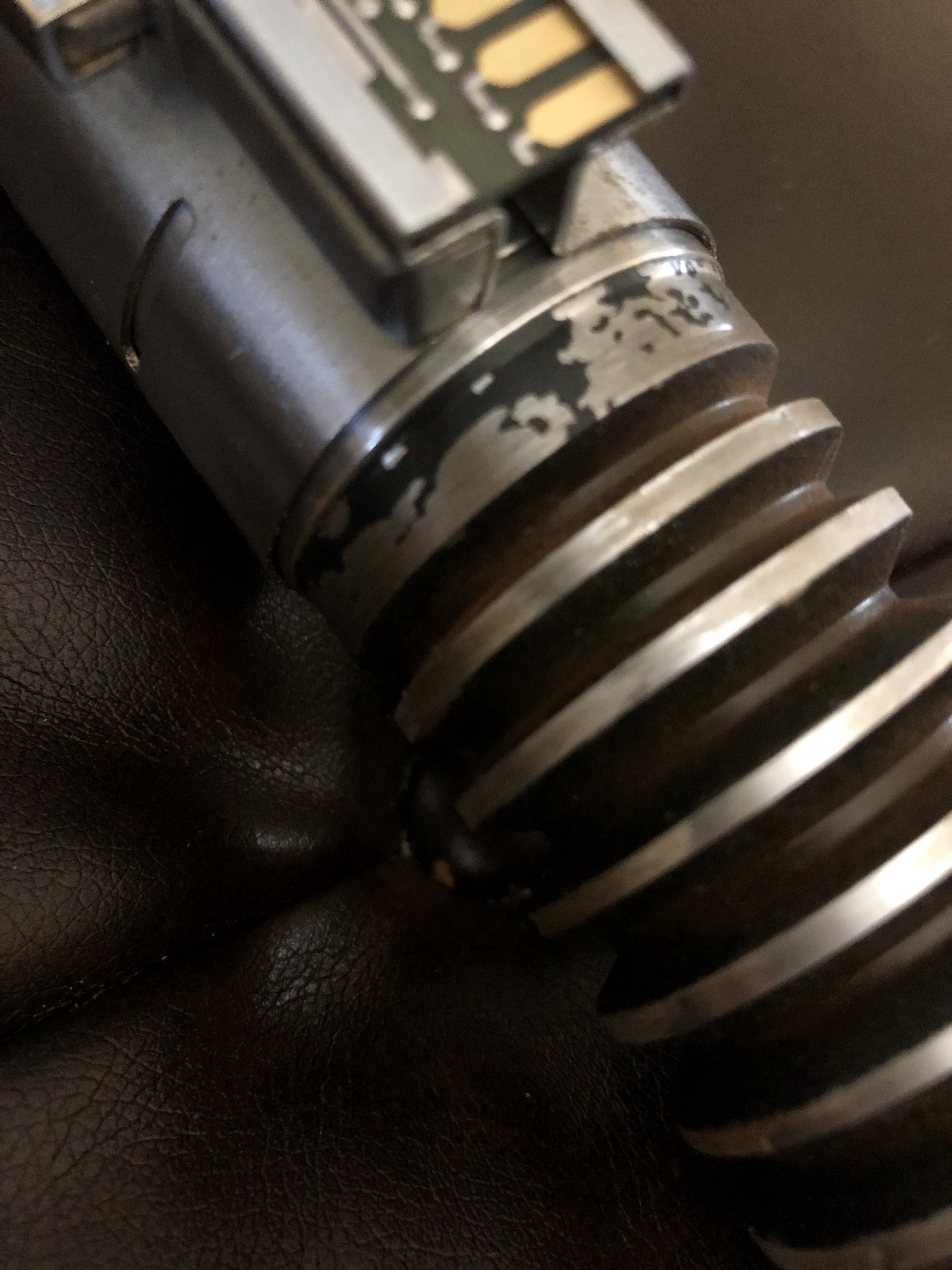

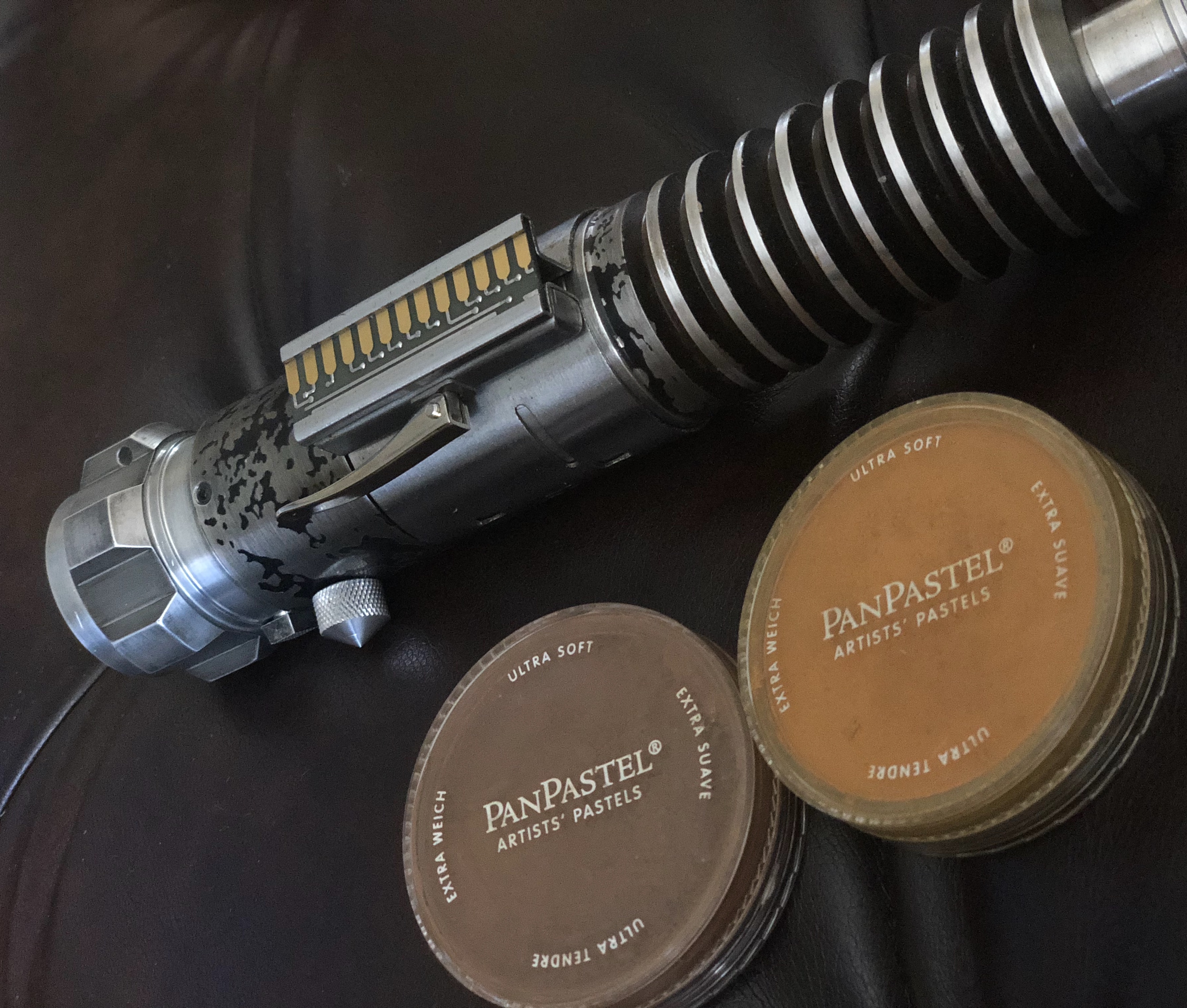

Quick update moving up the neck of the saber...
I use ”PanPastel” pastels (280.3 orange shade and 740.3 burnt sienna shade) to subtlety add the dust/rust/whatever that is between the grenade rings. Each pass is sealed with a satin clear coat (after masking off other areas) followed by a removal of the clear coat with fine grit sandpaper from the edge of the rings to maintain the shiny appearance of the rings seen in the original. It takes a few passes to build it up but not to overdue it.
This is my first 2 weathering passes with pastels:
Re: Anakin Starkiller FX V2 - Aging Weathering & Stencil Tutorial
OK I have the dirt/rust/crud detail in the rings where I want it and am stopping here for now.
As Mr. Lucas says “...you can go too far with these things.”
You can really only see the pastel weathering under bright light conditions, otherwise the rings just look black...
Under bright light:
Under regular lighting conditions:
I assume the original appears largely the same as you don’t really pick up any rusty colors in the grenade ring section in the movie or the “Pop Culture” video. I assume that the famous photo that Brandon posted that shows the rusty ring color was under photo studio lighting, or similar, conditions.
