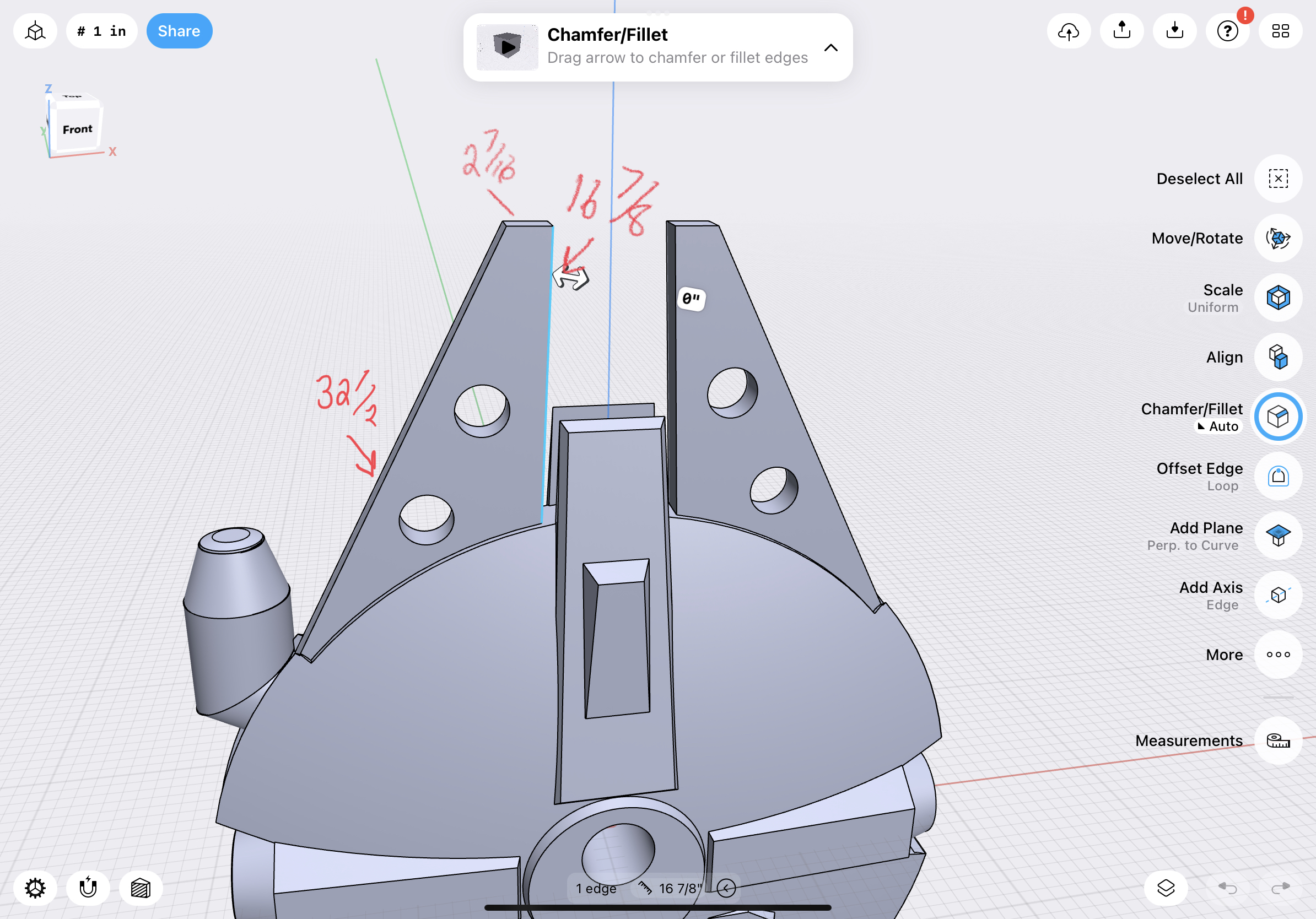

So before I cut these, I have a question. I know the mandible pits very in size, but are the holes in the mandibles themselves the same or are they also different?
Thanks,
John
So my first question would be is to ask the diameter of your 'core' disc?.
But, I see you are way too long on your mandible length.
Have you done kit part layout on the mandible sidewalls to ascertain a ball park measure?.
46” disc. I went with the following. Forgive my awful American measurements. :) Haven’t don’t the layout yet. Still need lots of pieces.
Your disc core measure is fine, that has to be maximum diameter though, accounting for sidewall thickness.
It's your mandible length then that's the issue.
I just saw your post back there where you had around 7" from mandible/sidewall end to docking ring sidewall edge. That's too short, like 2" at least.

Thanks Stu. I’m guessing that as long as the short side and angles are correct. (I do have the pieces to check those) the longer side can be adjusted on the fly.
It's really just a matter of tweaking for everything to gel.

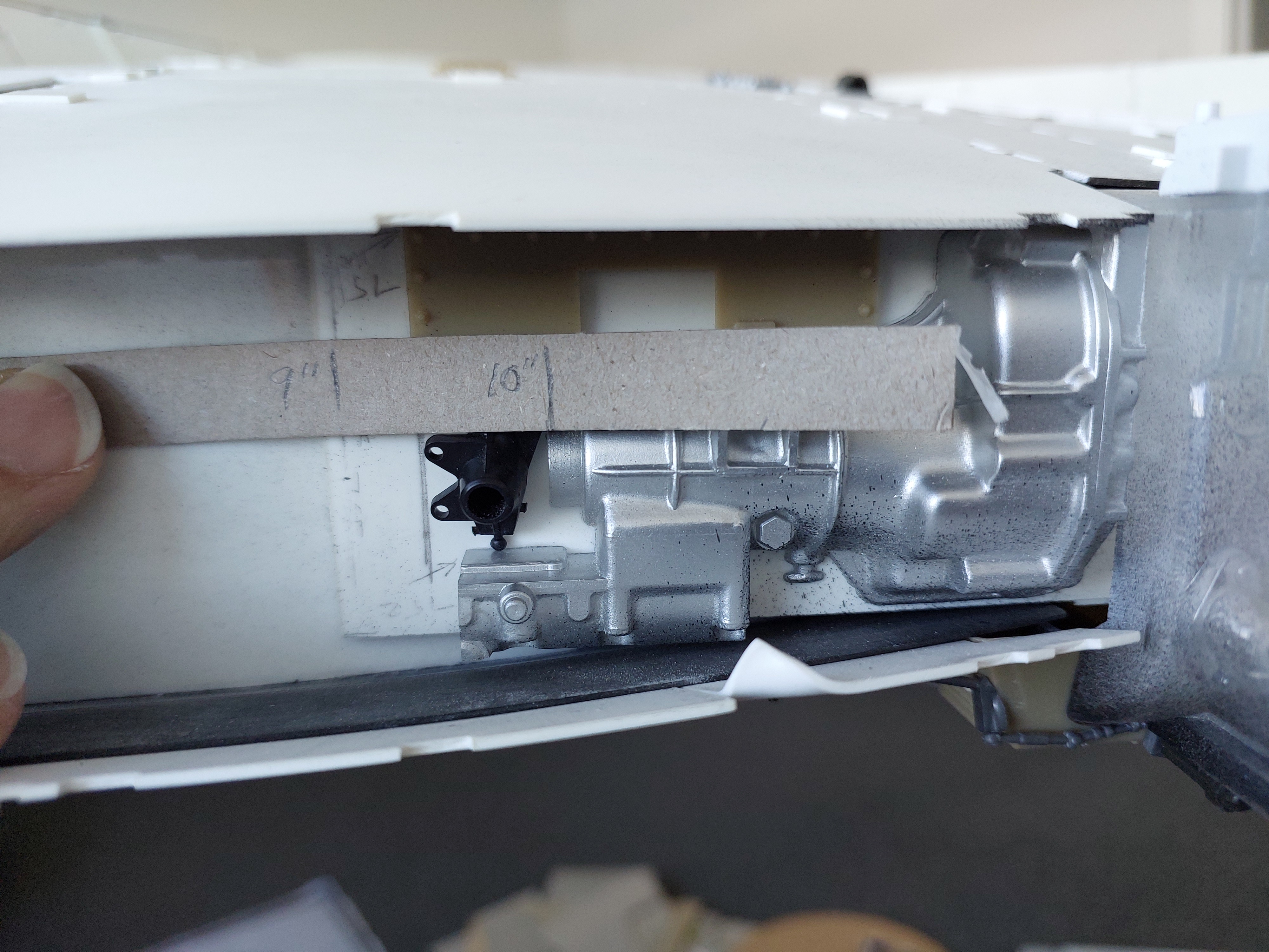

With kit part layout on key areas like the mandible sidewalls, you can transfer your findings to a card template & use this as a 'wrap' to find out how accurate or far off you are from mandible tip to docking ring sidewall end!.. I'm so old school...but it works.

Here's a pic John of my portside mandible sidewall, albeit upside down right now.
This shows key 9" & 10" markers taken from the docking ring sidewall edge.
This should give you an idea of distance & the wankel engine half position.
