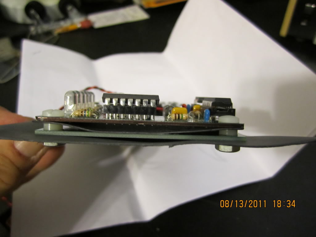

Here's what has been developed over quite a while (due to the big move, etc.)
Predwolf wanted some amber LEDs that would brighten and dim added to the Nolan P1.
I had to get creative and a) design the circuit with as few parts as possible and :lol: figure a way to add it without having to redo the existing layout of the Nolan P1.
I found a relatively empty corner of the board and squeezed it in.
The board fits in the right corner of the Nolan P1:
Side view of standoffs and insulation:

many thanks, at one point I thought I'd never get it small enough & fit in there. Lotsa going on...
I just checked, and if I wanted to add it to the other P1 board- for the P1 Deluxe- it won't fit... it sticks 1/4" over the end of the board :0

looks good Julie. but since it is raised, and towards the bottom, how far is it going to stick out of the lid?
xdmray,
the little spacer under the daughterboard raise it about 3/8" higher than the main board.
Predwolf is building/designing a gaunt around the board, and thus the LED height can be figured in.

many thanks Torredator :)
dimension correction: it should be 3/16" higher, not 3/8" :0
