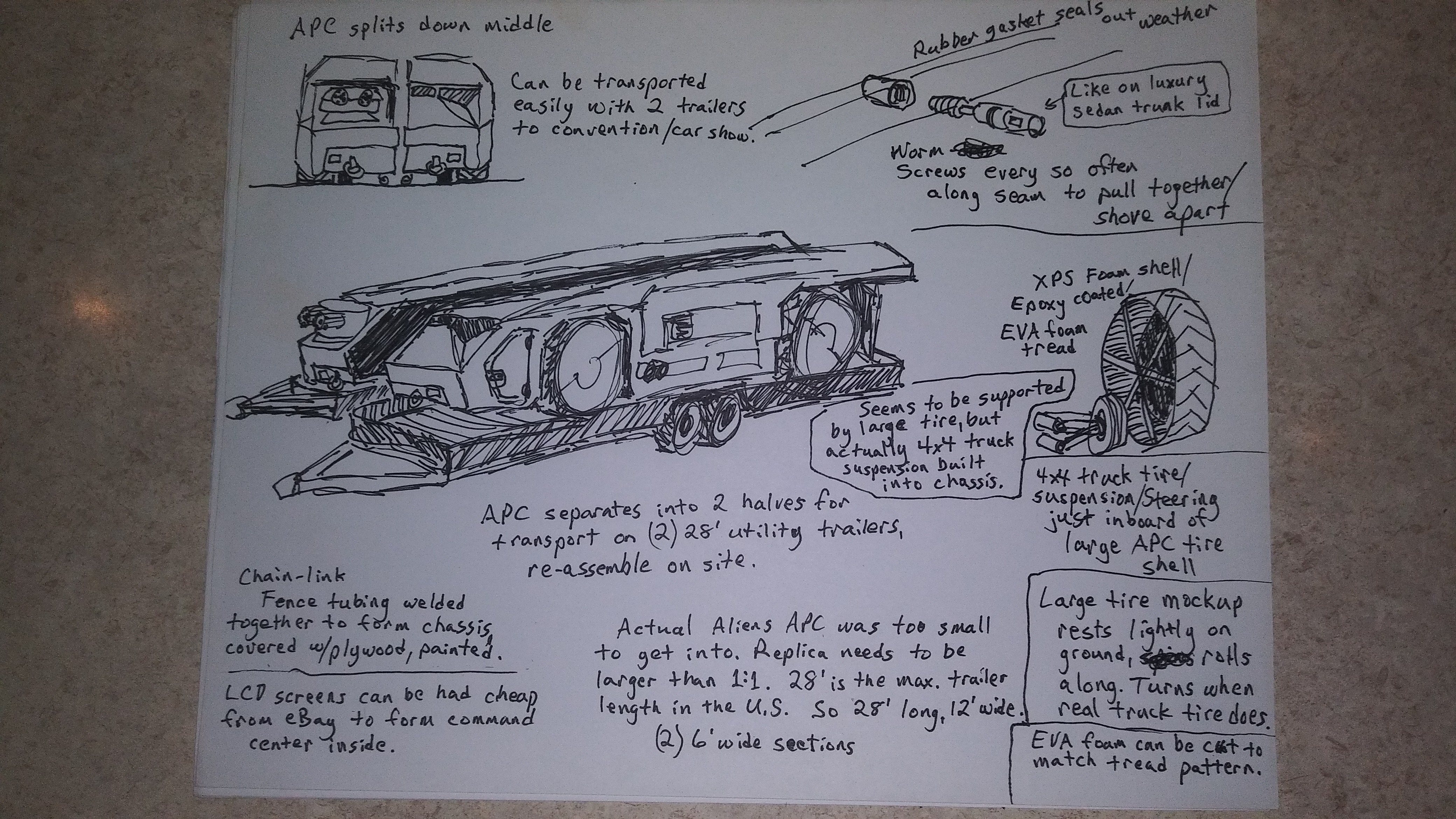

This is my design, i have it worked out alot more than this, but this drawing will give you the basic idea.
I have a nasty wound on my ankle, no skin 3/4 around. No skin on top of 2nd toes of feet either. Doctors blame poor circulation. Constant pain, hurts to walk, doctors won't prescribe effective pain meds. I spend most of my time sitting in comfy chair in garage with feet elevated, trying to minimize pain. None of my projects are getting done, but i have worked out the designs to the Nth degree...nothing else to do.
