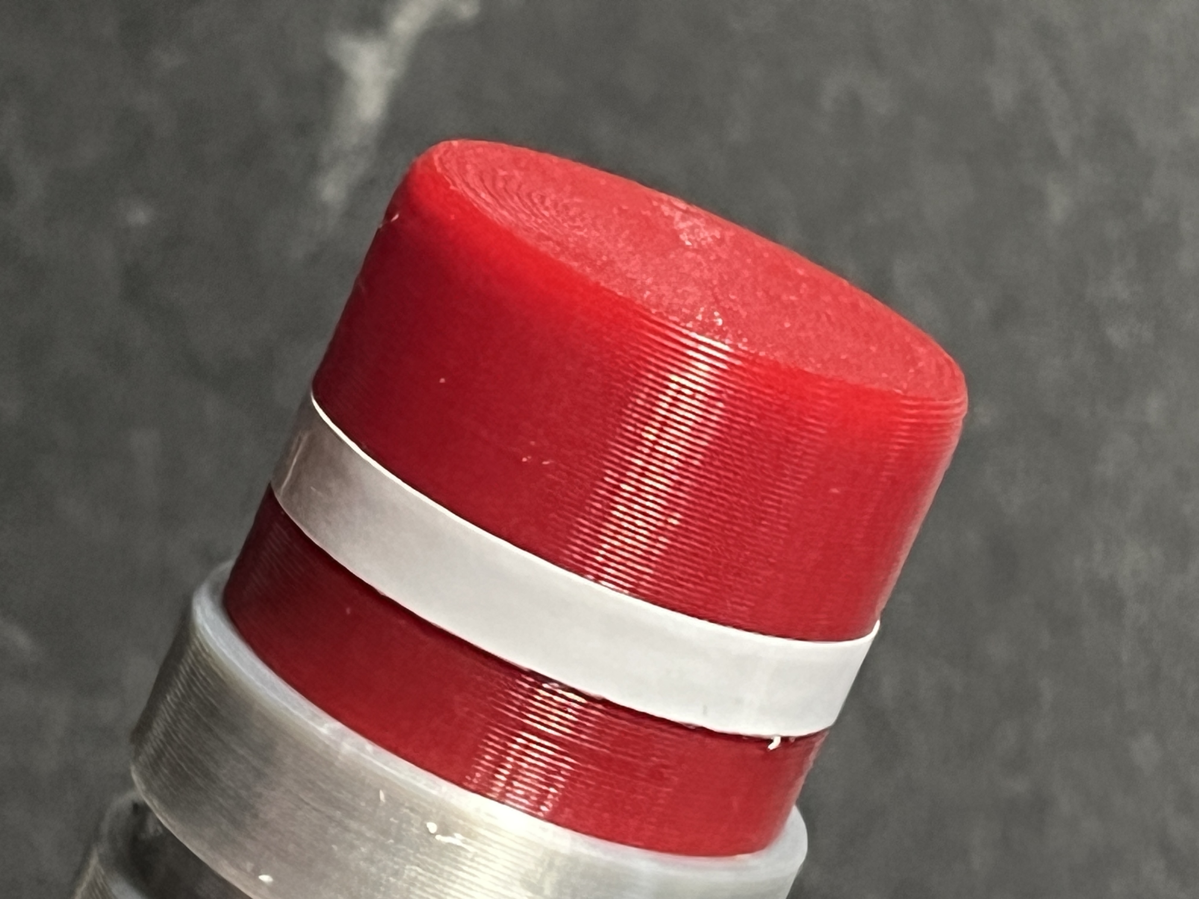

Still need to think about the pop-off plastic caps, which seem a little bit hard to source. I want at least a few really removable ones—I want to see if I can achieve a good fit—but I’ll probably also make some with the cap just sculpted on.

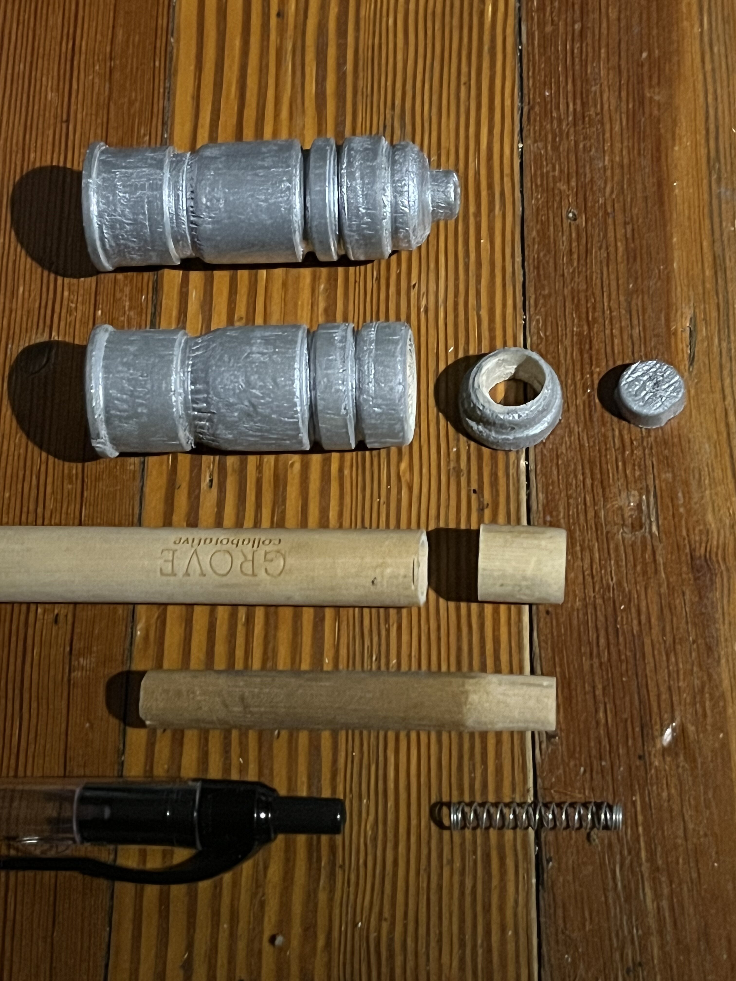

I realized that my second test piece was too long in just the right place for me to saw it open, drill it out, and make it into a clicking version the same size as my third, more accurate one.
Pen spring. Bit of 3/8” dowel. Slice of bamboo drinking straw.
The version with a pushable button works so well, I figure I’ll want to make a few more at some point. Luckily I have a big box of pens waiting to be recycled. I raided it for springs, something I honestly should have done a long time ago.

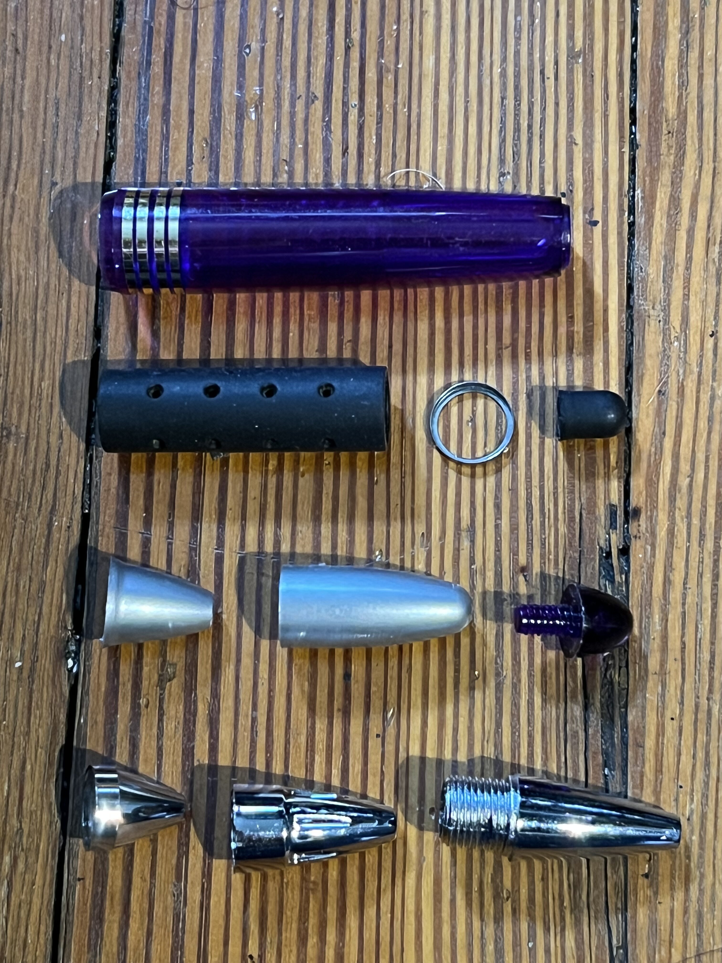

I also scored some cool greebles for other projects.
It’s easy to get carried away with this kind of stuff, but when you like building weird stuff cheap, it’s important to cultivate a useful collection of random greebles.
I tried making one with a sculpted-in “cap”, with some miniatures paint I had handy.
It looks awful. The matte paint and some slight asymmetry makes it look like lipstick.
If I take more care with the turning and use a more appropriate paint, I hope I can get a better result, but it might not be easy.

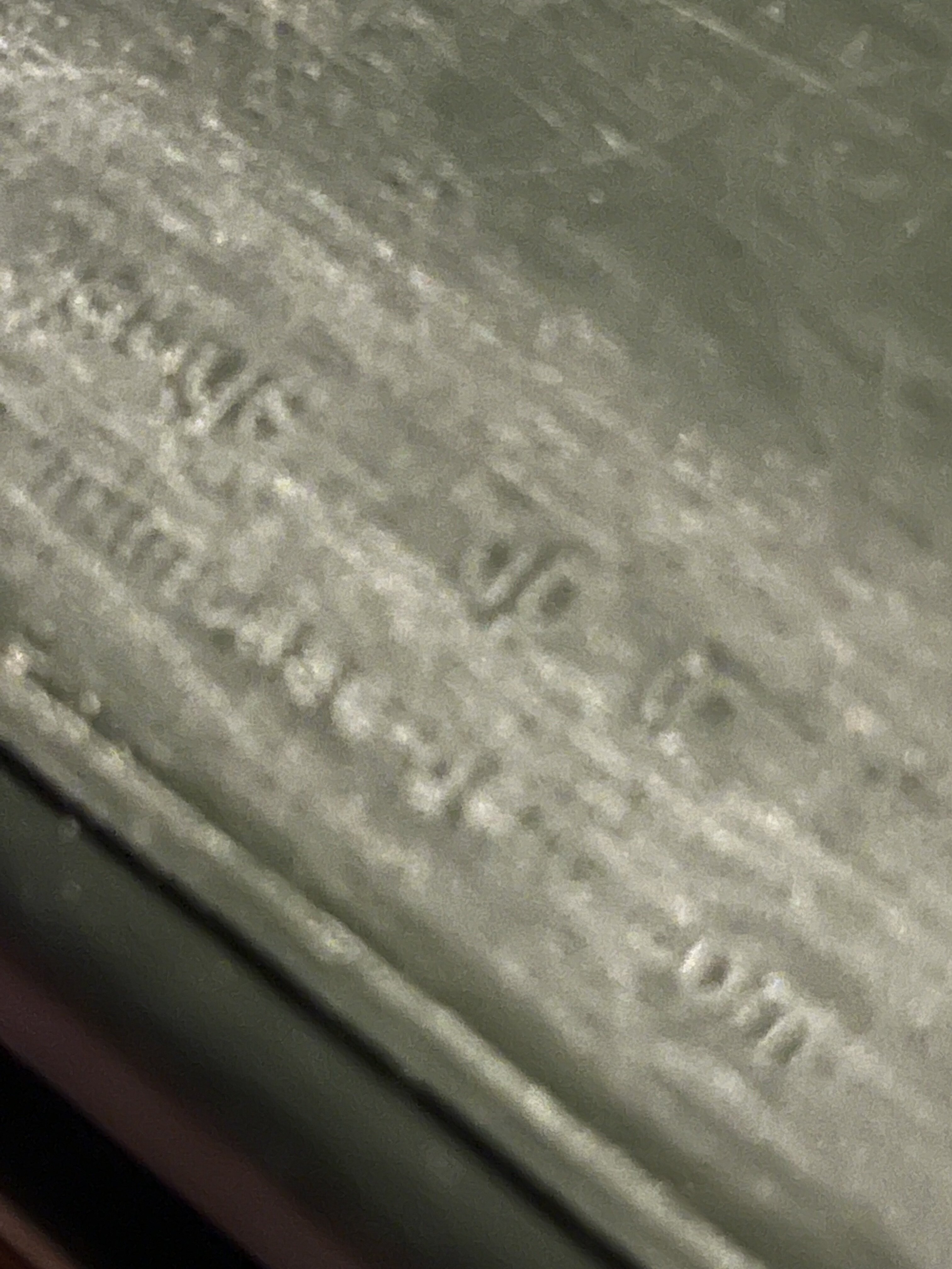

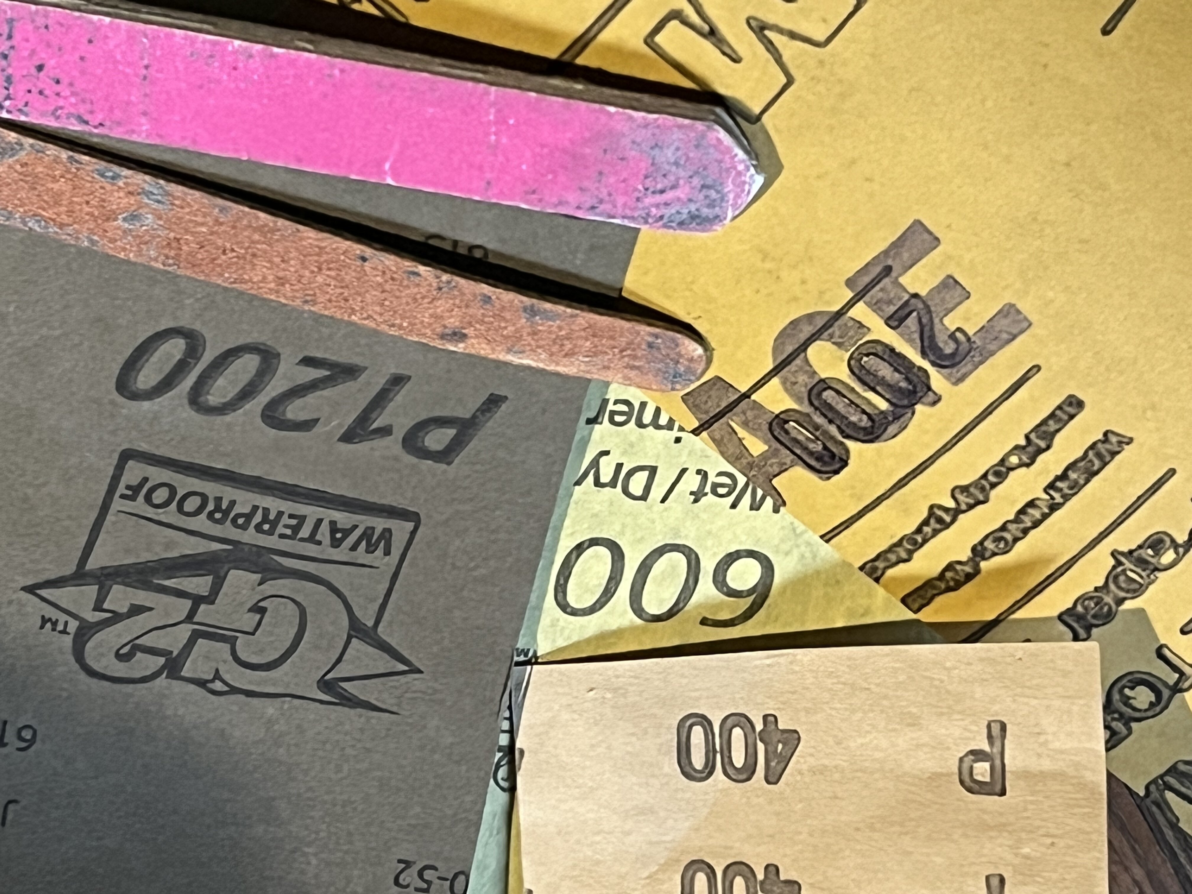

MTM brand box with the branding painstakingly sanded off, from emery boards down through 600, 400, 1200, 2000, then Novus #3, #2, and #1. (It was frosty looking right down to the final Novus polish.) I particularly wanted to get rid of the "www" at the bottom....
