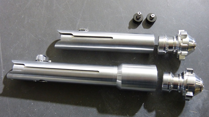

here are the new parts
so that's the problem when you are waiting on parts but still have to move forward, the parts don't fit. The threading is almost the same size at the outside of my tubes. the best story is the long one, I spent a long time fitting my tube to the larger one and making them sit flush. I actually needed to have one cm without the thin tube at the end of the long saber. So I had to push back the inside tube out of the large tube... that was fun. and now the lightsaber is 1cm too long so I'll probably try to remove completly the tube and cut it later on...
for the short saber, I filed the threading away and filed the inside of my tube to make them fit. Took a long time but this worked great, both parts are now put together by brute force and are not going to separate any time soon
