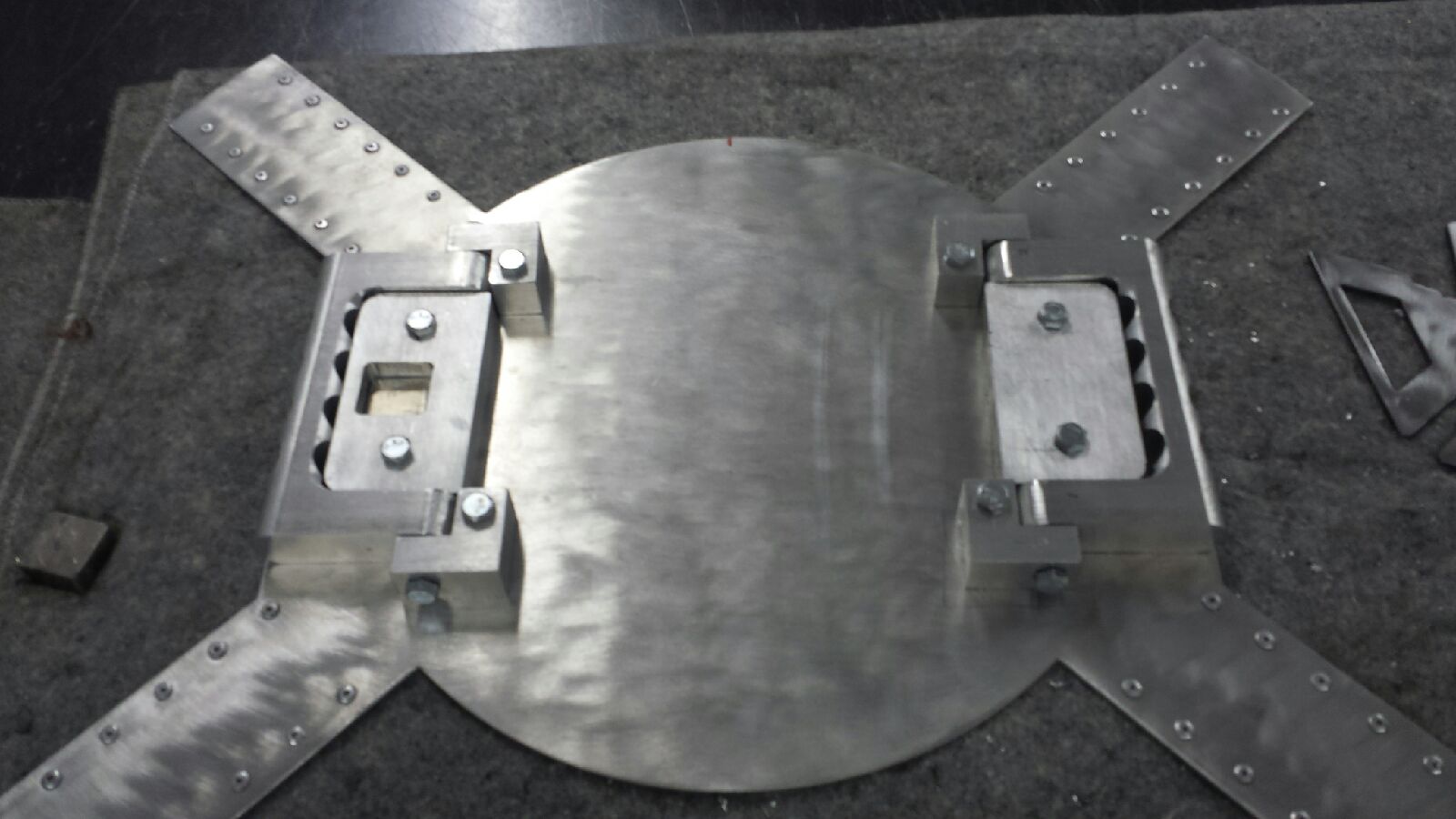

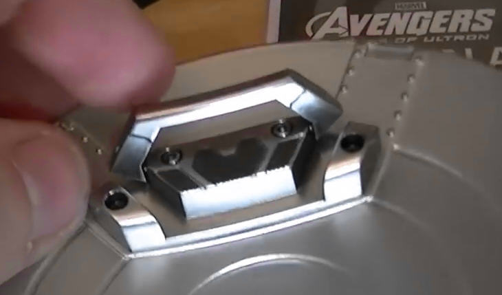

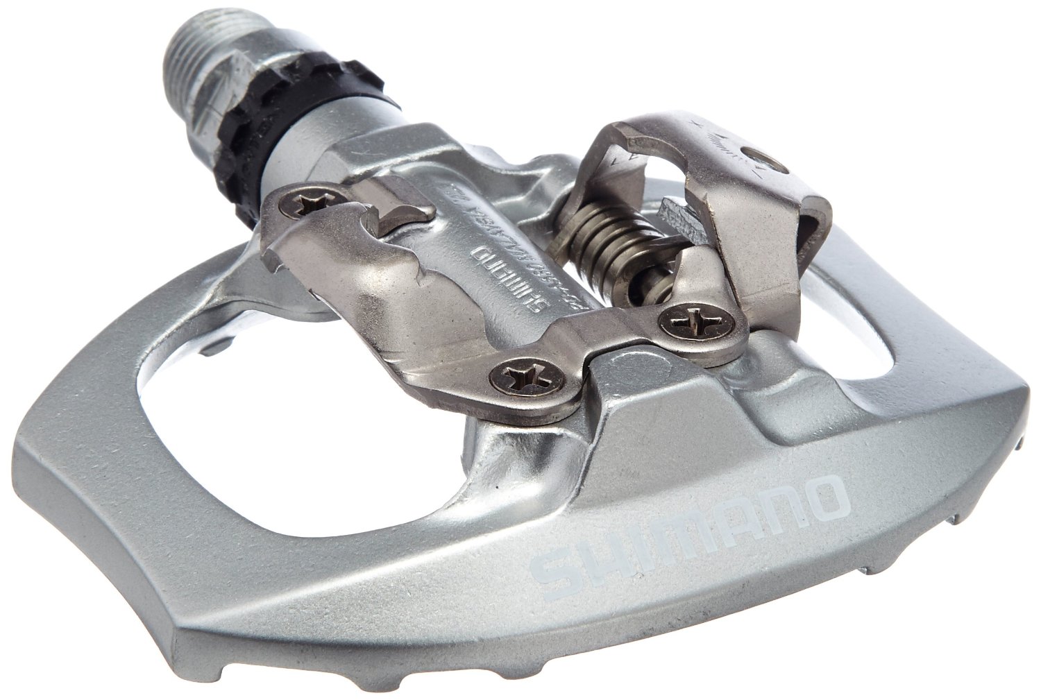

Interesting. I don't ride anymore, but can you tell me, could the spring tension be dialed back enough on pedal clips like these so that you could release the cleat from the clip, rather than just tearing the clip or cleat off your shield or forearm?
I'm worried that the release tension would be so strong that the clip and cleat will stay together with more strength than any mounting material could secure each to the shield and gauntlet.
I like the look of the Shimano PD-A530 SPD pedals. The underside is flat and the clip sticks up nicely. The low price I found was $35 for a set of two.
You could grind off a ton of superfluous material.

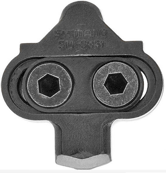

I also discovered that Shimano makes two kinds of cleats, one of which can uncouple from the clip in a lot more directions than the other, so it pays to make sure which type you get.
Would this possibly work? One could lock in the upper forearm first, and then the back of the hand. To uncouple, I see it working like this; torque your wrist toward your little finger to release the cleat from the clip. Holding the shield with your opposite hand, rotate the shield to torgue it of the upper foerarm clip.
Can it work?

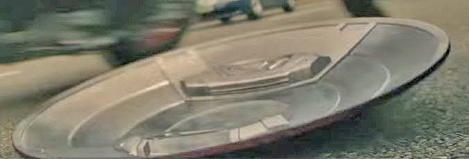

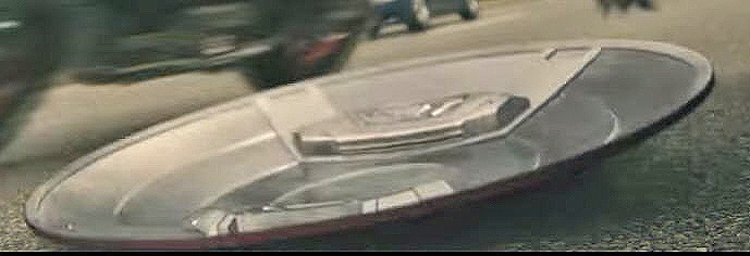

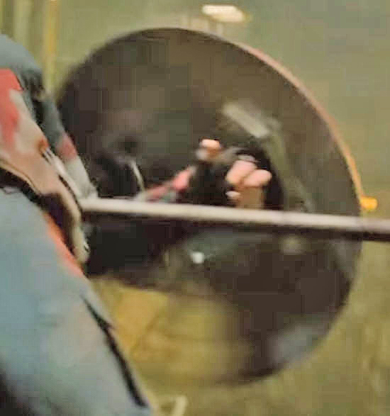

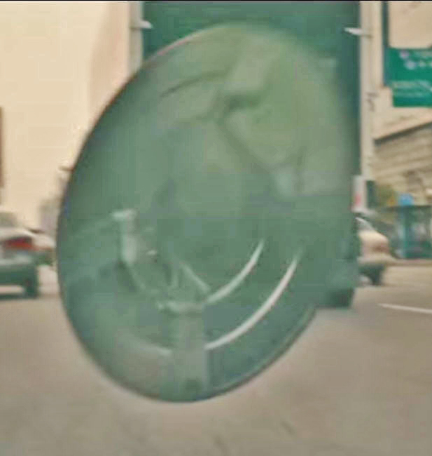

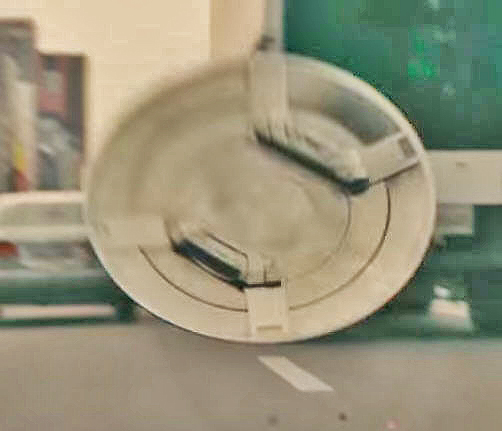

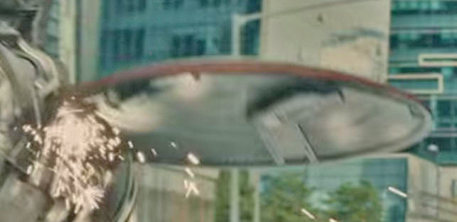

More screen caps for what every they're worth to anyone who can make more sense of them than I can. Wish the quality were better! BOY do I wish the quality were better.
AoU - Cap - SHIELD back - screen cap from trailer 3 - bounding down the road 2.jpgAoU - Cap - SHIELD back - screen cap from trailer 3 - bounding down the road.jpgAoU - Cap - SHIELD back - screen cap from trailer 3 - stuck in Ultron - blurry.jpgAoU - Cap - SHIELD back - screen cap from trailer 4 - leaning back over rail 2.jpgAoU - Cap - SHIELD back - screen cap from trailer 5 - lying on the road.jpgAoU - Cap - SHIELD back - screen cap from trailer 4 - lying on the road.jpg

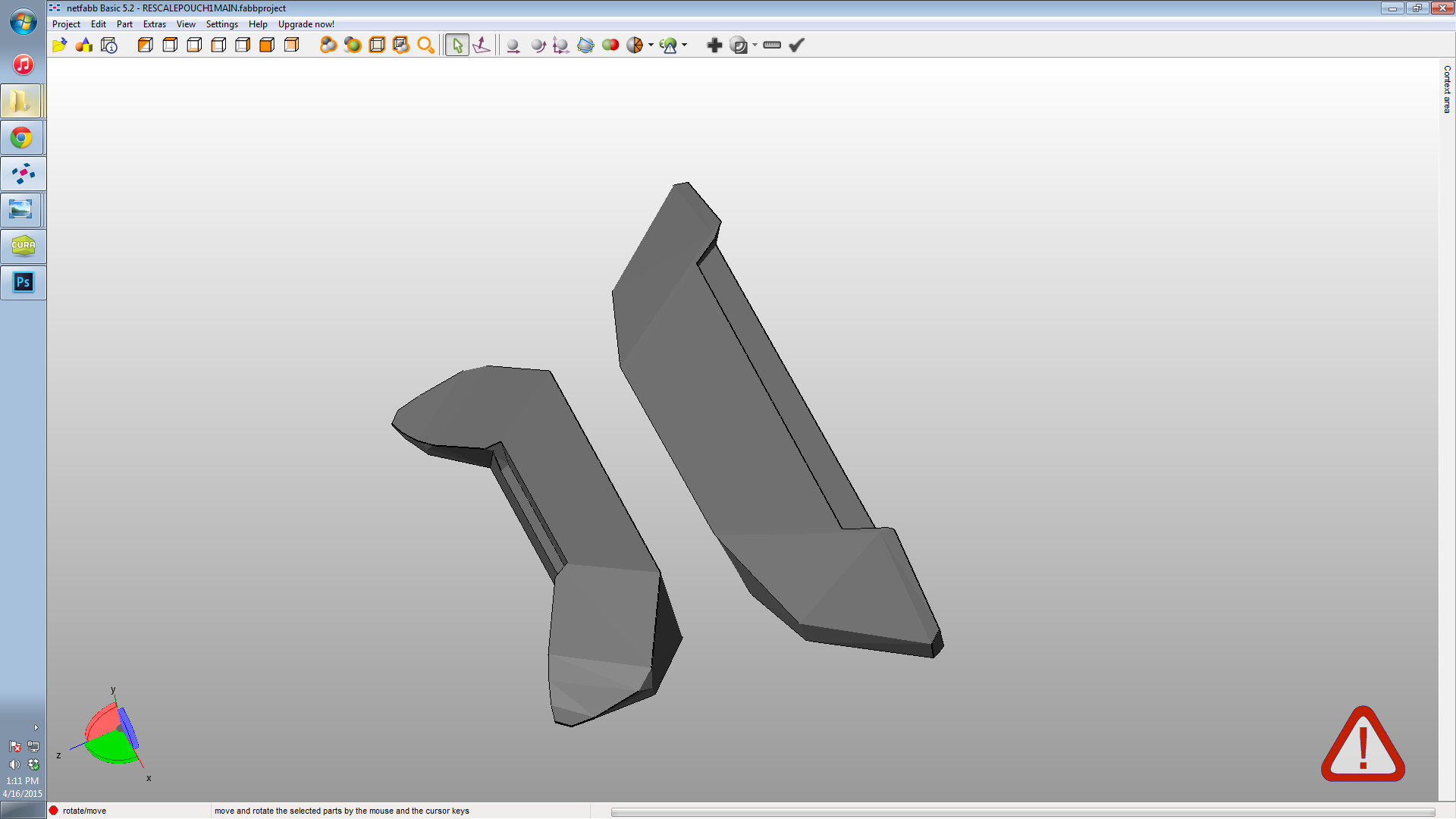

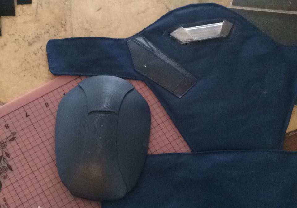

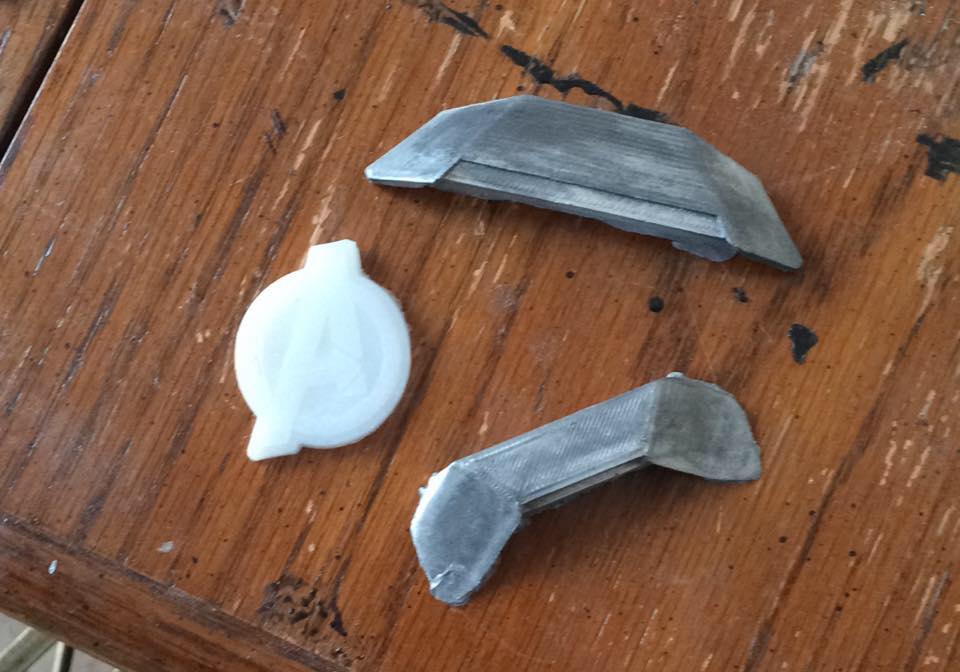

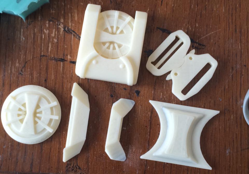

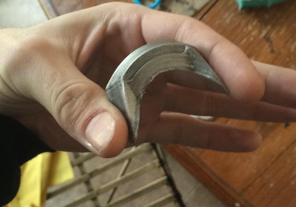

I modeled and printed the arm magnets for Phizzle Cosplay a month or two ago, although we didn't have anywhere near these many reference images so we had to go off set photos:
3D Models:
Raw Prints:
Finished Magnets (we molded and cast them from rubber so they'd attach to the gauntlets better:
And here they are on the suit:
Maybe we should take another crack at them and see if we can get them to glow like in the trailer? Or would you guys rather go the practical route with magnets?

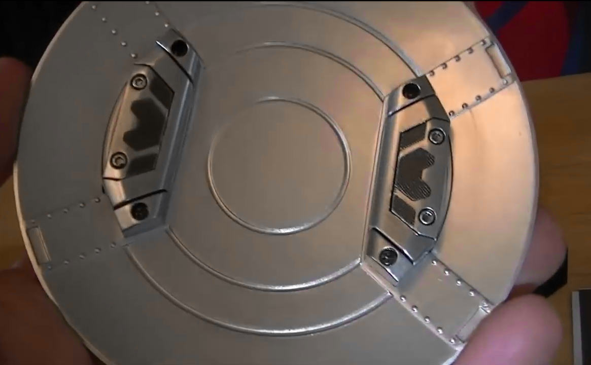

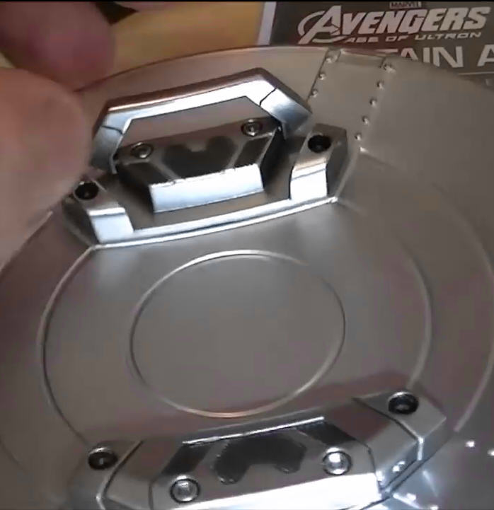

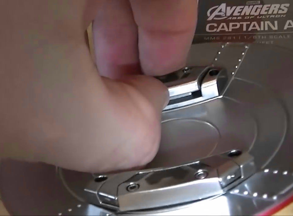

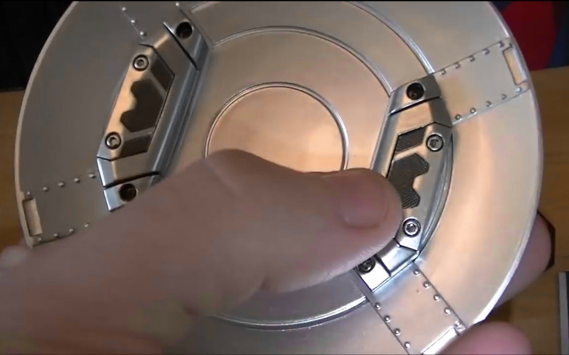

The hot toys shield, while being far and away the most accurate reference for a toy, has a couple of differences from our screen grabs. The brackets are too centered and symmetrical, And the new handles are too thick. In the captures from footage, one bracket is closer to the center than the other.

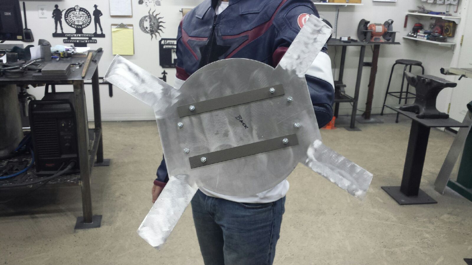

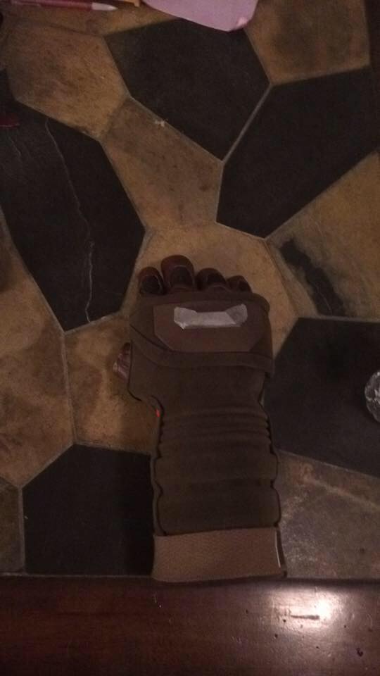

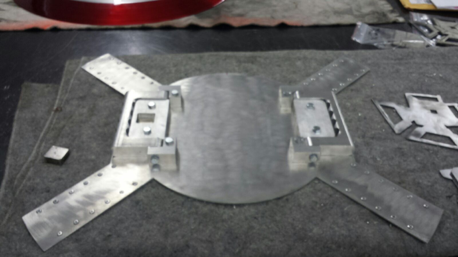

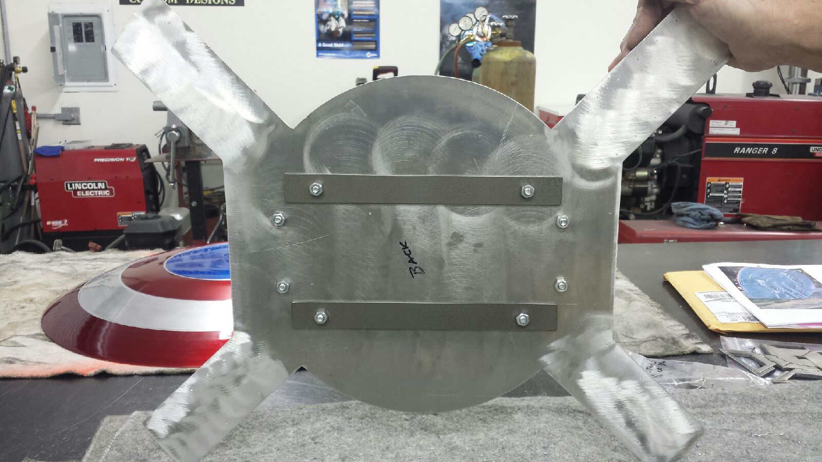

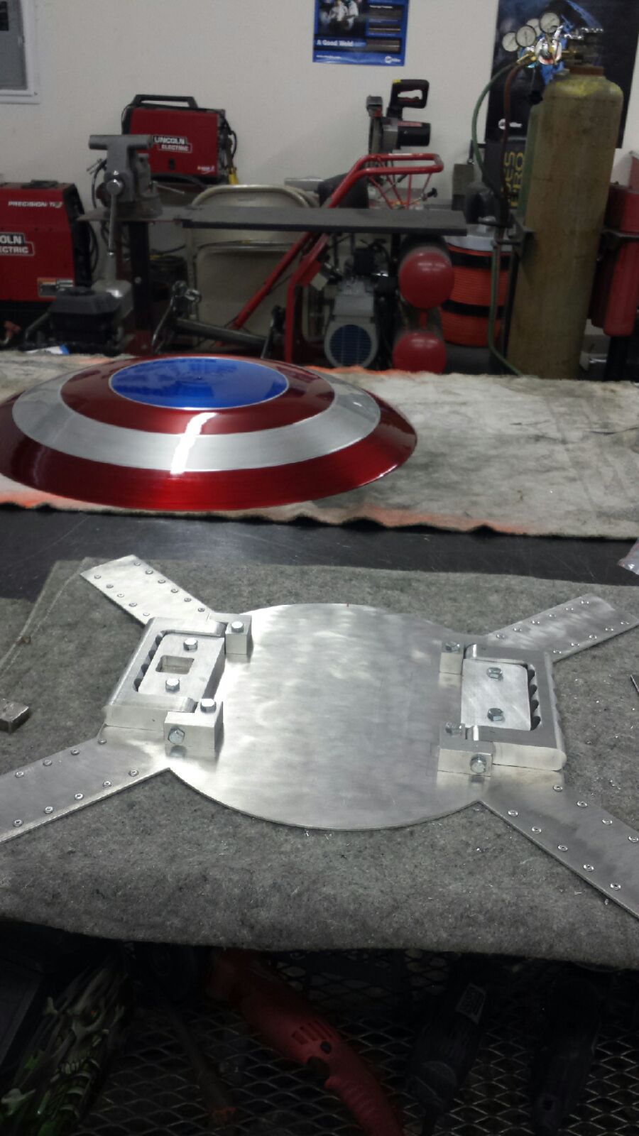

Just saw this thread after making my own, been working on this. Here is what I have so far, got the magnetics functioning great - just working on the details now... IMG_4325.JPGIMG_4326.JPGIMG_4327.JPGIMG_4328.JPGIMG_4329.JPGIMG_4330.JPGIMG_4331.JPGIMG_4332.JPG
