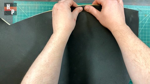

Next the back was skinned with some foam.

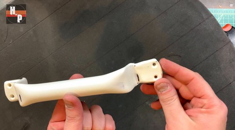

And PVC pipe was bent to make a handle which was mounted to the back with screws.

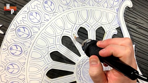

The a wood burner with a knife tip was used to create the planking lines.

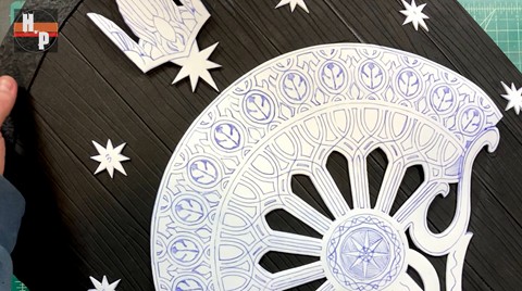

Then the appliques were glued into place.
And different wood burner tips were used to create texturing on the Tree of Gondor

I like the idea of heating of the knife like that. Any type of cutting like that, even without heat, always that fear on a big peace, to slip and mess the whole thing up.....always nerve wreaking.
I know what you mean. I was terrified the whole time I was cutting the straight lines:)

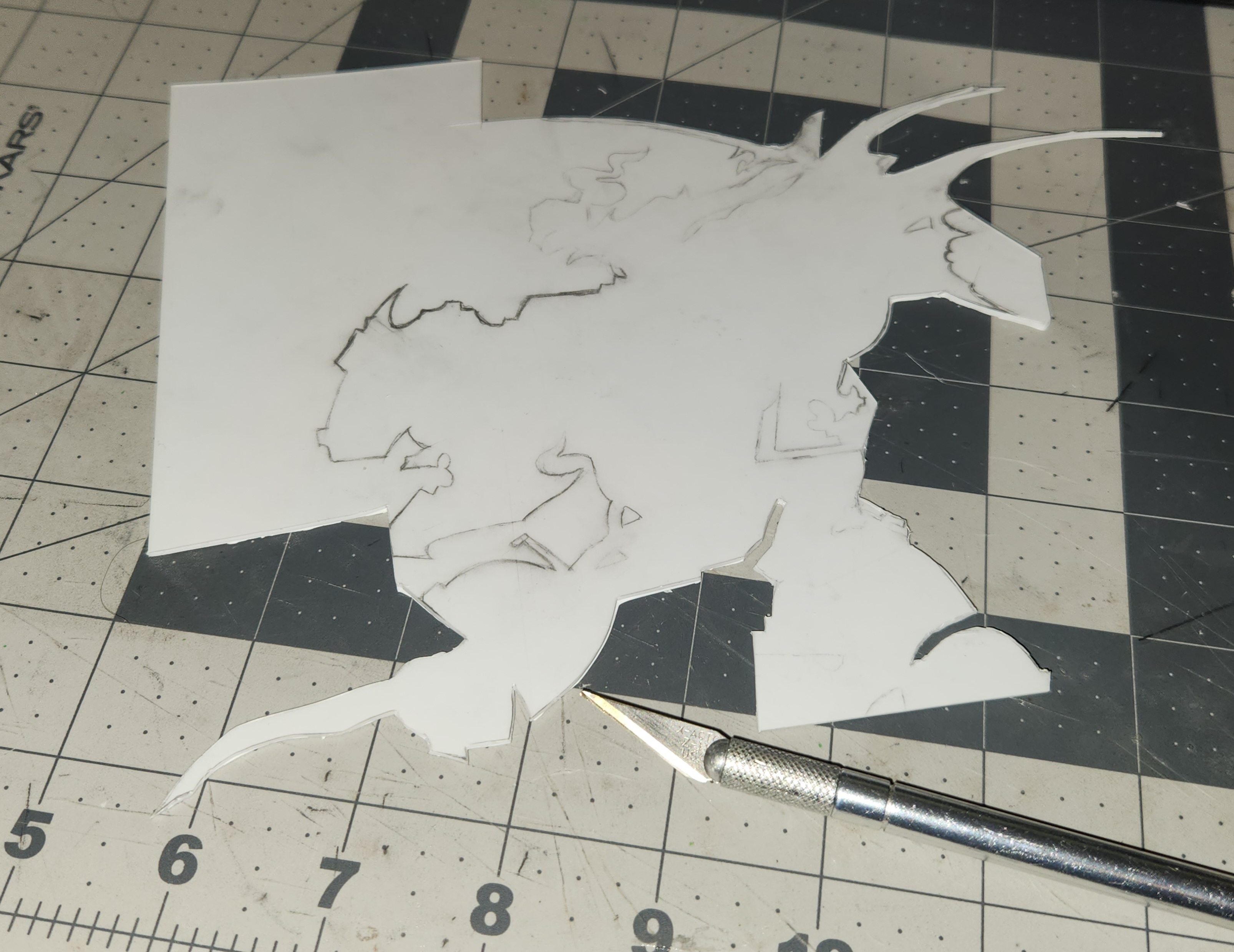

Yeah...I just cutout the logo from Final Fantasy 6 with this exacto knife. I knew, one slip and it was all over.
But I made it all the way, thankfully.
