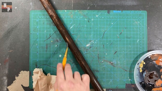

The shaft is based with in raw umber, and burnt sienna was dry brushed to create a woodgrain.

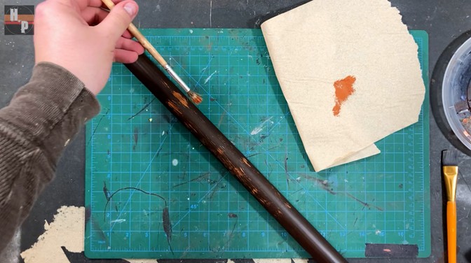

Then a black wash was used to age the wood and "tone down" the color of the woodgrain.
