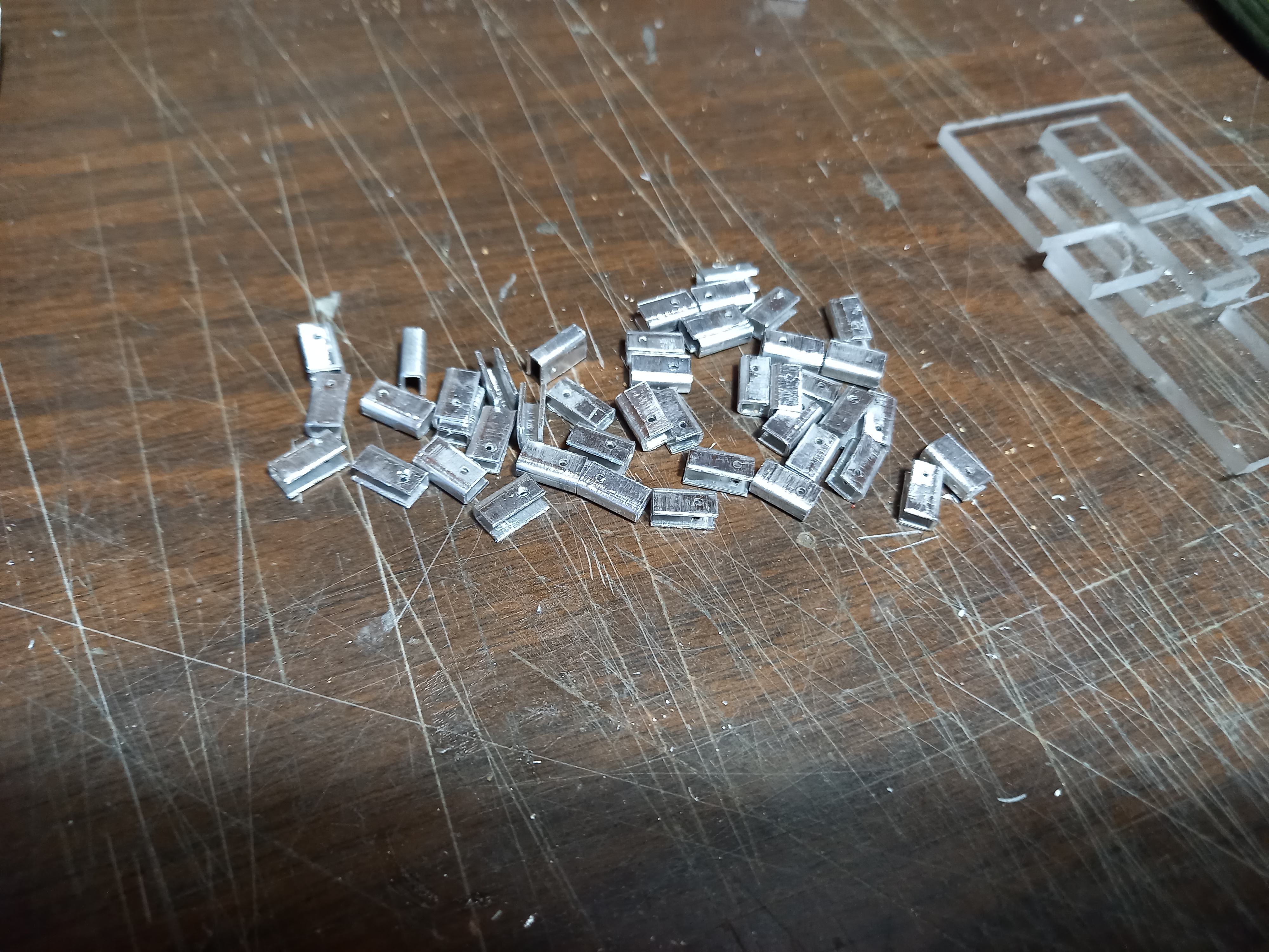

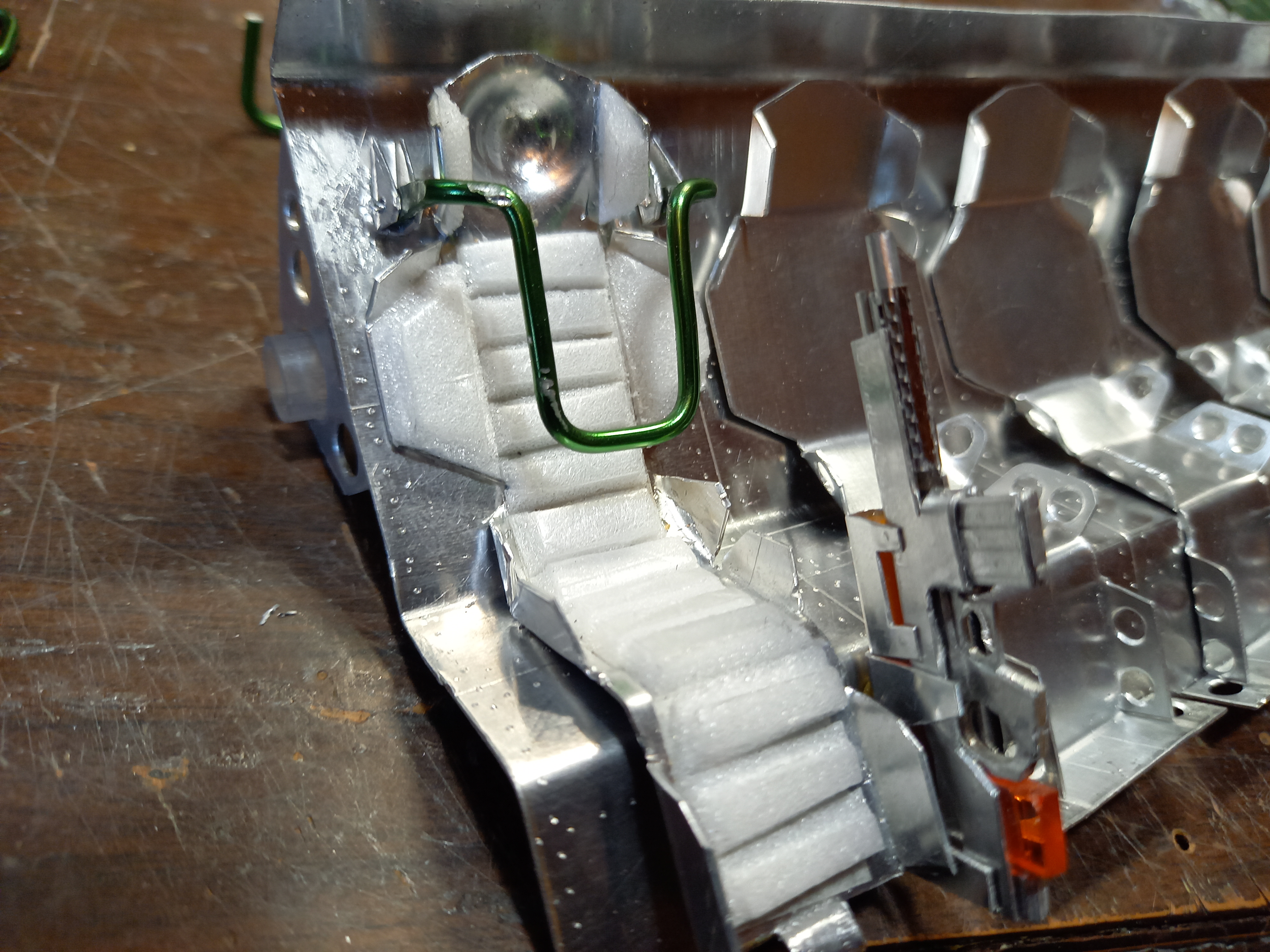

The mechanical part of the seat slide and rotation has been done this morning and I started detailing the seat and pedestal.

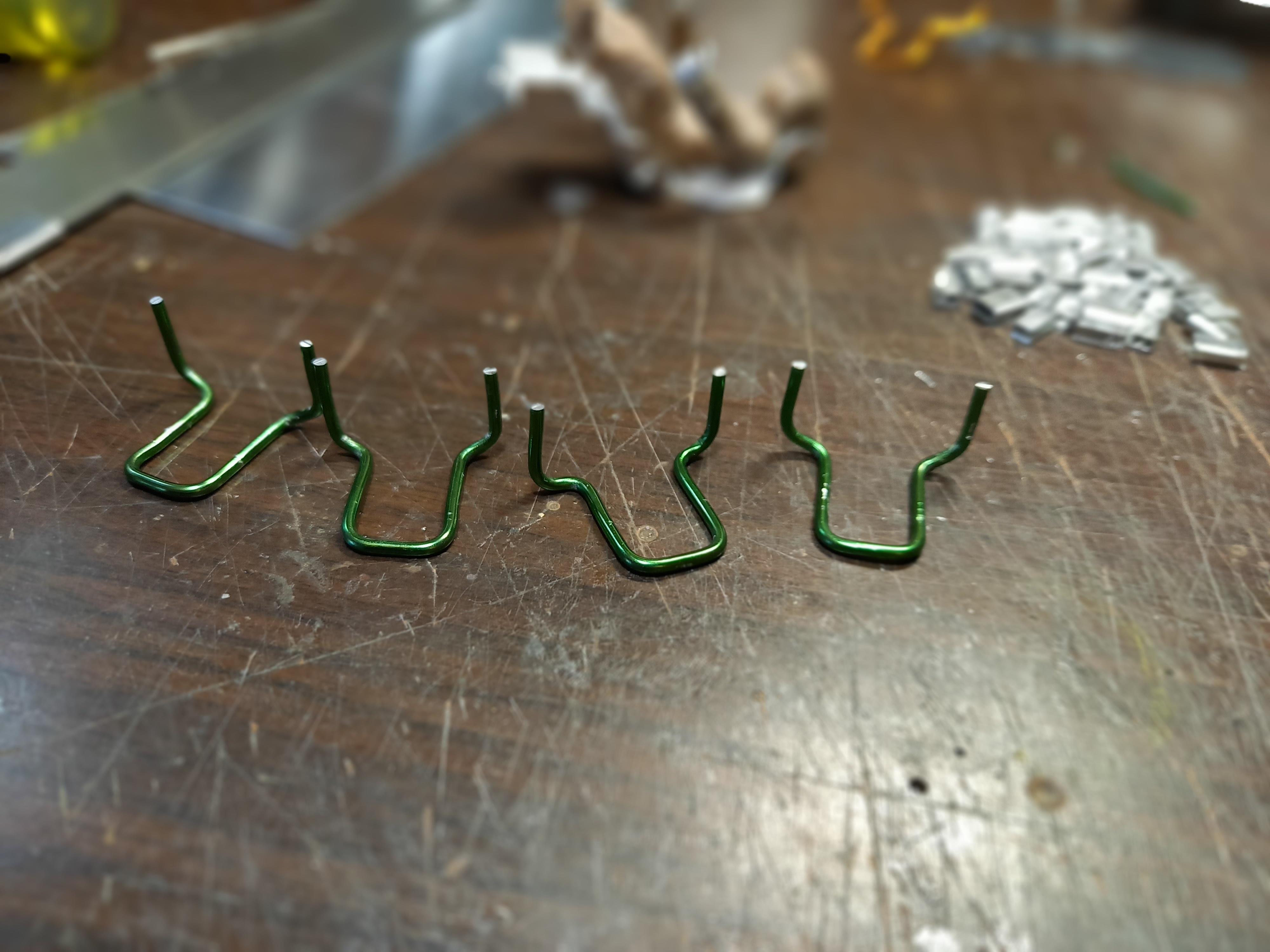

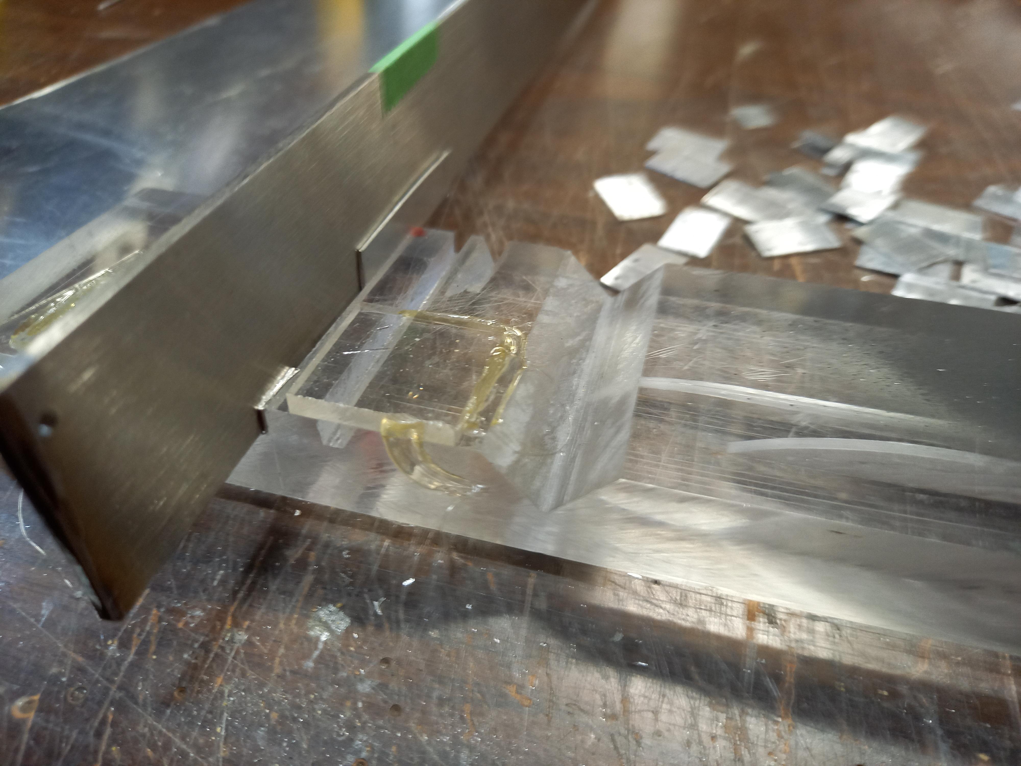

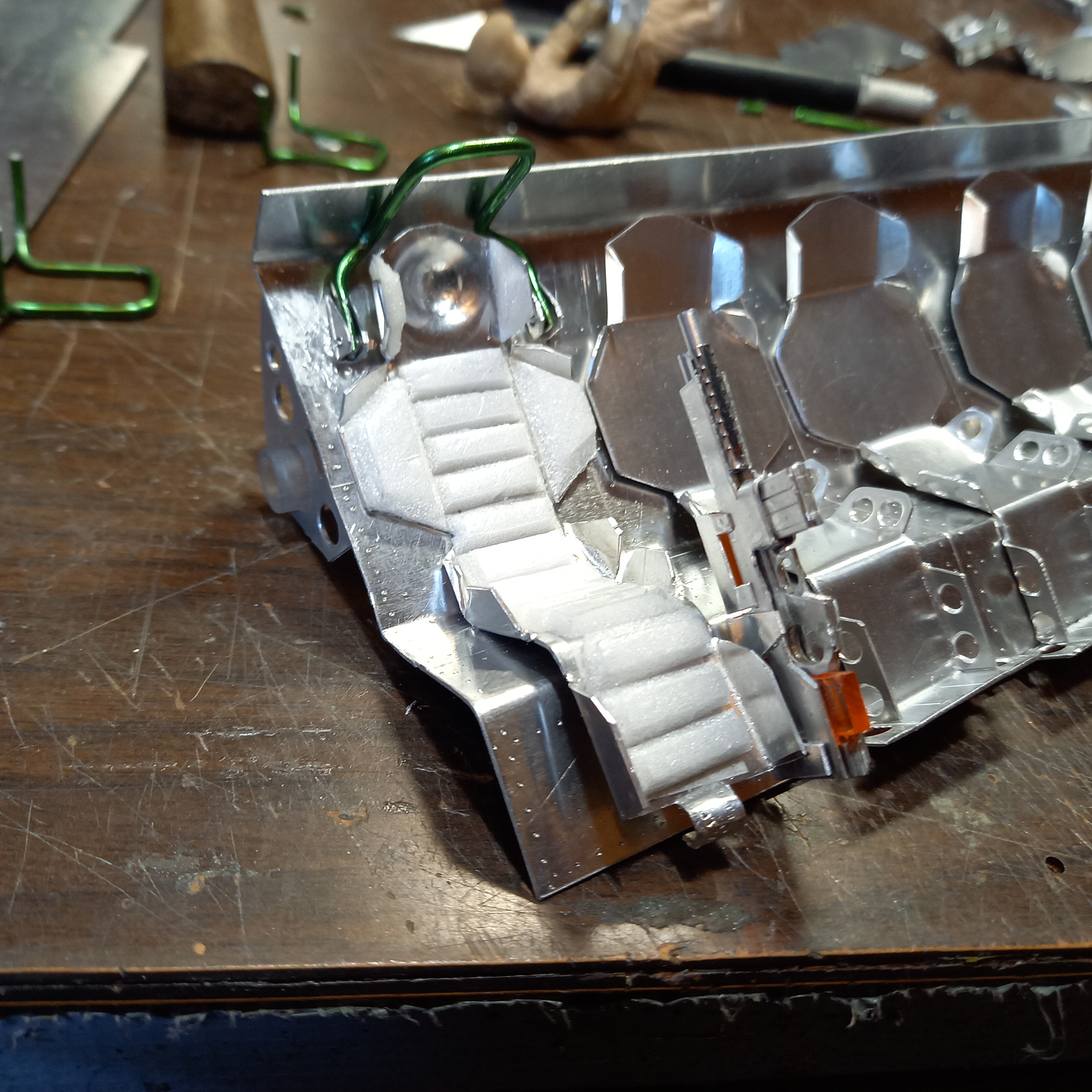

Once I thought of equipping the seat belt for each seat but it was nothing cool. This morning, I've just happened to design the holdback bar for the soldiers. It looks like one in the APC of Aliens. Took an hour to design the bar and I made a jig to make dozen of them with the same shape.

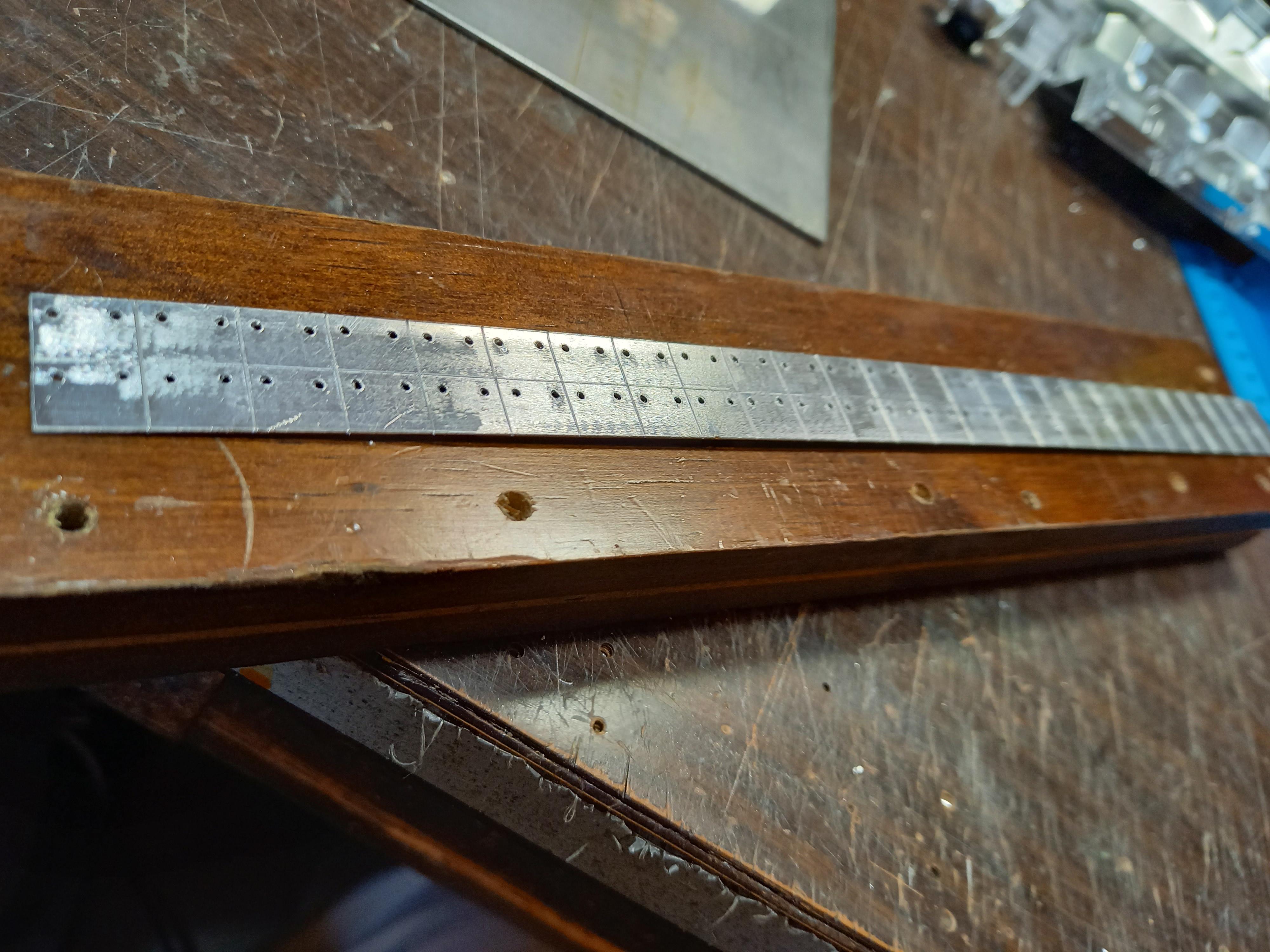

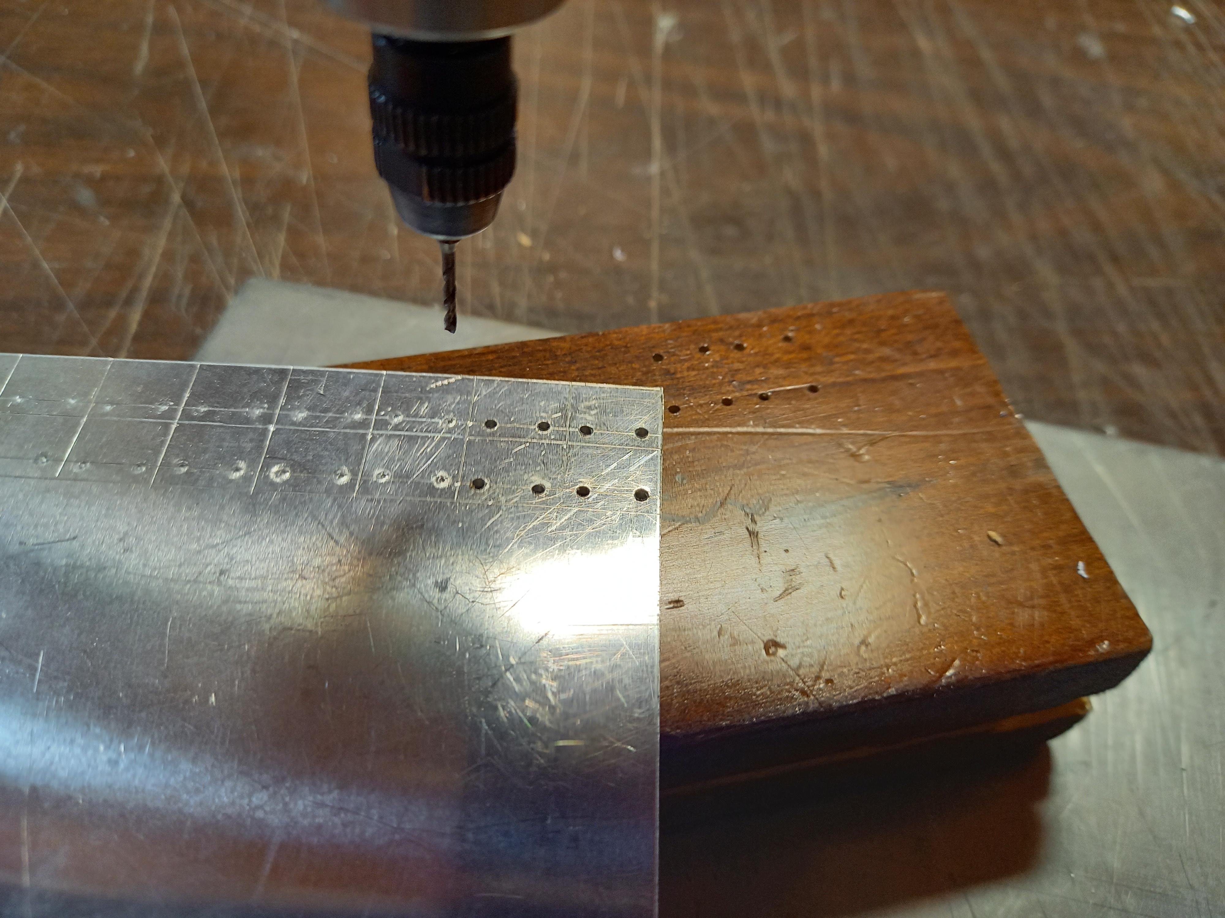

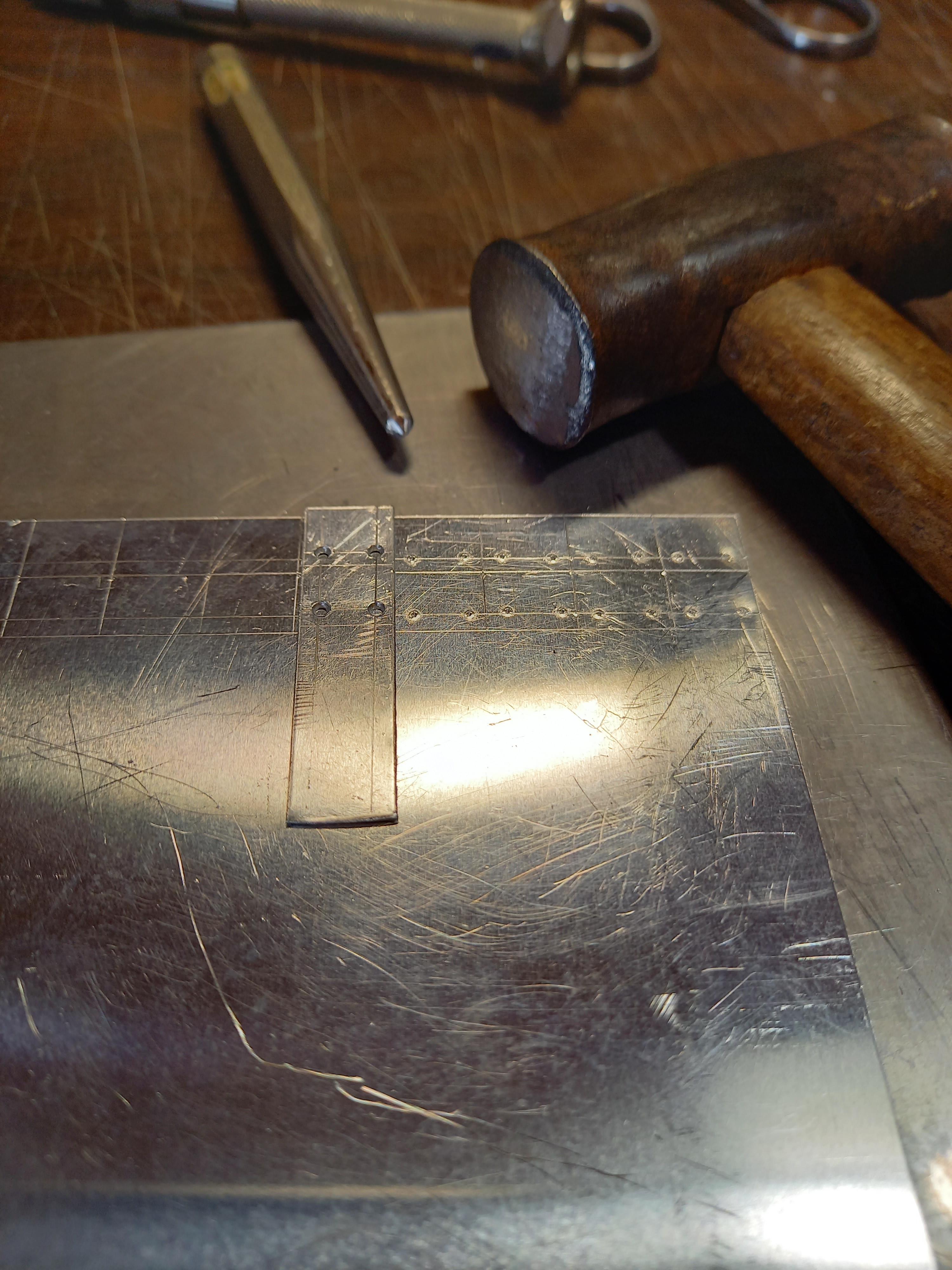

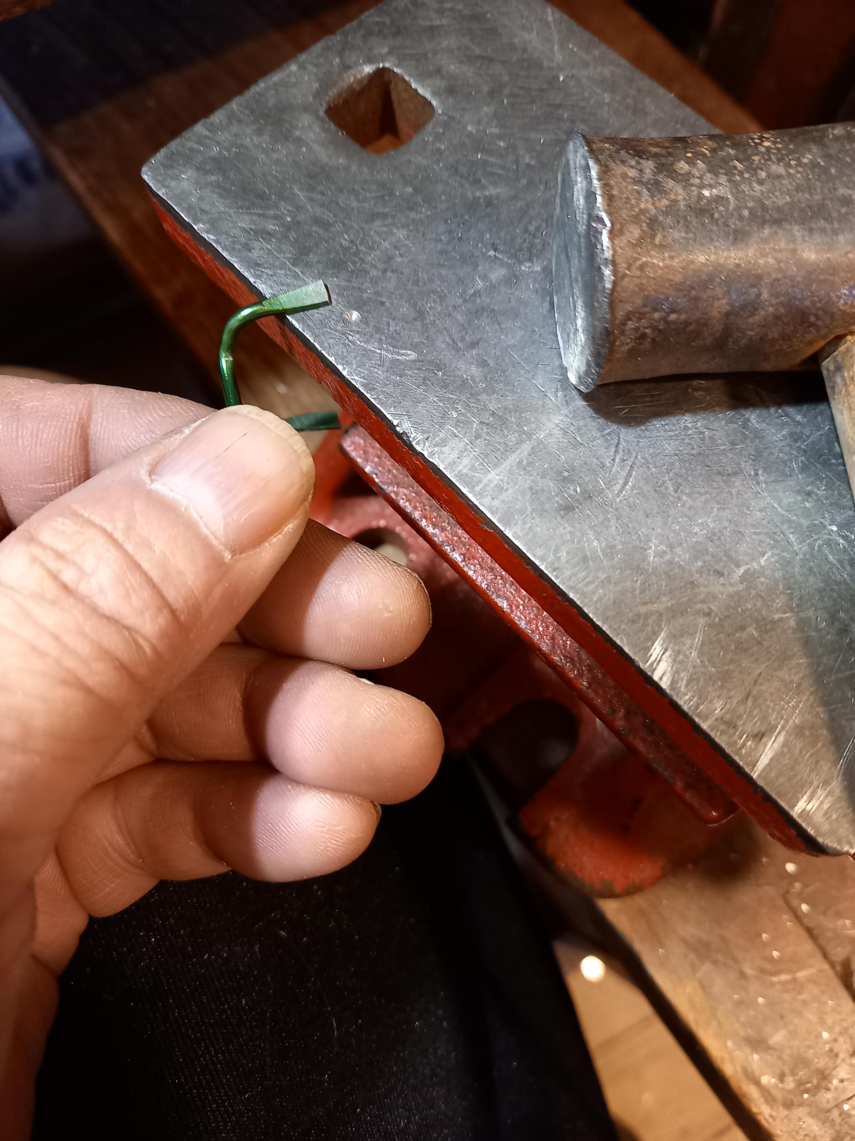

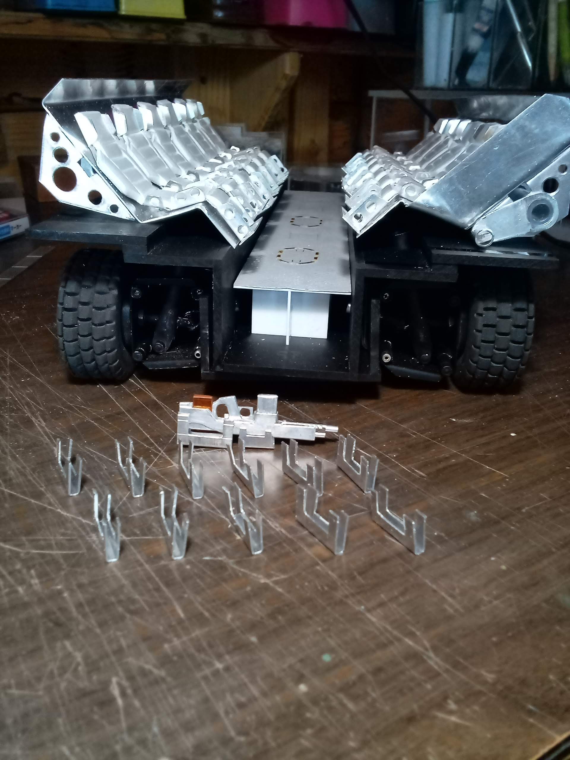

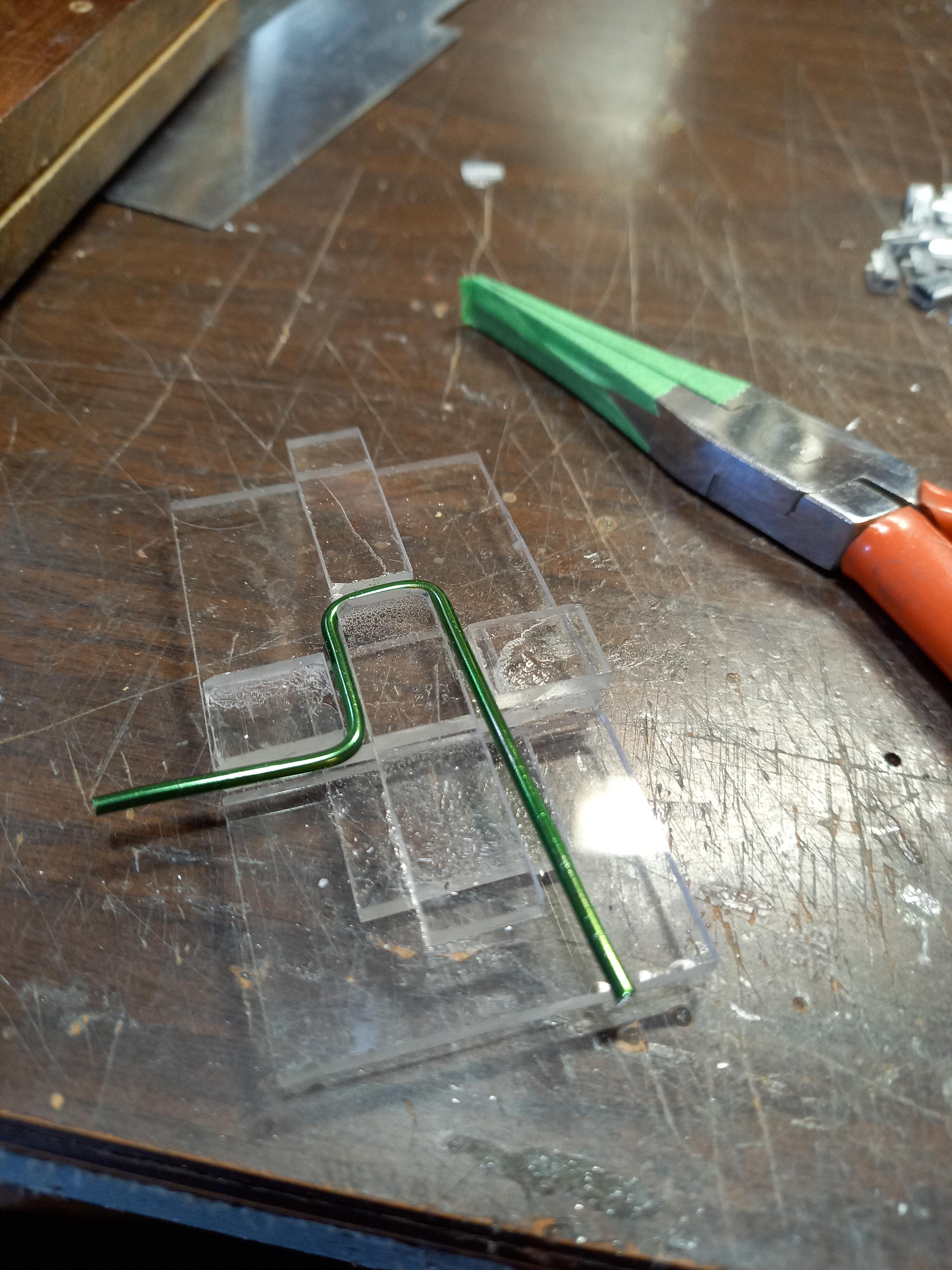

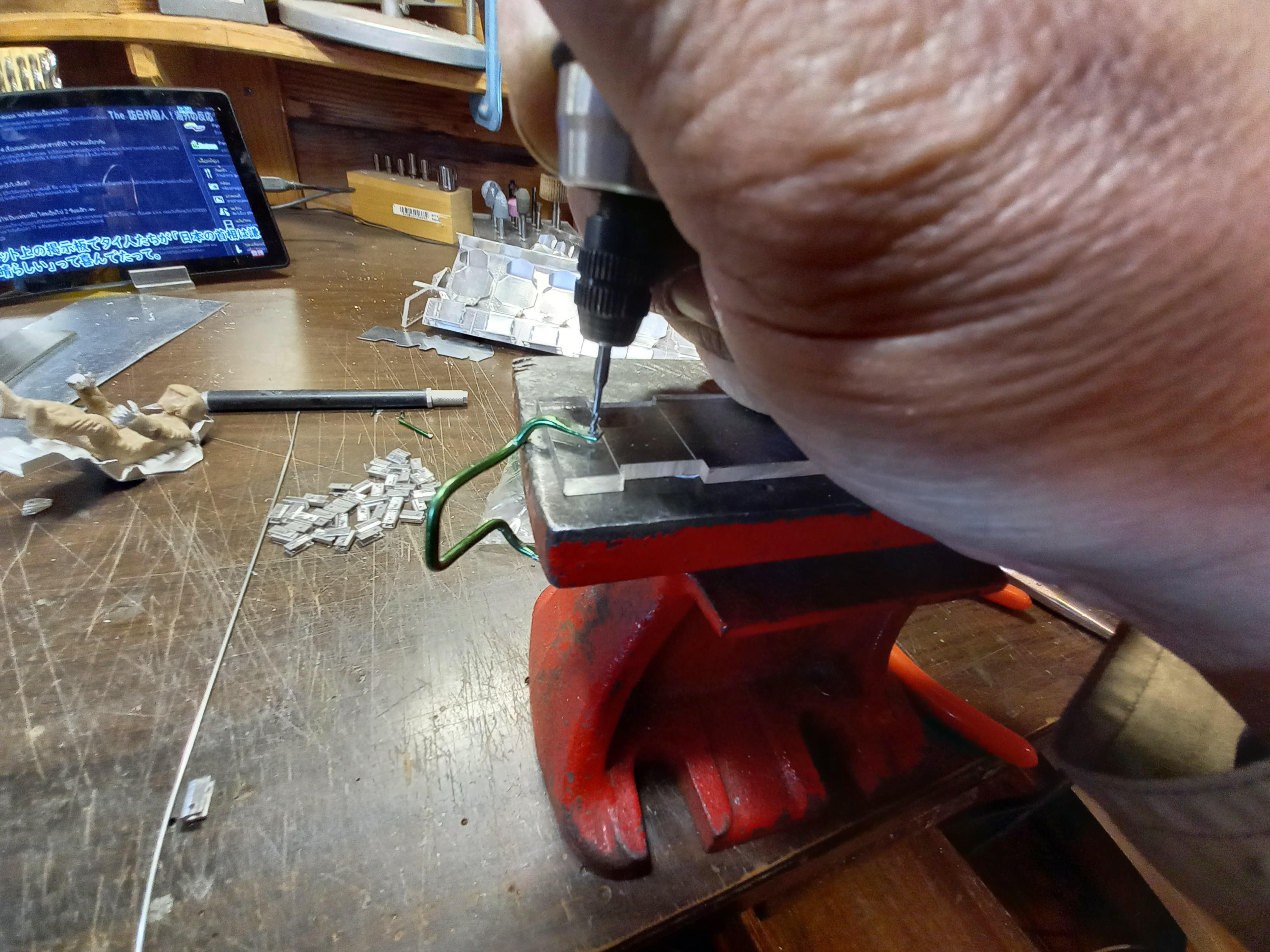

Here's a day's work.

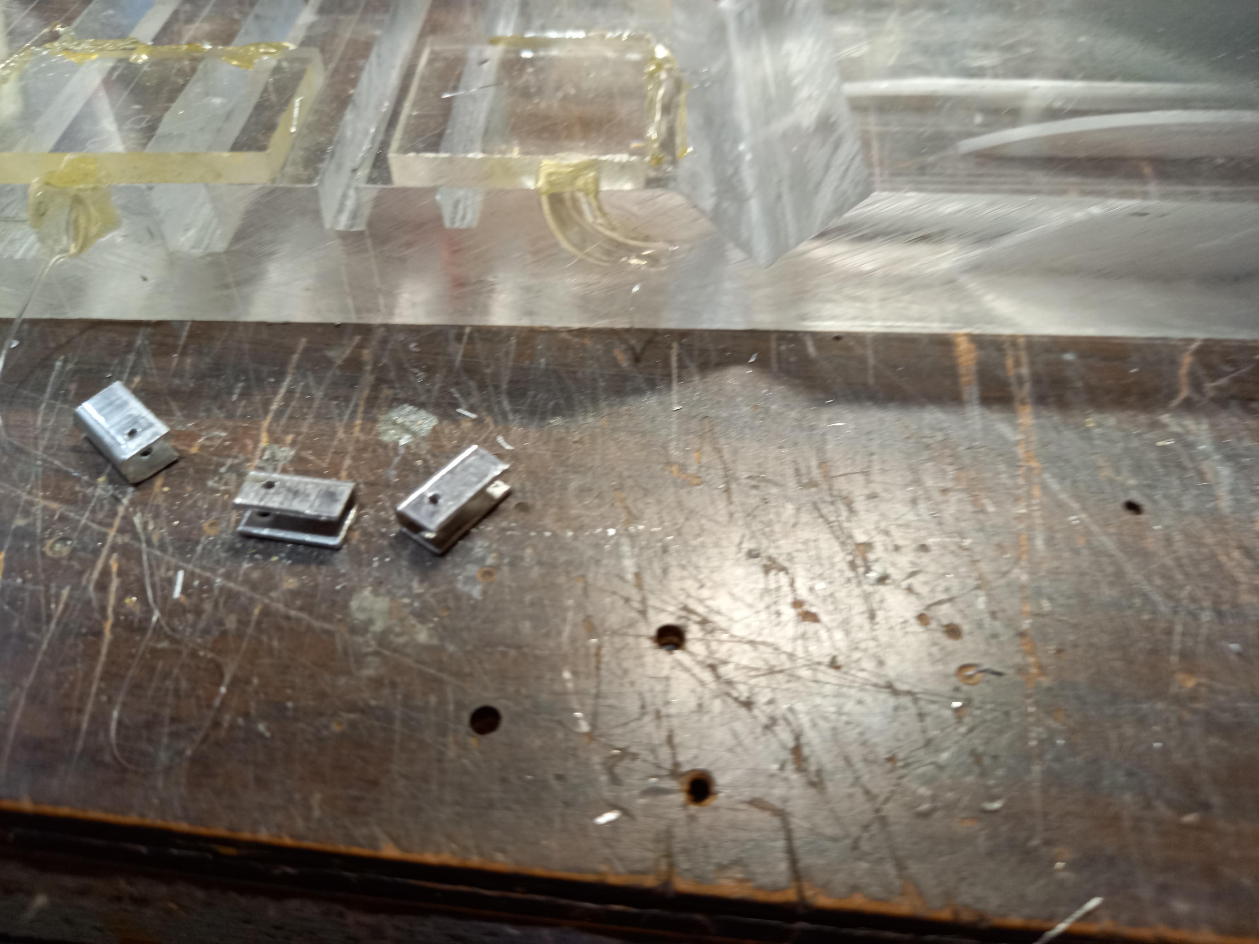

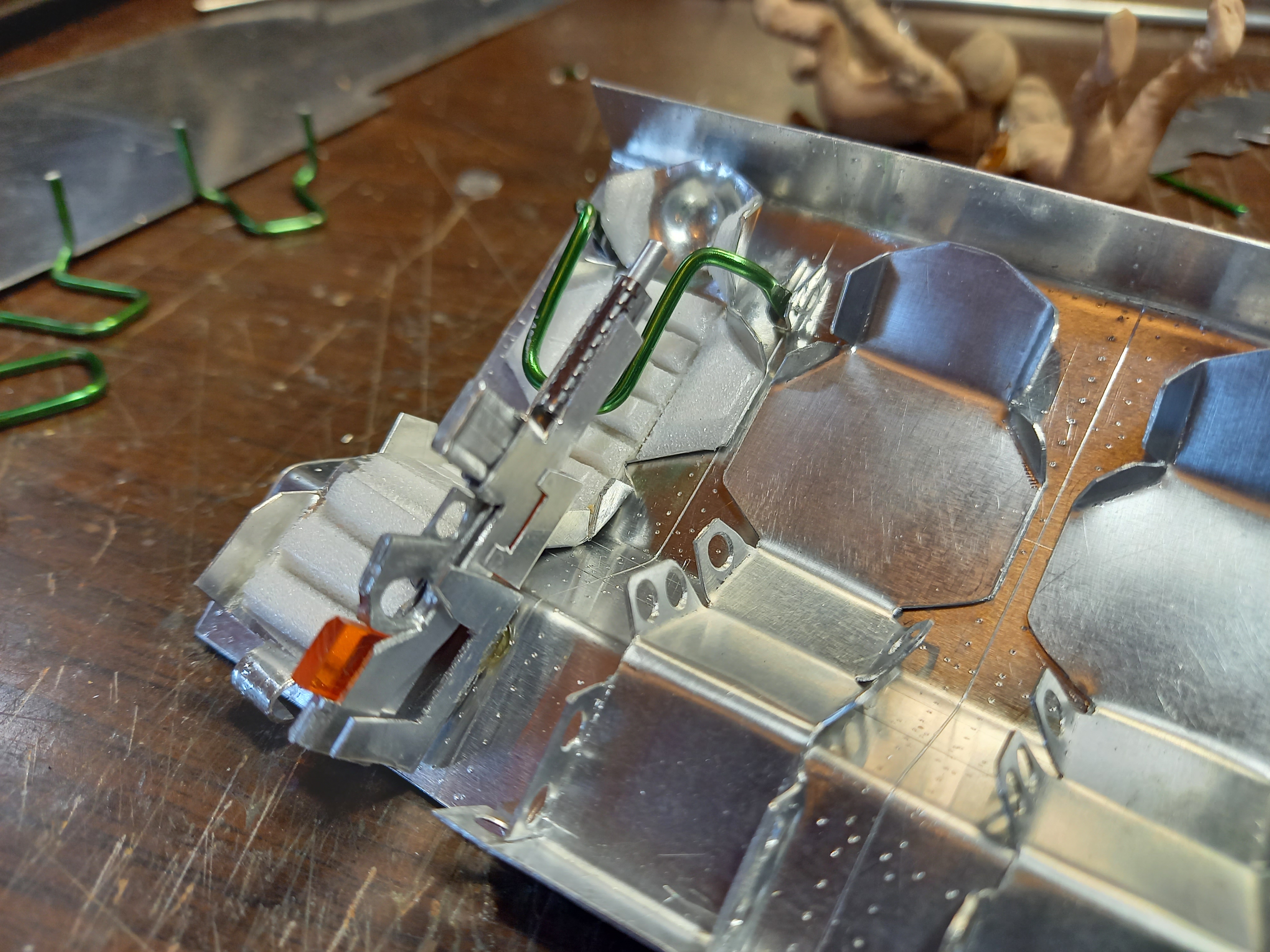

Making a bracket of the holdback bar.
I'm using 2 mm thick aluminum wire. I guess it's for the flower arrangement or something.

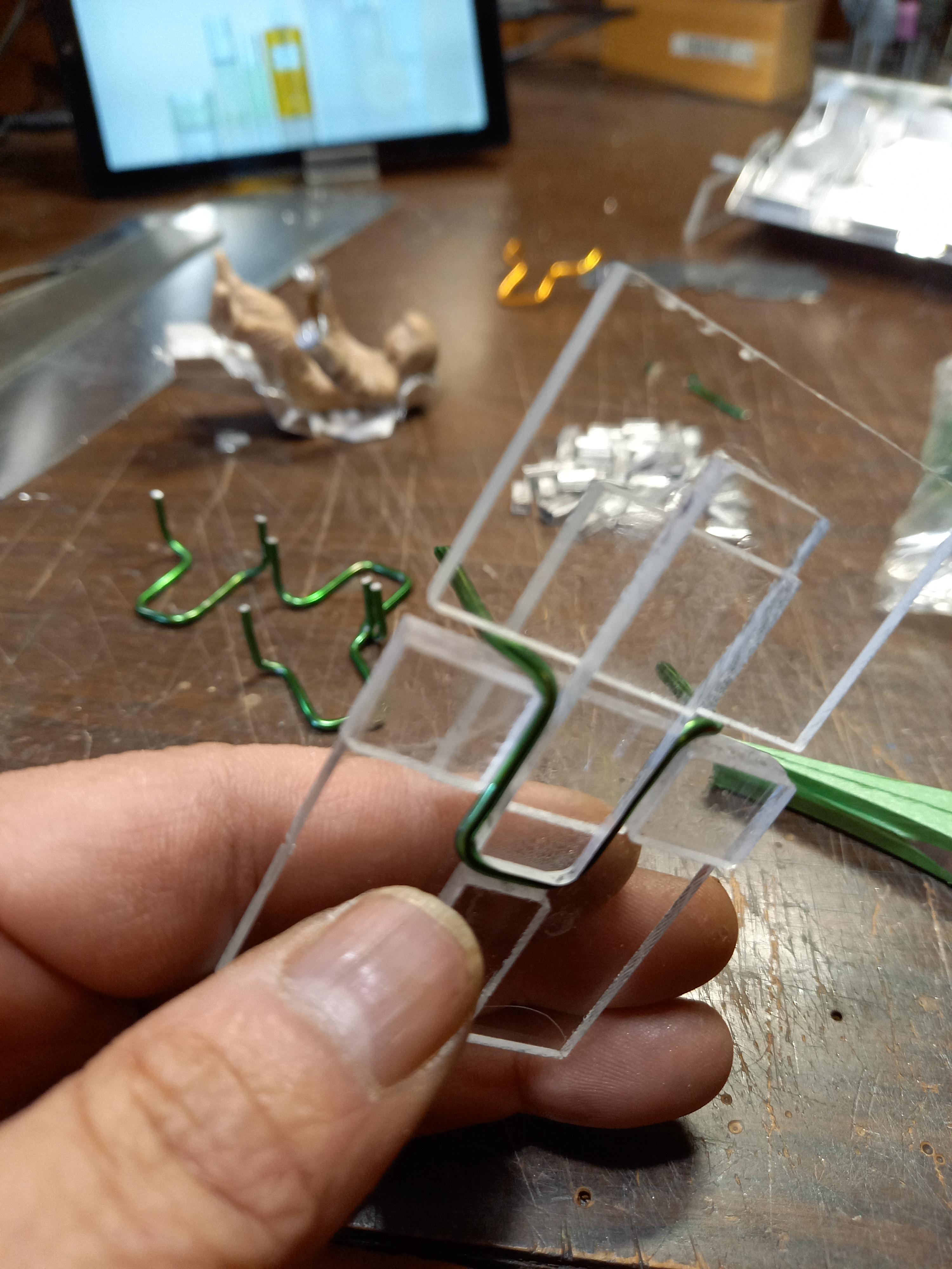

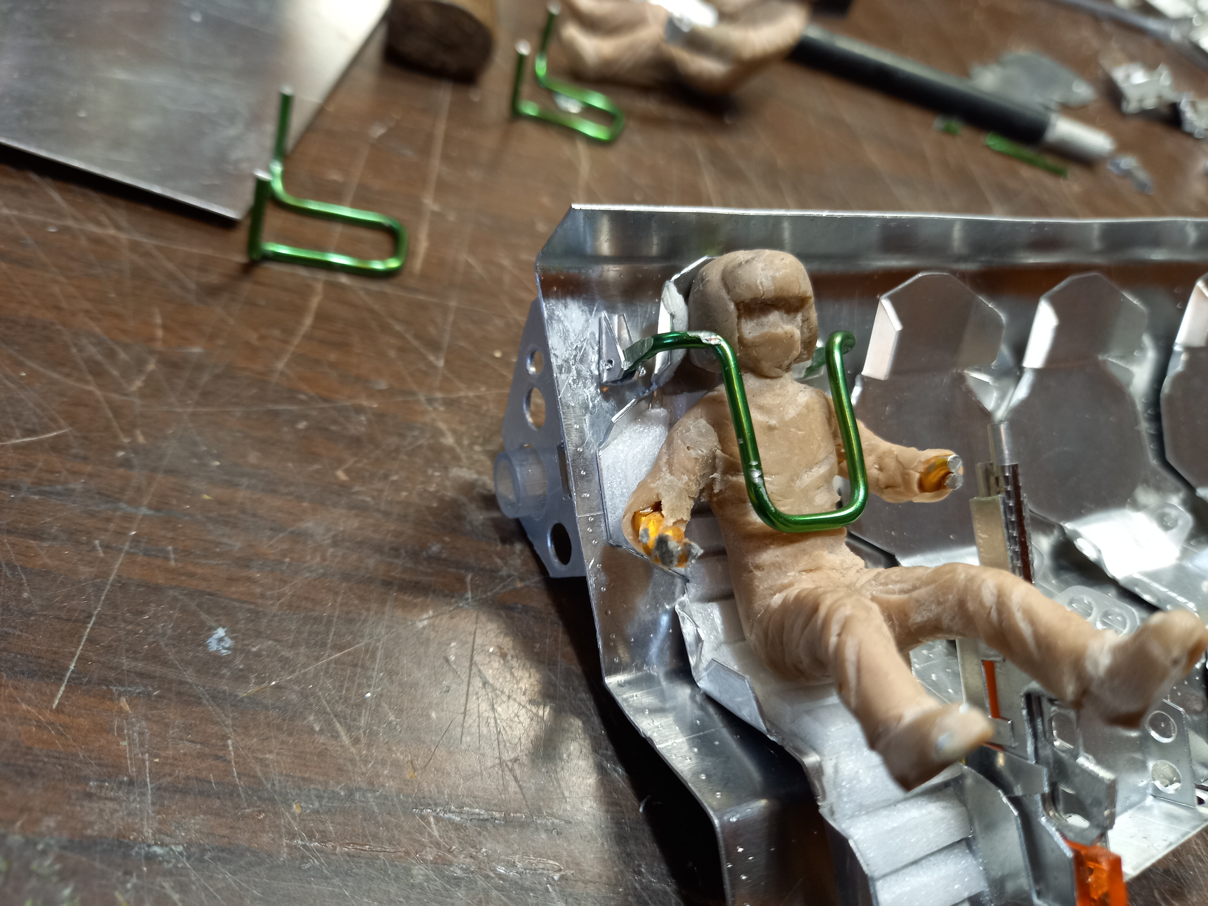

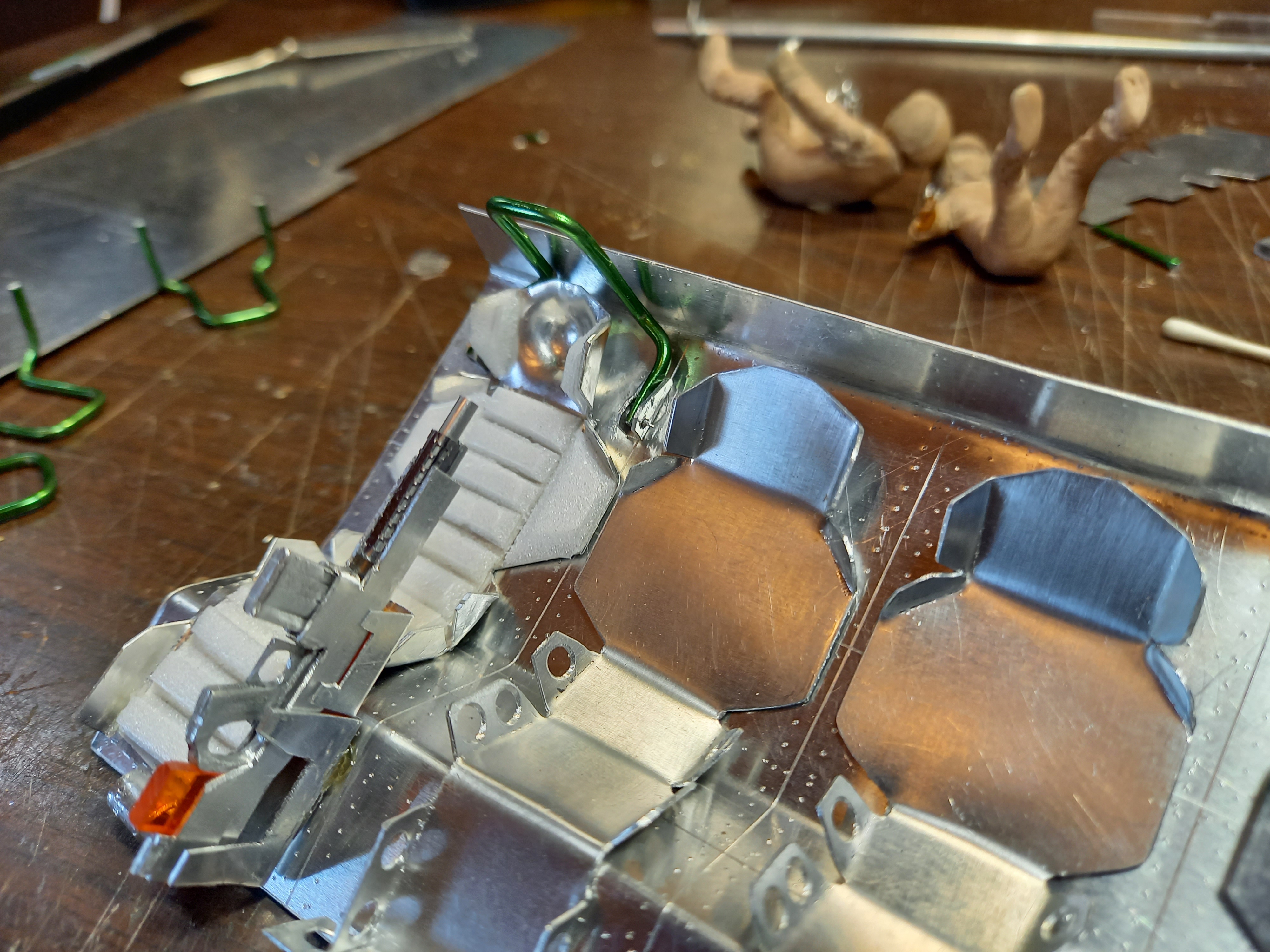

It goes here. The rifles will be held like that.
Here's a test fitting.
Release position.
Restraint position.
The figure is a bit too small for this but anyway...
Need a few adjustments but it seems OK to me.

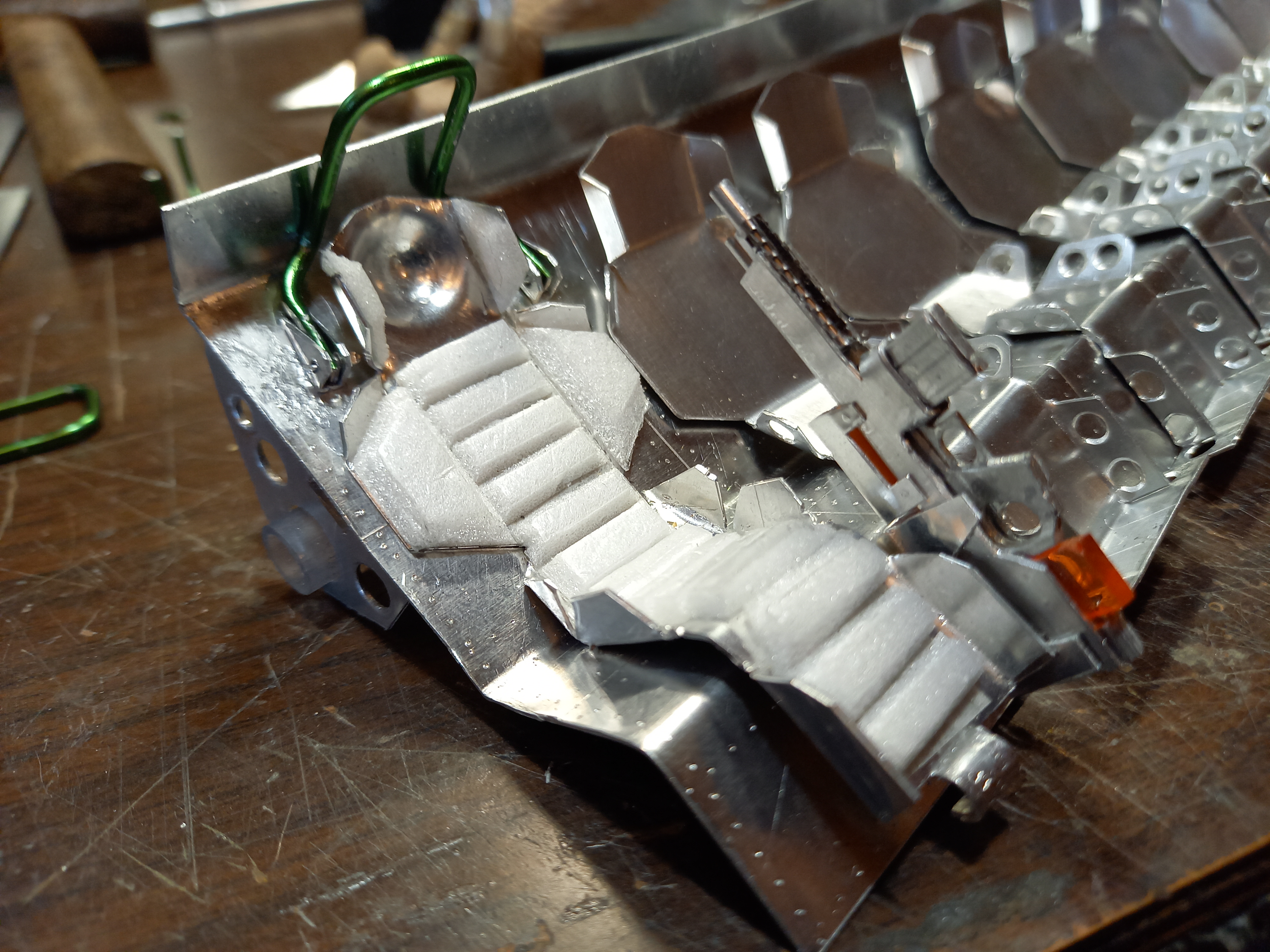

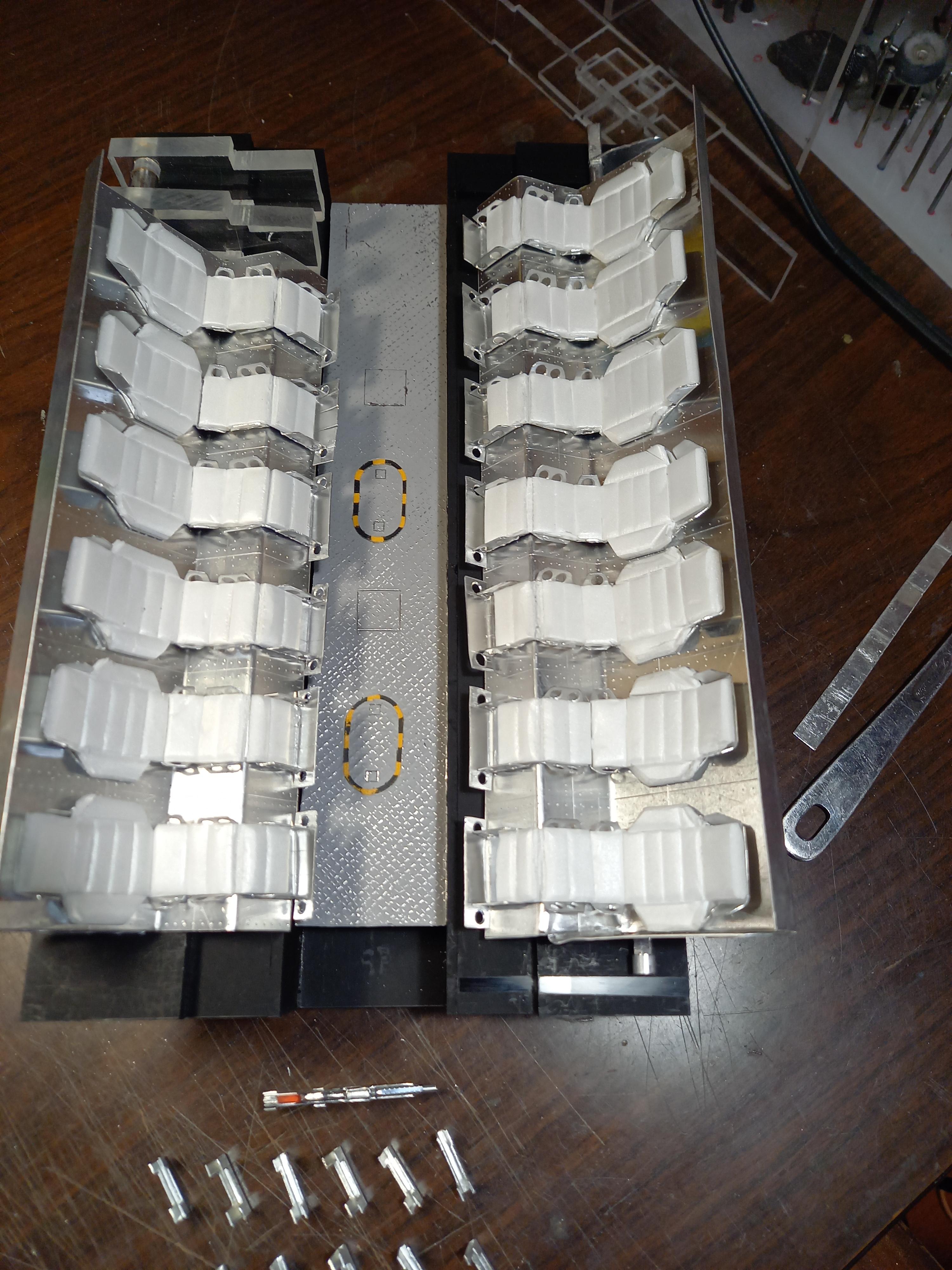

Continue to work on the interior. I've just finished the holdback bars and then started to make the seat cushion.

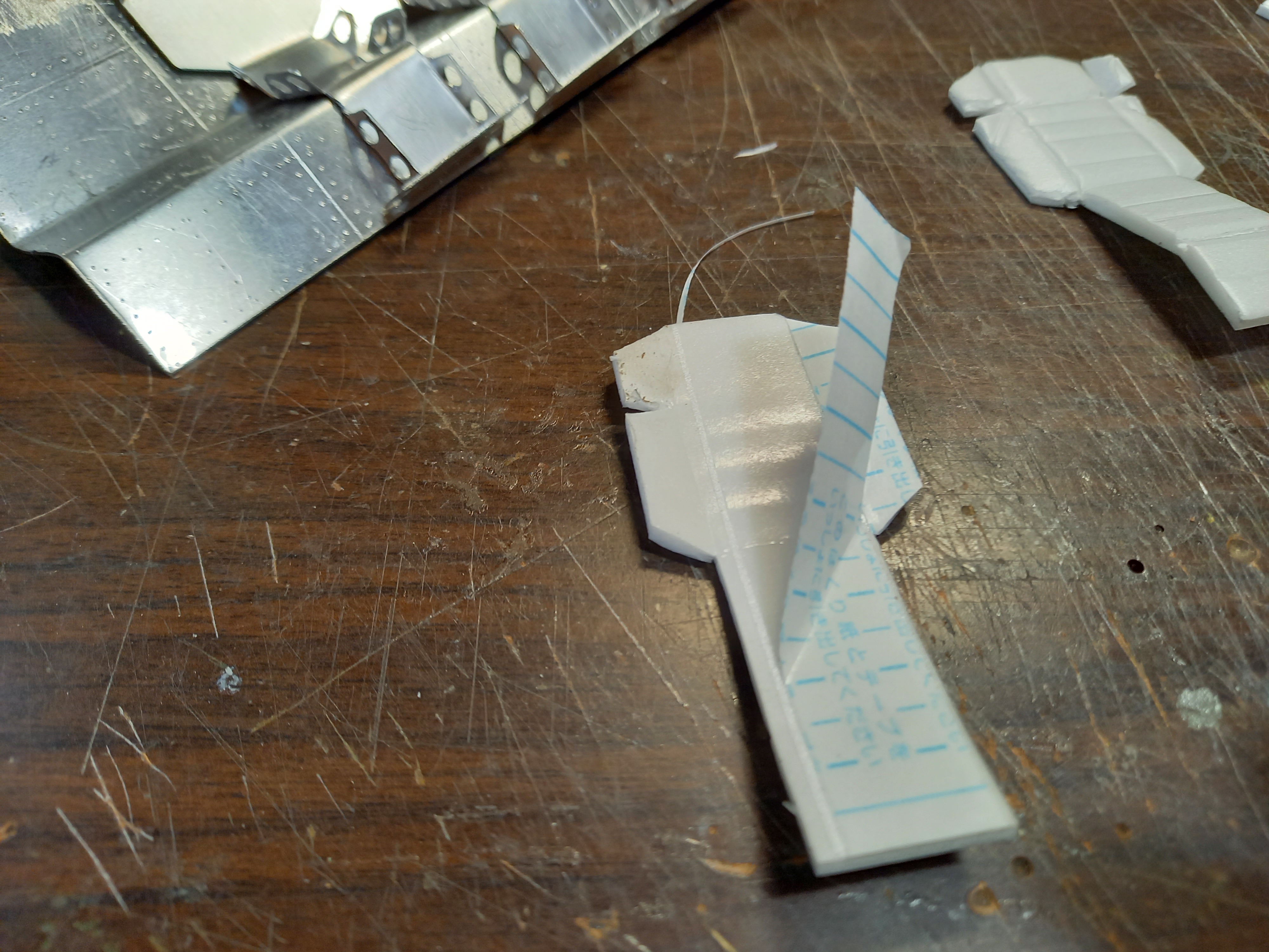

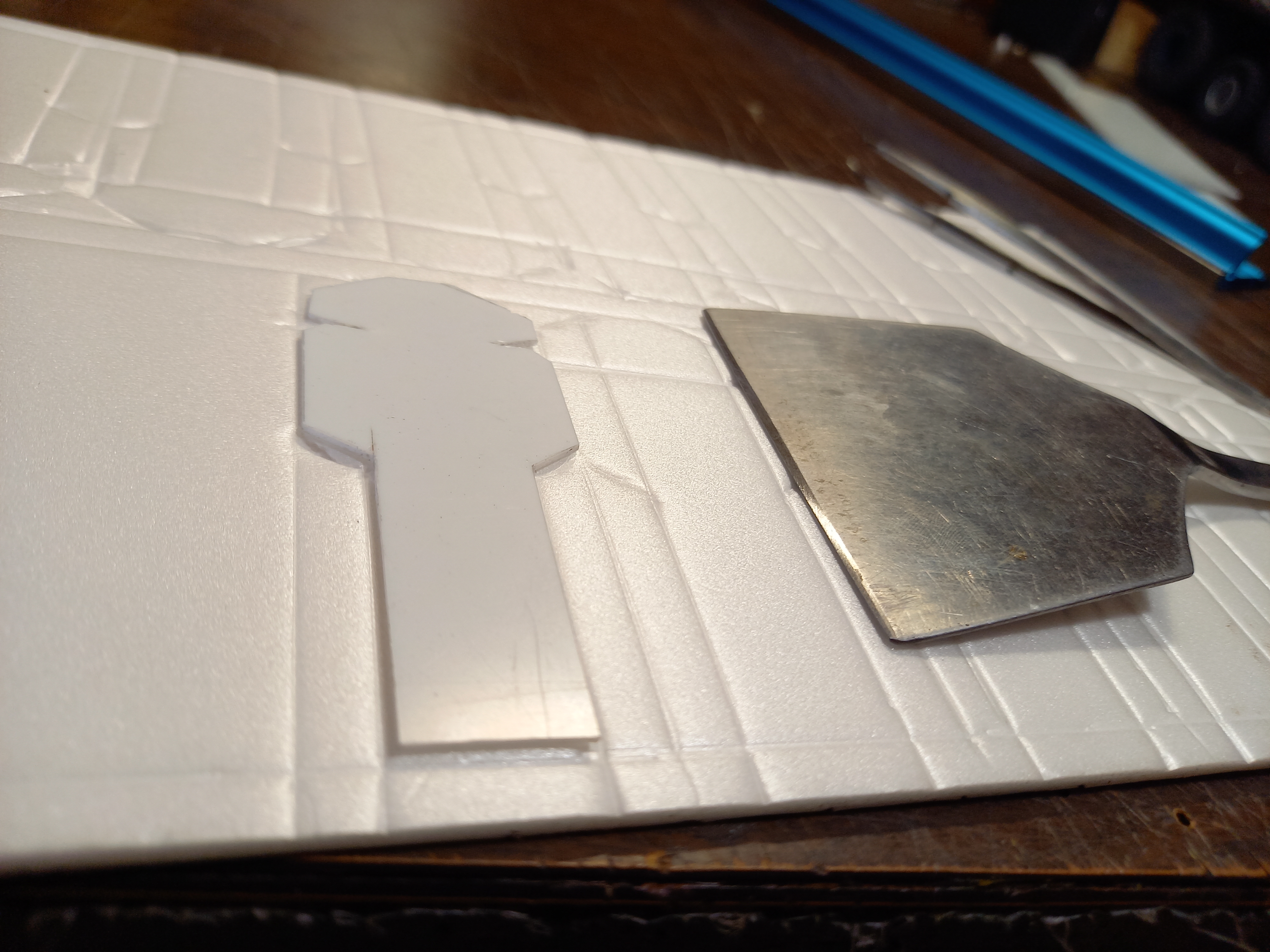

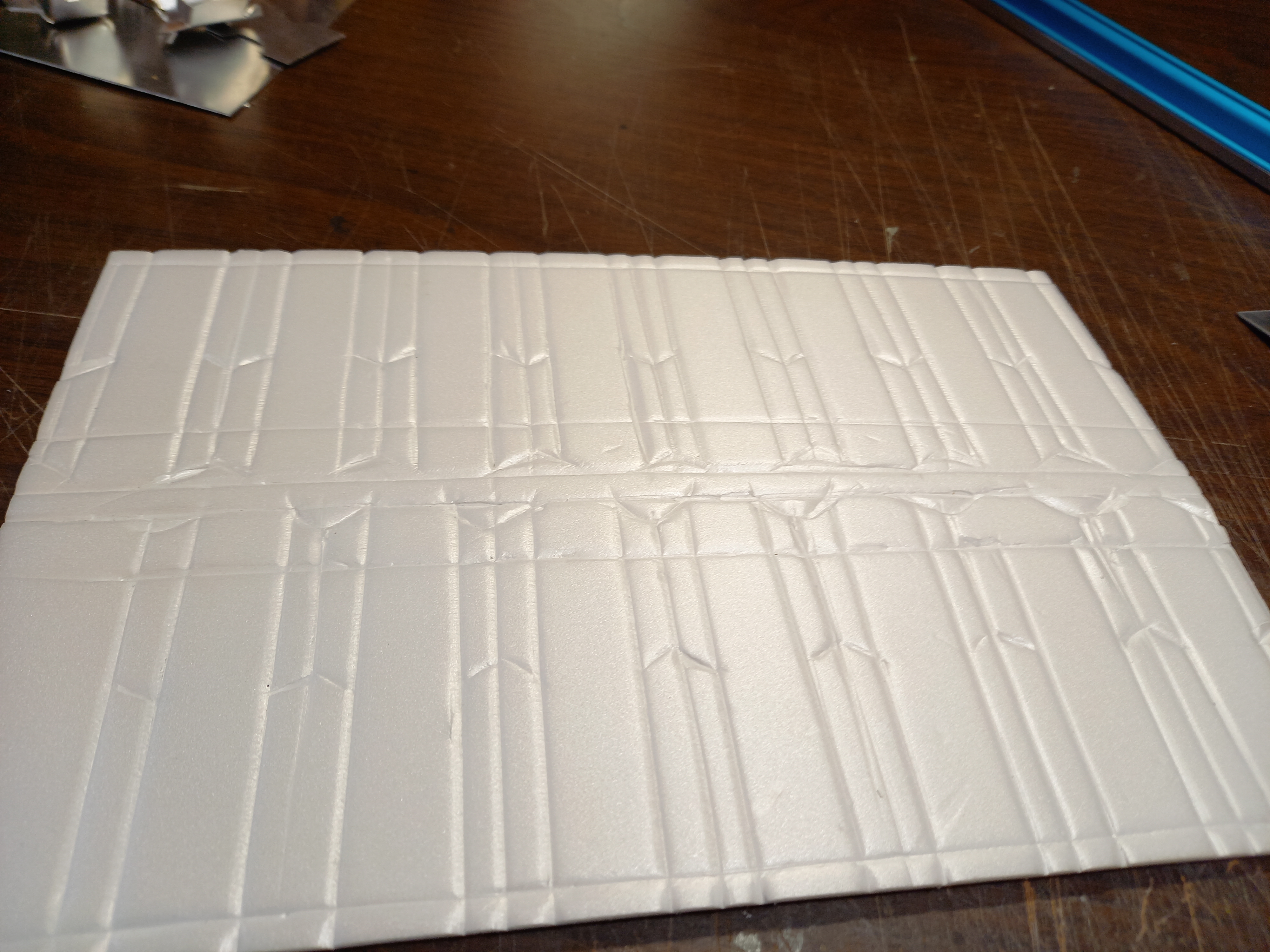

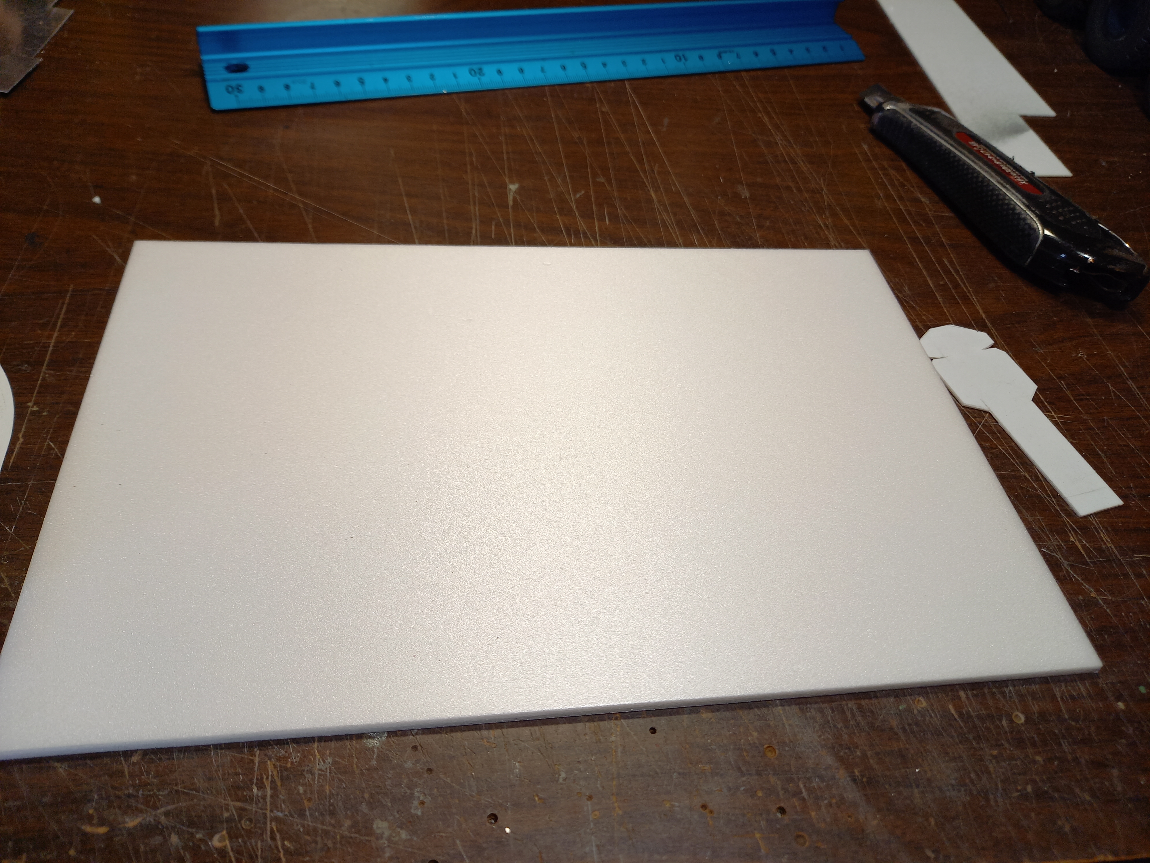

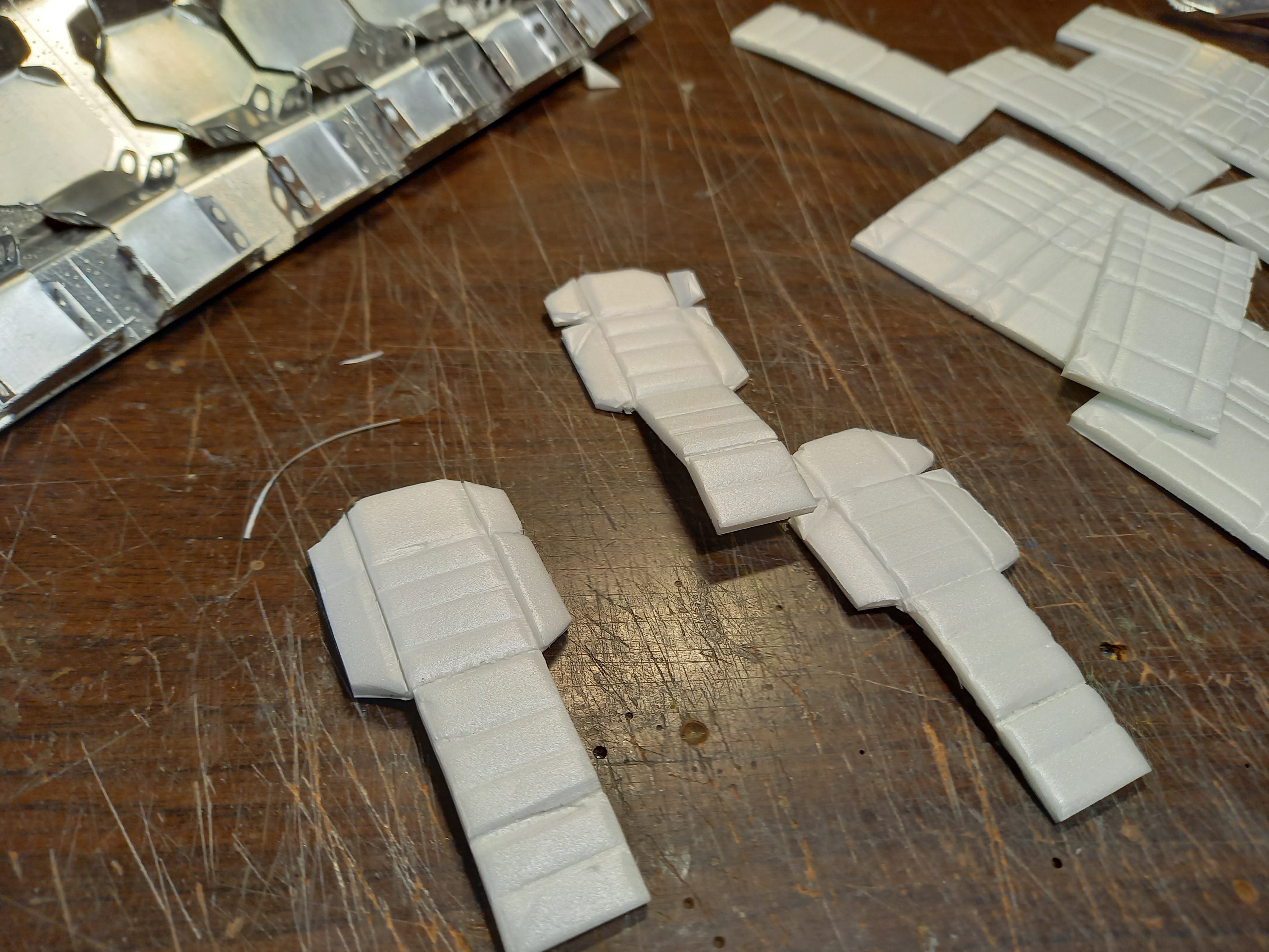

At the test build, I made ridges(?) by cutting a foam board with a knife. But I thought it takes too much time and looks not softly. So I tried this. At the test build, I used a food tray for that but this time I prepared a 3 mm thick foam board.
Foam board and a pattern.

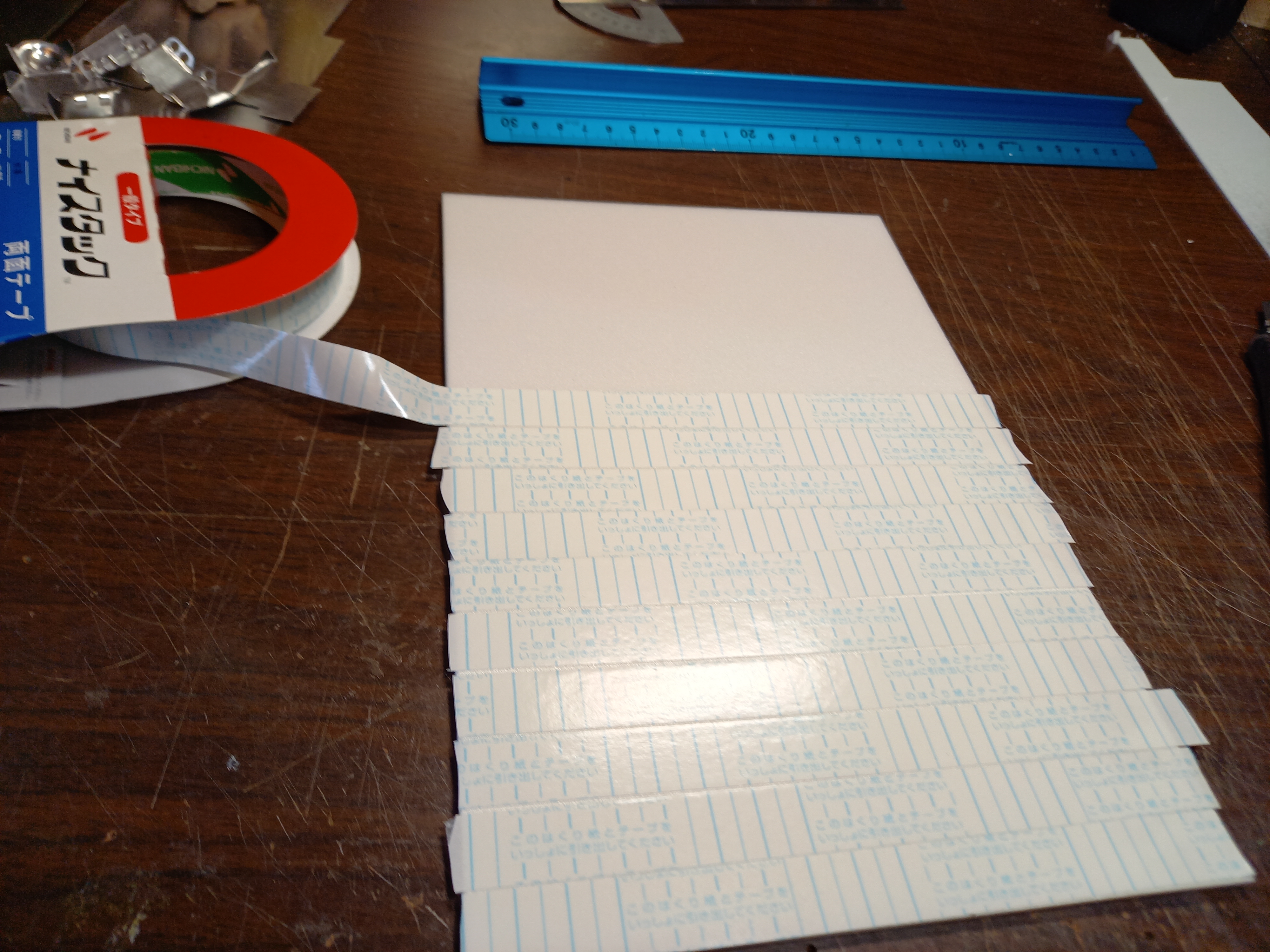

Stick a double-sided adhesive tape on the backside.

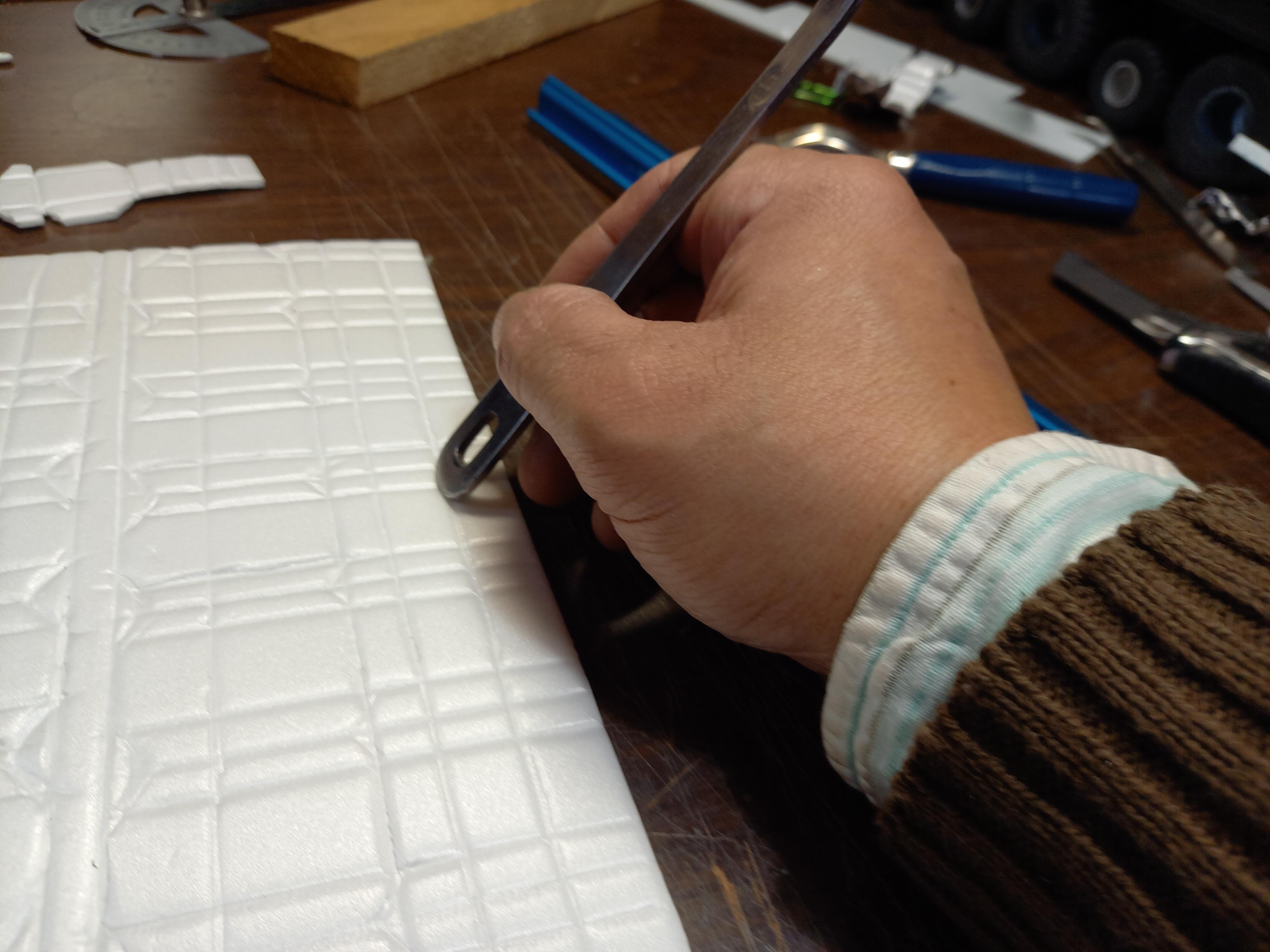

Using the pattern as a ruler, press along with the pattern with a dull edge blade or a spatula.
And then, gently scribe/press the lines with a more rounded thing again.

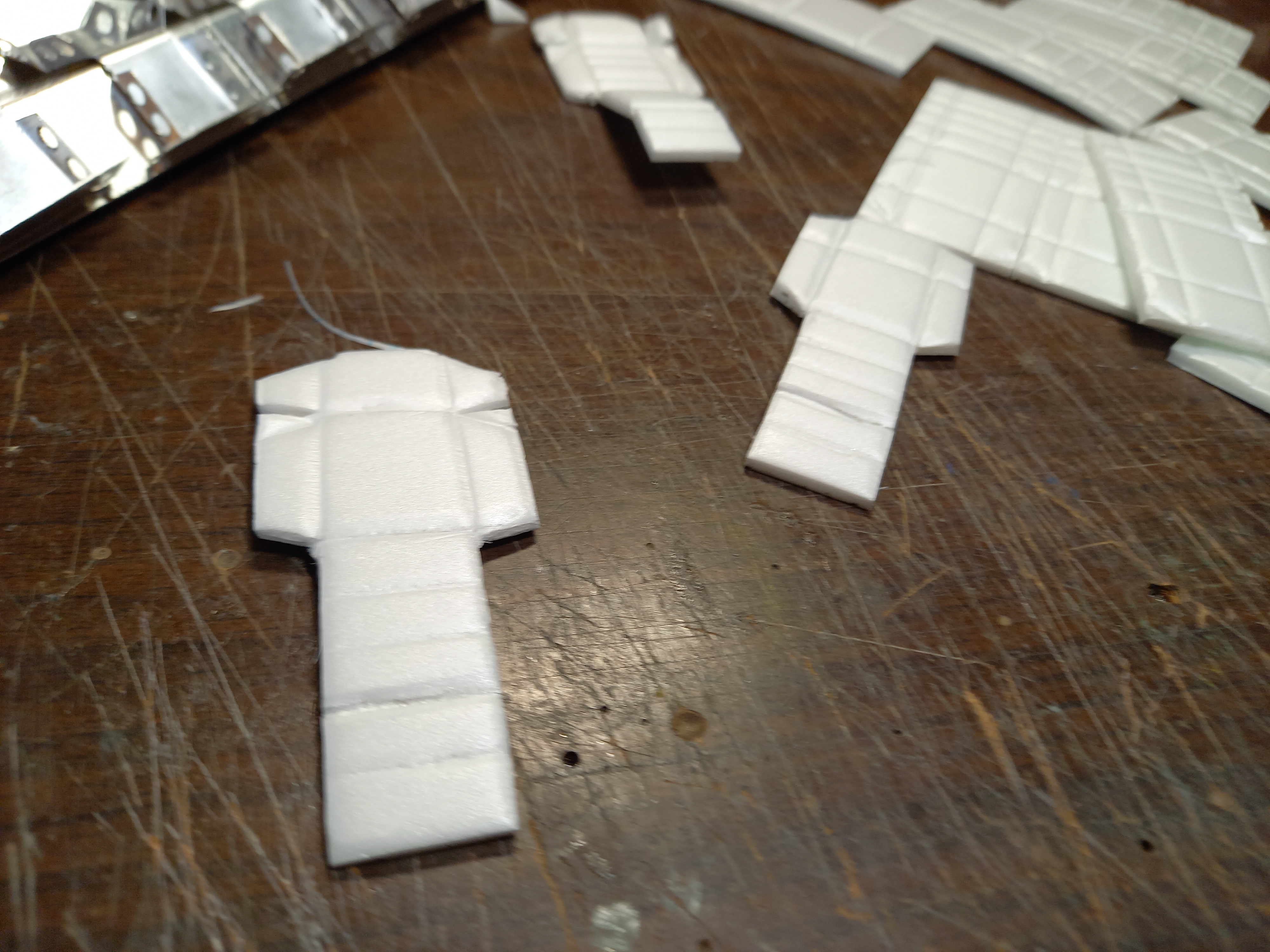

Cut up and trim them.
Peel off the backside.

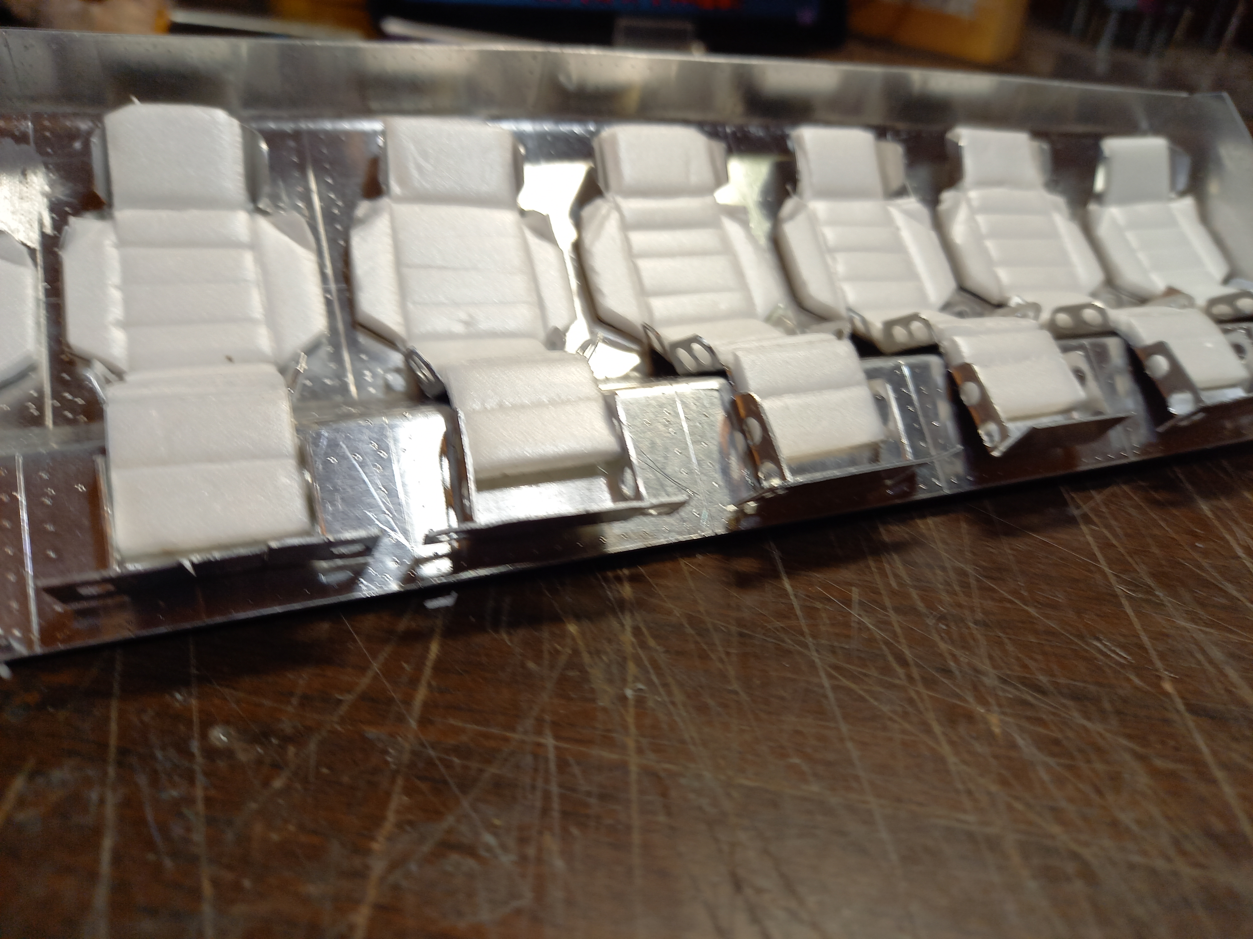

And apply on the seat.

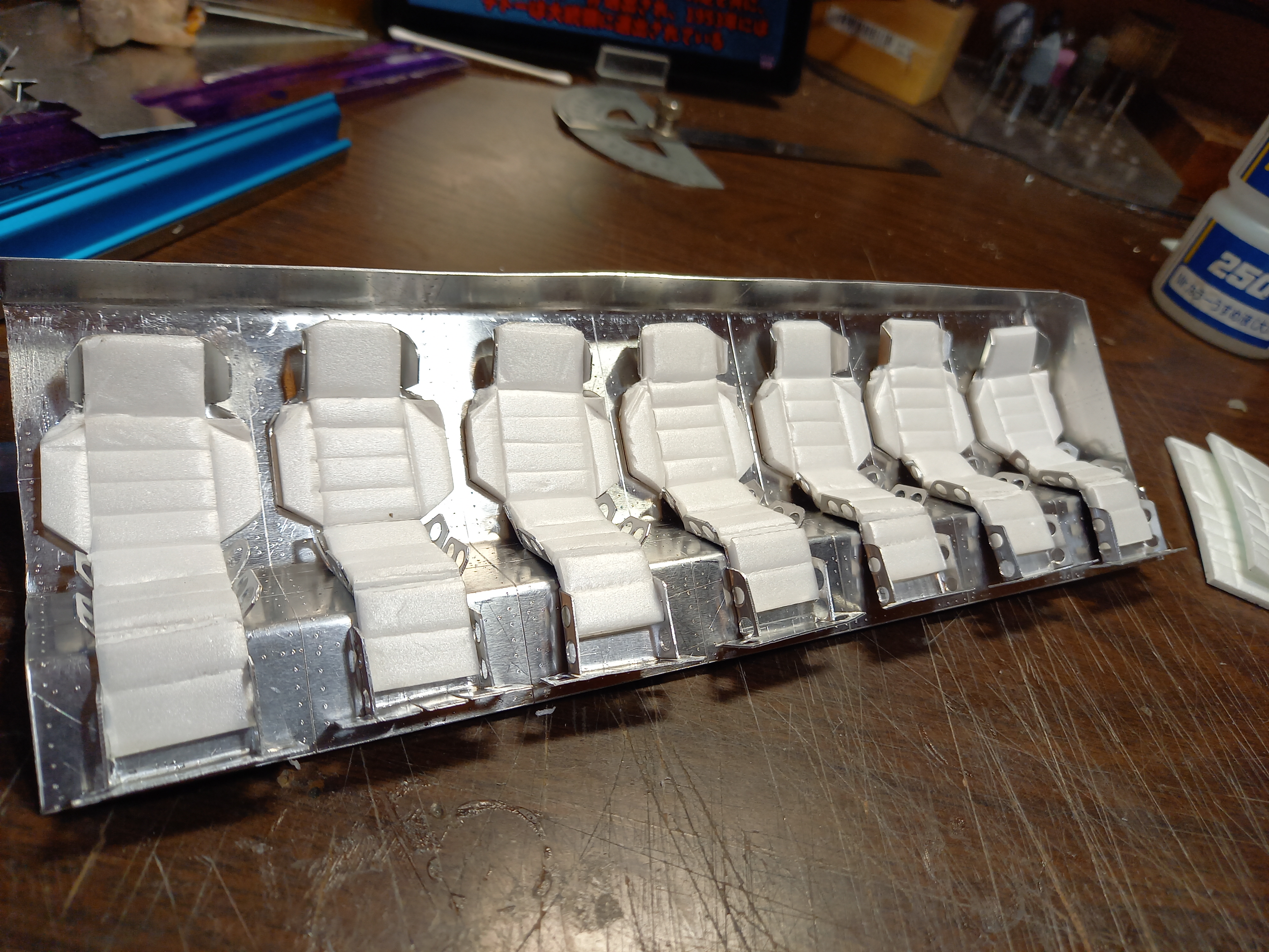

Look like soft, isn't it? :rolleyes:
I think it's a little bit better than the previous one.

It's fascinating to watch the process of making that stuff and the end results are perfect
Nicely upholstered seats! If the goal was a softer look I'd say mission accomplished.

That is a great idea! Looks soft to me, but not too soft.
That's a pleasant comment, Stevie-san. Yes, this is a combat vehicle, not a limo.(y)

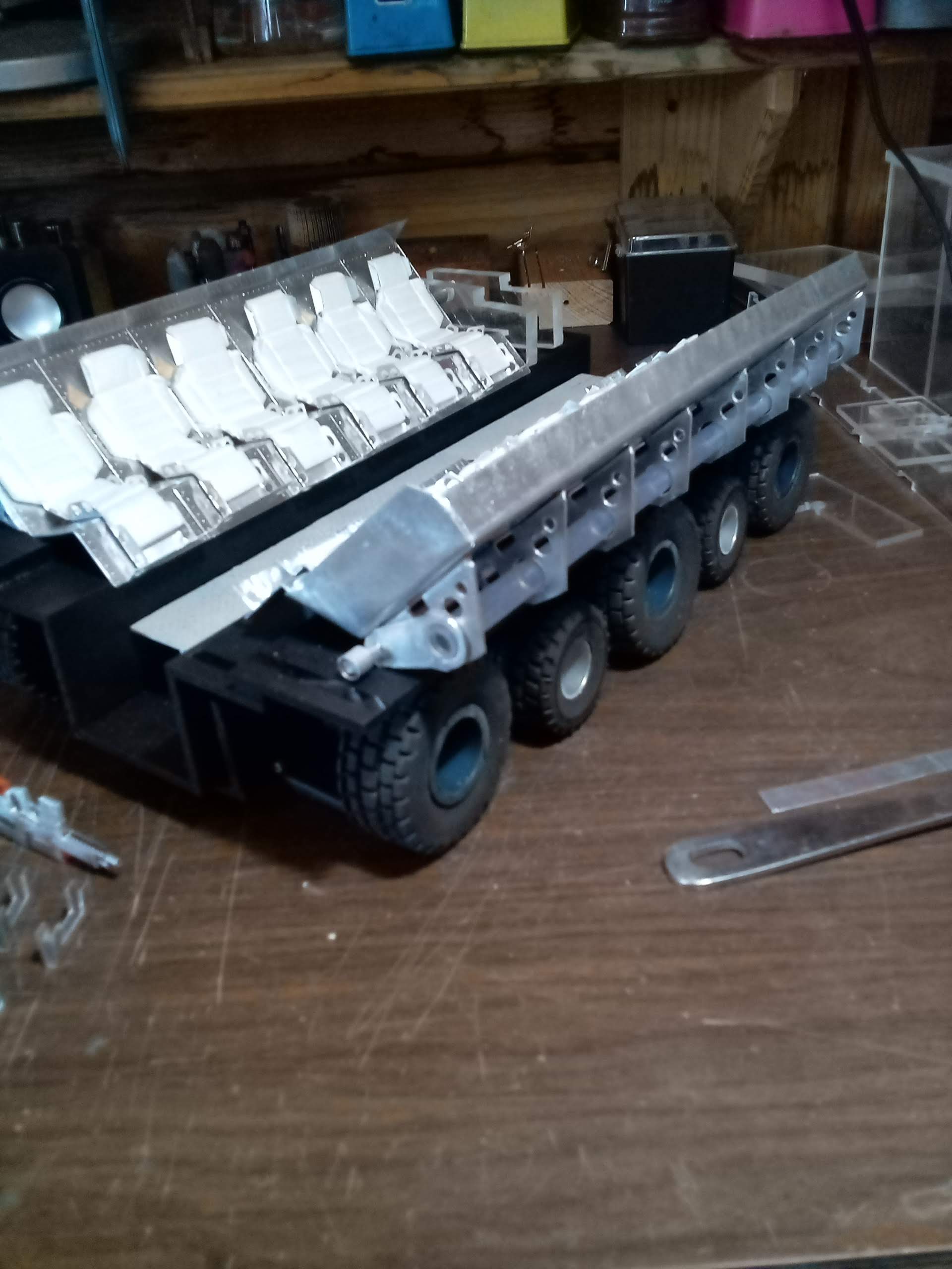

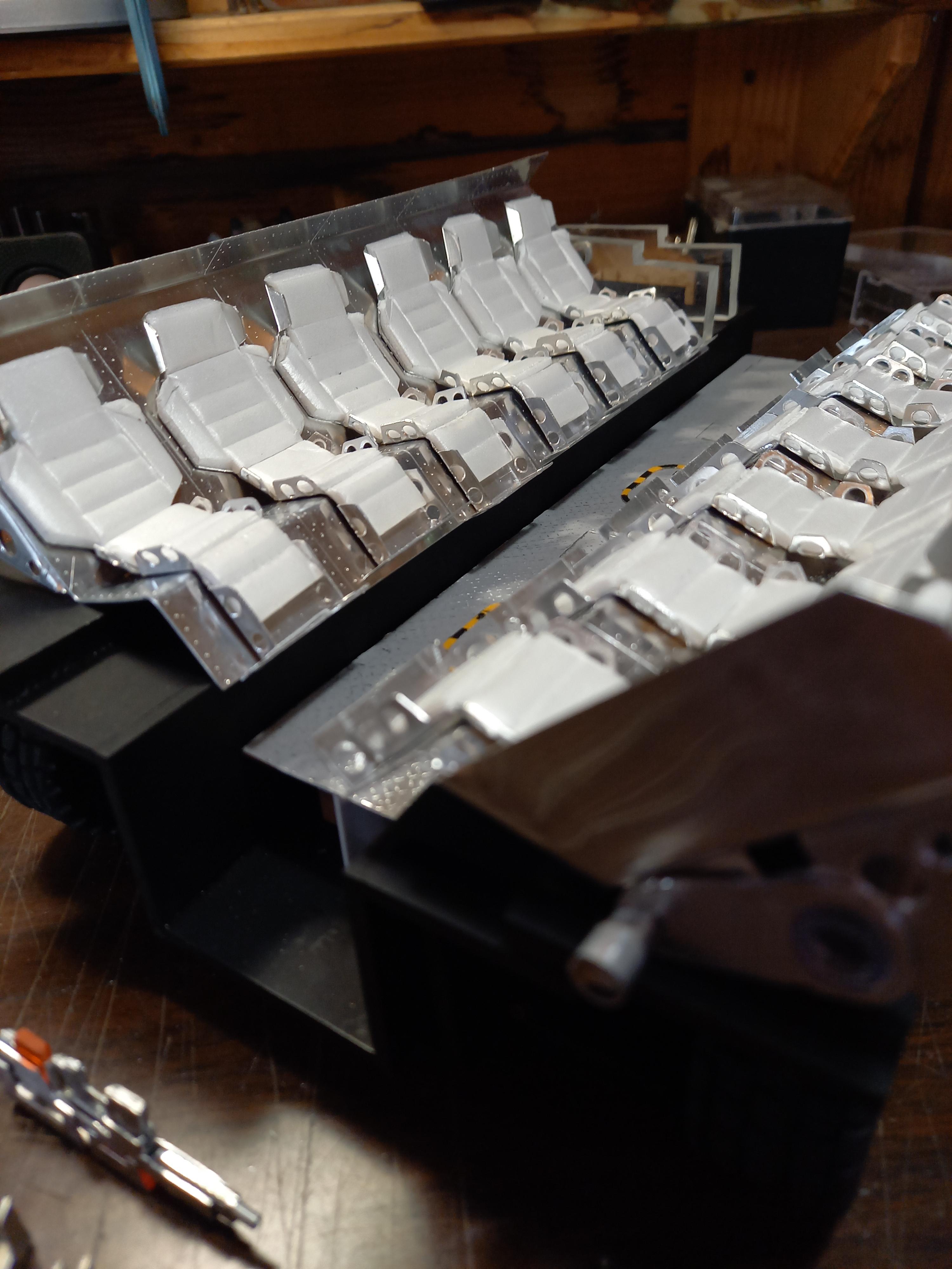

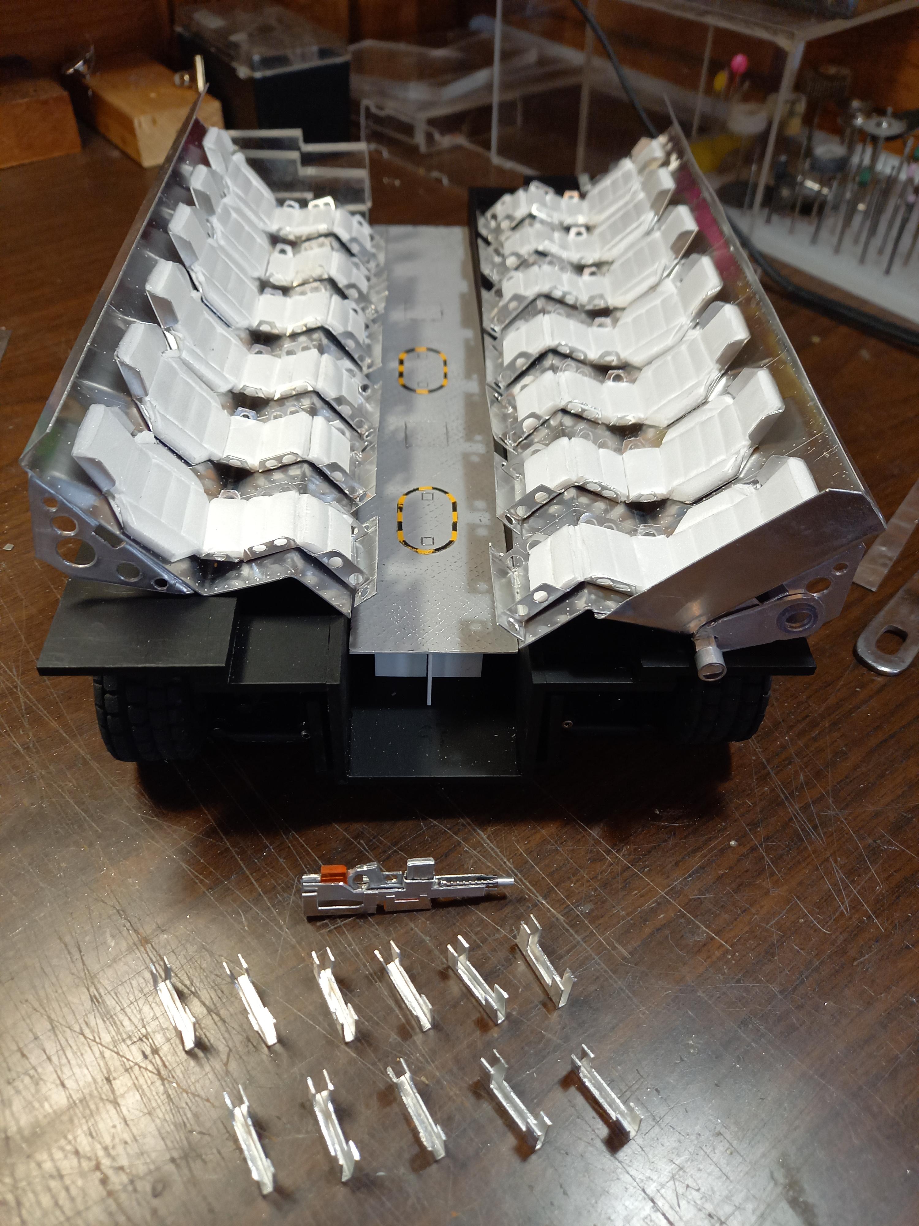

All the soldier's seats and the gun racks were done.
Now I'm thinking about the commanding officer's seat right behind the driver's seat.
Before I go for the driver's compartment(Nose section) I am going to do the paint job for the soldier's compartment.
Still, there's a long way ahead but your kind support is appreciated.

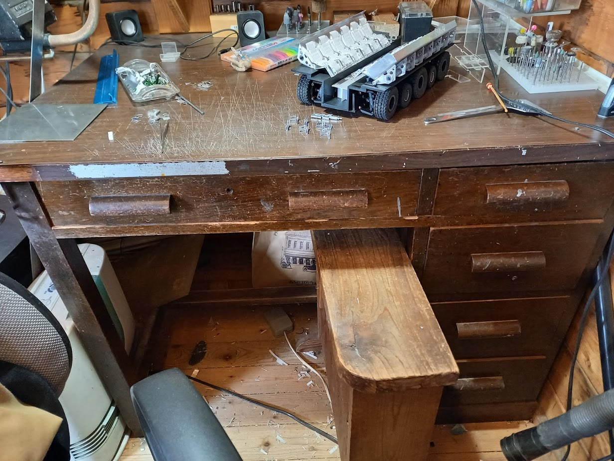

PS: The work desk is maybe more than 90 years old. My mother's high school female classmate's husband was a graduate of the Naval Academy of Japanese Imperial Navy. He used this desk when he studied for the entrance examination at his age of 13 to 16. He gave it to me more than ten years ago. Today was happened to be his third death anniversary. Rest in peace, Mr. Taketsugu.
