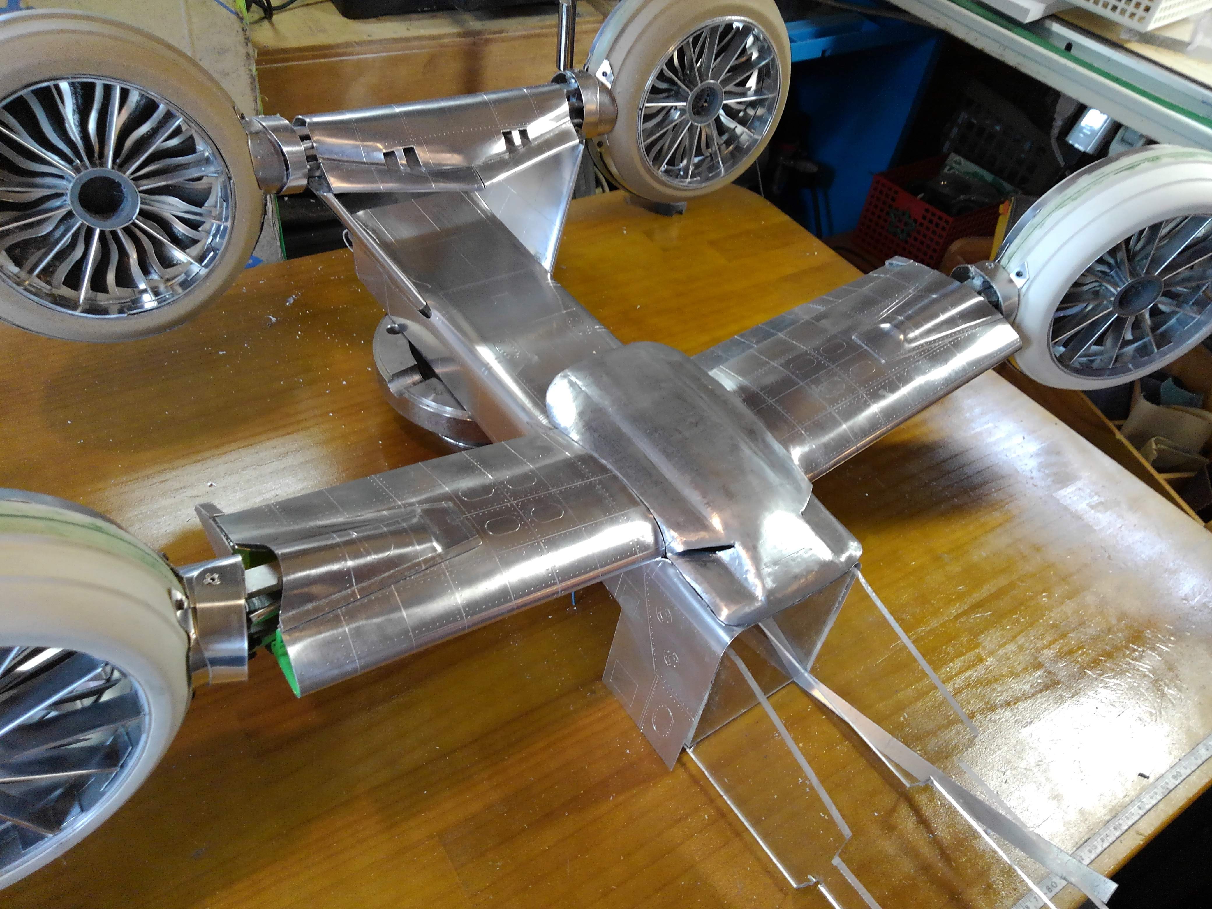

I heated up the 0.8 mm aluminum sheet up to about 230 c deg with a hand torch and cooled it down slowly.
How could I know it's 230 c deg? It's a secret. Na... Just draw some line with a magic marker pencil. When it's erased, It's 230 c deg.
That is clever!
I love how the body shell turned out. That was sure a lot of hammering and sanding.
I once did a box made of bronze where I hammered in some faces and that was a real pain. Instead of using a wood backing I remeber using some kind of soft "resin" type of form
and this is also a very wise tip... :lol:

Beautiful metal work, as always! Looking really great, Katsu-san... looking forward to seeing her done.

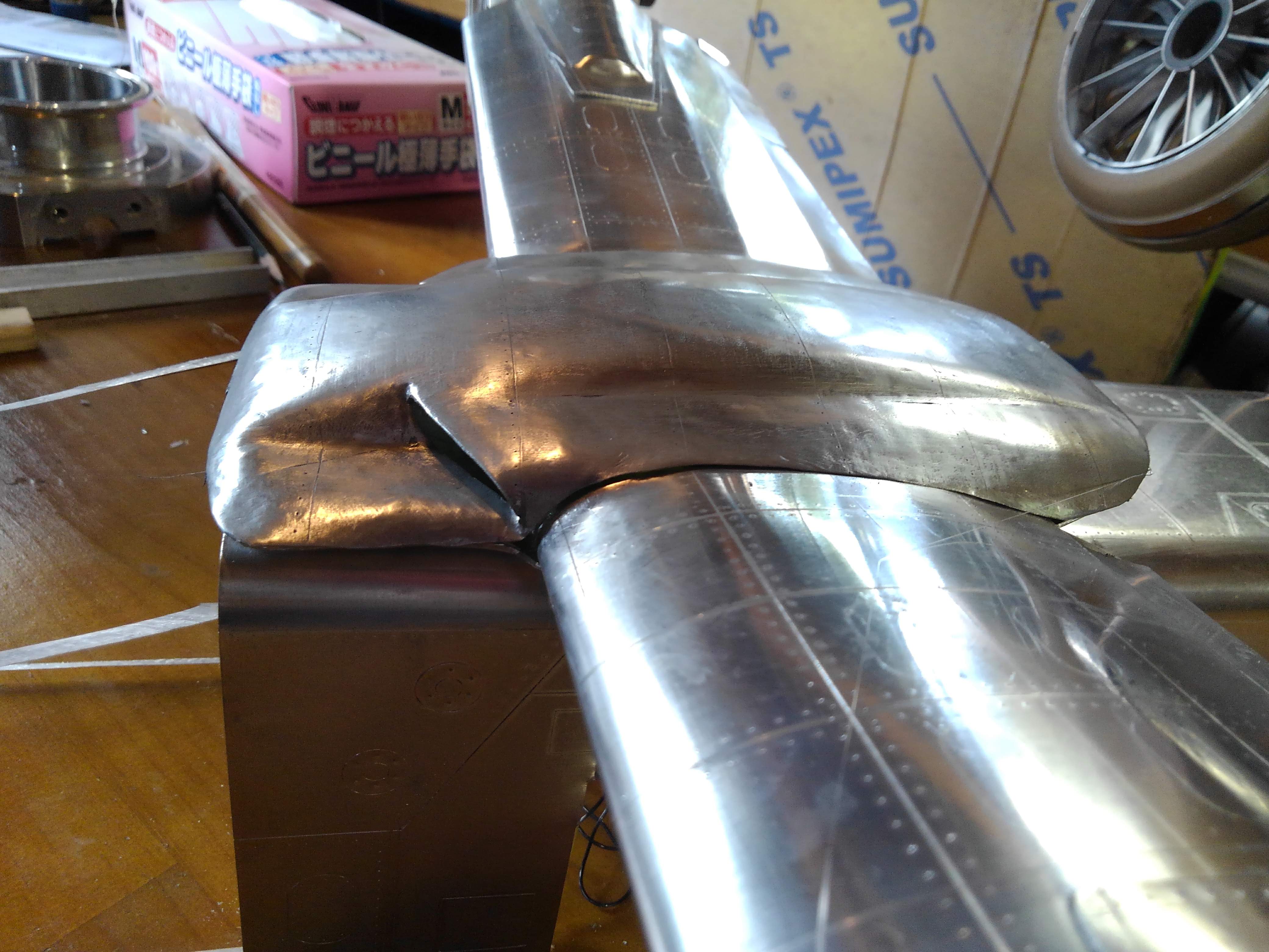

In fact, as I'm looking at the large pics, I just realized that still there are many scars and dimples all over. It may need another sanding polishing and glazing putty. Oh I need a younger eyeball.
I once did a box made of bronze where I hammered in some faces and that was a real pain. Instead of using a wood backing I remember using some kind of soft "resin" type of form
Bronze is harder than aluminum, so I guess it may need a hard backing or anvil.
Primer and paint might even out the look.
On the other hand, the fuselage looks like it's seen some action. If the wings and engines were similarly finished, it could give the craft a tougher appearance.

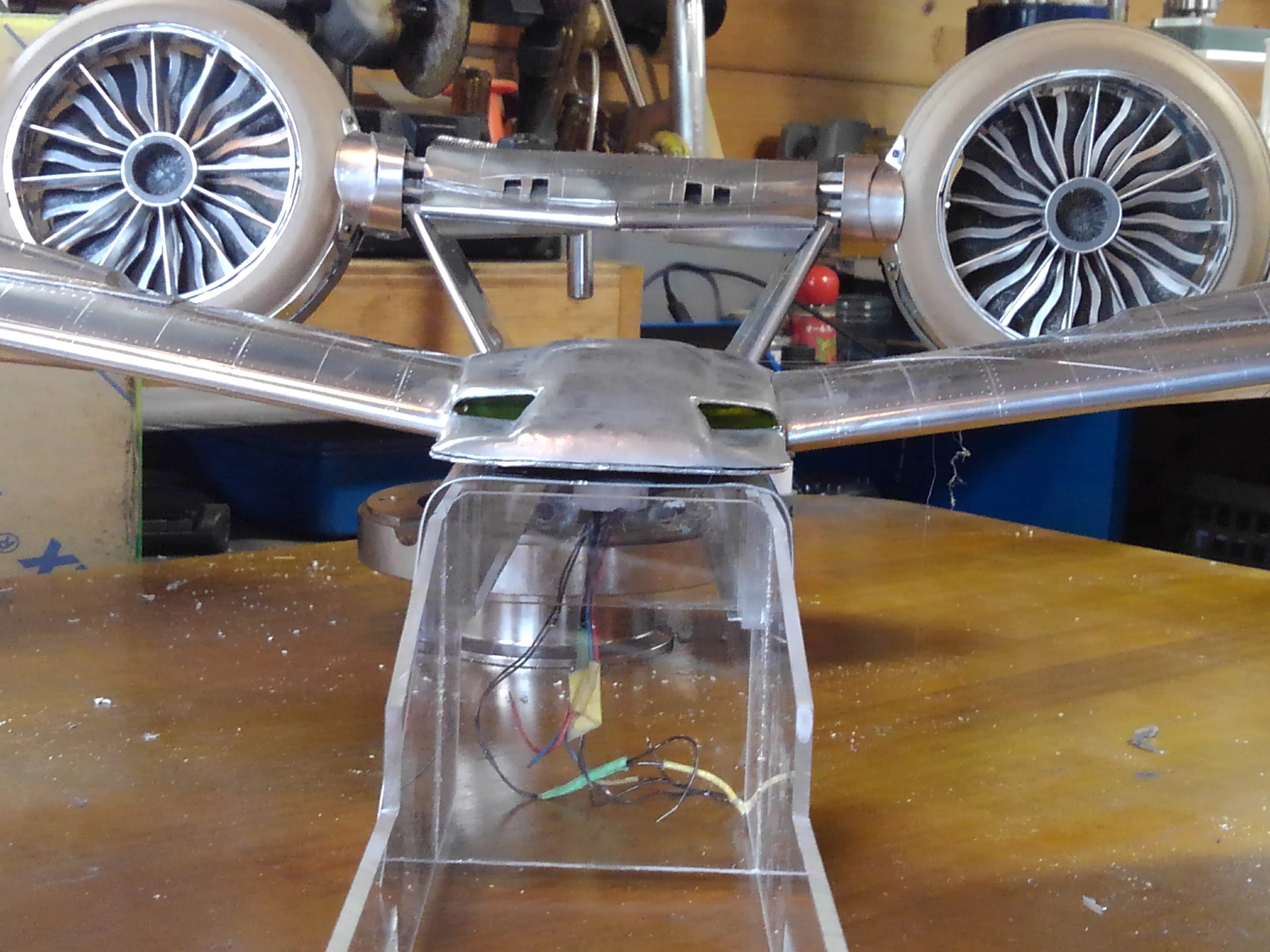

Made a bottom plate and sanded and polished a bit more again and fitted on top the wing.
I wanna take some nap again this afternoon.
Thanks for looking.
The next part is build a canopy. So far, I'm thinking the vacuum forming with a wooden plug and acrylic transparent sheet.
I'm now making a plug.

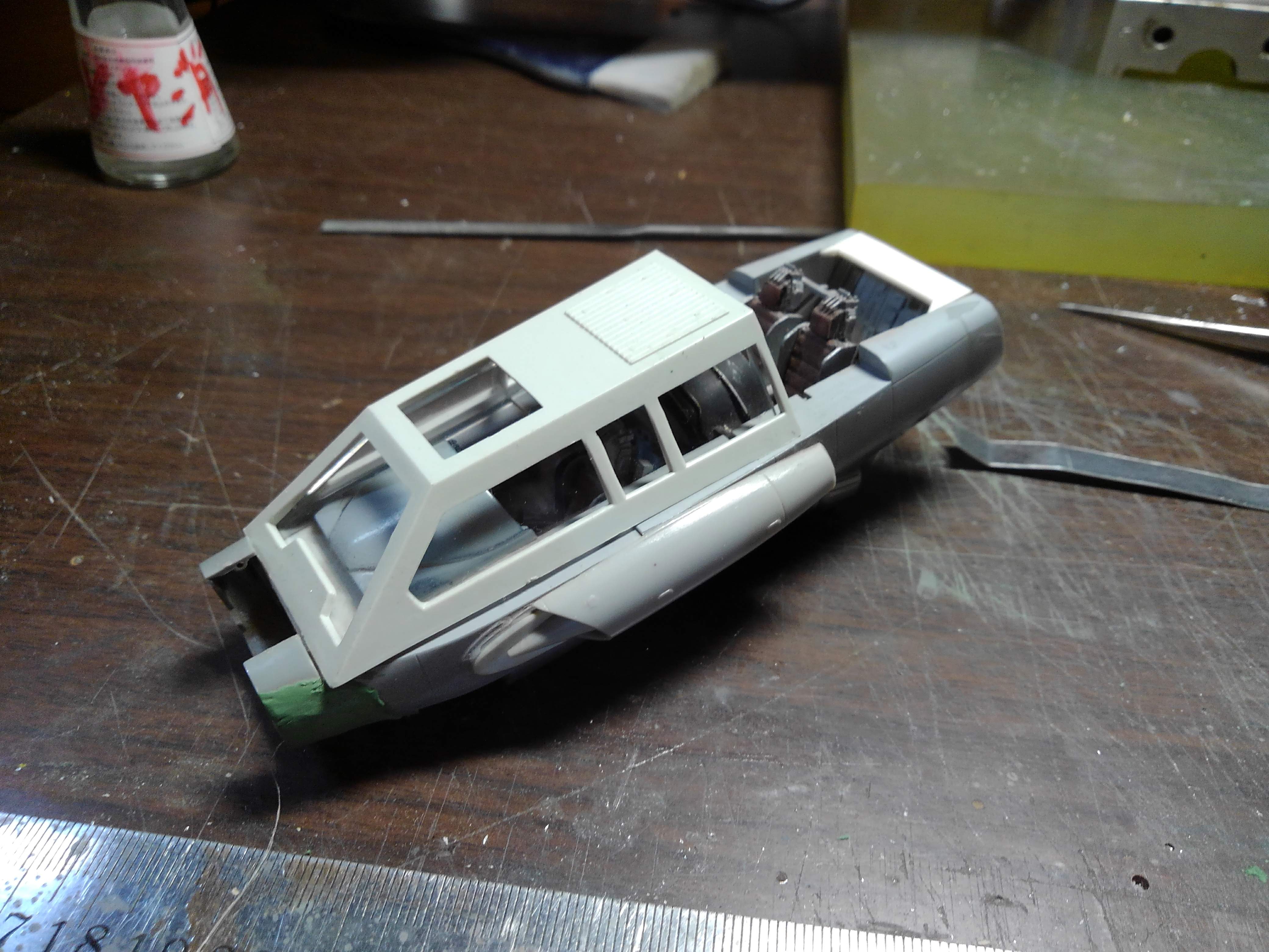

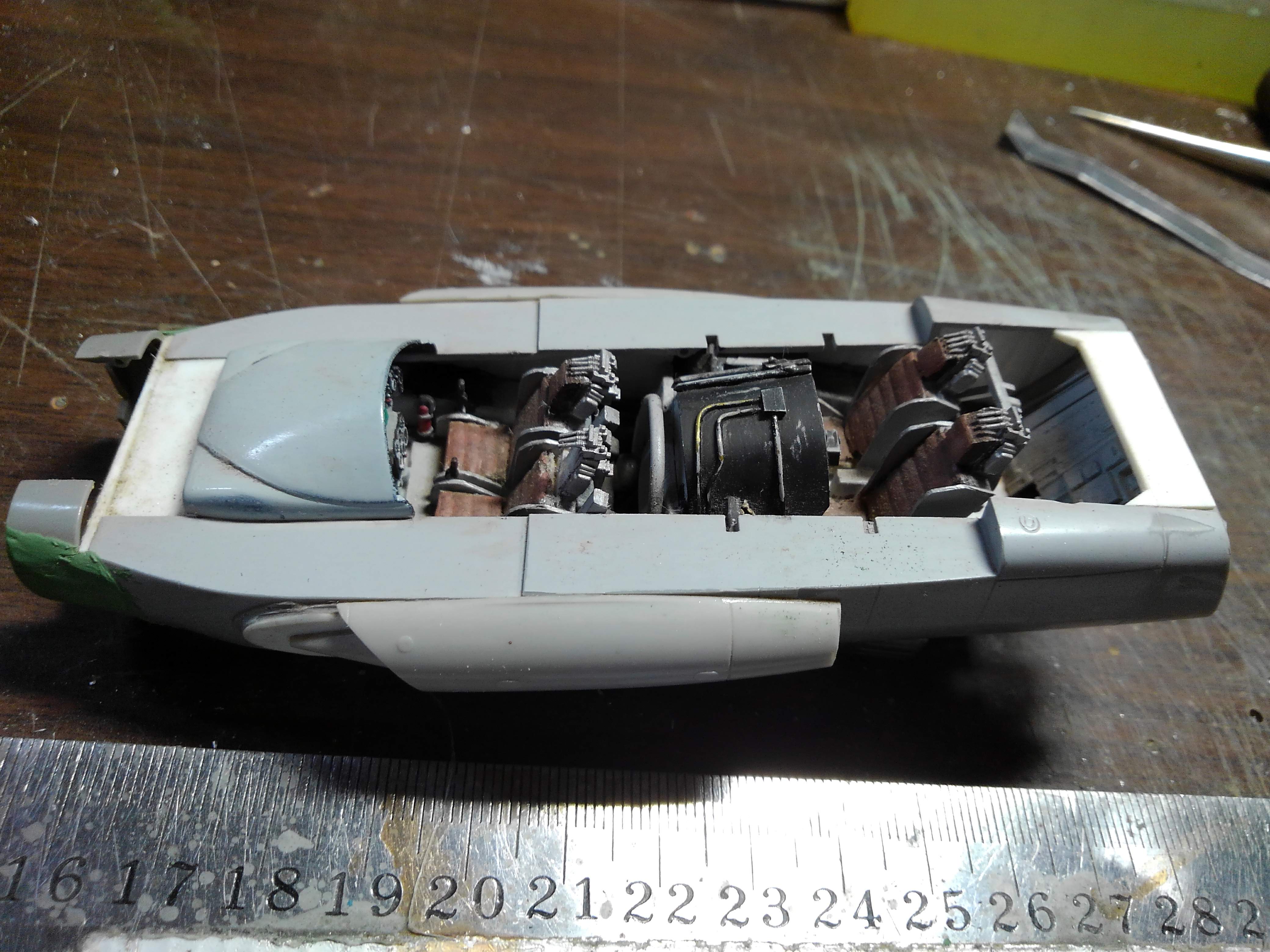

By the way I just found a little model I made a half and forgot.
It's the small craft which was supposed to be in a hanger of the planet explorer I build before.
I guess I snatched the canopy parts from the kit parts of Snow Speeder. Those faceted style may not fit this time.
Oh, that totally needs to be finished and added to your Explorer display.
Thanks, Tom-san. After I finished present project, I think I'm going to touch up and repair all the model I've built before.
Then I'll try to finish this small craft.
It's really taking shape now!
I think a more rounded canopy would look good
Thanks- Analyzer-san.
I think something like the one of AH-1 Super Cobra would fit.
