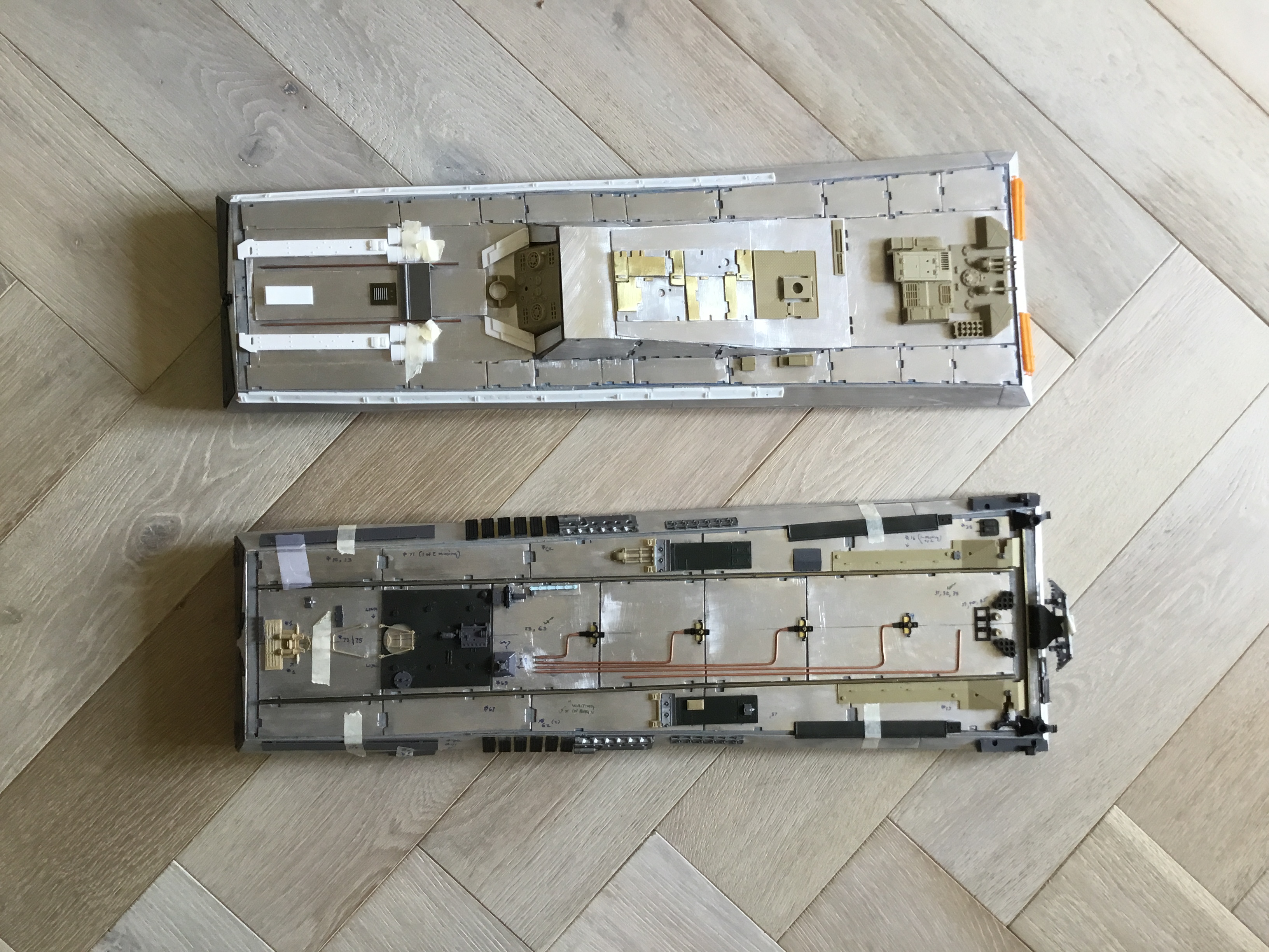

Attached is a picture of the upper and lower jaw boxes that have their armor installed. This permits the start of kit part location. It is a work in progress with some alignment necessary and practice on piping. I have tried to temporarily tack on those parts only when certain, as I can be, of their identification. Great appreciation of ILM for their application of greeblies and artistic skill. Lots of back and forth between kit part bags. Much to learn about cutting parts. One needs their “process” carefully thought out when doing this to avoid confusion. When all the parts start looking the same, it is time to stop and take a break. I am fortunate to have obtained kits parts from a knowledgeable source.

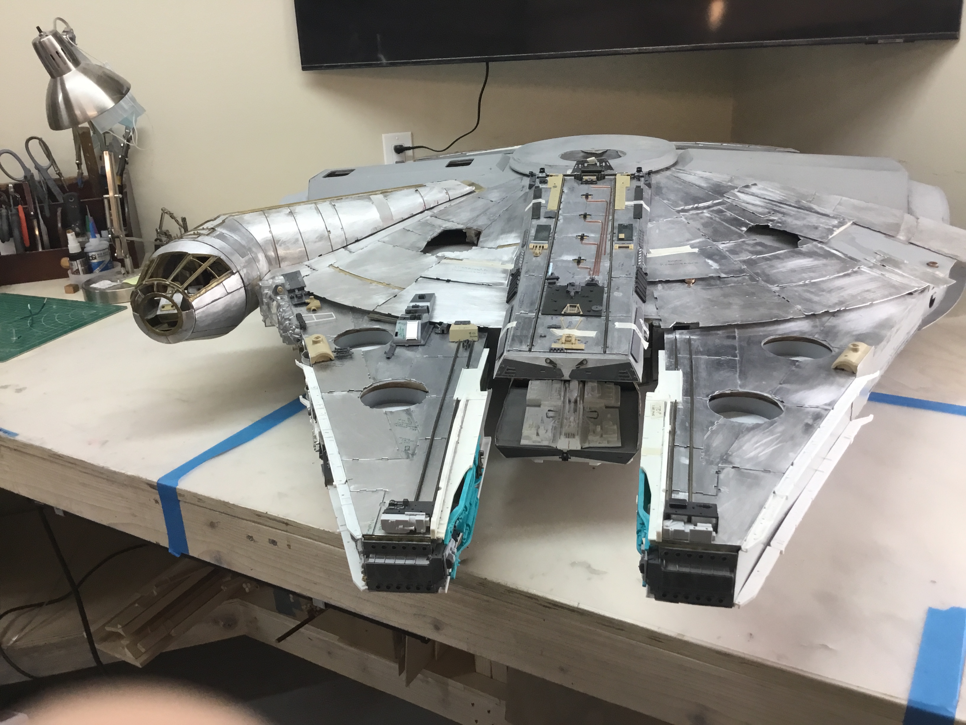

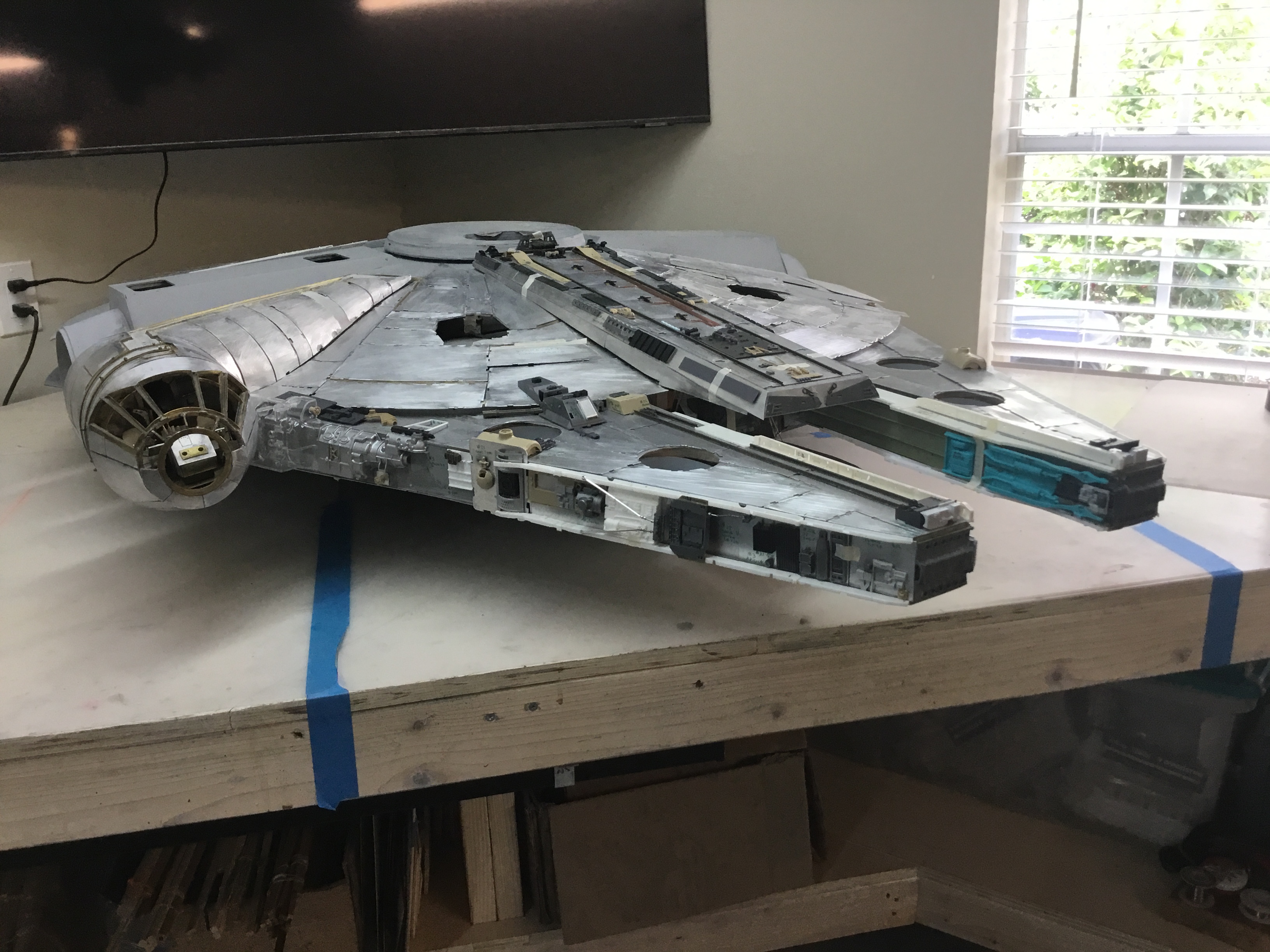

Fastened the removable cockpit tube, jaw boxes and mandibles on the disc. This provides some idea of how my project is shaping up. Excuse the tape and notes on yet to find pieces in the kit bags. Those structures are off when working.
Finished the armor on the bottom of the mandibles, so started applying kit parts when certain of their identification. Inboard greeblies were relatively easy. Focus is on Starboard Mandible outboard and top.
Lots of homework required to validate the tiny pieces in spite of maps, the many photographs and web page references. Foggy reference pictures, awkward perspective views, missing parts on the original, map differences, make small look alike parts quite challenging. Very rewarding when determined correct. While I do find the 1/72 perfect grade Bandai an excellent guide and kit instruction manuals valuable when part number is available, one can get easily lost in a reference “do loop” searching for multiple pieces. Even us left brain folks experience that difficulty.

Attached are some pictures showing the results of experimenting with piping technique on the upper jaw box, upper mandibles and forward disc quarter panels. Lots of adjustments needed. Must find some very small kit parts to replace temporary pipe fittings. Everything can readily be change be changed, and will need to be, when matching up with maintenance pit internal detail much later on.
For now, this shows what can be done with small copper & aluminum tubing. On the slightly larger tubing, one can insert solid rod into sections of the tubing to prevent “flat” bends. That rod can act as “pin” connectors when needed for extending pipe runs or adding 90 degree elbow turns. Serious studio scale folks will note I took some liberties by adding a few base plates. This keeps pipe slightly off skin surface (I can not run piping without pipe hangers, too many years in the power plant). Lots of chips added on the deck later will mask this personal engineering touch.
