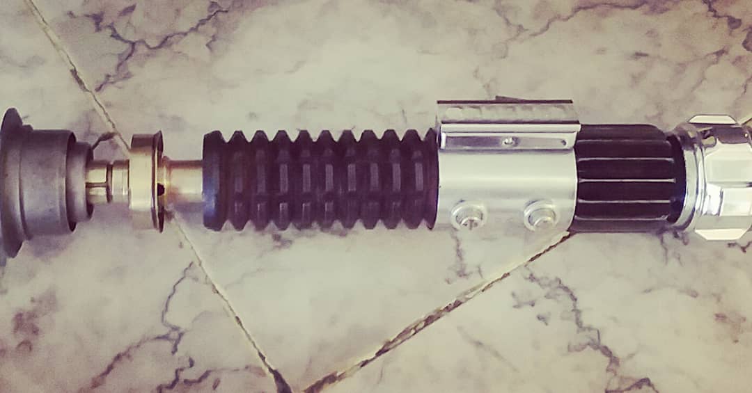

You inspired me too! after seeing the job you did there... it got me excited to improve mine!
I re-did the perma blue and polished the neck. (the perma blue turned the neck brown, so I polished it back to brass. maybe I'll grab some AB for the lower neck... maybe)
Good to know about the permablue reaction on brass, I figured it would do something.
