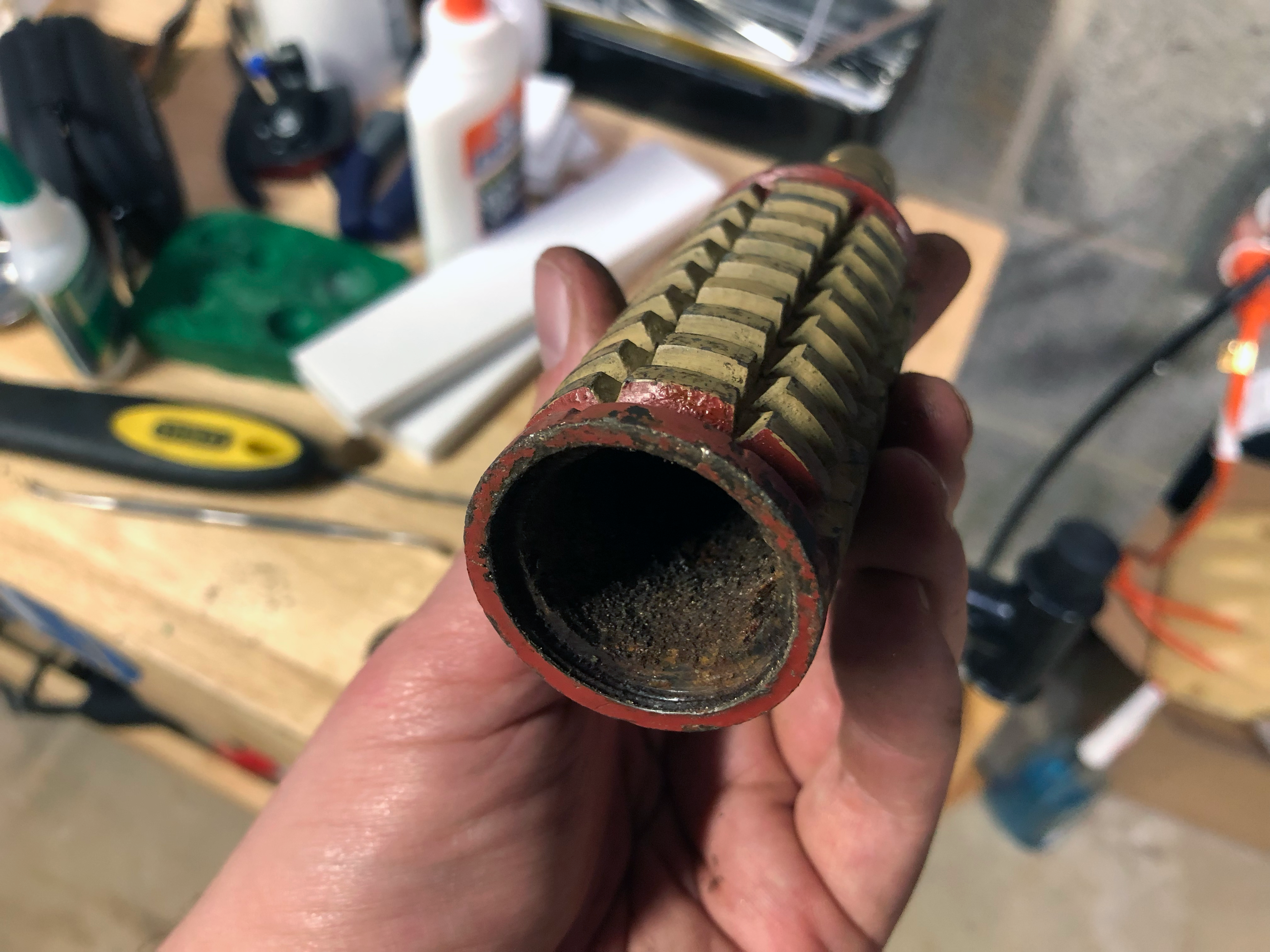

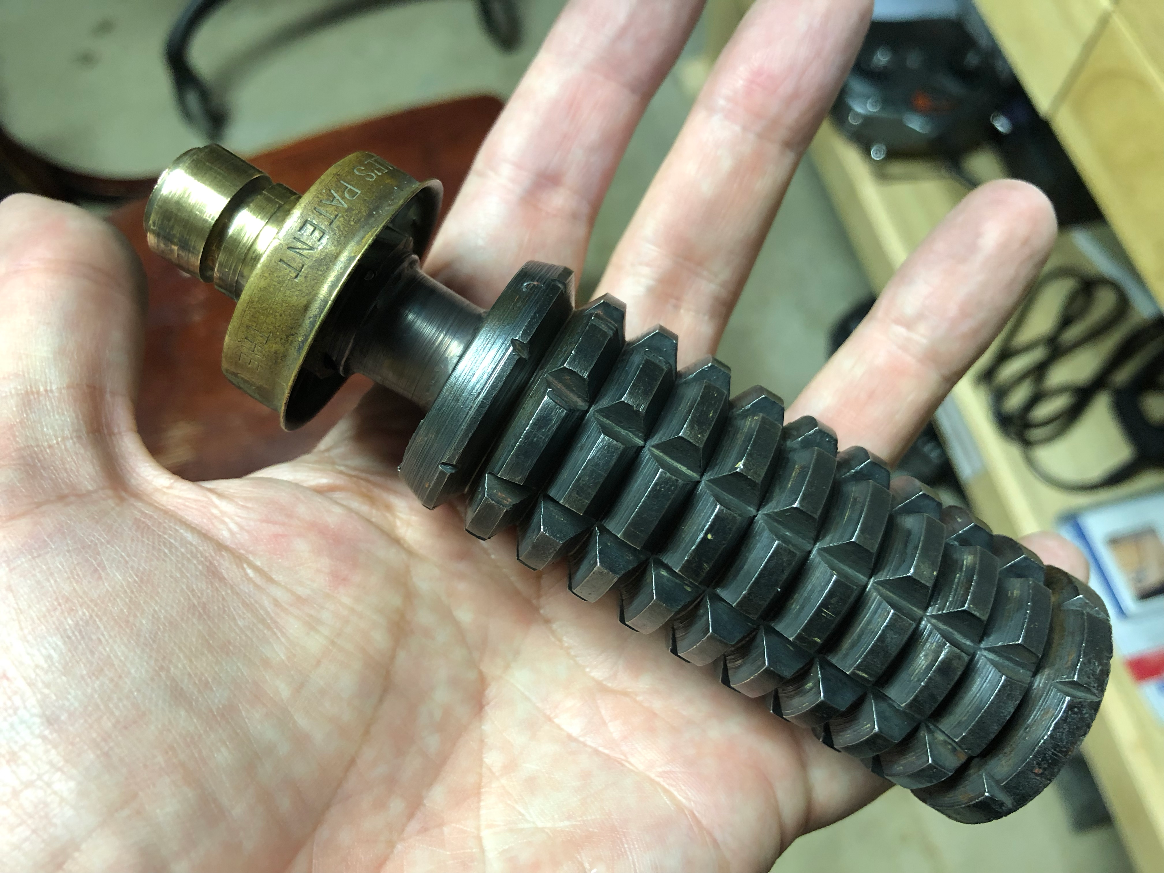

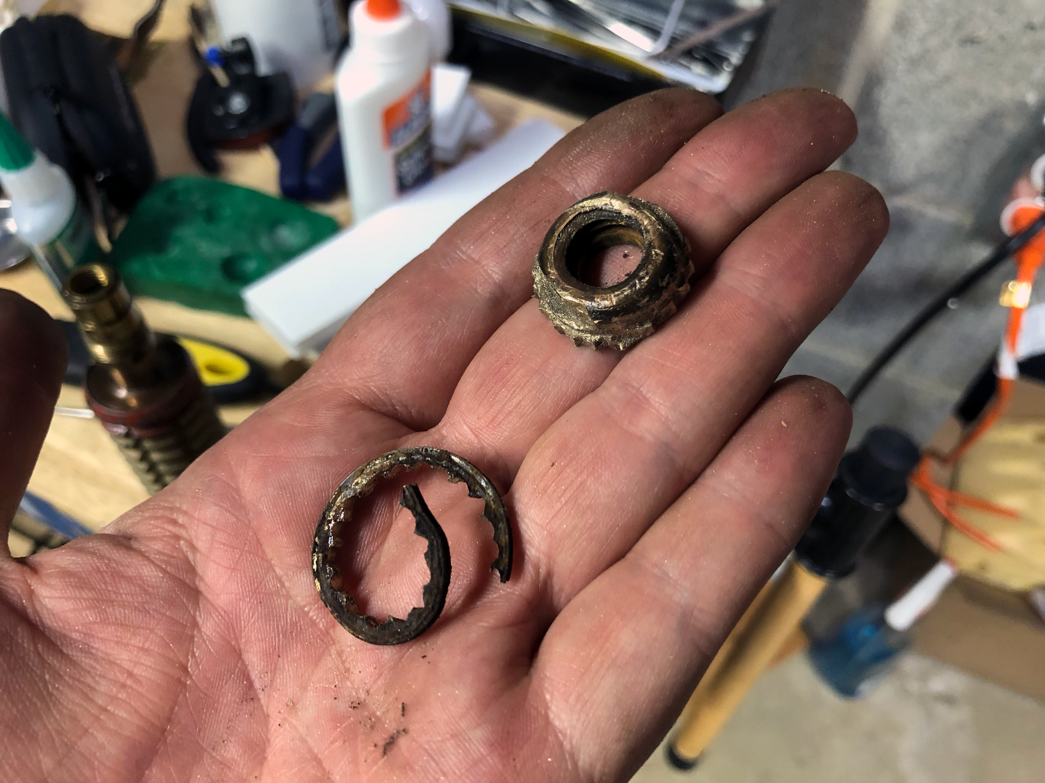

First bit of progress, and this took so much longer than I expected. I tried to get the neck off the painted grenade but it would not budge at all. Then I turned my attention to the bottom plug and it was also frozen in place. I wound up drilling out the bottom plug, not how I wanted to remove it, I'm not a fan of destroying things.
It's pretty rusty inside.
And what's left of the bottom plug

Watching you lightly tap out the threaded portion was oddly satisfying. Did you see any gunk or anything on the brass or steel threads?
nice work, I gave up on mine and drilled holes in that brass sleeve you popped out to shake out any garbage

Not really in the threads but there was some stuff on the back of the plug that was not rust, it's that shiny stuff you see in the video. That could be whatever they put on the threads that squeezed out, just a theory. It could just be a bunch of rust.

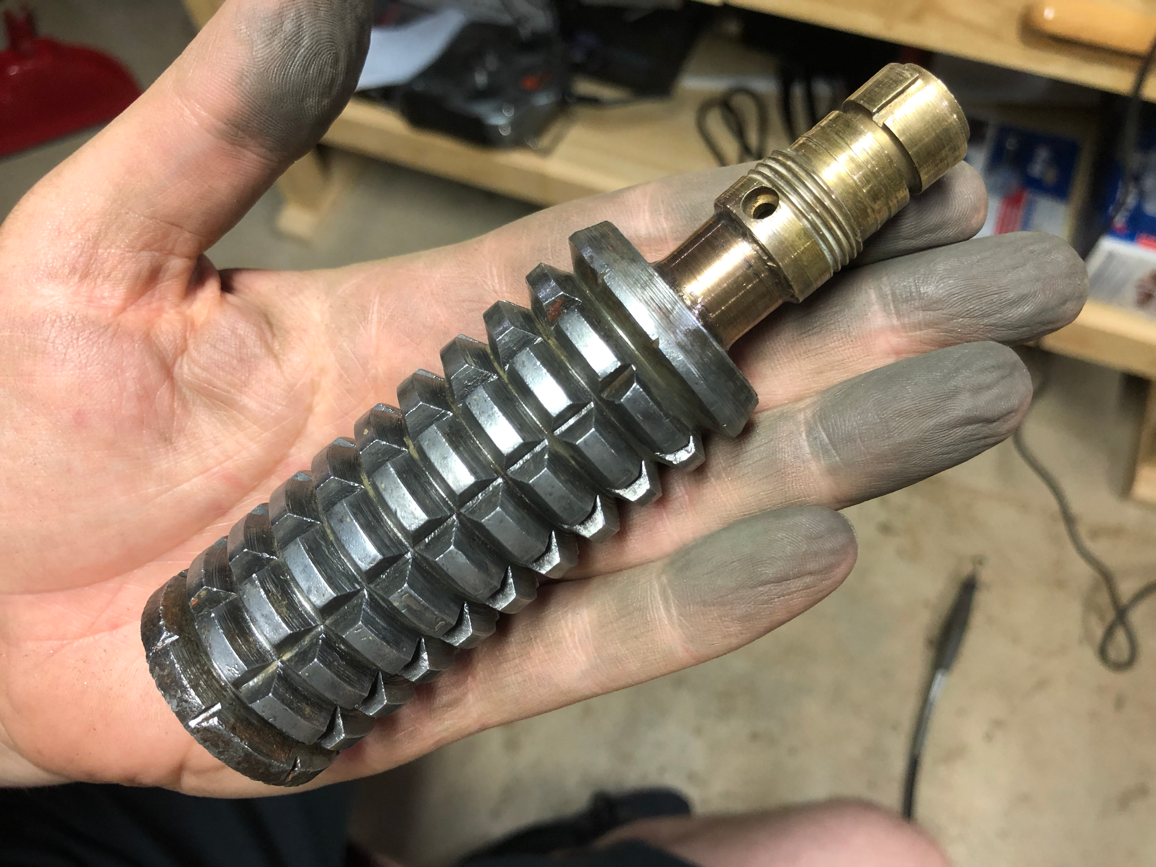

yea, that is like almost factory finish. incredible.
brass black for the neck?
If you look at reference photos you'll notice that the windvane and the neck below the windvane are darkened.

Yea! I should have clarified, I was asking what you used to darken the brass

Ok, I misunderstood. I used Birchwood Casey Aluminum Black to darken the brass. Interesting theory.

Liver of sulphur paste or solution (warm) gives an excellent dark patina to brass & copper.
