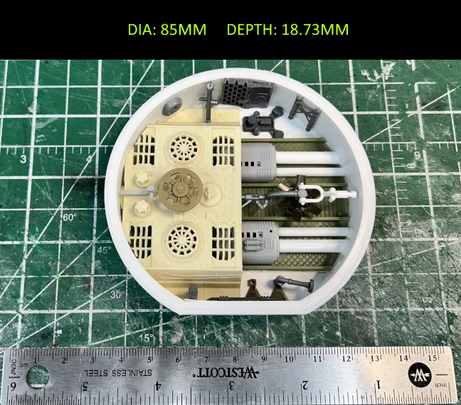

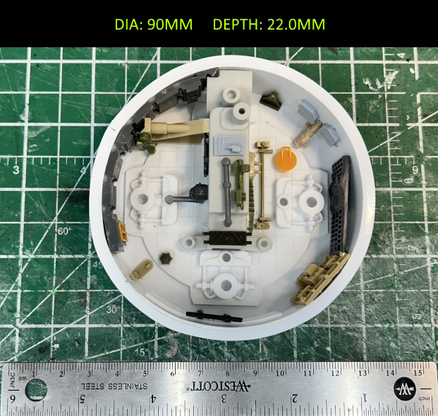

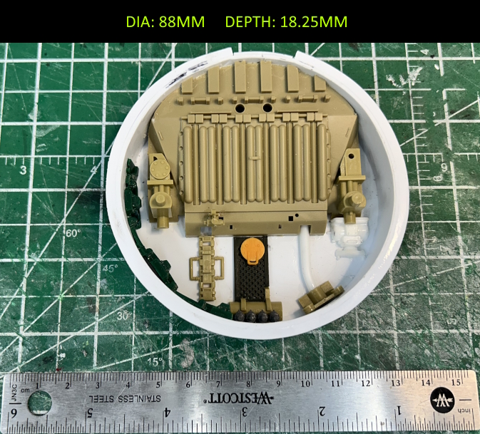

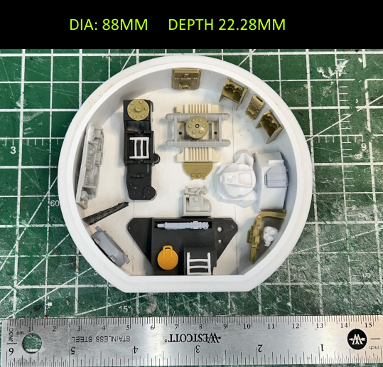

4' (AKA 5 foot) Falcon build

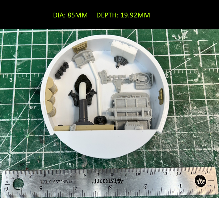

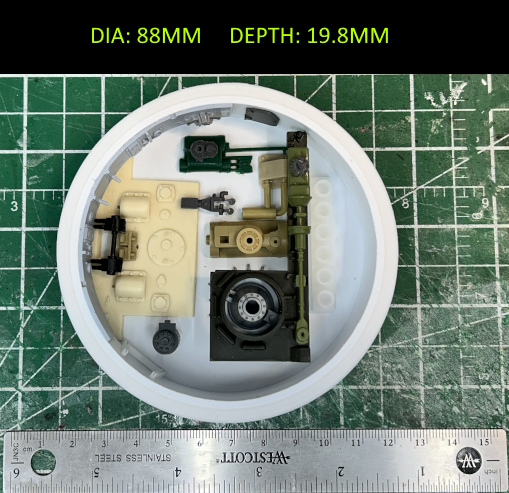

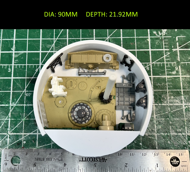

As requested, these are the dimensions I am using for my build's mandible mechanical pits.
NOTE: Everyone's build is going to be slightly different. So your mileage may vary with dimensions that work for you. As I mentioned in another post further up, I started all my pits at 91mm, then added 1mm or 0.5mm strips inside as required, dry fitting the parts until they seemed to be in the correct places relative to each other.
Height wise, that was determined by both the greeblies and where they cut off according to the filming model. As well as how two pits stack on each other, and still fit inside the mandible.
Total height of the mandibles is 2" or 50.8mm
The top and bottoms of the mandibles are 3mm each (so 6mm)
50.8 - 6mm = 44.8mm total height to fit both mechanical pits. You probably want to have a 0.5mm buffer too, so now you're at 44.3mm total for both. If you exceed that, then one (or both) of the two pits in the stack is too high.
I also used the Bandai kit as a rough guide. But we all know that is prone to error.
edit - one of those pit's isn't quite finished yet. I haven't settled on the 'gear' greeblie for one of them yet.

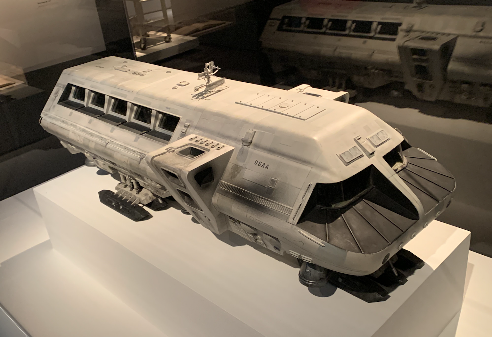

Great video David, in-depth for sure. A little "critique": while the design/looks of the models in 2OO1 A Space Odyssey are more in tune with the '60s and even our Space age, the only models that didn't have the wear & tear that SW models have, were the EVA Pod and the Space Station V. The rest of the models were looking "used-up" but not as much as the SW ones. The ILM model makers (interviews available on YouTube) all said that this movie was the inspiration behind the used look of how to clad greeblies and paint effects on their SW models. ;)

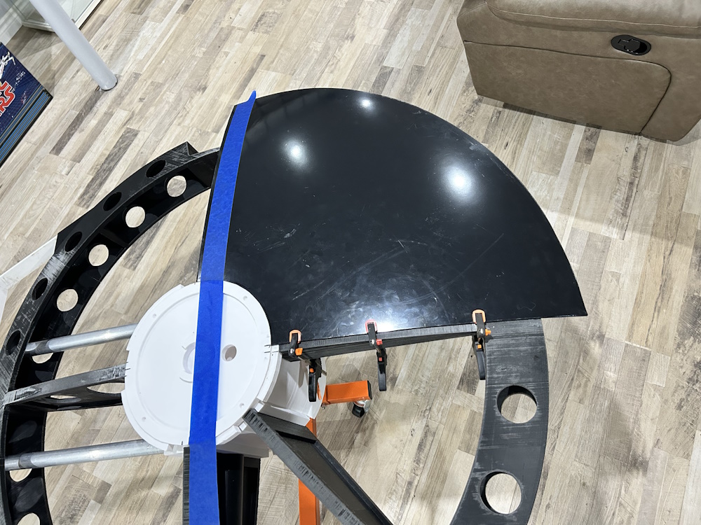

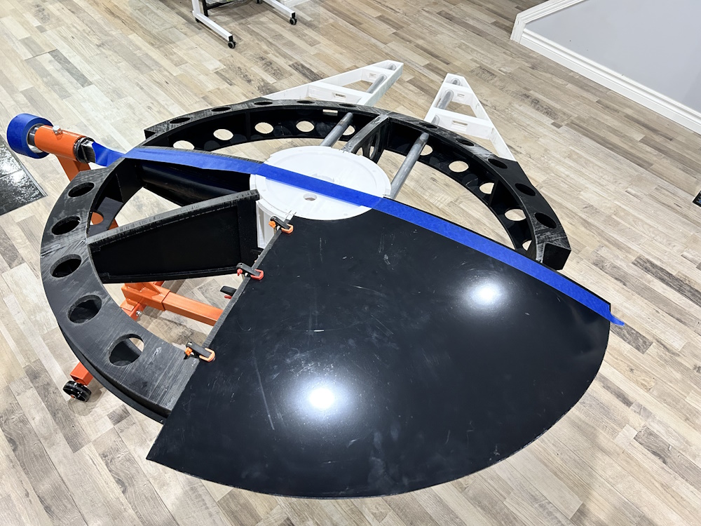

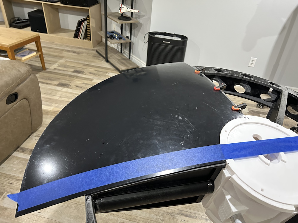

I've started rough fitting the ABS domes for my build. These are the domes that Stu (eagle1) had vac-formed. While they require trimming, the curvature matches my frame perfectly. I'm starting with the lower-port-rear quarter as it's the only one of the eight quarters that does not have some sort of opening cut into it. so I figured I'd start with the easiest of the bunch.
edit, in hindsight, I should have adjusted my frame a little bit. The lower-port-rear rib needs to have a section cut out to accommodate the items visible through the bottom gouge. I'll have to pull out the Dremel for that one.
thanks
