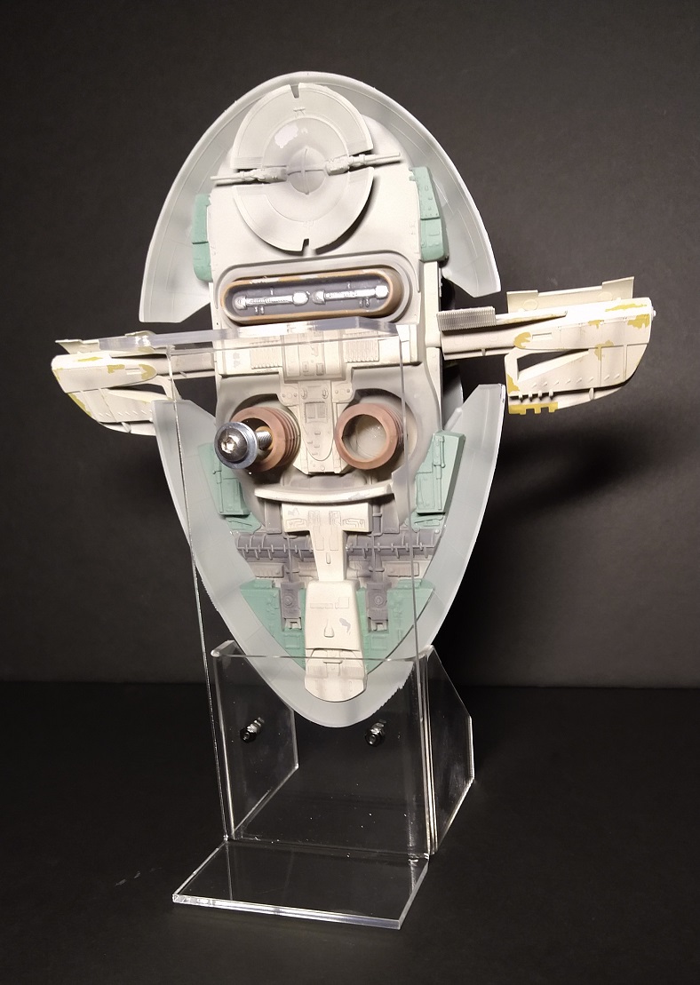

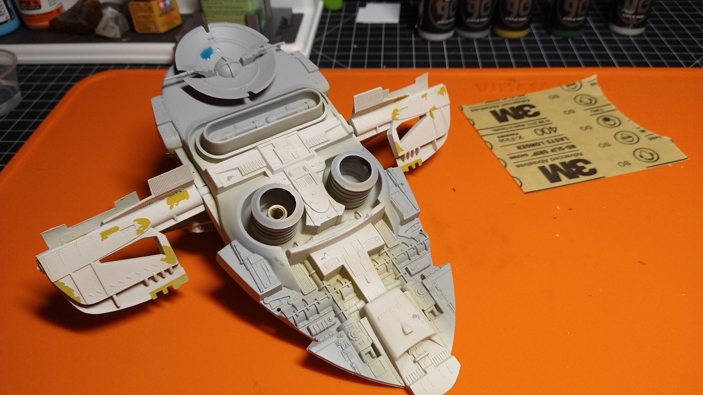

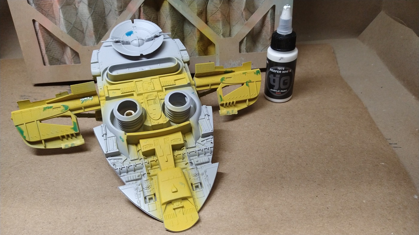

Now, onto the rear section! This is basically the same process and colors I used previously so I won't go into a lot of details. I did make a few adjustments though. I used Light Green, mixed 50/50 Rust and Boxcar Red for the engine shrouds, I used the color Mud on the upper part of the win strut and finally misted it the same way I did the upper section with Dark Grime followed by Concrete.
That Reefer White over the Armour Yellow really gives you that creamy color:
And finally, the interior is painted and installed. Now you can see why I usually black our my canopies :)
