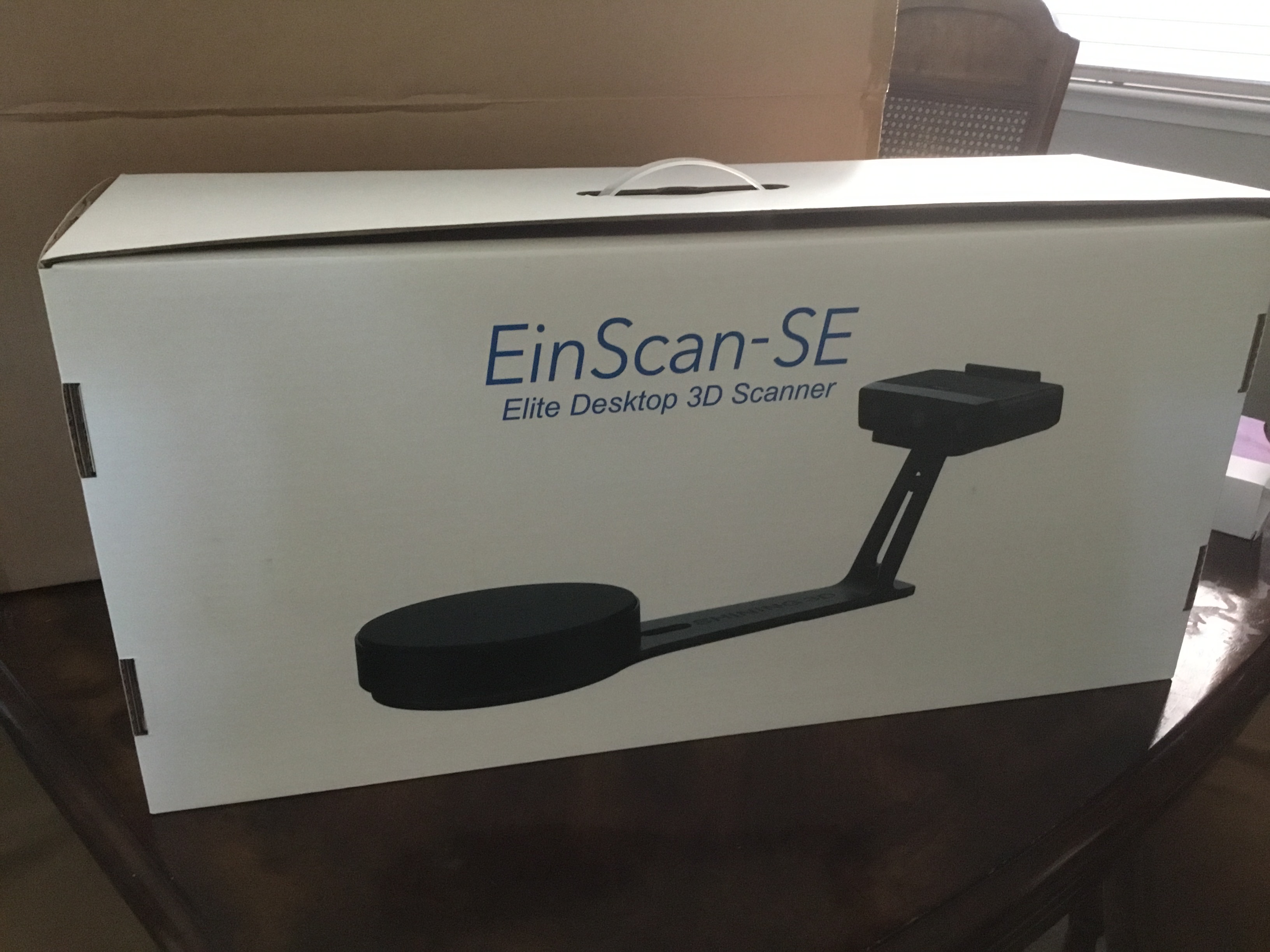

I also went in on a Tier 7.
My Einscan SE just arrived. Maybe I can help out once I get this dialed in.
I have a few kits.

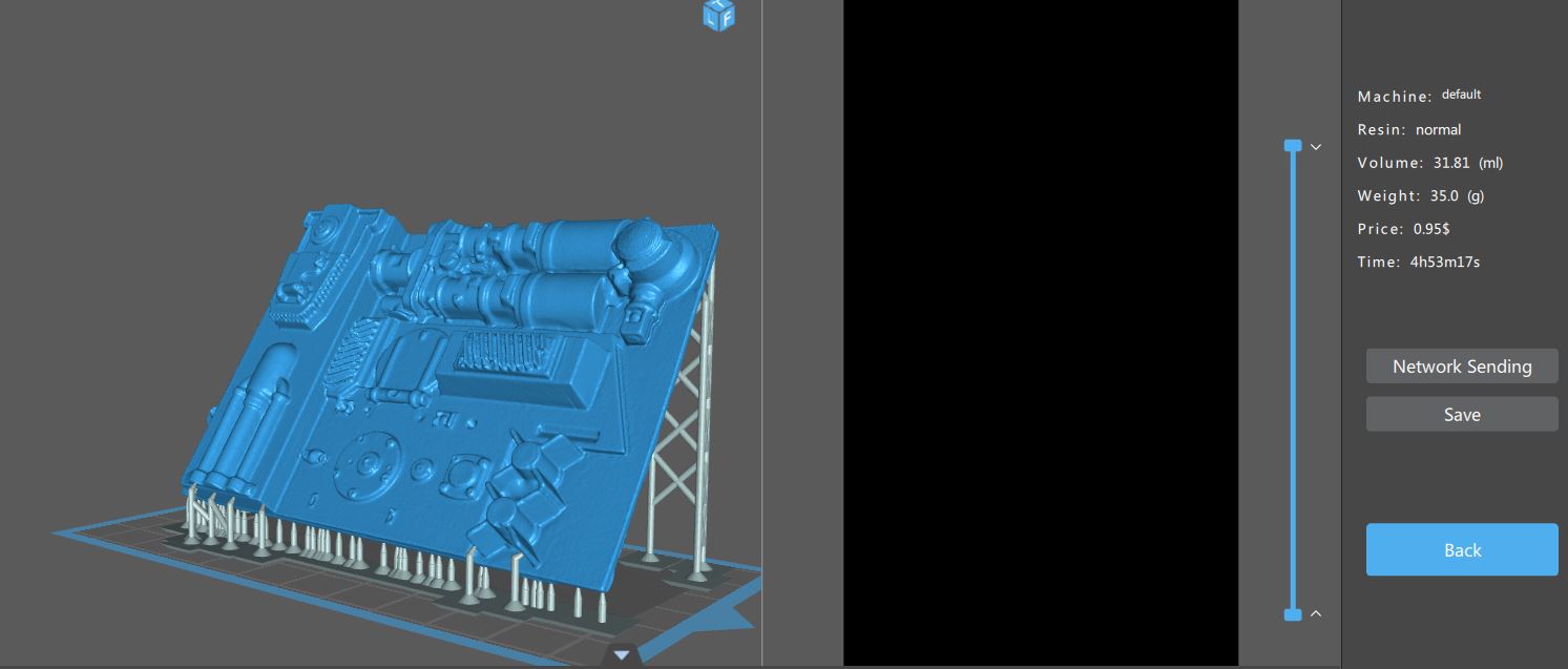

That LOOKS great. What part needs work? The two little yellow splotch areas?
I've always presumed/assumed that the proof is not in the pudding, but in the tasting. In other words, how does it look once it's printed out? If you can print it and take a picture of that, it would seem to offer a much clearer picture of "what you get" at the end of the process.
There's a few things you have to keep in mind about the printed pieces and using that as a metric for quality.
What type of printer? sla, dlp, fdm... resin prints differ in quality heavily based on what type of resin used and what print setting were used.
What type of material was used?
What scale was it printed at? some people may print at original scale some smaller or larger
SUPPORTS - major part of printing is how it is supported which can effect the final outcome. Results in quality of the print depend heavily on how the object is supported.
Post processing - how well was it cleaned up, did they over sand it?
Hope that gives you some things to think about. For me I would say printing is on the user, and all I would worry about is the quality of the scans. Everything trickles down starting from that. Give your mind some ease.
Ha, what a cracker of a first test Whiskey!
The result looks nice and clean.
And what a great area to try and square away. Well done!

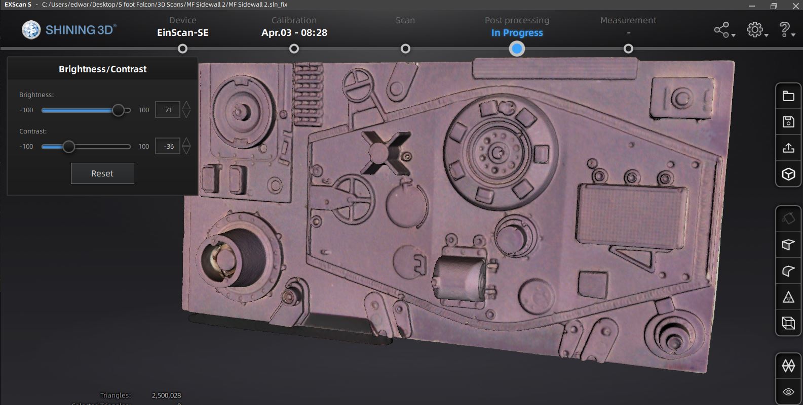

This is the other section of the sidewalls for the 5'
Need to take a break. I cant quite get the edges sharp enough.
Soft compared to the actual piece.
Might need to increase the light and snapshots per revolution. Right now I'm at 65.
have you tried using scan spray at all before? or a dulling spray even may help
